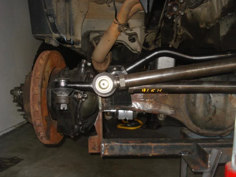

Tie rod end rubbing control arm

I wonder if this....
Might be better or easier than This...
attachment.php
Other than getting more debris in the rod ends and wearing due to it, What would be the down side of doing it like in the first pic?
and ofcourse having the tie Rod / drag link much lower also, since it would be mounted on the underside of the arm... <---- I think this alone should be a reason no to do it like that... right?
