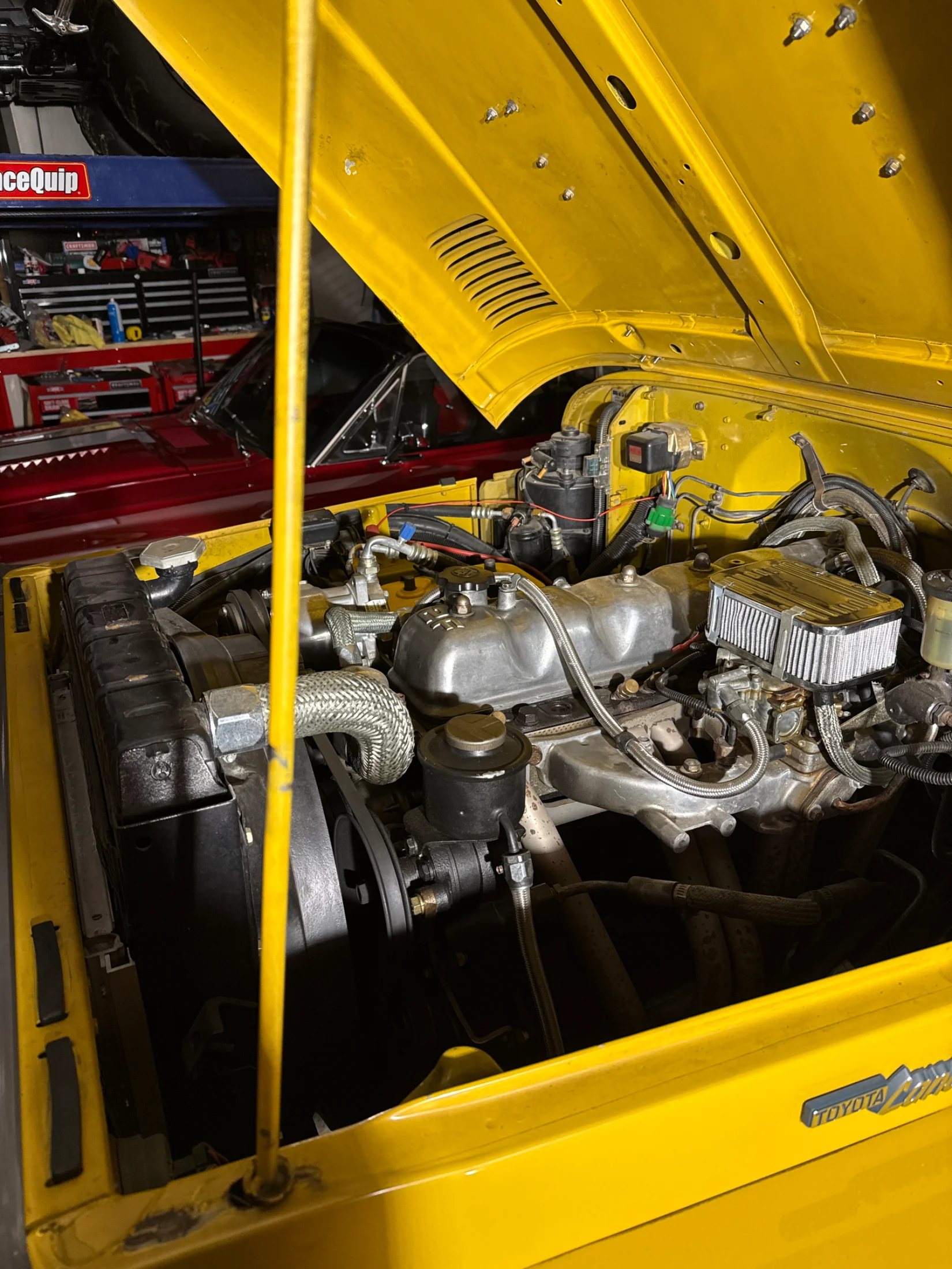

I’m in a bit of a pickle. I have a 1980 FJ40 that is starting to show a bit of age. I have what I believe to be a 2F motor with around 40k original miles that is numbers matching to my truck and runs decent. I live in Colorado about 6500 ft and it causes a lack of power due to the elevation. It has a Weber carb on it. My question is would you swap the 2F for a Cummins in my shoes?

No. You can make your 2F run just fine at 6,500'. I got around Denver with a '73 Aisin carb and an FJ60 big cap dizzy (advanced quite a bit) on a 2F block.
If your 2F has decent compression (at 6500 feet, you'd like to see 115-120 psi), put AFI EFI on it. Mine pulls hard in all gears, starts great, etc. Short of towing trailers (which is sketchy behind a 90" wheelbase vehicle), I have no power issues. Even with 33s, what I now need is an overdrive. I live at 7000'. $20K+ to do a Cummins swap seems absurd.

Rather than the considerable effort and expense of a motor replacement, I would suggest a swap back to a factory carburetor and see how it works. If later on you decide a different motor is what you prefer, then you’ll have a 2F with OEM carb to sell.

There's tons of info on here on what carb and tuning to use. If you live there you can tune it for there.
Fix what you have and I think you'll be happy for a long time. Swap it out and I'm almost sure you'll regret it.
