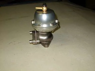

I could actually see light through the stock wastegate. It was bad. So, new 38 MM wastegate off Ebay.. And, I also have an infinitely variable boost controller (in cab) for it as well. fun stuff :)
That old wastegate only weighed about 50 lbs more than the new one ;)

The bummer on the adapter is that I have to cut it up a bit for the new wastegate. Ahh well, it needed help anyway ;)
