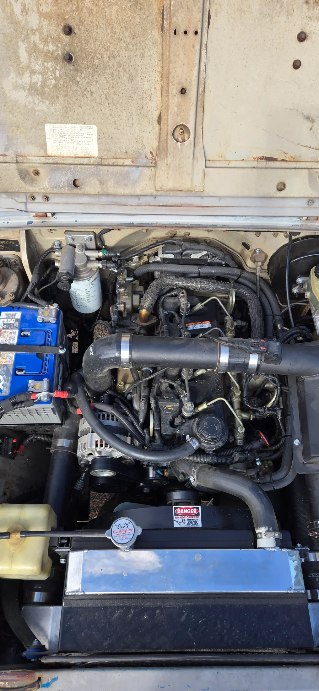

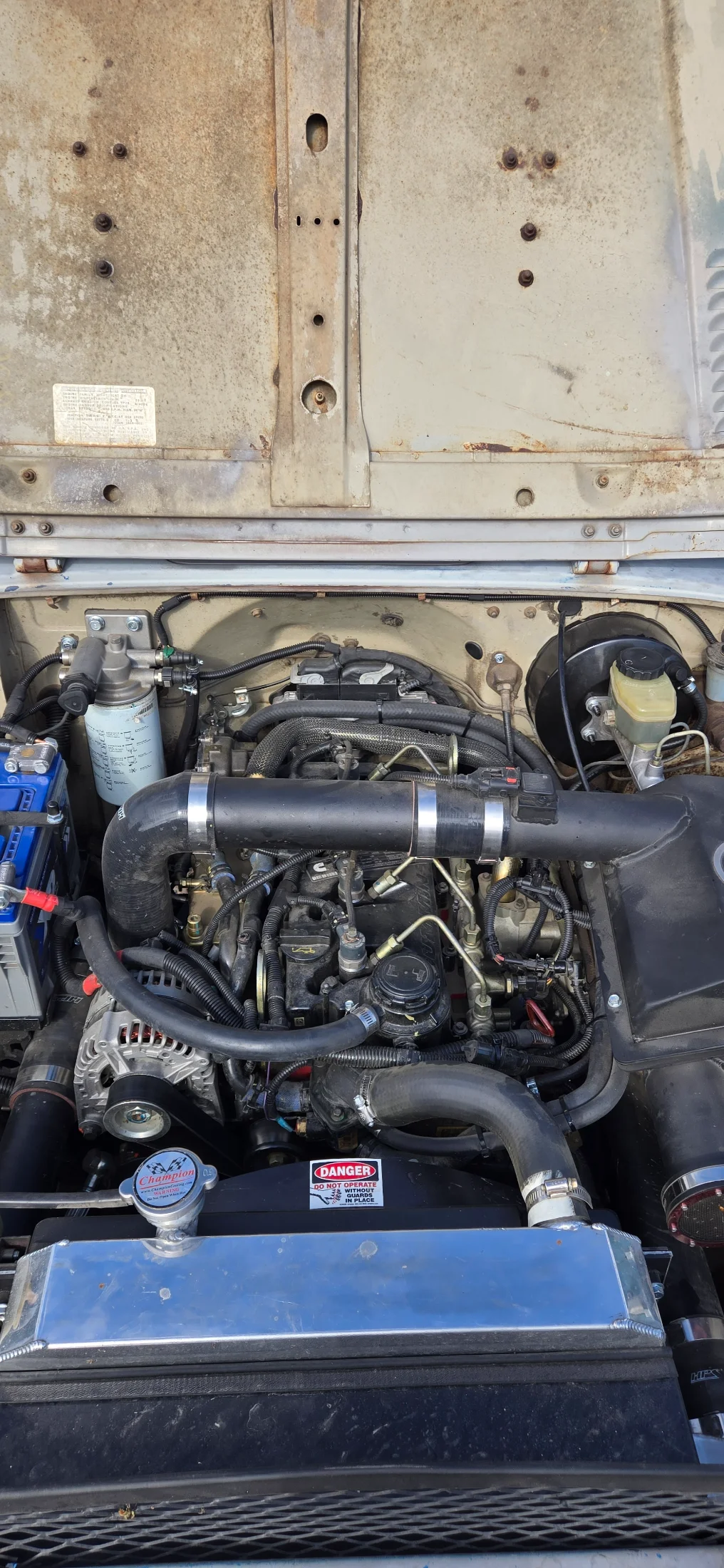

I have a R2.8 in my 40.
My advice is to drive one before you pull the trigger. I'd go a different route knowing what I know now.
On road it's fine. Delivers adequate power and returns 20-21mpg.
Vibrates a lot. Especially annoying at idle. 4 cylinders do not balance well.
Offroad the programming is not great. 3:1 gears do make it substantially better. I had to abuse the snot out of the clutch to keep ground speed low enough. I did 3:70 gears, but with an H55 transmission 1st gear pretty well wipes out the gearing change. 3:1 in the transfer case made a world of improvement.
The 2F in my 40 was tired when I bought it. Keeping it in any fashion never crossed my mind.
If i had stayed gas, I'd do a 1FZ
Going diesel, I'd do an OM606
Best picture i have of the engine bay at the moment.
