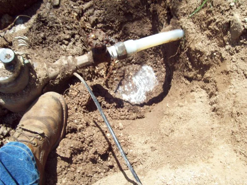

This is Pex tubing right?

Main line, multi million dollar home with a whole house fire suppression system. Homeowner asked if I could fix the leak.
I told them yes, I can fix the leak. But no, I won't touch it and to get someone who is licensed, bonded, and insured.
Looks like someone has already "fixed" it. I don't blame ya!

great place to put that gate valve handle buried in the dirt , thats some sweet work and engineering right there :hillbilly:
Looks like PEX but transition fitting doesn't look right.
Ya, that's PEX pipe, but the wrong fitting. No wonder it's leaking. I wouldn't touch that either, good call.
That valve needs to be in a weather-tight box. Not sure I've ever seen a water meter that's meant to be buried, either.
The meter was in a concrete box, but the gate valve was buried.
Thats Wirsbo pex. It uses an expanded collar that shrinks back to hold the tubing to the barb adapter.
You need Wirsbo tools to work with the collars. You could cut it back and use a ford fitting and insert. Ford Fittings
