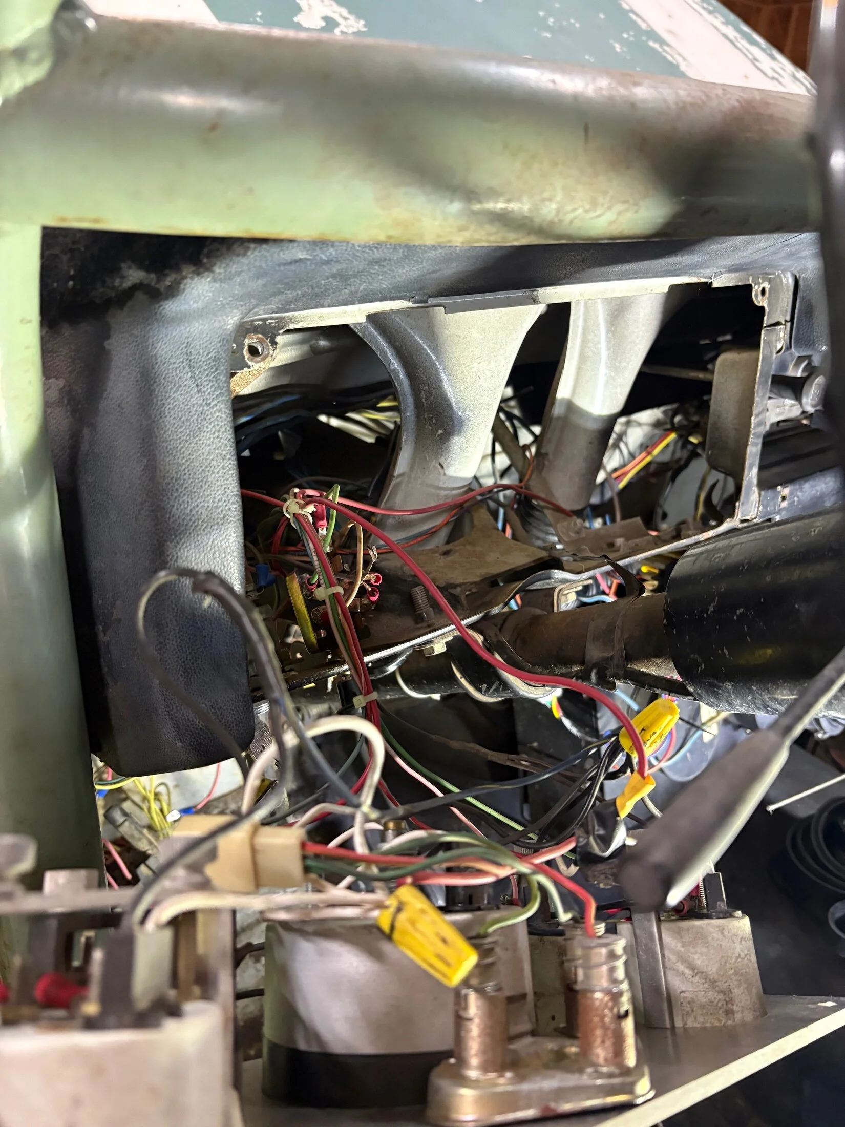

Not a ton of progress, still trying to get a grasp on what needs to be done and in what order. The wiring is a mess, it really needs to be completely redone. Wire nuts, bad connections, and wires going every which way. The Autometer speedo has no cable hooked up to it, that could be why it doesn't work. I was able to clean up the top of the fuel cell a little, there are some wires back there and what looks like a sender, impossible to access without dropping the tank though.

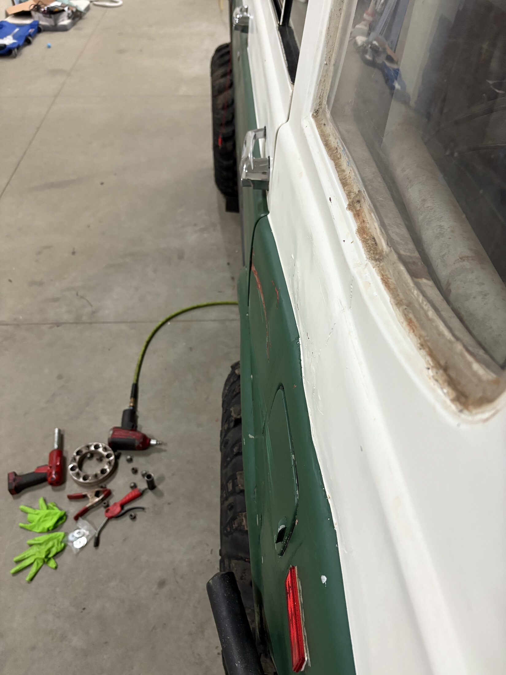

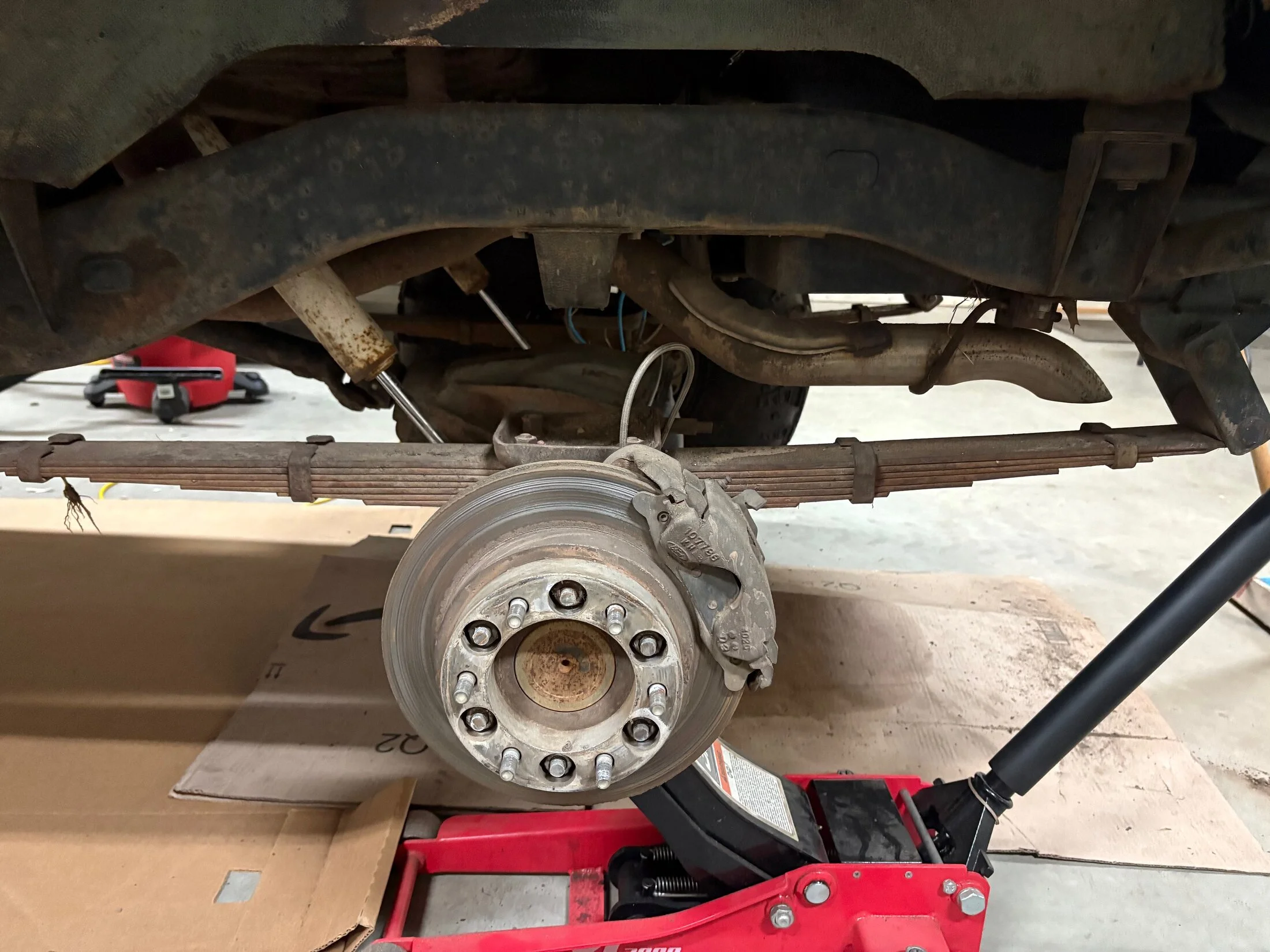

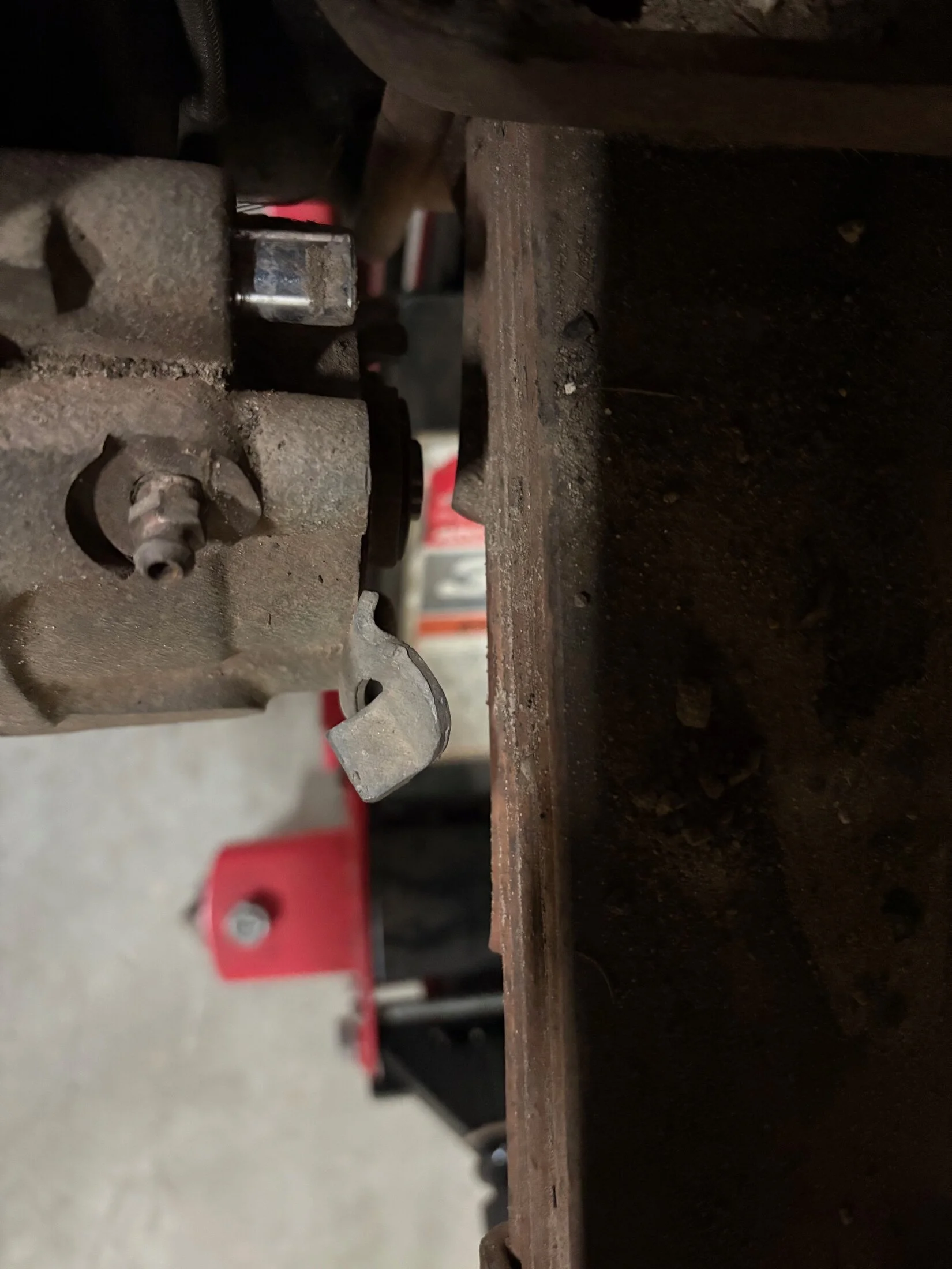

Pulled the left rear wheel, one stud was trashed, probably due to sub par wheel spacers. Looks to have some goofy Ford brakes. The parking brake mechanism has been removed and there isn't much clearance on the leaf spring. I guess it works though. Need to order some pads, maybe new calipers. Why would you go to the trouble of a custom width rear end, make it too narrow, and have to run spacers?

Also checked wheel fitment without the spacers, I just don't know as it kind of lost the look. I will probably have clearance issues up front but it might work in the rear. Wheels are 15x10 with 2.5" backspacing, not sure I can get much better than that. Maybe some 37"x12.50 tires on a 17" wheel will be in the future, I have long ways to go before worrying about this though. I am going to make the rear brakes work even though I don't love them. The passenger side was up against the leaf spring, but I can get creative with the grinder. Starting to order some parts, anxiously waiting for a large care package from @cruisermatt :pig:

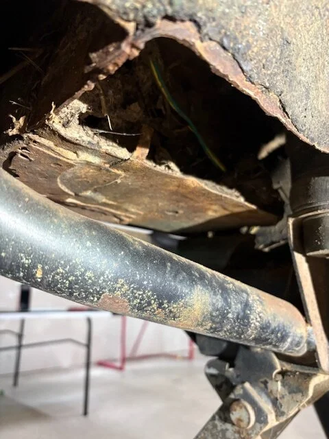

Found where all the dirt gets packed into, there is ton in this cavity on the passenger rear side. Is this space here on a stock FJ55?

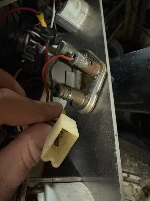

Almost forgot, this is the blinker and high-beam light assembly that was retrofit in the dash. Is this a factory Toyota part? The harness plug looks like it could be.

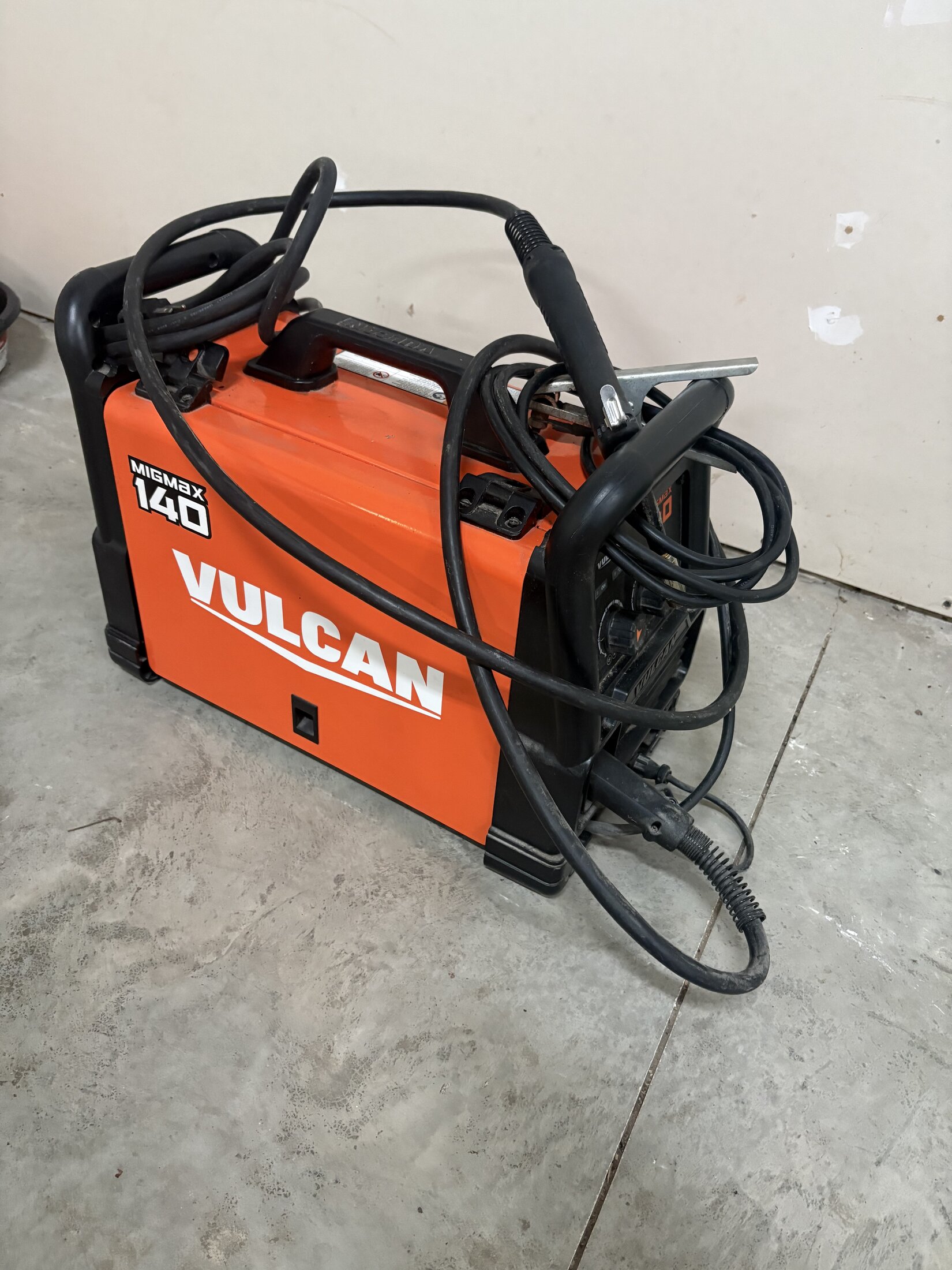

I have not had any time to get any work done on the Cruiser, but I did manage to upgrade welders with a good score on marketplace today.

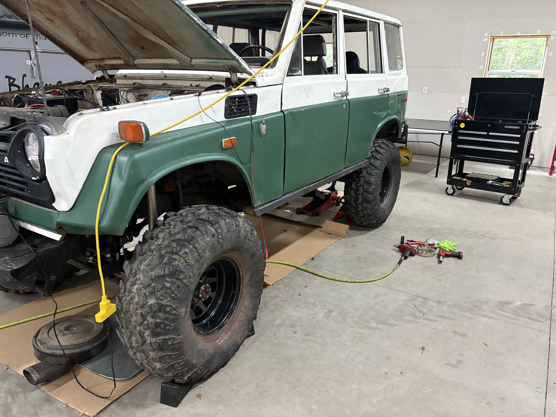

Well my wheel/spacer situation has come to a head and I need to make some decisions. I took the time to properly measure the rim today and confirmed it is a 2.5" backspaced 15x10. Hard to come by these days but Raceline might have some 15x10 2.5" backspaced beadlocks still available for a good price. I figured I would just pick up some Spidertrax spacers with new beadlocks and call it a day, but not so fast. The right and left rear axles are different, I think one is a Currie and the other a Moser. I potentially have different size lug studs between the two, I have not investigated further, but shenanigans are undoubtedly present after removing the spacers tonight. In addition, I emailed Spidertrax and they recommended NOT to run wheel spacers with my 2.5" backspaced wheels. Nuts. So now I have a short and narrow pig!

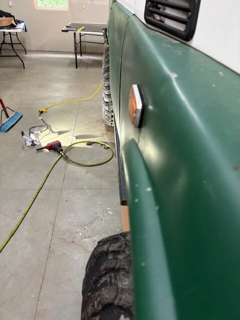

I need some help convincing myself that the stance is going to be ok (it seems narrow) running the 15x10 2.5" backspaced wheels. I really don't even know if I can stuff these tires or not (36x13.5) like it sits. Below are a couple pics with the rear wheel spacer removed and the front wheel spacer still installed. Is anyone else running SOA with stock width axles besides Pighead? If so what is your wheel/tire combo? I have a feeling I am going to be hunting for a full width Dana 60 housing and maybe run those IFS mini truck front hub spacers.
