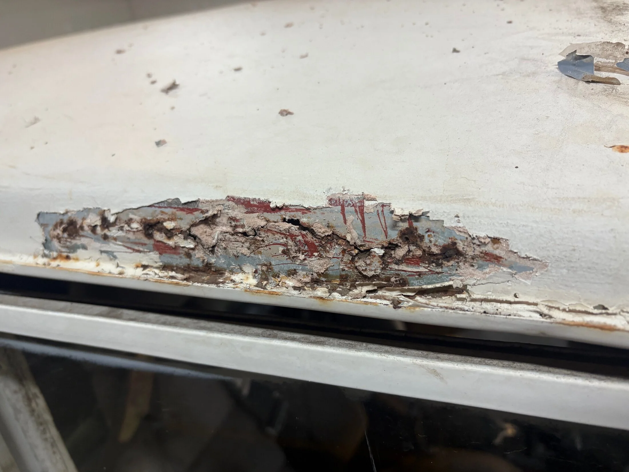

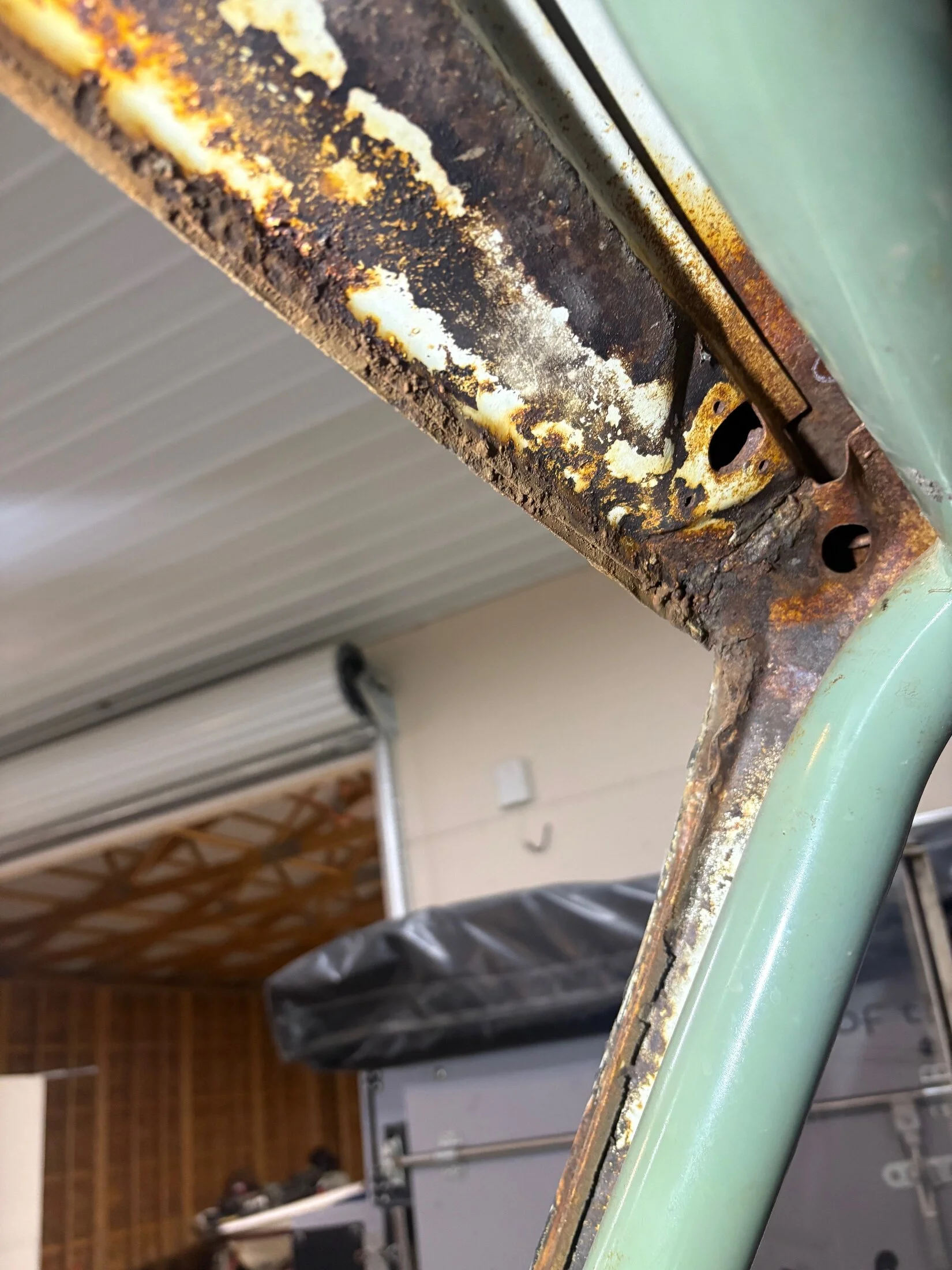

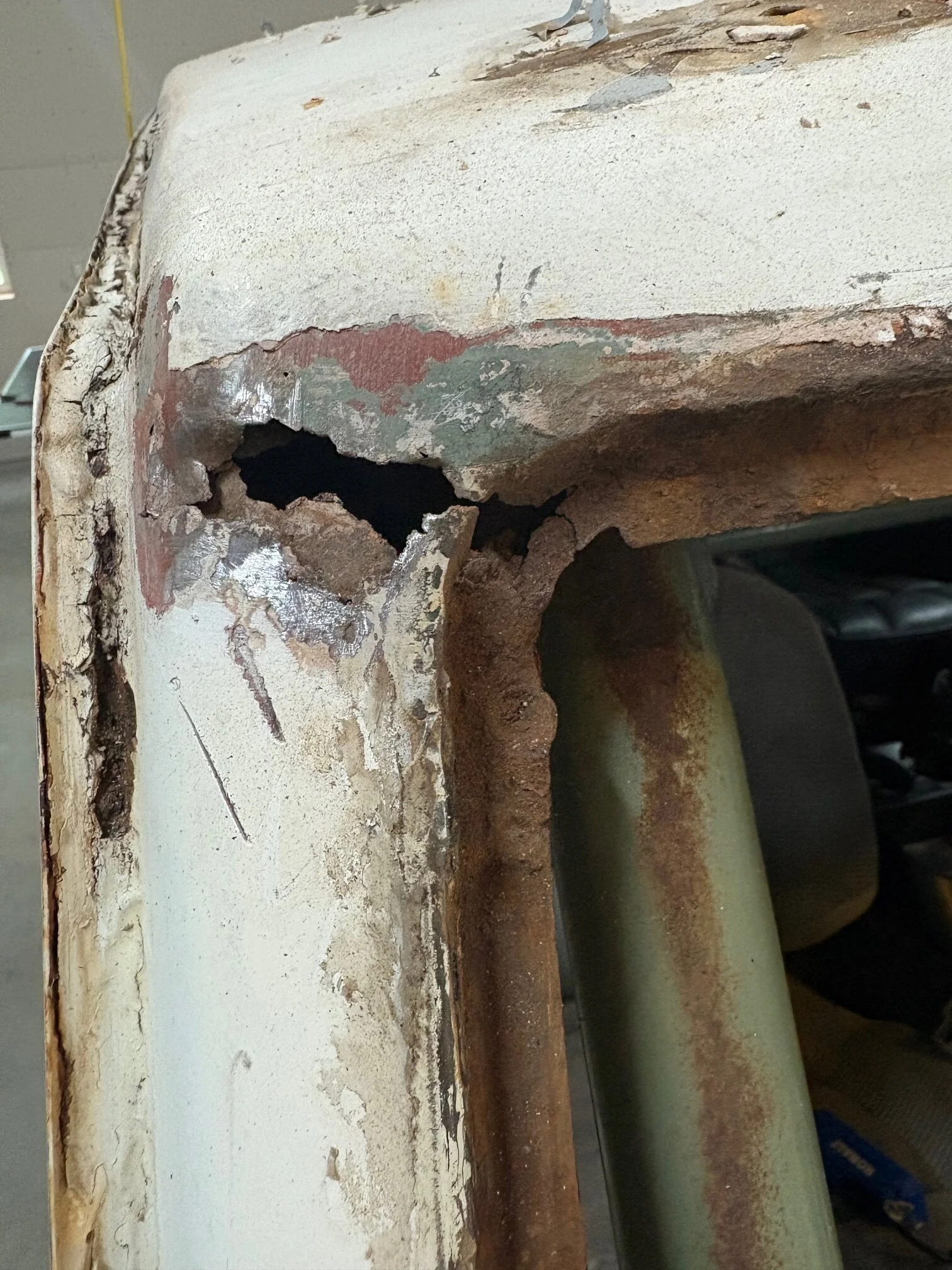

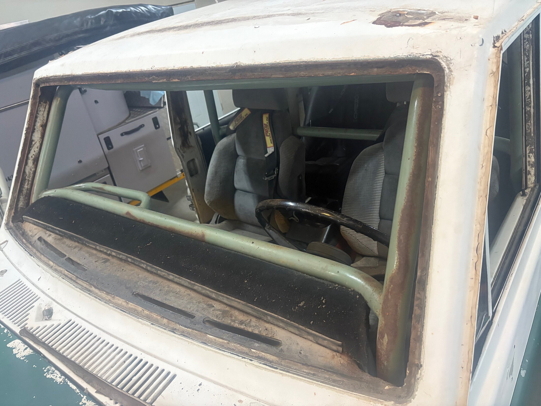

@J Mack you saved the day with that tip. I got into the Maker's Mark then started on that gasket. I cut the inside lip off and the glass just rolled right out, it was a non-event. With the bourbon on board I just couldn't resist and went to town at the bondo job. I had to know what was under there and found out it's not great, but not terrible either. I do believe this is the worst of it, there is a spot on the driver's door and another on the fender, but nothing else that I know of. I sure could use some options to fix this. The most obvious to me would be find a donor FJ55 and cut the pieces out, but that is probably a long shot. Seems like a tough spot to fab patches for too. Part of me wants to just wire wheel the channel (which is in overall much better condition than I expected) hit it with rust converter, then some type of spray can epoxy primer and drop some new glass in for the time being. Half assed perhaps, but I am still waiting for the "gotcha" moment with this pig and want to put some miles on it to find out what it is really about. Heck I probably don't even need a windshield for the time being. I am all ears on suggestions.

Easy spot to patch and perfect place to practice with that new wire feed welder. Don't wait on this one....
The shinny spot is lead, melt that out with a propane torch first then sand down to clean metal. I would use 14 gauge right there and might make it in two pieces, let me know if you have trouble finding some small sheets of 14 gauge and I'll send you some.

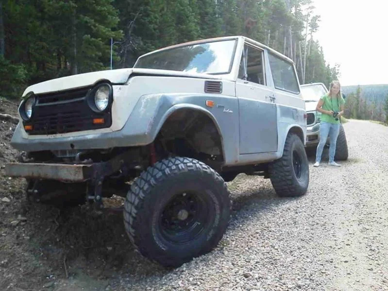

Found a thread here that looks to have some pics of your rig as well as a slew of other bobbed 55’s. Page 6 is especially heavy with “Short Rib”
Thanks for posting that link, some good stuff is in there. I found some other old pics too I will post up. This forum has lost some great people over the years. While I never met him Delancy was a huge contributor to the site. FJ40zen (Bob Paul) was my local Land Cruiser mentor when we lived in Colorado and passed away a few years ago too. Sad times.
