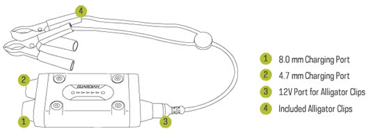

Here is another item I have been looking at if I want to charge up my ArkPak in the field.
http://www.goalzero.com/shop/p/156/Guardian-12V-Charge-Controller/6:5/
The charge controller has battery clips on so you can attach it to the ArkPak or any 12v battery for that matter, and the solar panel inputs on the controller can accept two different size cables.
My Powerfilm 60 watt solar panel I have will mate to this controller.
Amazon has these, just ordered one.

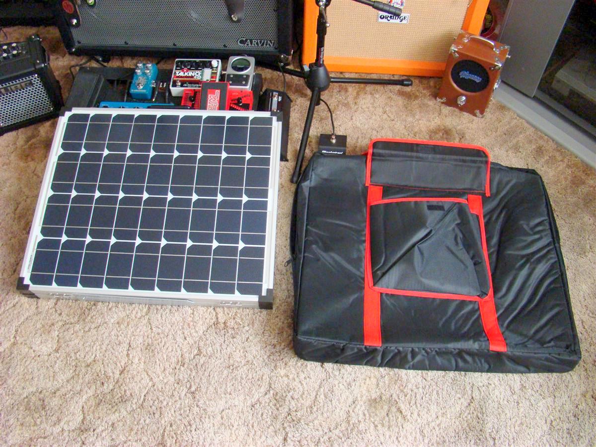

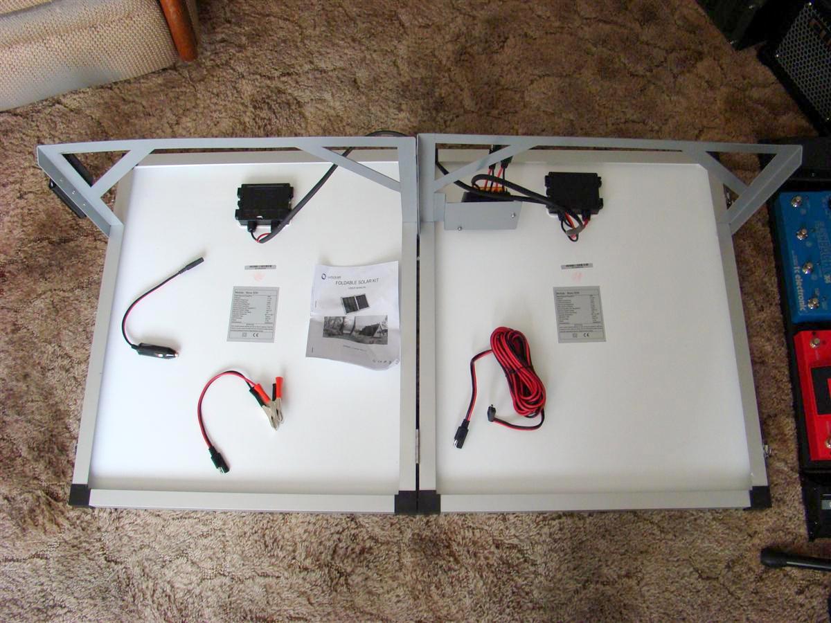

FedEx just dropped it off 30 minutes ago, and I unpacked it and snagged a few pics.
First off I am very impressed with Solar Blvd's shipping and boxing.
The box had 90 degree angle stiff cardboard all around the outer box helping to hold the box secure.

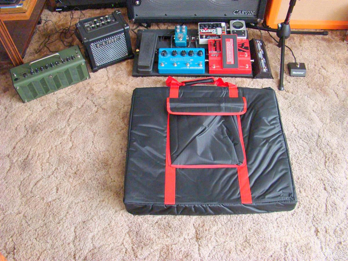

When I opened the box I was met by a red/black bag, I did not know these shipped with one, but I am happy it did :D
Lots of cables came with it and instructions, which I will pour over tomorrow.
This will mainly be for charging up my AGM battery in my ArkPak when camping, since I have the Powerfilm 60 watt foldable for the FJs battery which runs the ARB fridge.
This unit looks very well constructed, and it is very hard to not get something made in China these days, know what I mean?
W Solar 100 Watt Foldable 12 Volt Solar Panel $270.00
only $169.00
No where does it mention on the URL above about it coming with a case.
In the case
Next to case

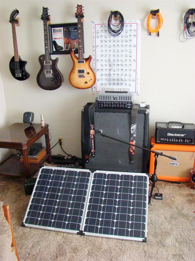

Back side showing cables and the folding aluminum frame for standing it up

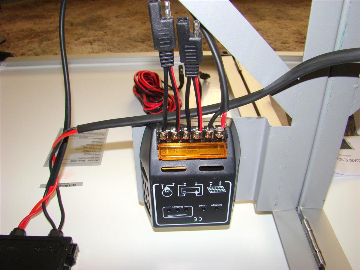

Charge controller I assume
In position to catch some rays

Corey, those solar panel units are very common and popular in oz. Prices keep dropping - about $150 gets you a 140W or more mono panel over there. As does yours, the come with a reasonably padded bag and storage for the cables etc. The folding aspect is great for packing in the vehicle versus a large single array.
The mono panels work great in cloudy/non-optimal weather. For the USA that $170 for 100W is a pretty good price, for some reason they cost more here than oz - someone is making more profit here :)
Anyhow, I'm sure you'll be more than happy with that panel. The 'charge controllers' are simple PWM units, they work ok, but nothing 'wonderful'. You can always spend some $$ later if you're not happy with the PWM unit that came with the panel and pick up a MPPT controller or just a better US PWM controller. I used the cheapie PWM controller that came with my panel on a 2 week trip and it worked fine to run the fridge 24/7 on my aux battery even with clouds and some rainy days.

Thanks George for the info.
I noticed after taking the pics that the green "on" LED light was lit up on the charge controller.
This was with my drapes closed, as to much sun was coming in for pics.
Looking forward to using this unit later.
May do some experimenting with it and see if it will run a few of my Goal Zero LED lanterns with no battery in between.

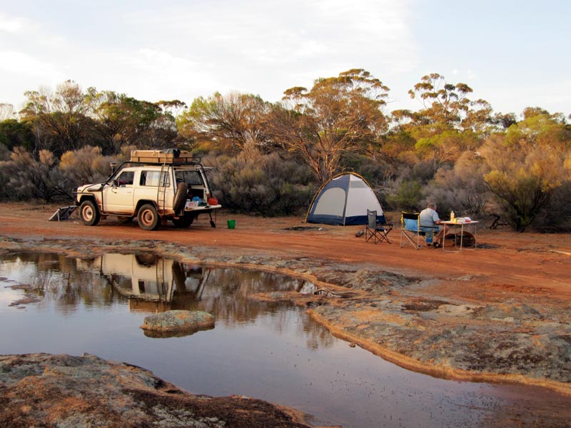

Here's a pic of an 85W folding panel setup in oz 2 years ago. For same/less money I could now buy a 140W folding panel.
I did buy an MPPT solar controller that I used last Oct/Nov when I went back. The MPPT does put more current back into the battery and has many more options for charging and voltage profile etc. Though given how cheap a 140W panel is back there, it's cheaper to just size up and use a PWM unit.
Also, an MPPT would make a lot more sense for a more 'permanent' setup where the panel is used day in and day out versus just a day or three while stationary in one camp spot. Anyhow, I have it now, so may as well use it :)

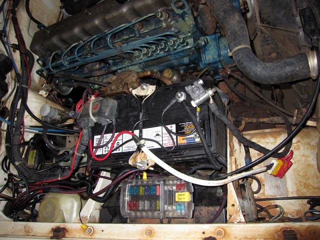

Here's from last year, keeping the beer etc in the fridge cool. The panel with the MPPT controller was regularly putting 6A or more into the aux battery - very nice!

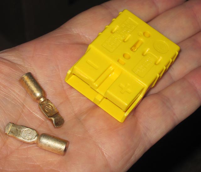

I also replaced the supplied connectors (they are common on all those panels and happen to be the same style as used by Battery Tender etc) with Anderson 50A connectors (SB50) - which I use on both of my batteries and other higher power battery items I take camping.
YELLOW is the colour you should use for 12V (the various colours have different keys that prevent say a 24V connector being plugged into a 12V device etc).
