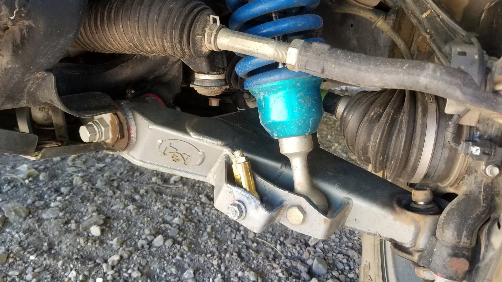

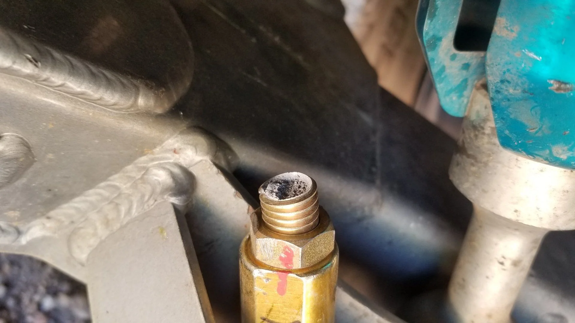

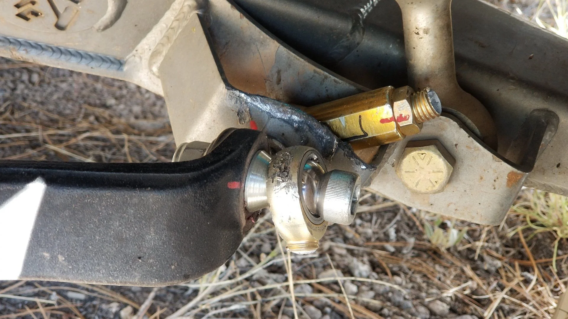

I had Walt's guys replaced the originally modified Toyota sway bar couplings with Total Chaos couplings, since the TC couplings had not be developed when I did my stage 2 with Walt. Unfortunately the driver side coupling failed as soon as I hit dirt and I had to remove the KDSS control arm and proceed without KDSS for the rest of the trip.

Well, that could be a factor, my 4-in-a-40 friend! The gravel roads from CO17 to the 1st camp spot were a bit washed out and I was moving at a good pace. Even though I had run the OEM couplings for years on harsh roads, I guess there is always a chance that I just hit it hard at the right angle etc.
Because it happened so quickly, I am leaning towards one of two reasons for the failure. Either there was a defect in the casting or the "non-OEM" set up is simply inferior. Walt at TAV is going to study the replacement couplings, now on order, over a few days and then I will have a chance to run the replacement linkage over several runs next week at the LCDC near FT Collins and then our HDC runs out of Ouray the following weekend.
That should reveal any further issues if the application is the cause.

There’s a few 200s running the Tundra links to reduce the deflection of the KDSS relocation bracket. I think they can even be flipped for non-KDSS relo applications. I’d be inclined to give this a try before letting Walt have another crack at it.
Thanks Brandon. I am not completely sure I understand what you are describing but will explore with Walt and let you know.
