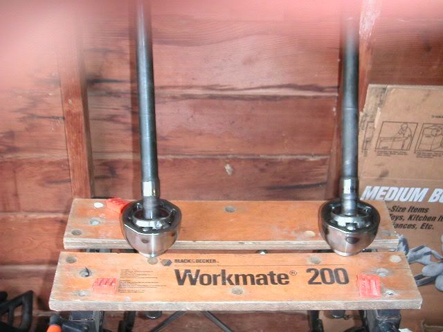

[quote author=tucker74 link=board=2;threadid=11875;start=msg109150#msg109150 date=1077573566]
Phil - I used the redline in the wheel bearings because a high temperature grease was specified. I had planned on using Amsoil GLC for the wheel bearings (but could not source - and parts guy suggested CV-2) and GHD for the birfield. I could not get the GHD - and the best my local AutoZone had was the M1 (I figured it would have to do - since they only make one type of grease). I would have gone w/ all Redline but I had only purchased the one tube (and it's really expensive). Hopefully it will perform well...
Tucker
[/quote]
The redline looks OK for wheel bearings but M1 for the birfield in my opinion is not good. Myself I'm going to use M1 in bearings which has a 500 degree rating ($5 per tube). The fact that it is synthetic is a bonus. I'll use moly grease from Tractor Supply at $1.60 a tube for the birfield. I really don't see a need for a high cost synthetic for this application. I do run M1 in engine, transmission, transfer and pumpkins.
[quote author=ppc link=board=2;threadid=11875;start=msg109191#msg109191 date=1077578176]
[/quote]
on the other hand, you're trying to save like $10-$20 on grease for a $400-$600 birfield in a job that takes 2 whole days to do........
Well its more like $40 but that isn't the reason. This stuff is used in $100,000+ pieces of machinery. Owners want protection not bling.
