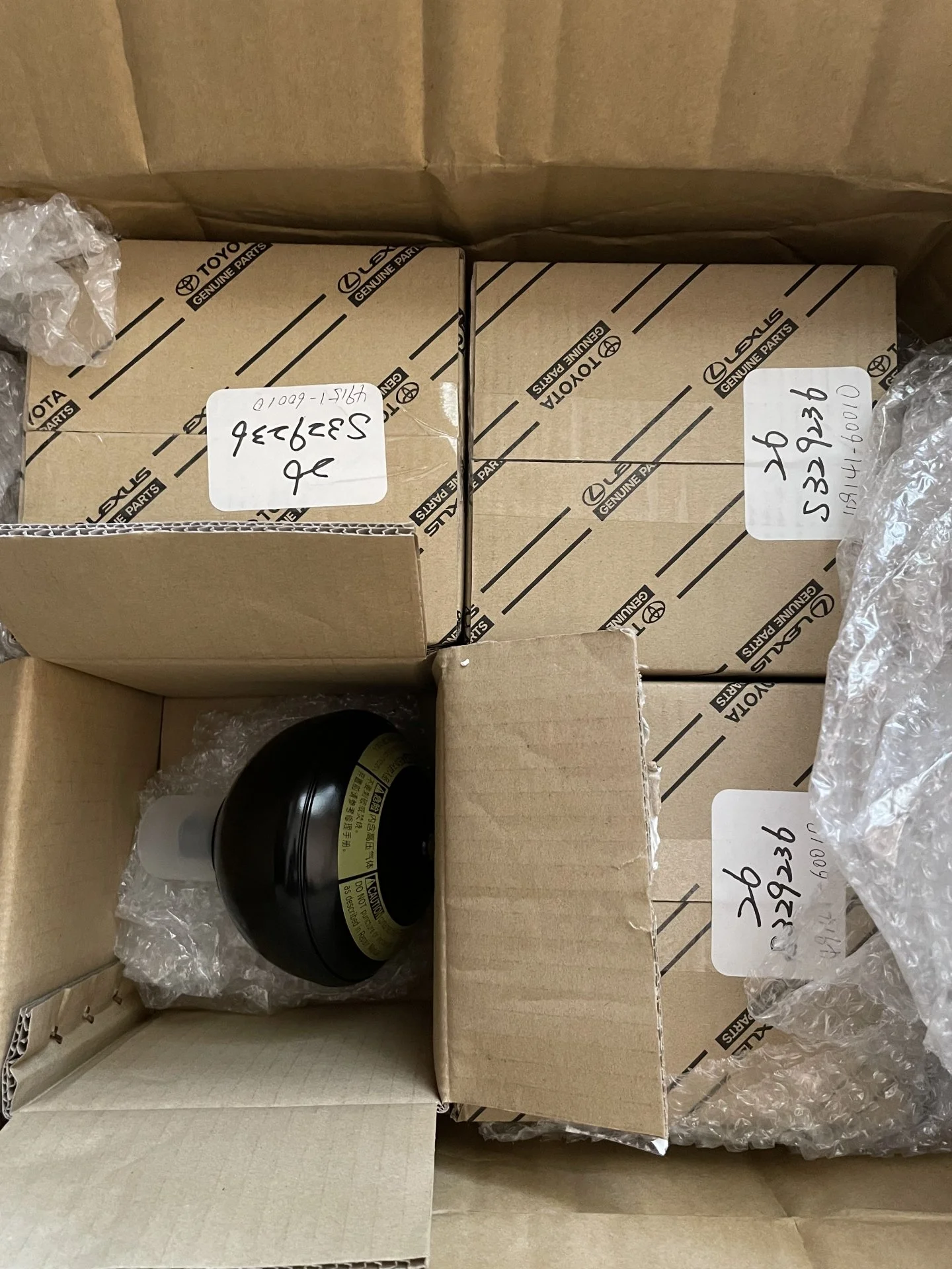

Hmm...that's weird. I just looked again and the current USD to JPY conversion puts them at $112 each for me. If you're going to replace all four globes, you will need two of 49141-60010 and two of 49151-60010.
(In my opinion, the term "kit" is misleading as there's only one part in each "kit.")
"Kit" is not a good word -- but each 'globe' usually does include an o-ring and and a back-up ring already fitted. These have separate Part Numbers. It would be unusual for 'globes' to arrived without these -- but suggest check before installing.
It is possible for just one (or even two) 'globes' to fail separately to others -- but it is difficult to discern failure of a single 'globe' and the reality is that if one has failed, the others are not far behind. Therefore suggest always replace the four 'globes' as a set, meaning 2 x 49141-60010 (Front) and 2 x 49151-60010 (Rear). It is normal for the 'globes' to be priced individually.

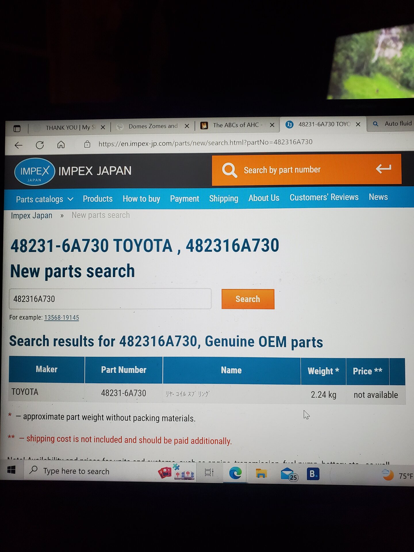

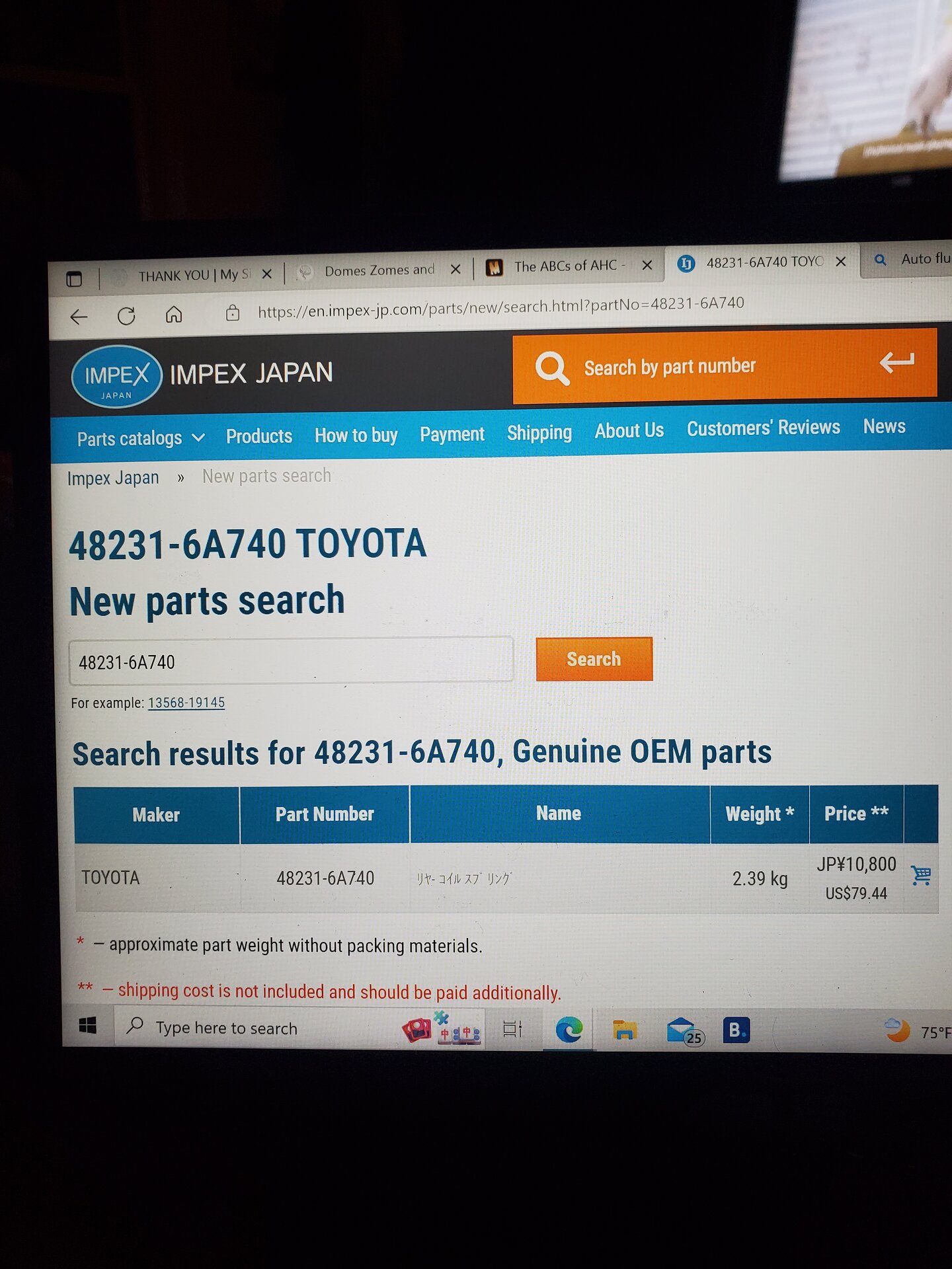

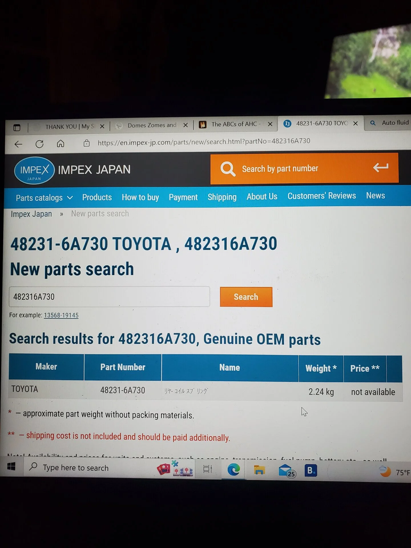

Thanks guys! So, I'm on the IMPEX site. I have 4 accumulators, a steering telescope motor and am looking into rear springs. On their site they only have 48231-6A740 available and not the other side which is 48231-6A730. Are they the same though, should it matter?? Also, on their site there are no fotos to confirm anything and for the Springs it has a Japanese description. Is this site legit? A rear strut for only $80?? How many of you have actually used it??

Thanks guys! So, I'm on the IMPEX site. I have 4 accumulators, a steering telescope motor and am looking into rear springs. On their site they only have 48231-6A740 available and not the other side which is 48231-6A730. Are they the same though, should it matter?? Also, on their site there are no fotos to confirm anything and for the Springs it has a Japanese description. Is this site legit? A rear strut for only $80?? How many of you have actually used it??View attachment 3189527View attachment 3189529

As for rear springs, check out the Kings...

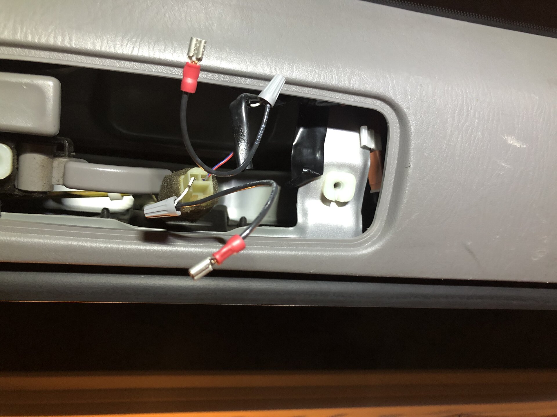

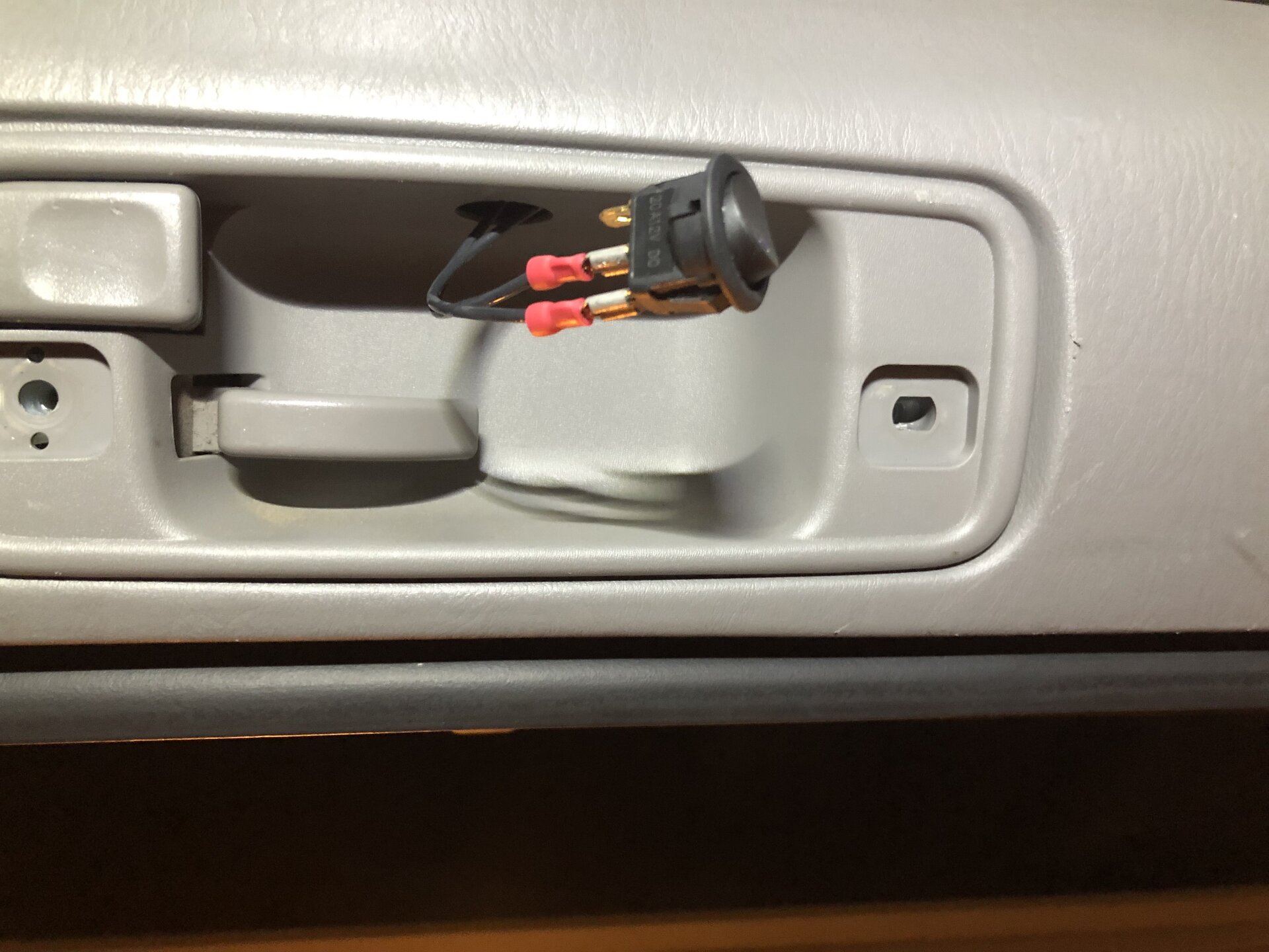

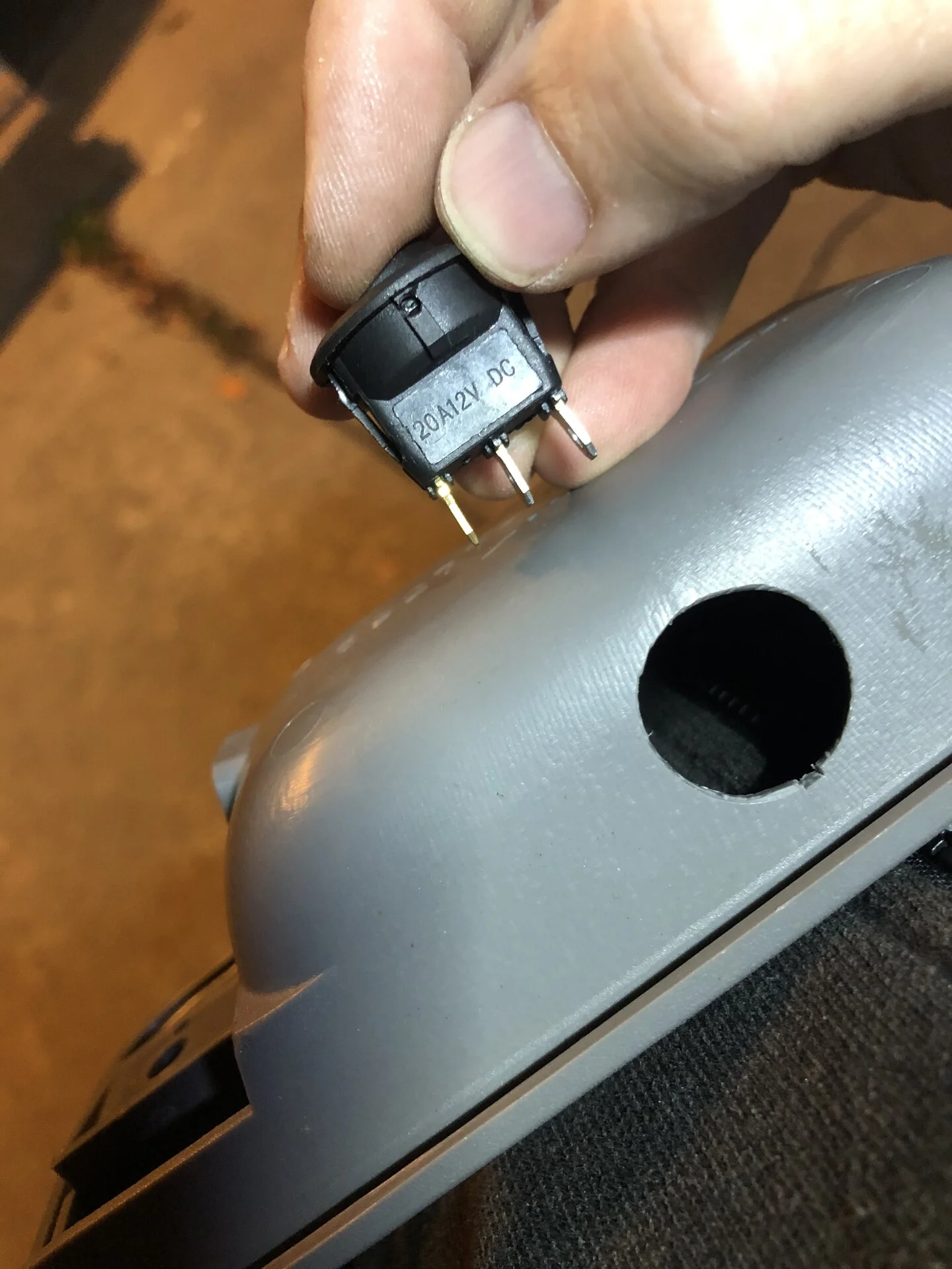

Here are some photos of the install (Admins, please let me know if there’s a better place to post this, as it’s a little off topic). I have a video I can send, too, which demonstrates the functioning of the switch and how it affects the AHC. If there’s enough interest, I’ll figure out how to upload to YouTube and post a link (please let me know if there’s a better way to share here.)
Hope this helps.
Hope this helps.
Awesome looks easy enough, I have an extra switch just like that sitting right here.
I just don't understand exactly what the switch does other than allow AHC to raise and lower with the rear hatch up when its on (or off?).
Also the wires in the first pic, what were they originally connected to? Did you terminate them yourself?
Thank you in advance for explaining it to me like I'm a moron, I'll go pop the handle on mine this afternoon and see if I can figure out how you got there.

I cut the black/white wire and added the black wire, spade terminals that I crimped myself, and wire nuts.
I haven't traced it out to figure out exactly what's happening but here's what I imagine is happening: You're interrupting the white/black wire from the sensor that tells the vehicle computer (ECU?) If the hatch is closed. You're putting two switches in series. If either switch is open, the circuit is open, telling the ECU that the hatch is closed. Both switches have to be closed to close the circuit, telling the ECU that the hatch is open. As you know, the AHC won't modulate if any doors are open. But if you open the circuit with the switch, you'll trick the ECU into thinking all the doors are closed, and AHC will function even with the hatch open.
(As always, anyone that knows better, please correct me.)

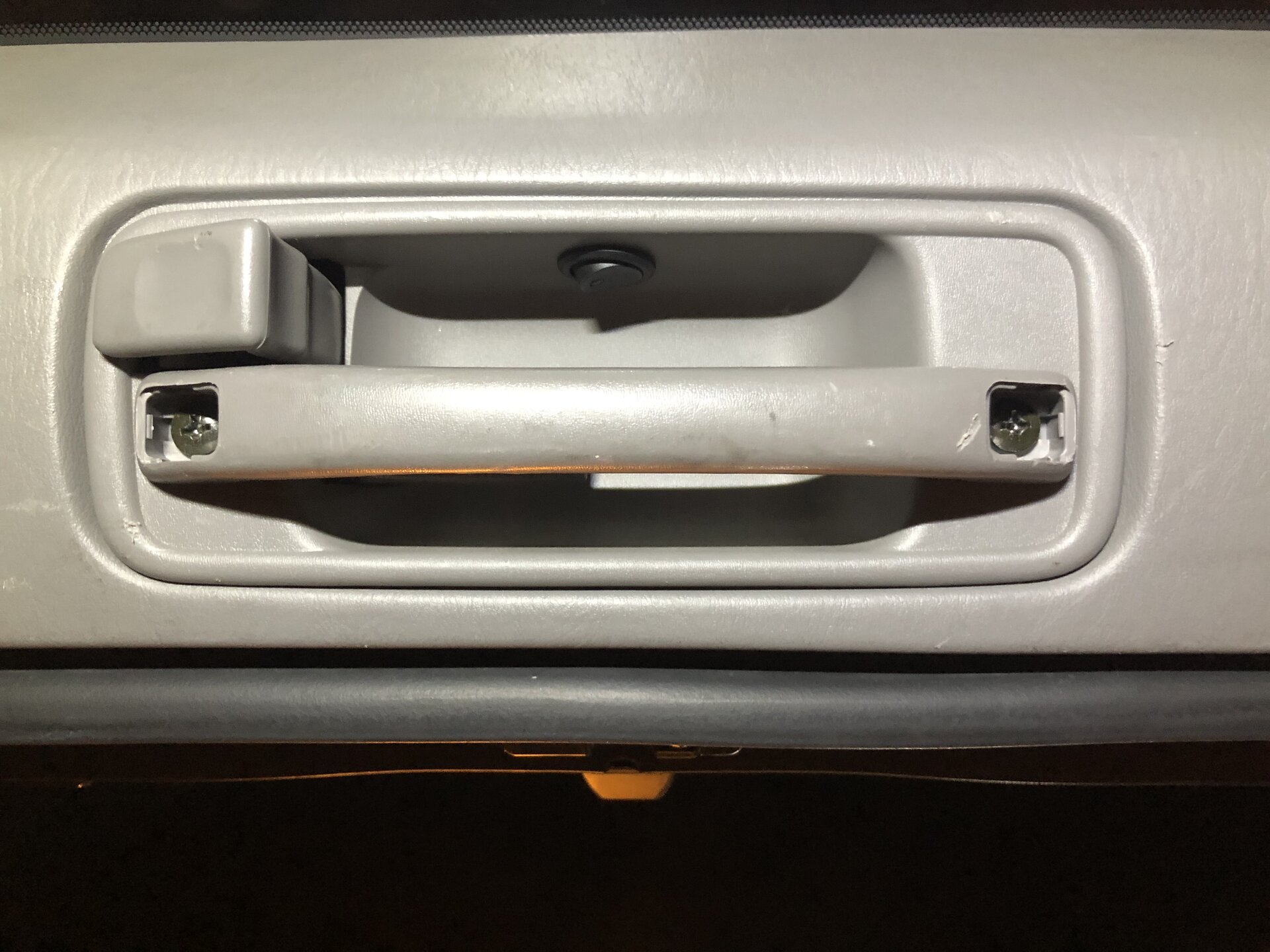

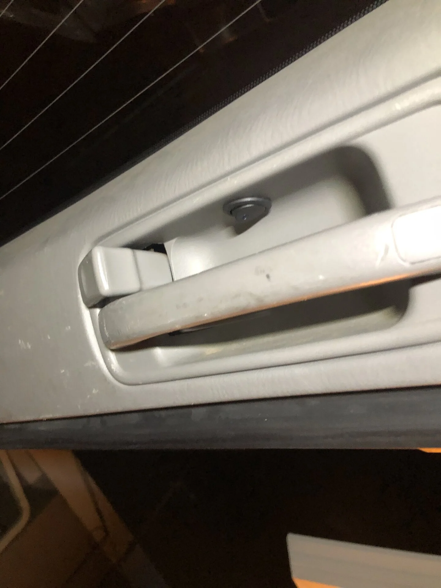

Well in a moment of inspiration I just disconnected the sensor. I had the switch and wires ready to install like yours, but I was thinking I'm probably just going to leave it open. So I tested the AHC with the sensor disconnected and I'm not getting any dashboard, lights or anything so...
I have already installed rear hatch lights so the door light is of no consequence.
Assuming I just want the truck to raise and lower with the rear hatch open can you think of a reason why I couldn't just leave it disconnected without a switch?

So disconnecting the sensor doesn't stop me from using my fob to lock and unlock the vehicle. It seems the only downside is if I have only the hatch open it thinks the vehicle is closed and I'm inside it so it auto locks.
I guess I have to decide what I find. More annoying, not being able to raise and lower the vehicle with the hatch open or the vehicle locking itself when I have to hatch open.
