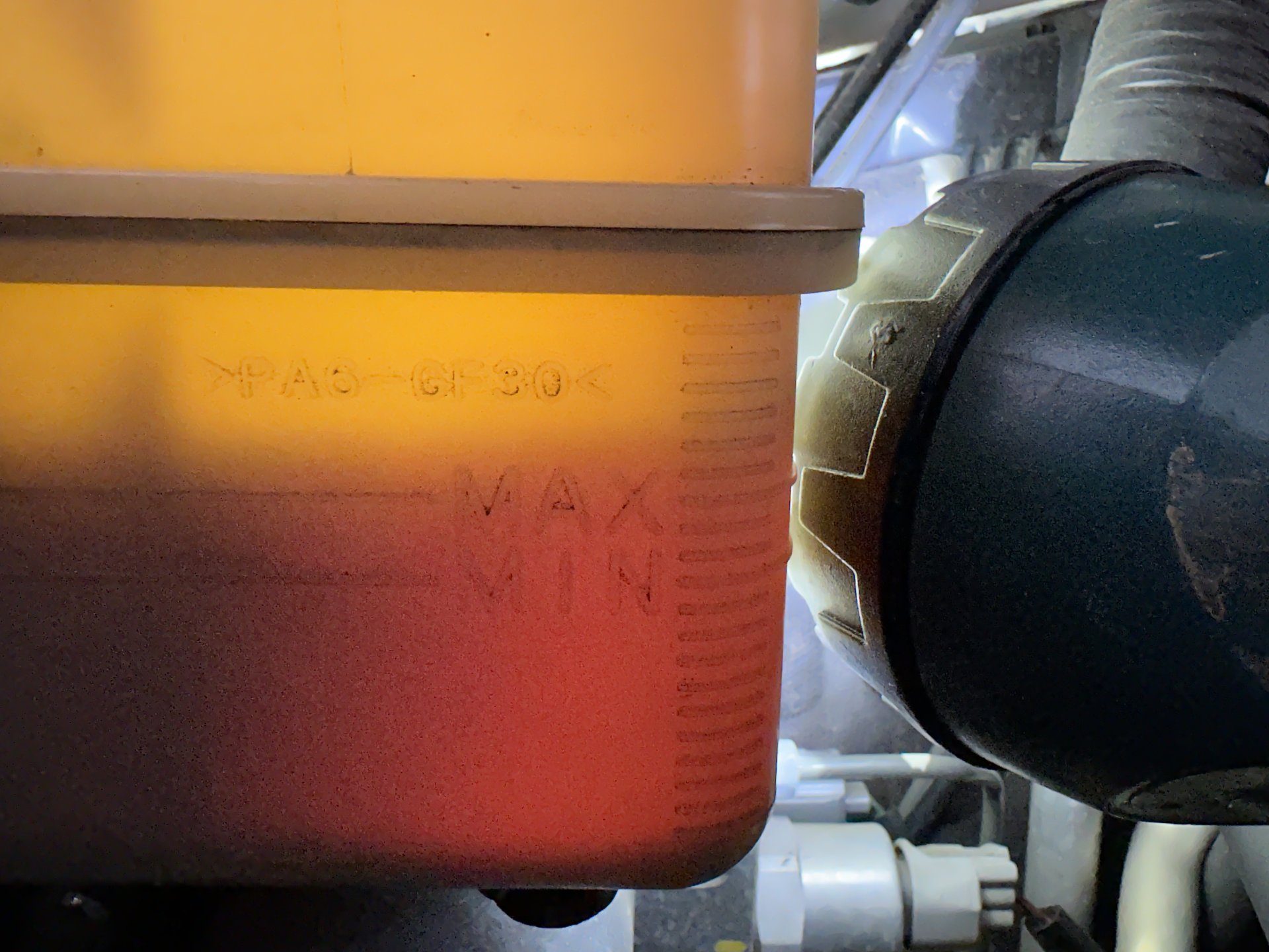

Front pressure: 8.9MPa
Rear pressure: 8.2MPa
Gradation change: 4(!)

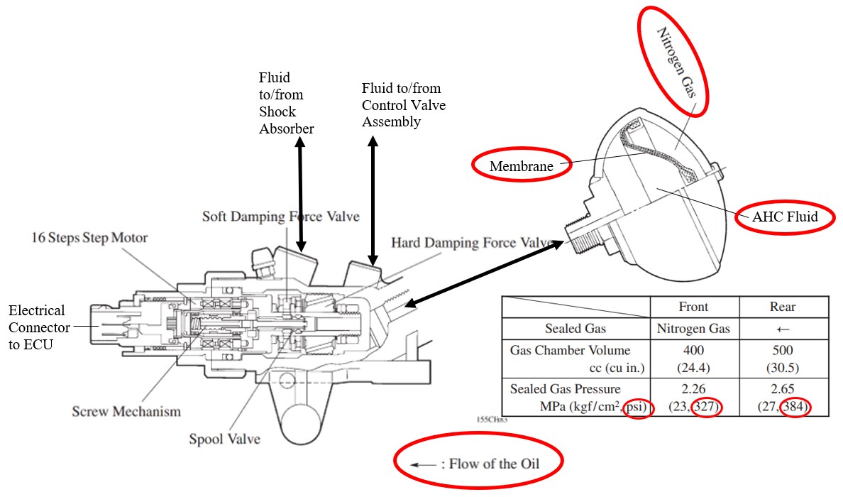

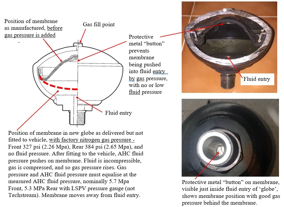

Suggest keep in mind that
AHC pressures – whether high or low or as FSM-specified – tell nothing about ‘globe’ condition. If the measurements were made correctly after height movements N > LO > N, then these numbers just indicate that excessive share of the vehicle weight is being carried by the AHC part of the suspension system, and, too low share of the vehicle weight is being carried by the mechanical part of the suspension system (meaning front torsion bars and rear coils springs), OR, it means that the after-market additions to the vehicle have made it very heavy.
Either way, correction requires front torsion bar adjustment (and/or possibly re-indexing), and, at least pre-loading the rear springs with spacers (and/or upgrading the rear springs such as with KING KTRS-79 replacements).
Excessive AHC pressures mean poor damping performance and less than best ride comfort. It also risks leakage at valves and seals, especially the internal seals in the ‘shock absorbers’.
Graduation change – the FSM-specified guidance for change in AHC Fluid level at the AHC Tank between “HI” height and “LO” height applies when the AHC pressures are within the FSM-specified ranges. Then ~14 graduations difference between "HI" and
"LO" means ‘globes are as new’. When the reading declines to 7 graduations it means ‘replace all globes' – because nitrogen pressure behind the membranes in the ‘globes’ is now too low for effective damping performance.
When AHC fluid pressures are excessive for whatever reason, then the change in graduations test is not comparable with FSM-specified guidance. For example, if AHC fluid pressures are high, then the nitrogen pressures behind the membranes in the ‘globes’ are less able to push fluid back to the tank than when AHC fluid pressures are correct. This will result in a lower reading than when AHC fluid pressures are within FSM-specified ranges.
The nitrogen pressures behind the membranes in the ‘globes’ cannot be measured directly because there is no valve fitting on the ‘globes’ to enable gas pressure to be measured. Instead, the FSM offers this indirect approach to indicate the overall condition of the four ‘globes’ taken together (meaning, using fluid displacement to indicate indirectly whether or not the remaining nitrogen gas pressure is adequate for reasonable damping performance and ride comfort).

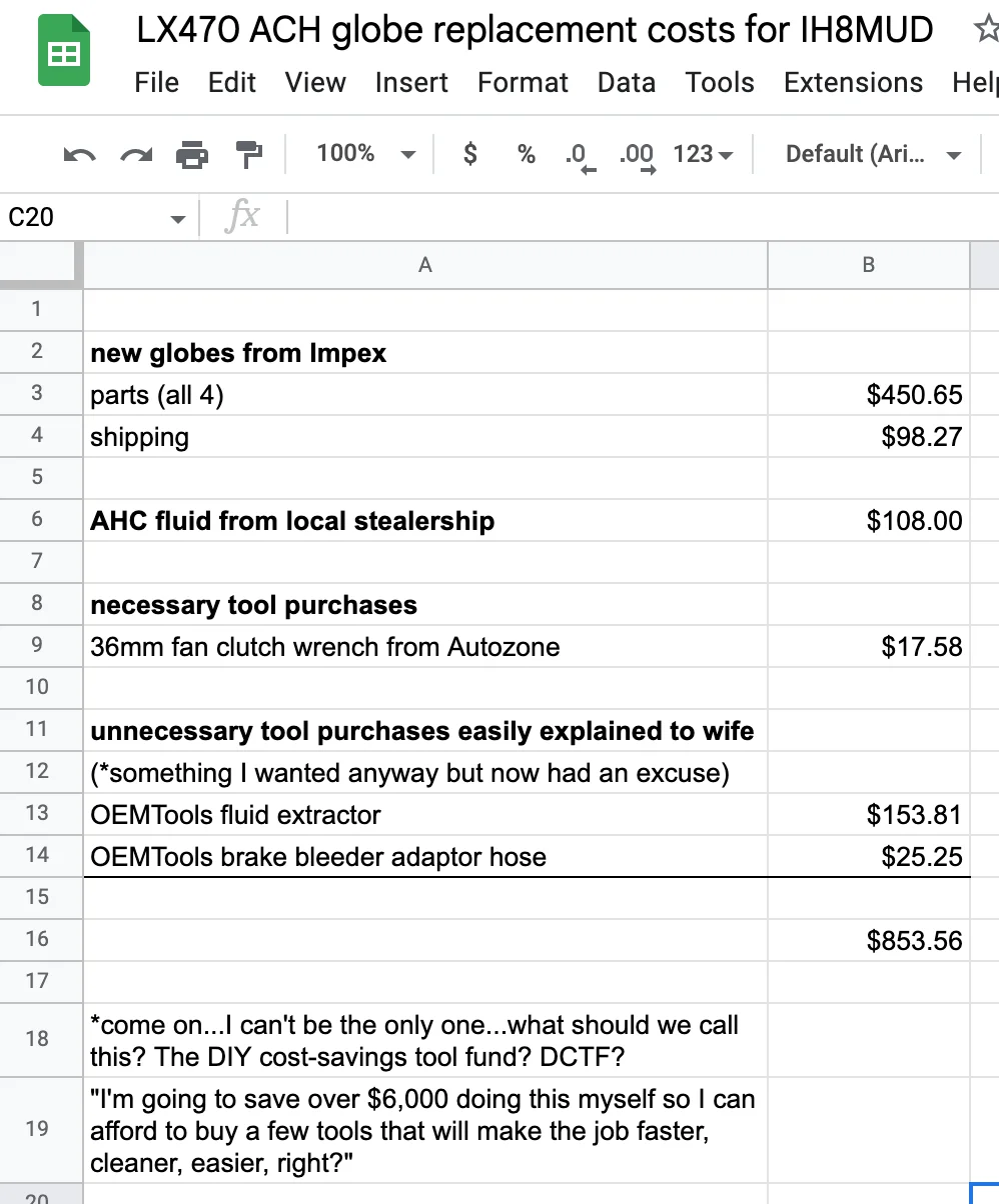

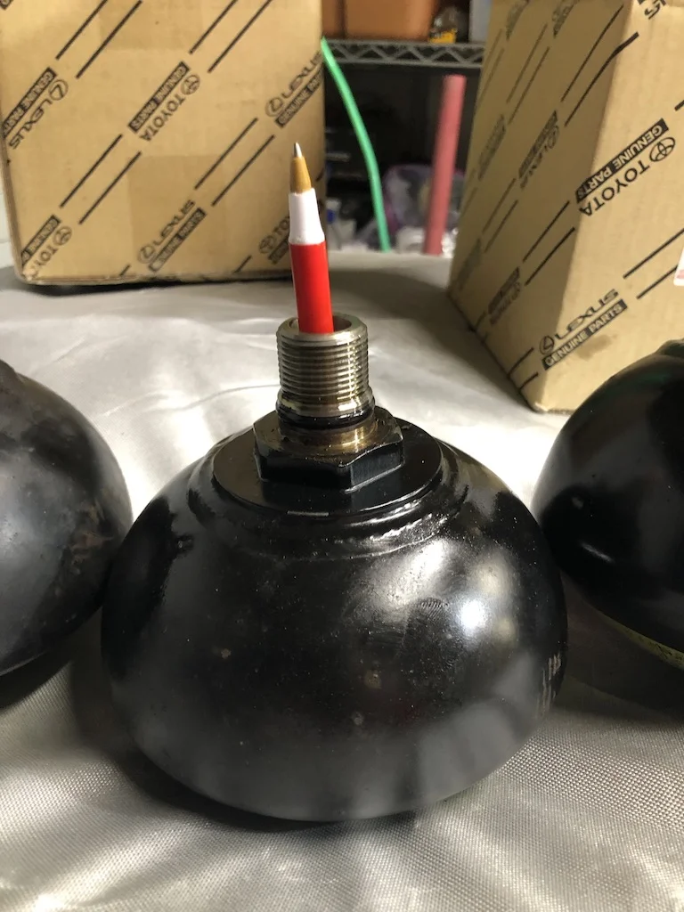

Update: Wow, friends...such an incredible difference!!
My accumulators arrived from IMPEX Japan on Wednesday so I spent a couple hours that night bleeding, draining, lubricating, torquing, removing, replacing, etc. and then I decided to work on the AHC. (jk) It was about a 2 hour job for me with the truck on the ground, no jack stands. Both of my front accumulators were completely failed and full of fluid...and the fluid collected was almost black.
I immediately took the truck for a spin and was blown away by the extreme difference. It felt like I was riding on a magic carpet. Upon return home I did a complete post-test-drive safety check, too, so don't worry about that.
This may sound reckless and immature but I'm going to share anyway: since Wednesday I've been hunting for worse and worse road conditions, potholes, speed bumps, speed humps, arrogant cyclists, etc. just to see how fast I can fly over them. Guys....I can't. believe. the difference. The truck was smooth before the front accumulators failed, but I don't remember it being this velvety.
Thank you to all of you who helped and encouraged.
Full cost details below.

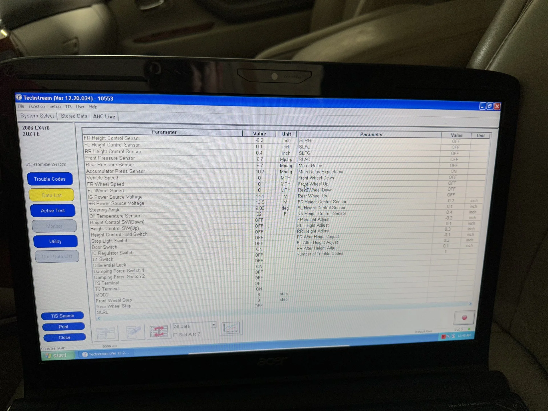

I will connect to techstream later today and share the new numbers in case anyone else is interested.
Thanks again, especially @LndXrsr, @PabloCruise, @mazdababy, and @IndroCruise for the extra detail
Walker
Hey, I'm looking to get new globes too. At IMPEX, when I key in the front globe part number and rear, it shows the price at only $120. Is that per globe, so do I need to add two of the front and rear? Or is it the whole rear kit that includes two globes??
That is the price for each globe. You'll need 2 of the front and 2 rears
Hmm...that's weird. I just looked again and the current USD to JPY conversion puts them at $112 each for me. If you're going to replace all four globes, you will need two of 49141-60010 and two of 49151-60010.
(In my opinion, the term "kit" is misleading as there's only one part in each "kit.")
