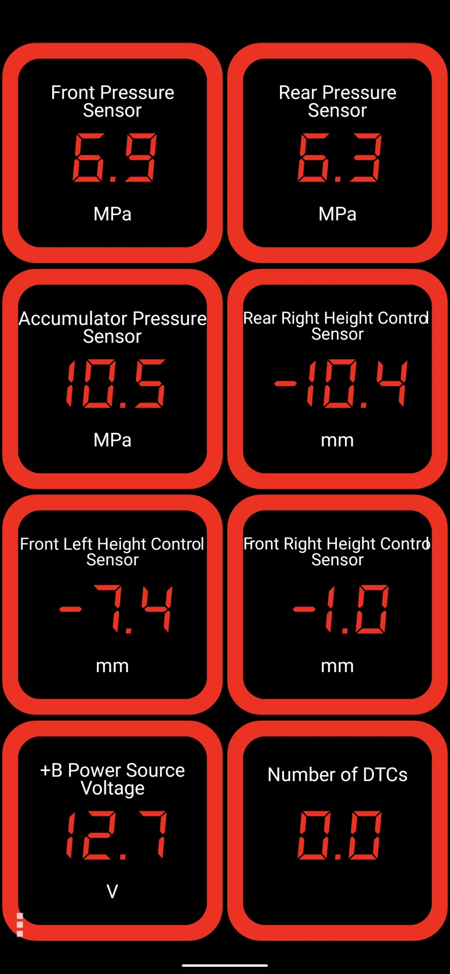

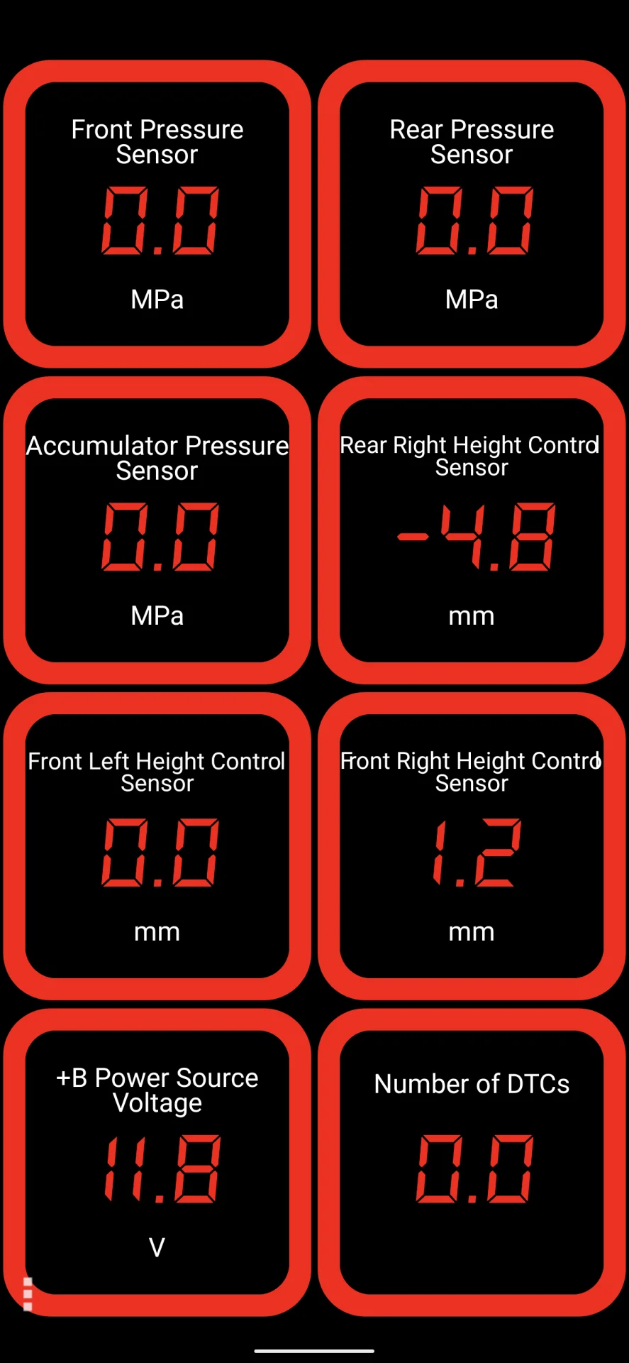

So I would just like to say that I am incredibly grateful for the work that you guys have done putting this guide together. I try to pay it back by documenting most of the work that I do in video and uploading it to YouTube.
I finally got all of the tools that I needed to do a full AHC service on my vehicle and using this guide it went pretty damn smoothly considering I basically had no idea what I was doing.
The only issue I ran into was when I bought this vehicle a year ago I spent a week grinding off every single speck of rust from the undercarriage and then I put two coats of POR15 on it. Well unbeknownst to me I coated The ride height sensors in a layer of POR15 making them almost impossible to adjust without breaking them. I still was able to get them relatively close.
One point of clarification, the ride height sensors are to be measured with the engine off and ignition on. Is that correct? Because the ride height sensors change when you cut the engine on.
Anyhow, after following the guide step by step, this was my final result.
The first image is The final result with the engine running after transitioning from low to neutral.
The second image was from when I adjusted the ride height sensors with the engine off and ignition on.
It should be noted that I have installed King springs in the rear, and I measured them but they are the same height.
All in all I'm very happy with the results and it is very true that you should not let perfection be the enemy of Good when it comes to this maintenance.

Great progress in getting a scanner working and getting on top of the AHC/TEMS systems!!
With no intention of raining on the party, here are some points to ponder:
  • Check that all physical tape measurements of heights and all Height Sensor readings and adjustments were made on level ground, such as a garage floor, not in the street or on a driveway? Do not want any fall built into the measurements – from side to side of the vehicle, nor front to rear of the vehicle,
  • Check that before Height Control Sensor adjustments were made, Front was ‘cross-levelled’ at “N” height setting with torsion bar adjusters per FSM with engine OFF (not running) to equalise Front heights as measured by tape measure and also to equalise torsion bar loads? Do not want any vehicle ‘lean’ built into the adjustments and causing fake measurements and confusion. [At the start, it does not matter what the measurements may be, just want them equalised at “N” height setting, set the ‘ride heights’ later with the Height Control Sensor adjusters, not the torsion bar adjusters],
  • Check Front and Rear hub-to-fender ‘ride heights’ with tape measure at “N” height setting? If necessary adjust by raising Front and Rear of vehicle by “Active Test” or with jacks etc to the desired ‘ride heights’ all round, usually hub-to-fender Front 19.75 inches (500 mm) and Rear 20.50 inches (520 mm). Then with Ignition ON, Engine OFF (not running), adjust Height Control Sensors as close as possible to zero using sliding bolt (and/or the very fiddly heim adjusters at Front). Do not want engine ON (running) at this time because do not want AHC system to try and compensate for adjustments while they are being made – futile and also dangerously unsafe.
  • Check that actual physical hub-to-fender tape measurements also were made at each wheel to match each set of readings of Height Control Sensors? The Sensor readings cannot be interpreted properly without the physical tape measurements at each wheel.
Some comments on the reported numbers ….
Set of readings: Ignition ON, Engine OFF (not running), after adjusting Height Control Sensors as close as possible to zero:
- 0.0 mm Front Left Height Control Sensor
- 1.2 mm Front Right Height Control Sensor
- 4.8 mm Rear Height Control Sensor
The above numbers are reasonable – all within the expected range of 5 mm of one another. Maybe the Rear Sensor could be raised slightly to take it nearer to zero. What were the hub-to-fender tape measurements at this time?
Set of readings: Ignition ON, Engine ON (running), after raise from “LO” to “N”:
- 7.4 mm Front Left Height Control Sensor
- 1.0 mm Front Right Height Control Sensor
-10.4 mm Rear Height Control Sensor
This set of numbers is strange – noticeable difference Left Front to Right Front, large differences Front to Rear. What were the hub-to-fender tape measurements at this time? Have they changed?
The overall negative numbers suggests that the “LO” to “N” raise is not quite completed. The vehicle is expected to raise to the close-to-zero settings of the Height Control Sensor adjusters as previously set at “N” height – that is exactly what the Active Height Control (AHC) system is designed to do.
There are a number of possibilities for this. If the bullet points at the start of this post all are checked and OK, then the next suspicions are the 16 years old Height Control Sensors, even though this is a relatively young, low mileage vehicle. For the reasons explained in earlier posts in this thread and elsewhere, absence of a Height Control Sensor DTC does not provide assurance that the Sensors are healthy.
If ride comfort is good, it probably is too early to worry too much – but it is worth monitoring over time, especially if ride comfort deteriorates and Height Sensor-related AHC ‘fail safe function’ is suspected.

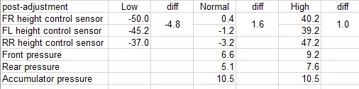

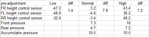

A few weeks ago when wheeling, I noticed that the front left seemed lower then the right front.
Finally last weekend I got my tape measure out and took measurements.
From bottom rim to bottom fender LF was 704mm, RF was 720mm.
Even though the difference is only 16mm, it was noticeable.
Out came my old laptop with XP with Techstream on it and read the heights and pressures:
So I cranked the TB and now the heights are pretty close. Checked TS again and it looks way better.
I have non-AHC springs in the rear for the additional load of long range tank, dual spare wheel carrier which accounts for the low pressure in the rear.

My 99.5% stock ride (2006 LX470) has been very bouncy lately. I think one YouTuber calls it the pogo-stick effect. Quite accurate. My rig still travels the full 4 inches between L and H, but there is no discernible difference between comfort and sport, and very poor damping.
I’ve used YotaMD’s 100 series AHC Cheat Sheet, and @Getco’s TechStream in 5 minutes (and interface cable) to determine the following abysmal numbers:
Front pressure: 8.9MPa
Rear pressure: 8.2MPa
Gradation change: 4(!)
