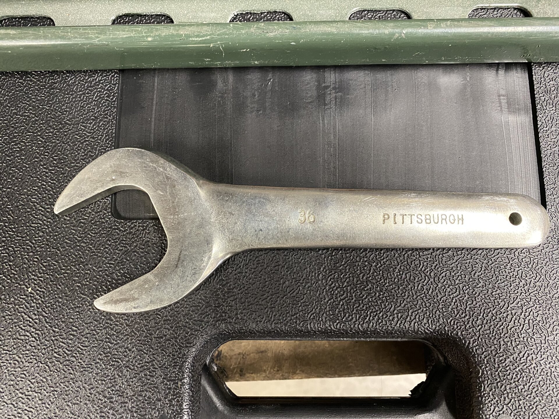

Harbor Freight has a forged open end wrench set. I use the 36mm form the kit. It's a very tight fit, so I tap wrench onto the globes nut for a very secure fit. Than for added leverage, I use a pipe on 36mm wrench handle. If only corners of globes nut round, you may still get a good hold on flats.
If nut now to round, which I've not seen happen (knock on wood).

forged 36mm. Forged is key, as they'll not flex or expand.
I was using the harbor freight wrench set, by the time I was done I could fit the 34mm wrench on it.
Eventually I was hammering on the wrench, then using a pipe for leverage.
I had it soaked in blaster for 2 days.

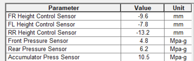

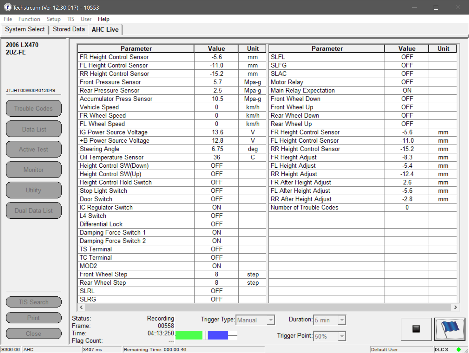

I already had 19.5" for my front measurements, so I went ahead and tried the Active Test. The car height did not change when I used the AHC up and down buttons. I did hear a noise from the front driver side when I pressed the up button, but I couldn't tell if it was the accumulator or globe. Here is a video:
Also of note, when I observed the AHC fluid reservoir, it was at the correct level at N, but it seemed that the fluid was a bit bubbly, that there was a bubbly SQUIRT sound from the tank at the very end of the adjustment, and the sound of the pump ended up with a slight high-pitched noise which I imagine is what it sounds like when people on here have talked about 'cavitation' sounds from the AHC pump.
Although clearly something is wrong, I do not have any DTCs, and the car is still making full L/N/H height adjustments, as well as a definite difference in softness/pushness/bounciness of the ride going from Sport -> Comfort+. Previously I had flushed the AHC fluid and the fluid from the accumulator had been a bit bubbly, but at the end of the bleed I was getting fresh fluid from all 5 bleed points (and 10+ gradations on the test, although I know now that testing that is premature). After the flush there was also a definite difference in the car being less rigid.
Anyways, after failing the Active Test, I went ahead and tried zeroing out the sensor heights anyway, and ran into another problem: rear sensor height is in the negative despite lowering adjustment all the way to the bottom of the slider.
I then drove around the block and when I parked again, the sensor heights had changed, and now the truck was sitting lower: 19.25 in the front, 19.75 in the back (see first image below).
Then I still went ahead and tried cycling through the height control just to see what pressures I would get, and those are below. (Goes N > L > N > H > N):

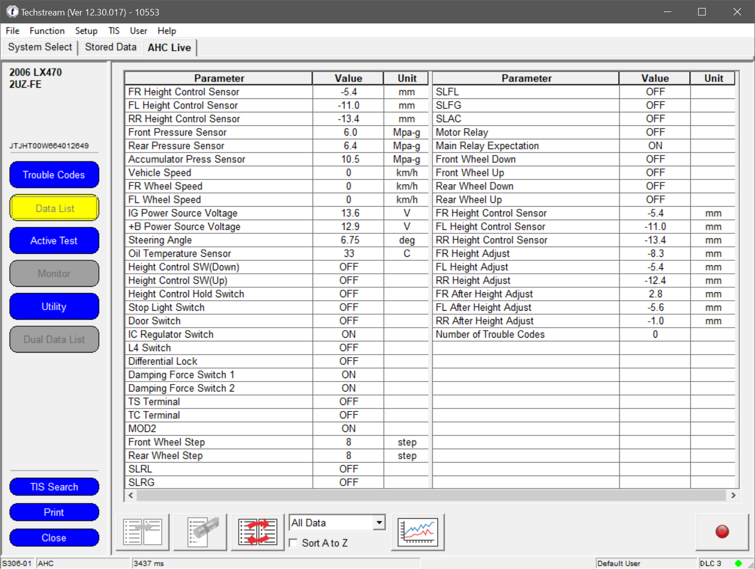

Now turn to Techstream read-outs after N > LO > N moves in your Post #362 and in your Post #378 -- the first point being that the AHC pressure readings -- Front, Rear and Height Control Accumulator -- all derive in a sequence from the single pressure sensor located next to the AHC Pump (with the Height Control Accumulator being re-charged and showing its pressure reading some time after the green AHC indicator light stops flashing). It is worth allowing up to 30 seconds for the Height Control Accumulator to re-charge after the green light stops flashing. The AHC Pump can be heard to stop when the re-charge is done.
The AHC pressure readings at N and HI are not reliable for any useful purpose -- because of the way the readings are overwritten and held in the ECU memory.
The pressure readings after the N > LO > N height movements are the only useful pressure data for diagnostic purposes and for comparison purposes with the FSM-specified pressures. All AHC adjustments are done only at N height.
If I have understood correctly which Techstream screenshots across your various Posts corresponds to N > LO > N movements, then the conclusion is that the Front and Rear AHC Pressures are considerably higher than the FSM-specified AHC Pressures, not out-of-this-world high, but high enough to require correction for optimum damping and ride comfort and for system longevity, and avoidance of leakage risks at ‘shock absorbers’ and elsewhere. These will need correction in due course -- and when the pressures are corrected, it would be appropriate to test the overall condition of ‘globes’ by observing the change in graduations from “HI” to “LO”, then record the details and the pressures as a base-line for future reference.
Moving to the Height Control Sensor readings ….

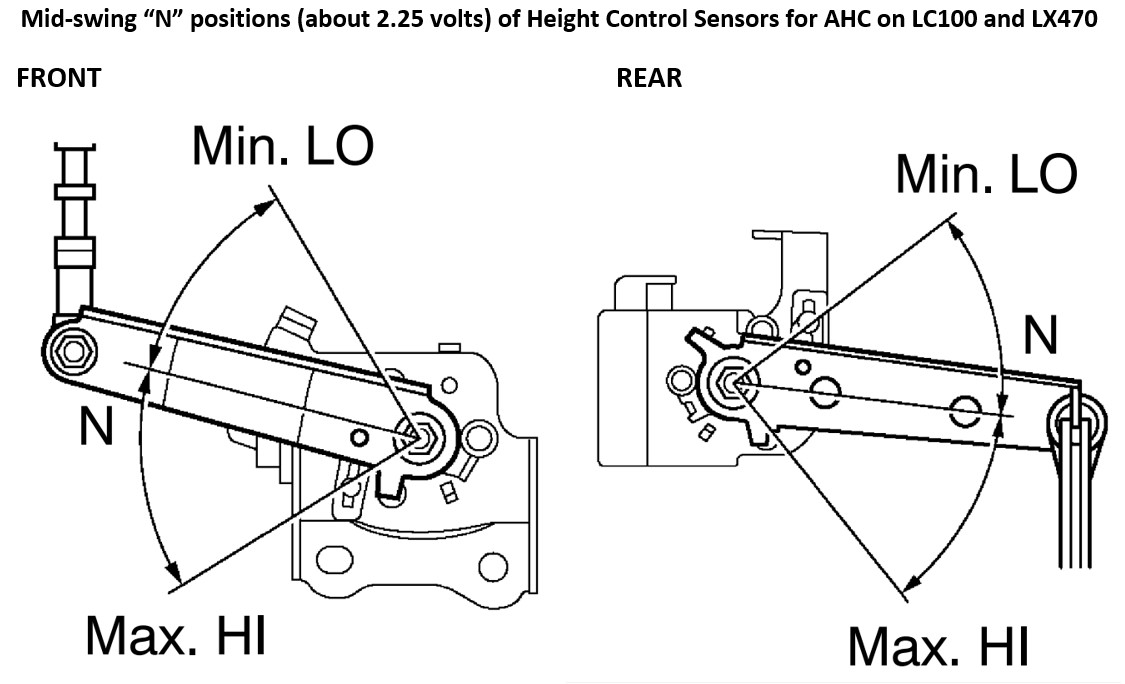

Unlike the pressure readings, the readings of healthy Height Control Sensors seen on Techstream are reliable in real time, changes are almost instantaneous, and reflect the position of the Height Control Sensor at any time, regardless of the sequence of height movements in the test process. This is kind of obvious because the Height Control Sensor sends signals to the Suspension ECU continuously in real time as the vehicle travels -- which enables the Active Height Control (AHC) to work as intended.

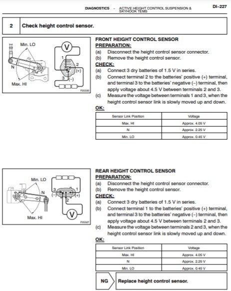

Per FSM, the Height Control Sensor readings with the vehicle at rest N are meant to be close to zero +/- 5 millimetres or +/- 0.2 inches AND the three Sensors should not be much different from each other.
Signals from the Height Control Sensor to the Suspension ECU actually are in voltages. For operational purposes, the ECU and/or Techstream translates these voltage signals to millimetres or inches according to whether Metric or US units were chosen somewhere in Techstream settings. We won’t get into a digression about this here -- except to say that the voltage changes are proportional to the height changes.
So inspect all of your Techstream screenshots at N height, noting the following:
1. There are no DTC’s -- but there are limitations to the meaning of the Height Control Sensor circuit DTC’s as discussed back at Post #368 this thread – and Height Control Sensor circuit health cannot be assumed by the absence of a DTC,
2. You have ensured that the vehicle level across the Front on a level surface.
3. Your Techstream Height Control Sensor readings at N are trying to tell you that LHS Front and RHS Front are not level – LHS Front is lower than RHS Front by about 5 millimetres– but you know that this physically is not true! The Rear Height Control Sensor says that it is lower than RHS Front by about 10 millimetres – but unless you can physically see that the vehicle is raked lower to the Rear (highly unusual), then that is not true either!
4. Even though the vehicle is relatively young (2006 LX470?), these differences in readings at N mean that the three Height Control Sensor circuits are suspicious (meaning Sensor plus Connector plus harness all the way back to the ECU, including the now-infamous BI1 connector block high up in the LHS rear quarter panel).
5. The Techstream Height Control Sensor readings at N also are all negative -- trying to tell you that the raise is not complete and the vehicle is low, that the raise has stopped before the vehicle arrived at the heights necessary for the FSM-specified height sensor readings to appear on Techstream – meaning, close to zero +/- 5 millimetres or +/- 0.2 inches. This further increases suspicions about the Height Control Sensor circuits,
6. You know that the vehicle is at the tape-measured physical hub-to-fender heights you require on a level surface – although the Rear Hub-to-Fender heights have not been quoted,
7. You know that the differences in the Height Control Sensor readings, while not good, are not large enough to cause the ECU to initiate the ‘fail safe function’ -- because the AHC and TEMS systems have not been prohibited and are still working.

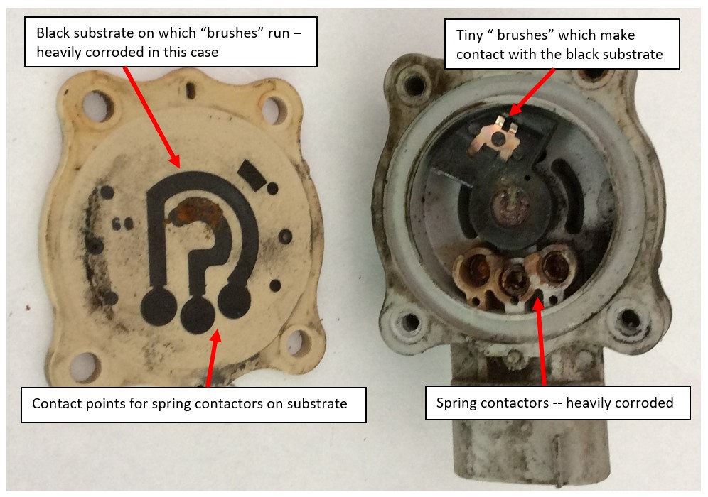

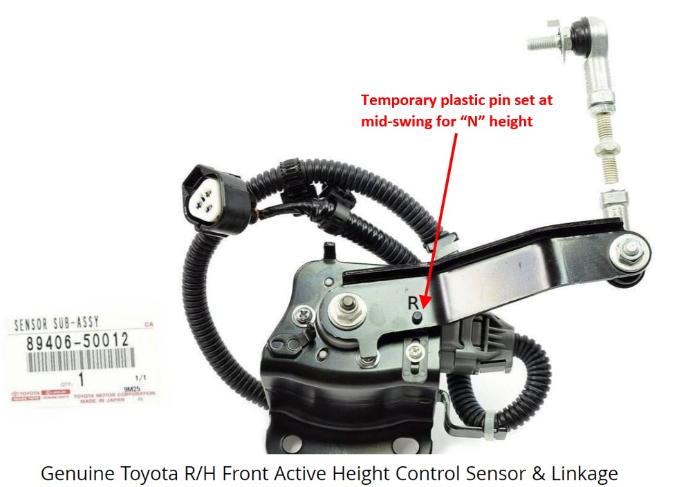

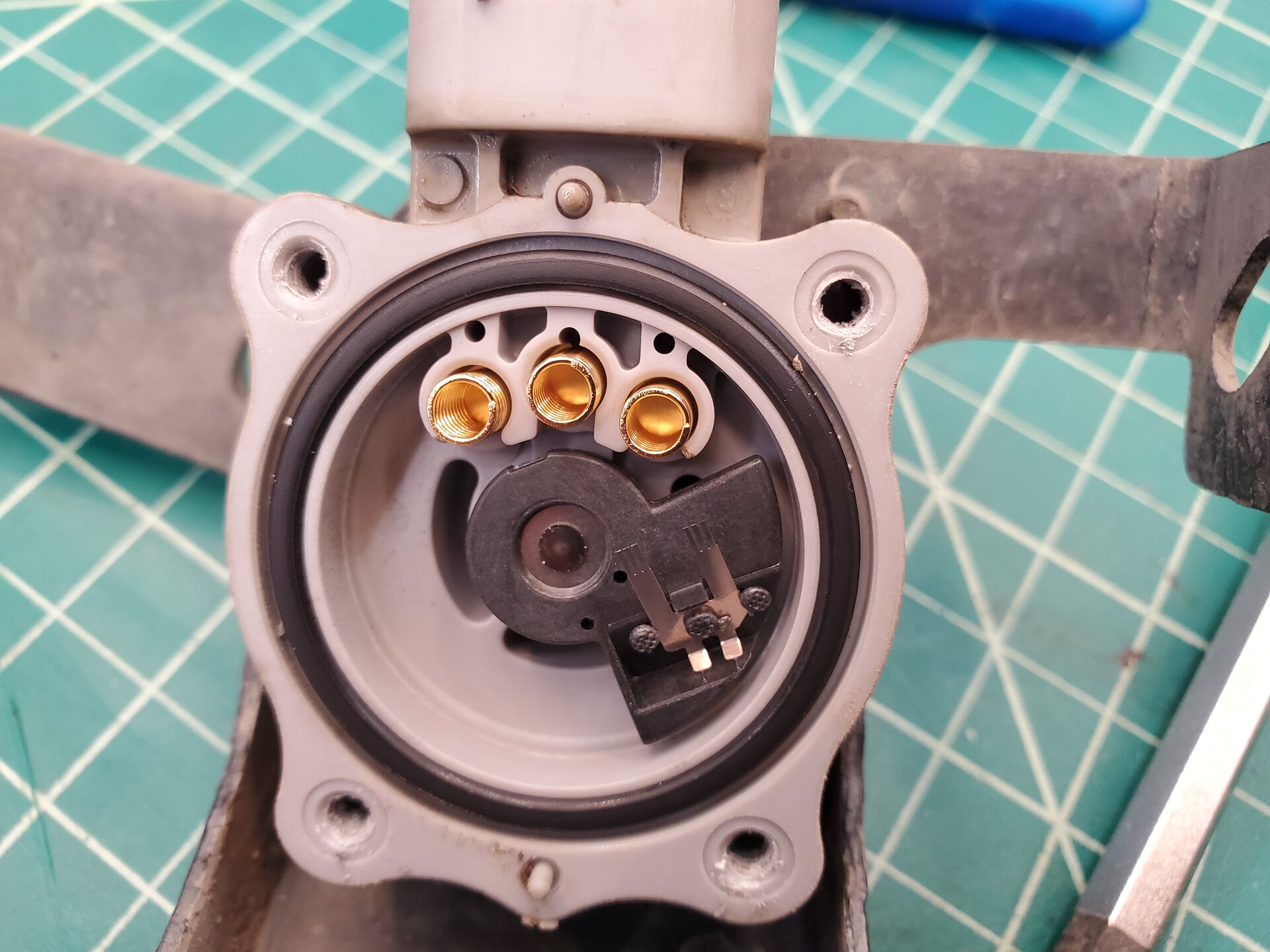

A. Replace the Rear Height Control Sensor – the behaviour of this circuit is highly suspicious,

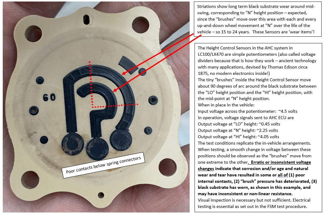

B. Remove and test both Front Height Control Sensors per FSM, re-install and adjust -- if these Sensors do not respond to cleaning and adjustment, replace (or for peace of mind replace anyway),
C. Use a multimeter and FSM Electrical Wiring Diagrams (EWD’s) to explore harness faults – including all the way back to the now-infamous BI1 connector block high up in the LHS rear quarter panel as highlighted by @suprarx7nut and @2001LC, as discussed in post #9 and other posts in this thread:

Q1: Would you recommend testing the rear height sensor in the same way as the front sensors? Are they substantially the same mechanism? -- In other words, is it a foregone conclusion that the sensor itself is bad? Just wondering before I spend $230 for a new OEM sensor off ebay.
Q2: When I remove all the sensors to test them, can I still drive the car (to move it around my driveway)?

These are the pressures (also consistent after each N>L>N cycle):
And these are the current fender measurements - the sides are within 1/8" of each other:

EDIT: AHC Active Test worked! I swear I did nothing different, but this time around I was able to raise and lower the front and back. I don't think this changes anything as far as my problem goes, however. I am going to attempt to zero out the height sensors one more time and report back.
EDIT 2: As suspected, after zeroing out the sensor heights and going through another N>L>N cycle, truck settles back in to the same set of numbers:
...And most importantly, the difference in fender heights from before zeroing out and after matches the change in sensor height values above. For example, rear fender height was at 20.5 inches (set using Active Test) prior to zeroing sensor height, and then became 20 inches after - roughly 13 mm. Same with the front, I adjusted the FR/FL to 19 9/16, and now both are sitting around 19 3/16, a difference of 3/8 = 9.5 mm. Therefore it seems the sensors are all reading accurately, but the truck refuses to go back to previously zeroed heights. What the heck can that mean??

Yes, it is reasonable to remove, disassemble, clean and test the Rear Height Control Sensor -- and both Front Height Control Sensors as well. The linkages are slightly different but they are all simple potentiometers as depicted below -- no modern electronics within these devices on LC100/LX470 -- and they all operate in the same way.
These Sensors are robust, very long-life components but they do wear out -- like brakes and the braking system, tyres, timing and other belts, steering rack, mechanical suspension parts, bushes, etc, etc, etc -- and your Sensors already are 17 years old (although quite low mileage).
You have been working on the Sensors so is it fair to assume that the linkages on all three Sensors are in good visual condition -- not detached, broken or impaired by corrosion?
Inside the Sensors, the internal carbon track develops ‘wear zones’ (particularly in the area corresponding to N height because there is constant movement there), the contact with the carbon track by the tiny brushes slowly weakens, moisture ingress leads to corrosion of the internal contacts which look like small coil springs causing increased resistance or even open circuits and/or ‘tracking’ due to moisture leads to reduced resistance or even short circuits. Any of these will affect the output voltage from the Sensor which then results in incorrect voltage signals to the ECU -- see correct voltages far below. In turn, this may result incorrect directions by the ECU to the AHC Pump and/or the Levelling Valves in the Control Valve Assembly, causing strange behaviors by the vehicle at the Front or Rear or both.
This response is caused by the actual voltage signal the ECU receives from the Sensor. The ECU then operates the AHC Pump to increase height (Front and/or Rear), or, opens the relevant (Front and/or Rear) Levelling Valve to release AHC Fluid to the AHC Tank and reduce height.
The point is that the ECU attempts to cause the Front and Rear to raise or lower until the correct voltage signal is received for N height (or LO or HI height if those are selected). This is the basic underlying principle of this circuit.
The response can be erratic when the ECU receives widely different signals from each Sensor circuit, outside the acceptable tolerance of the ECU. The ECU may then cause the Front and Rear of the vehicle to do different and unexpected things -- such as the behaviours and differences in readings you are observing – because the Suspension ECU is unable to resolve conflicting signals from the Height Control Sensors.
The overall Height Control Sensor circuit must be considered -- more about that later – but start first with the Sensors themselves ….
Disassembly and internal inspection of each Sensor is a good idea – but frankly, inspection by eye alone is insufficient. Actual electrical testing per FSM is important to see whether there actually is a smooth gradation in voltage output through the range of the Sensor movement (or there is an alternative method which looks for a smooth gradation in resistance -- High as a kite, hard as a rock! (Yes AHC again...) - https://forum.ih8mud.com/threads/high-as-a-kite-hard-as-a-rock-yes-ahc-again.1119157/#post-12149330 ).

Here are a few pics:

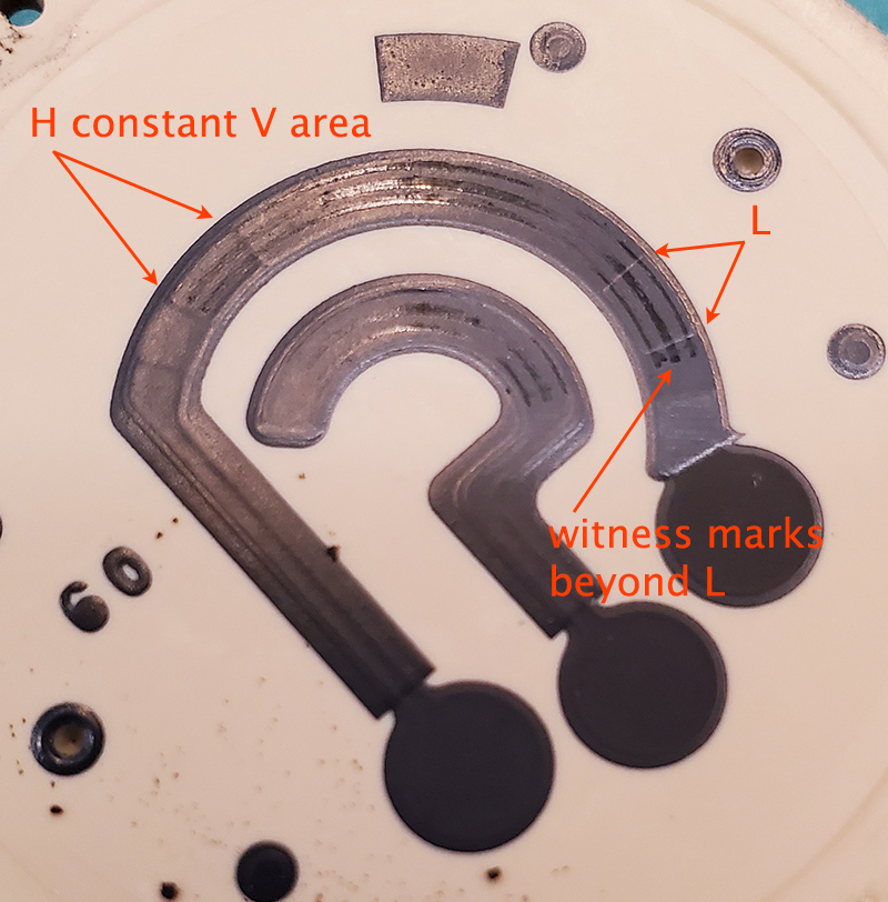

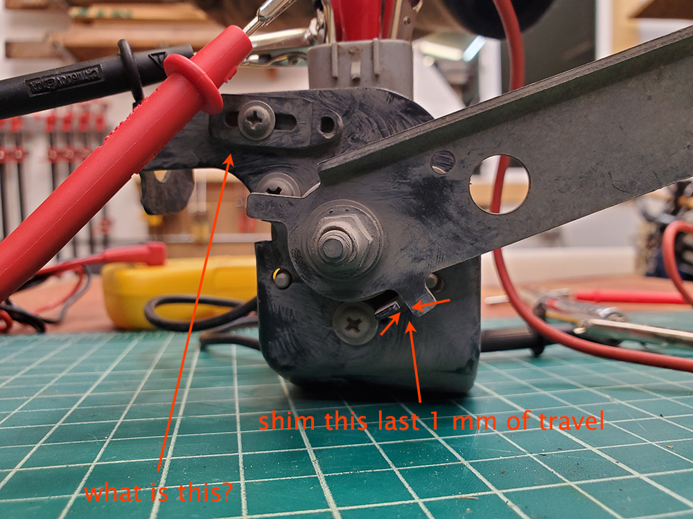

Alright, here is the rear sensor - immaculate on the inside. The connector was also clean. Any of the crud on the face is just dirt that fell in when I separated the cover.
As for proper testing, I rigged up 3 fresh AA batteries using a bunch of alligator clips and neodymium magnets. The series voltage was something like 4.7v, so it's reasonable I think that I was getting 4.18V at H.
Since the sensor is off the truck I didn't know where N would approximate in the travel of the sensor arm, but I don't think that matters, because voltage change was smooth throughout the entire travel from H to L. What I found was that there is a little bit of travel area in which the voltage at H is constant at ~4.15V. Similarly, there is an area on the L side where voltage is constant at around 0.45V. However, what I also found was that at the very end of the travel, the voltage drops further from a constant of 0.45V to around 0.28V. The following two photos are the arm at the beginning of the 0.45V area, and the end of the 0.45V area. In other words, there is about 1mm of further travel left where the sensor output drops below specified the L voltage.
Looking back at the photo of the substrate, it seems to me that the raised trapezoidal sections that begin outside the 90 degree marks (that you've annotated with a dotted red line on your picture) are these same areas of constant voltage, and, if we look at my picture, it appears that my brushes travel beyond the lower raised trapezoid - I'm fairly sure this is why voltage is dropping further than the 0.45V specified on the L end. Is this salient? It might be. I'm going to try to shim the 'stop tab' with maybe 1.5 mm of material, so that the brushes do not travel beyond the constant voltage area.
In case I wasn't being clear:
Without really any clear rationale, I think it's conceivable that when the sensor circuit receives a voltage X volts outside spec upon going to L
(in this case 0.45V - 0.28V = 0.17V), it would then do some kind of algorithmic/logical operation that would result in it targetting the wrong voltage when it returns to N - something like N volts minus X. Probably much more complex than that, but this really might be AN answer if not THE answer.
Good to see you getting involved in the detail!! In your pictures of a Sensor, the connector and the swing arm uniquely identify this as the Rear Height Control Sensor.
As a starter and getting into even more detail, I notice in the second picture in your Post #397 the question with an arrow “What is this?”
So let me start with that -- because it also helps explain some of the issues you are investigating.
I will use RH Front Height Control Sensor pictures as illustrations because I have these on file and I don’t have a helpful picture of a Rear Sensor. The chassis mounting, the socket to receive the harness connector and the swing arm and linkage obviously are different on the Front Sensors compared to the Rear Sensor but the operating principles as simple voltage dividers (potentiometers) are the same.

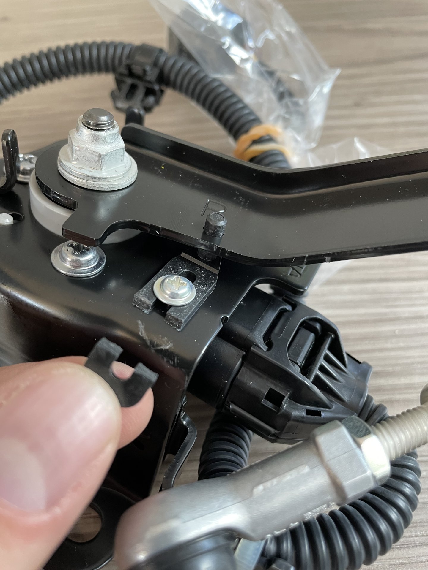

The manufacturer -- most likely stamped as AISIN or TOYOTA on an OEM Sensor -- uses a tiny plastic slider and temporary plastic post at the factory to set the mid-point of the swing of the Sensor arm to give a signal of about 2.25 volts, corresponding to the N height setting, as designated in the FSM.
Why does this exist?
As can be imagined when looking inside the Sensor, there is likely to be some variation in manufacturing of the "carbon track" and also in the positioning of the sliding brushes and other parts. One Sensor can be slightly different from another -- and readings are sensitive within fractions of a volt.
This arrangement allows the Sensor manufacturer to test and position the Sensor arm at the correct voltage of about 2.25 volts (or the correct equivalent resistance) for N height at or very close to mid-swing of the Sensor as it moves through its arc.
This arrangement aids quick assembly, within seconds on a production line, to match the correct Front and Rear ‘ride heights’ of the vehicle at N height setting, with minimal, if any, subsequent adjustment.
When the Sensor is installed and operating on the vehicle a little further down the production line, the temporary plastic post described will break and become redundant and of no further use.
If the plastic slider to which the plastic post was attached remains in place, the ‘factory set’ position of the now-missing plastic post, correct for N height on a stock vehicle, can be identified. This can be considered when adjusting Sensors, long after the vehicle has left the factory. This situation also can be quite useful when replacing Height Control Sensors with new units with the temporary plastic post still in place, as seen in one of the above pictures.
If plastic slider has moved, as in your case, it may be a little more difficult but the approximate mid-swing position can still be worked out by examining the above pictures. The diagrams in relevant section of the FSM “DIAGNOSTICS” section -- extract attached -- also help. (These can be expected to be accurate in the Japanese manner, not haphazard sketches).
I would also suggest that, given the mid-swing position, both the LO and HI positions also can be estimated, about 45 degrees either way from the N position.
With all of that in mind, what actual voltage are you measuring with your apparatus at N (mid-swing) position?
Your results for the actual measured voltages at the LO and HI positions seem very close to the FSM-specified values. You report that the voltage transitions are smooth from LO to HI.
This is leading to a conclusion that at least your Rear Height Control Sensor is healthy at the moment. Unless tests of the Front Height Control Sensors give adverse results, the next conclusion would be that it is time to check the harnesses for broken wires, especially in the regions of connectors and junction blocks.
It is much less than rigorous, but given the multiple reports by others of weaknesses at or near the BI1 connector as mentioned in my previous posts, one thought might be to use the multimeter to read the voltage coming from the harness (Ignition ON, Engine OFF -- while the Rear Sensor is removed) and to reach up to the BI1 connector block, move it around to see whether the voltage changes at the multimeter, which could suggest broken wire(s). Obviously if doubt exists, proper testing is necessary. Inspection of the FSM Electrical Wiring Diagrams (EWD’s) will reveal other connectors right through to the Suspension Electronic Control Unit which may be problematic – it is just that BI1 connector has been topical in recent times.
If your hypothesis of “some kind of algorithmic/logical operation” holds, then that would translate to me as a defective Suspension ECU! Possible but unusual -- hopefully not the case on your vehicle!

One odd thing is that it seems that the diagram of the sensors you've provided shows the limits of clockwise travel as HI and anticlockwise as LO... but this was opposite of what I observed. I connected the batteries correctly - positive end to pin 1, negative to pin 3, and the multimeter was connected correctly as well, testing between pins 2 and 3. Besides, if the multimeter was connected reversed it would just show negative voltage, not inverse voltage. (Does a potentiometer work in reverse polarity?)
Edit:
Exactly on spec when hole for plastic peg is directly above it's holder in the slider - which means the slider is still in the place where it was set at the factory.
Shimming with a bit of a windshield wiper insert:
Alright, FL sensor had a very large dead area in the >N region. I opened it up and it appeared that the brushes were no longer contacting... so I bent them back up a bit. After putting the cover back on, I think they are functional, with smooth voltage change throughout the range, except that much like my rear sensor, the brushes travel beyond the known 'H' area and go from spec 4.05v to 4.22v at the limit. I wonder if this matters. Suspect my fix is only temporary, but will check FR sensor and then put them all back on and see what happens.
