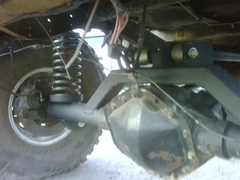

My 40 is done ...and by that I mean the suspension... and the best of it, it works!
I put front fox air shocks and rear coil springs in the back, front detroit locker in the D60 and rear locked 14 bolt...
When I drove her, she's a different truck.
She's more than what I expected.
My combo of the SM465 and a twin stick NP205 w/ front dig... it works beatiful, at least for me...
the 40 it's great...:grinpimp:
She's a heavy and ugly looking girl but I love her:hillbilly:
it has been an 11 yrs love affair!

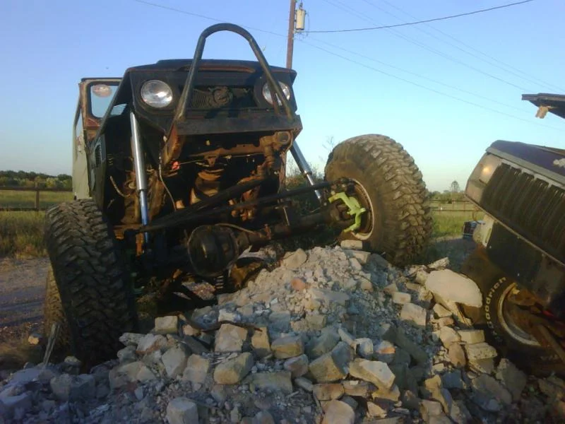

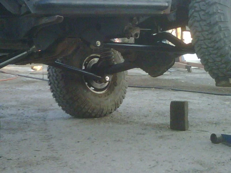

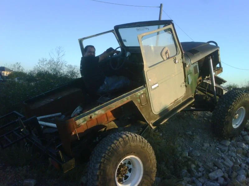

opposite side, Front and back
Flexed nice w/ front long arms, they might be too long but I want to try her and see the behavior:hillbilly:

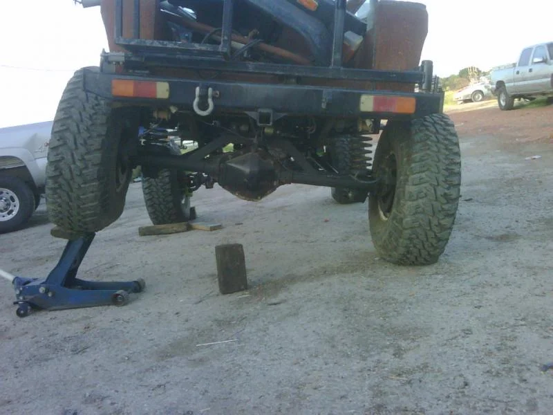

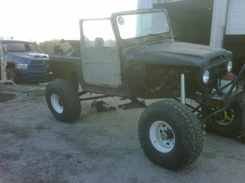

Track bars and Rear springs

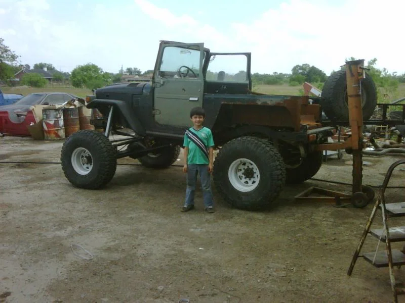

Happy truck owners

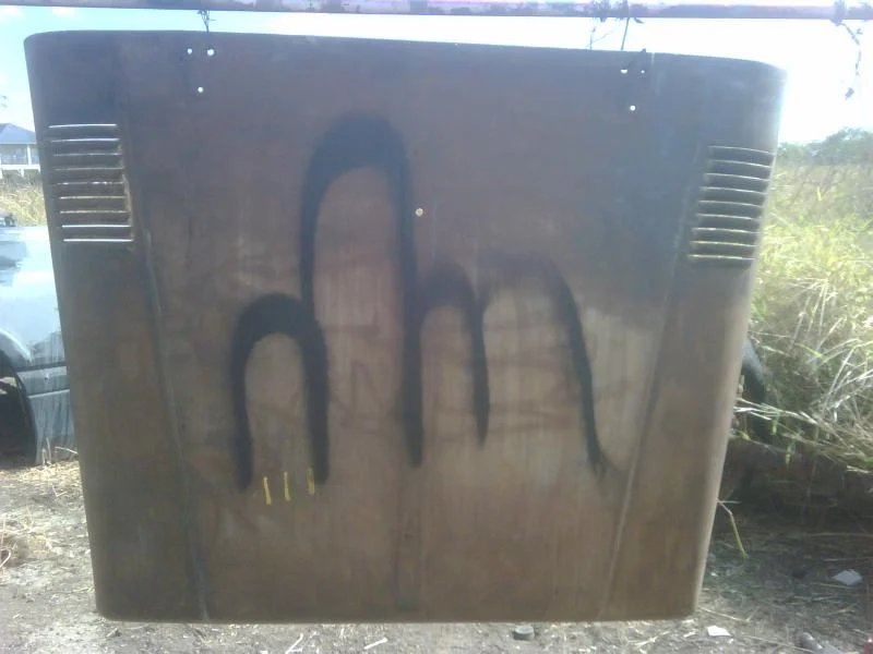

I am undecided on this here hood:hillbilly:
