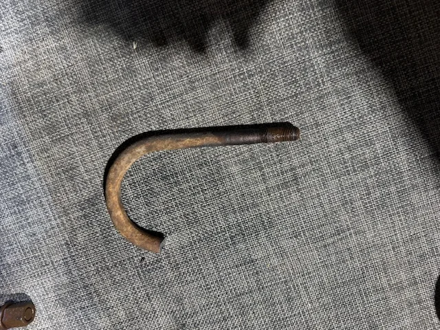

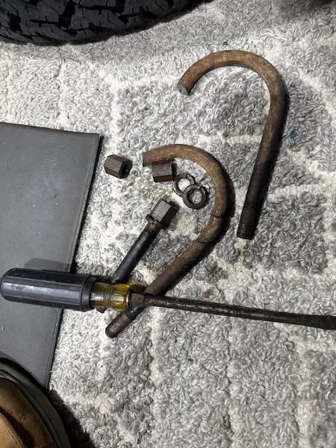

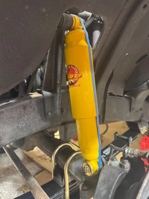

It’s a slow going project but I am getting there. One corner per day. For me, it’s hard to get into the positions under the truck and then discover my 17mm socket is over there and out of reach. That’s All on me, the job is quite easy to do and everything is dropping into place. I have the right rear side to remove and finish then add the steering stabilizer. Got a call into @orangefj45 on the stabilizer… that man is devoted
The quality of all of the parts is quite remarkable an ease of install from 1-5 is a 2…fairly easy and everything is there. if you’re younger and stronger…thank God for extra floor jacks. The rear u-bolts have proven to be too much for my 175psi compressor and 1/2” impact gun. I run it at 95psi but cranked it up for these….nothing. Cut-off wheels worked

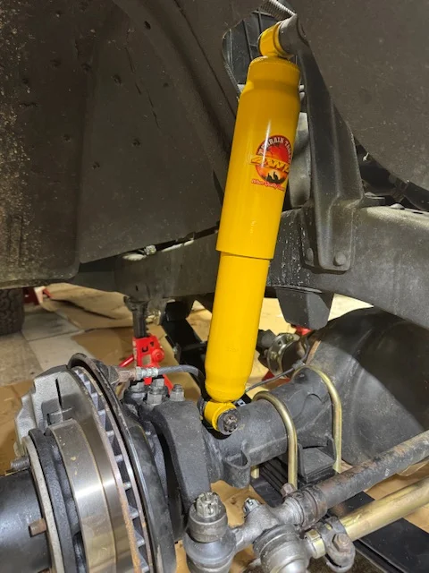

View attachment 3992575View attachment 3992576View attachment 3992577View attachment 3992578
The compressed shock makes it easy to install.. I doubt I’d be able to compress it had I cut the bandView attachment 3992588
1) I have found that impacts often struggle with U-bolts because the long bolt absorbs too much of the twist... often a ratchet and a cheater bar are needed.

I tried my 1/2” impact…nothing, the M12 3/8 impact, nothing, 1/2 drive with breaker bar…nothing. Placed my foot on the tire while really pulling with a 12” cheater on the breaker bar on my back under the truck …nothing and had soaked them with Kroil 2 days before
When they do get through the cut…the “POP’ was startling

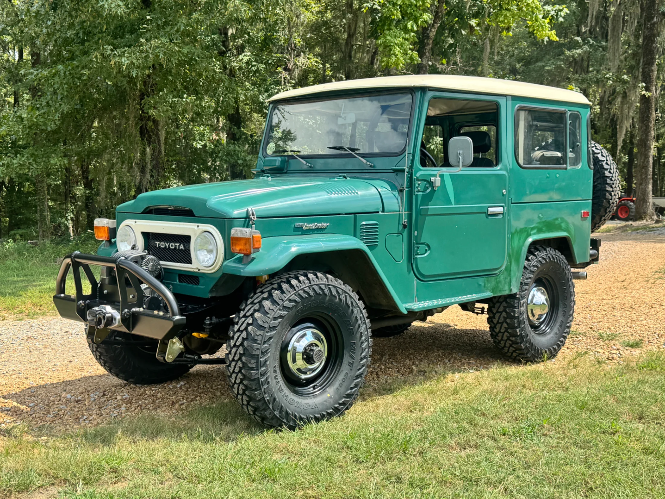

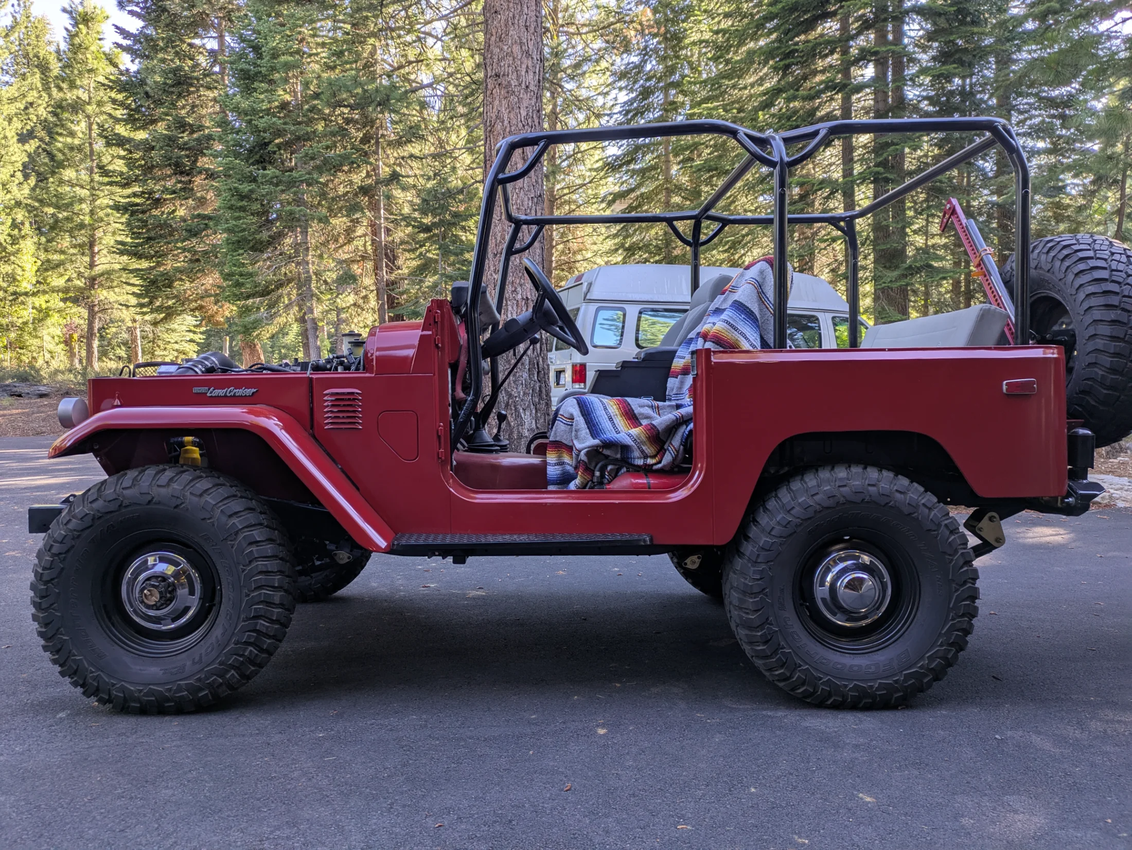

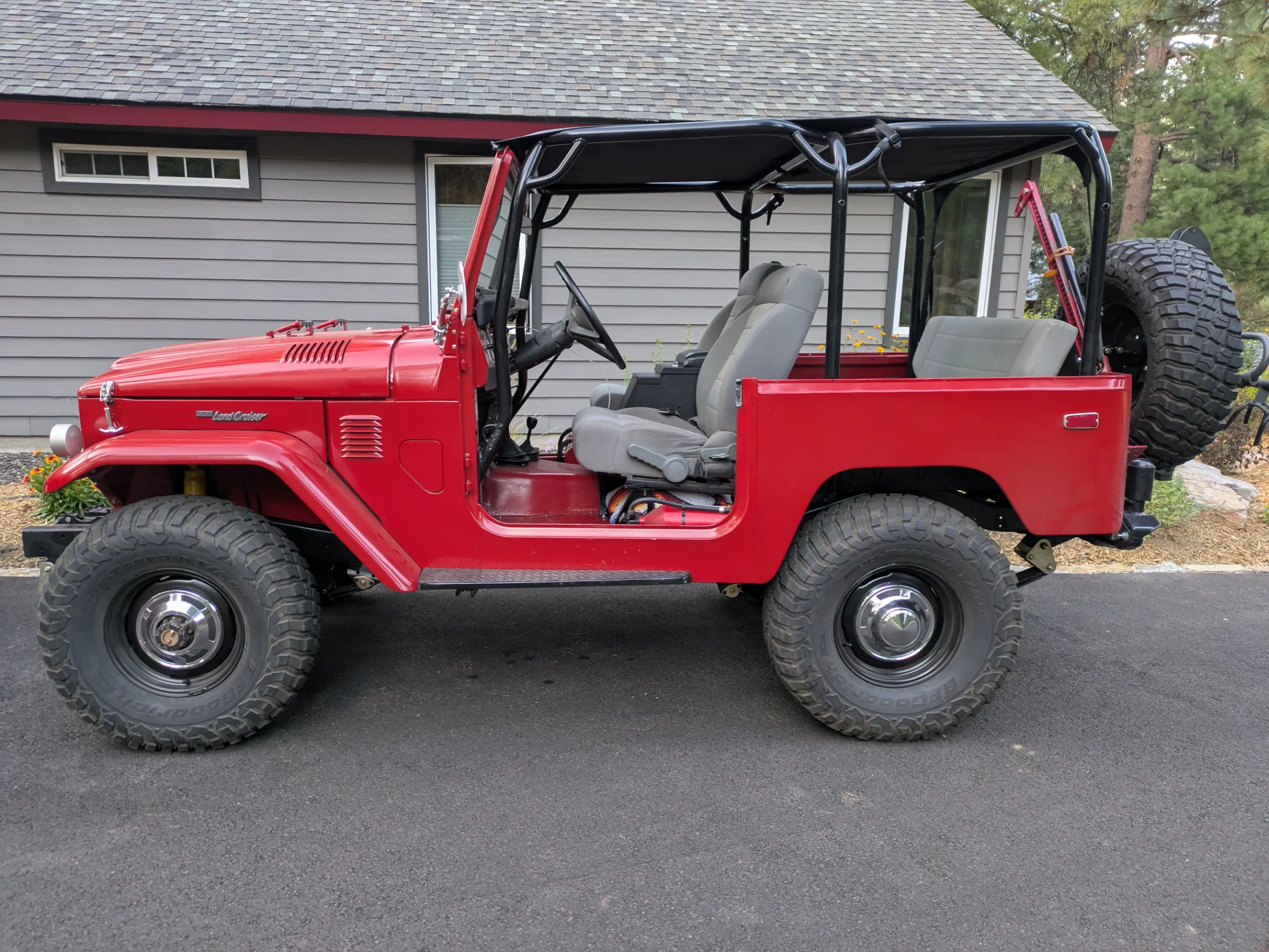

Really tempted to get a set of these for my FST Fj40 to replace its stock suspension. With the TT kit coming from stock, do you need the extended brake lines?

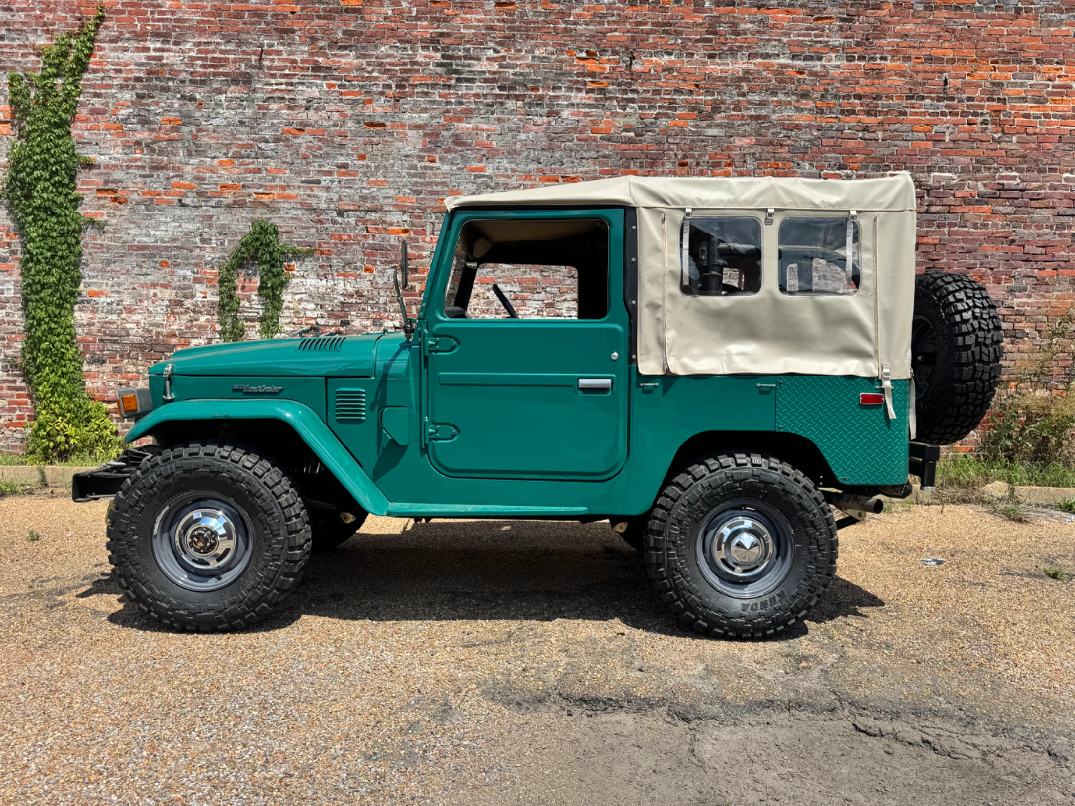

Anyone running this suspension on a 40 with 33x10.5x15 tires mind posting some pictures?
No need to extend the brake lines.
First one is 285/75-16. Similar to 33x10.50
Second one is 33x9.50-15
Great looking rigs! thanks for the pics, that is helpful.
