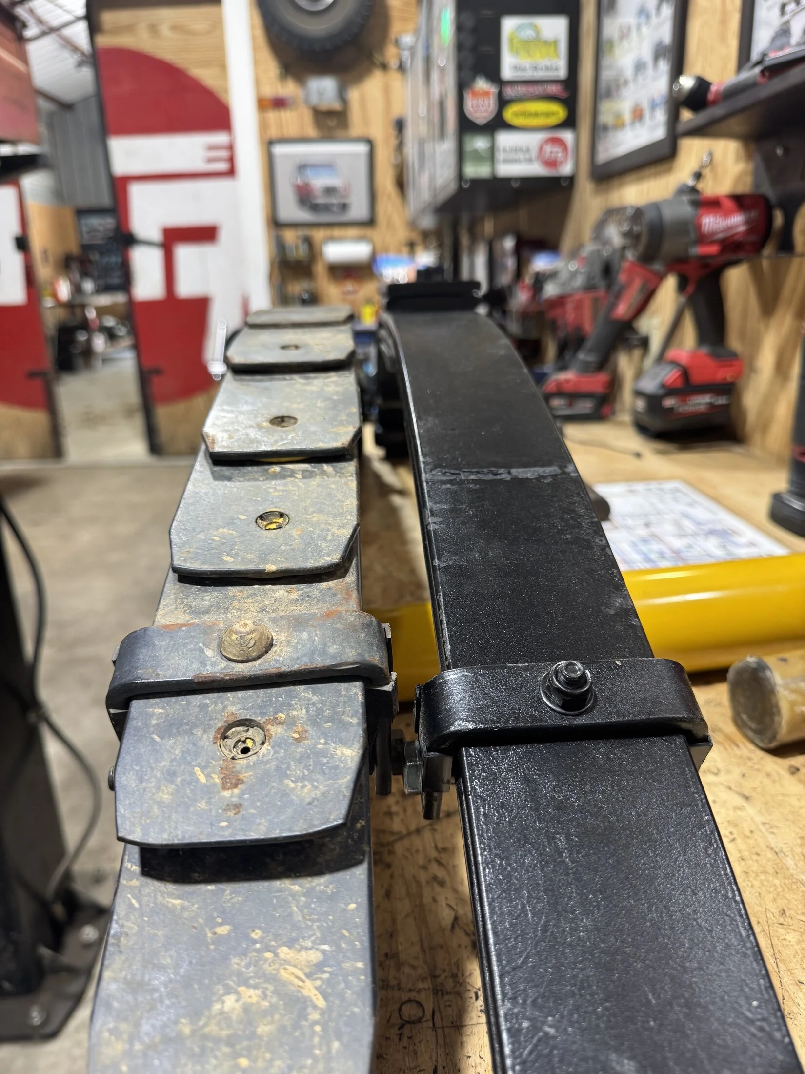

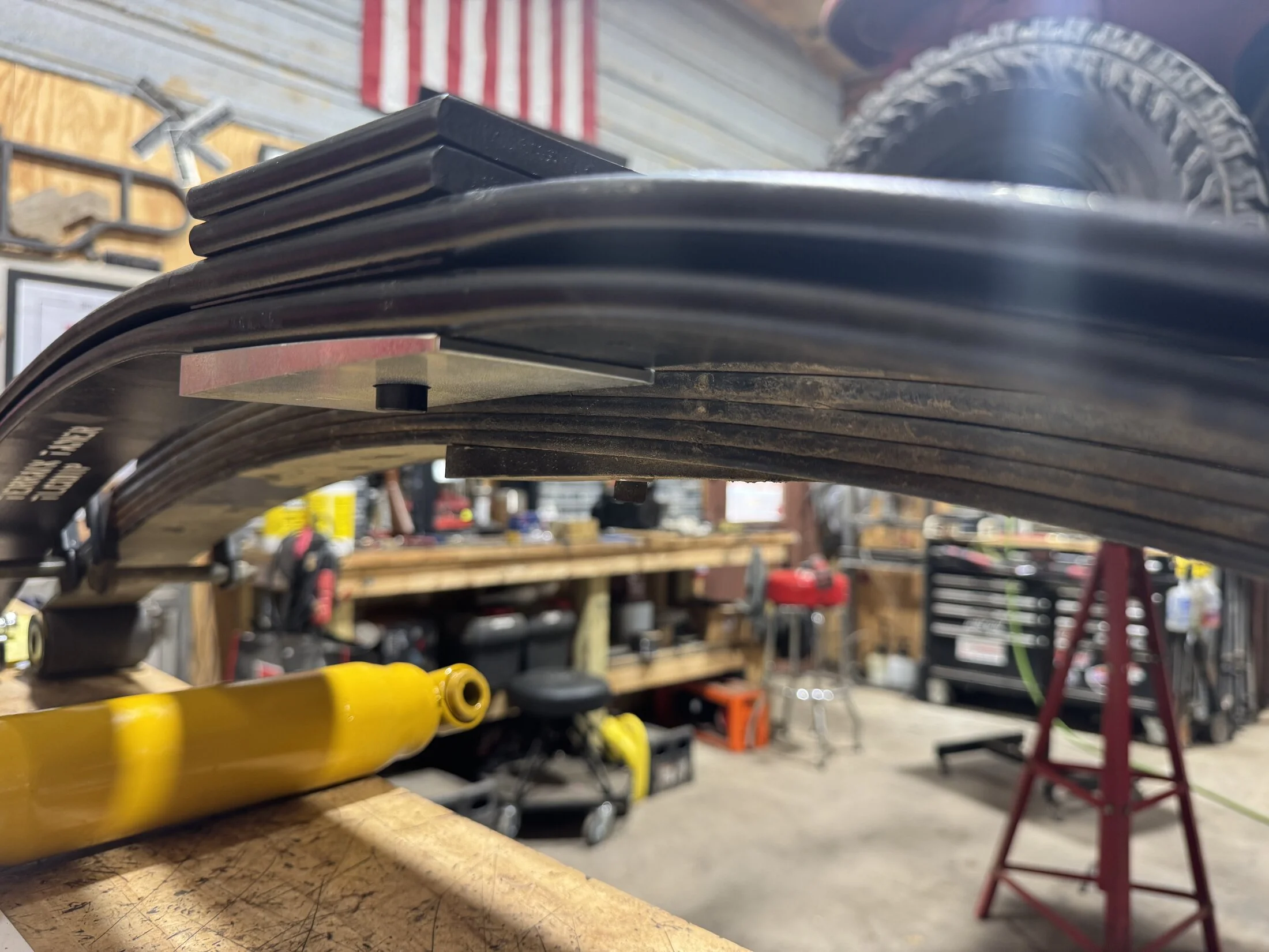

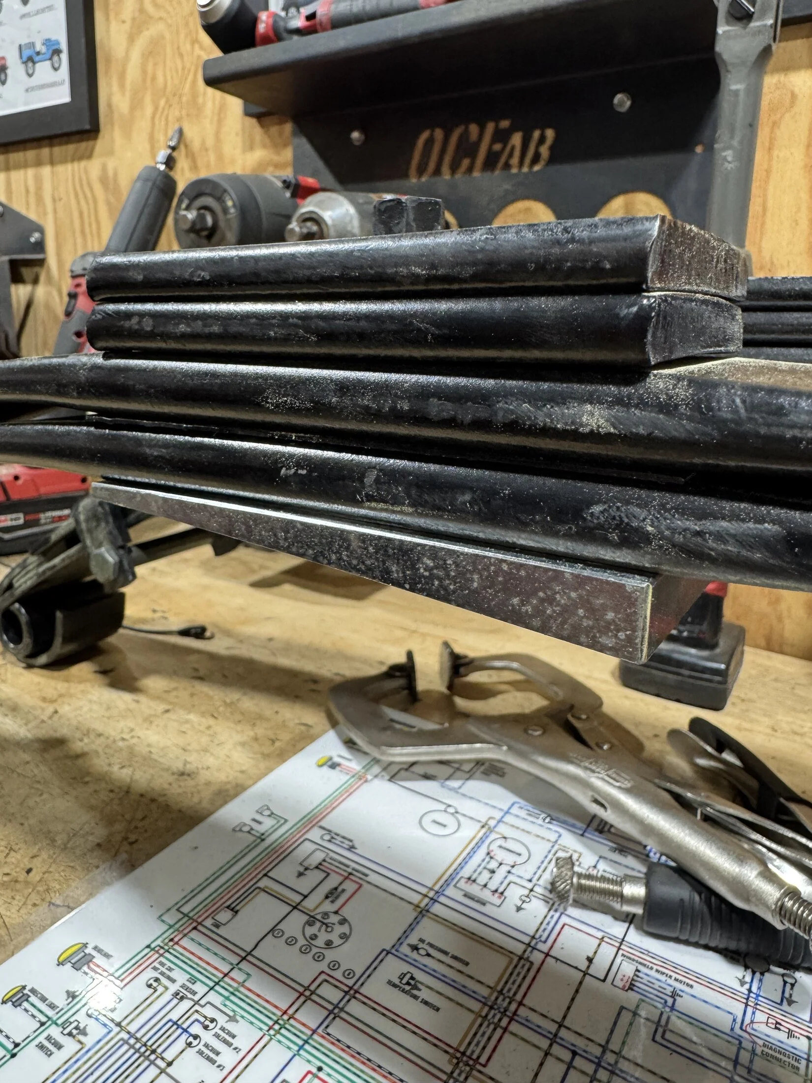

I got 1/2 done yesterday then dove into the front today after lunch.
First things first, add some 4* shims via Valley Hybrids to the front pack.
The extra small leaves on these packs are used to take up the same physical space in the Ubolt as a standard multi leaf pack. I doubt they play any part in the action of the spring at all.
One other feature. The other two leafs don't touch. They have isolators between them to reduce friction.

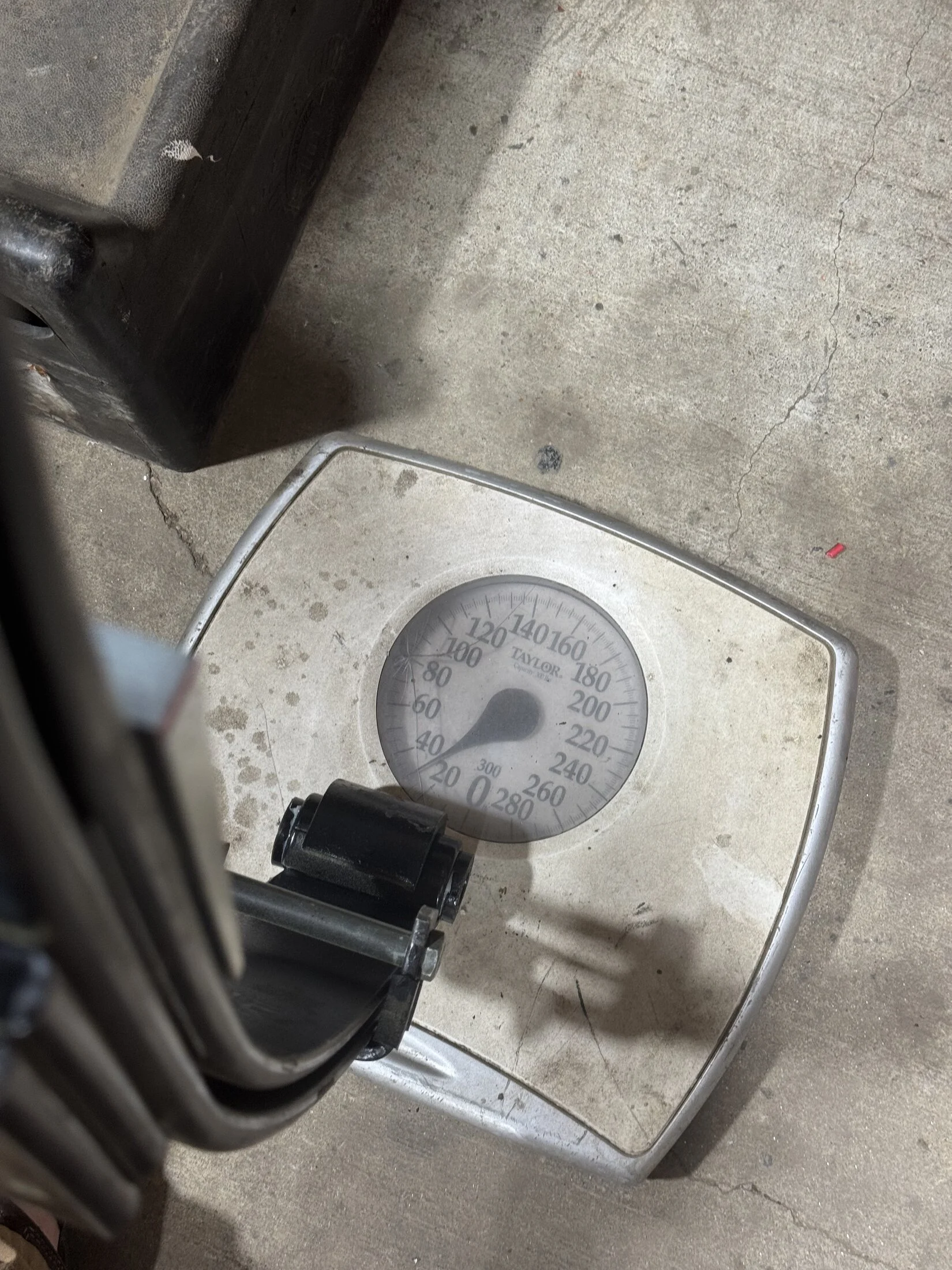

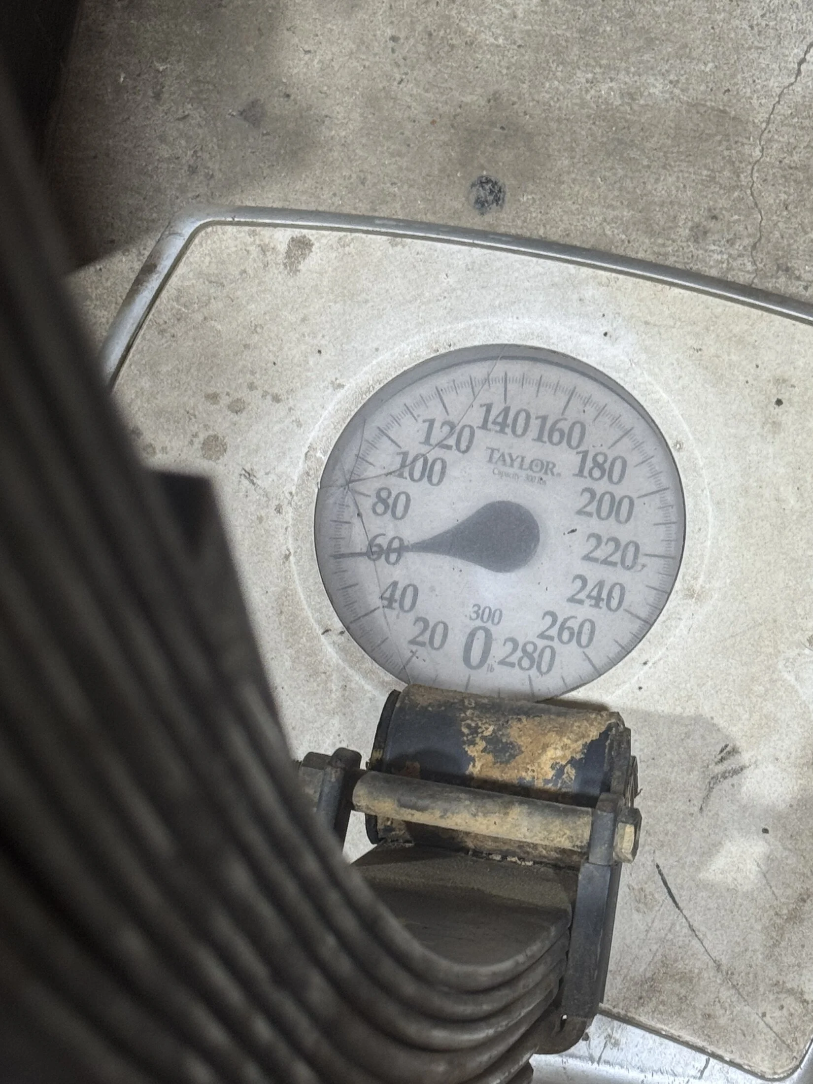

The front springs are really crazy light compared to OME - 60#View attachment 3876625
Versus only 30#
I'm running a @lcwizard flip kit but looking at the ubolts provided they are just standard stuff. Same as the others.
Side by Side the difference in design is stark
View attachment 3876629View attachment 3876630
I like how the parabolics are nice and flat where the caster shim goes. All other brands they are curved there and you have to really tighten the crap out of the center bolts.
Bonus, the Terrain Tamer center bolts were long enough to be reused with the 4* shims
While I can understand the reason they added the short leaves, I would get shorter u-bolts before I’d sacrifice 3/4” of clearance. The pictured U-bolts even have enough threads to ditch the “spacers”.

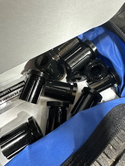

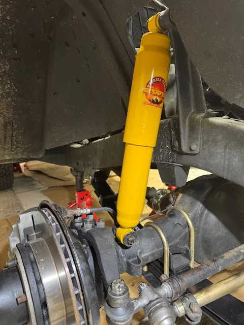

Had a couple of issues to work through. Frame perch bushings sent were too large. Larger diameter front left shock rubbed on steering rod. TT / Don Kyatt guys responded quickly with replacement components. They also provided recommendations for rear spring assembly rearrangement to lessen the stink bug stance.

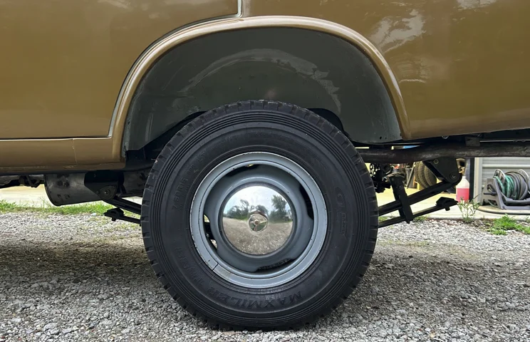

Rearranged the short sections, moving one plate from top to bottom, raised the front about an inch.

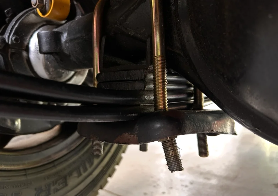

Before photo:

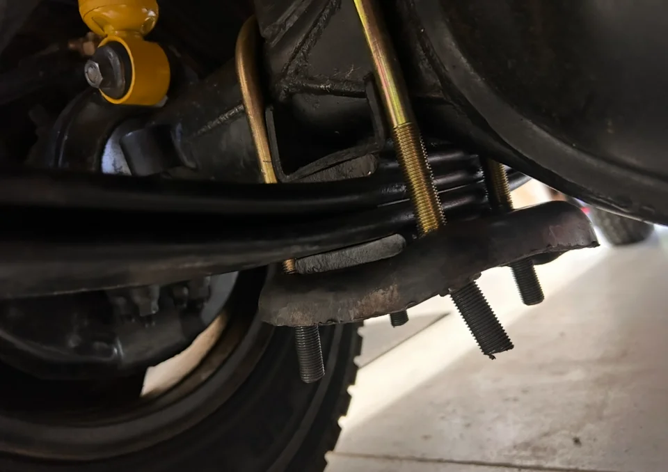

After photo:

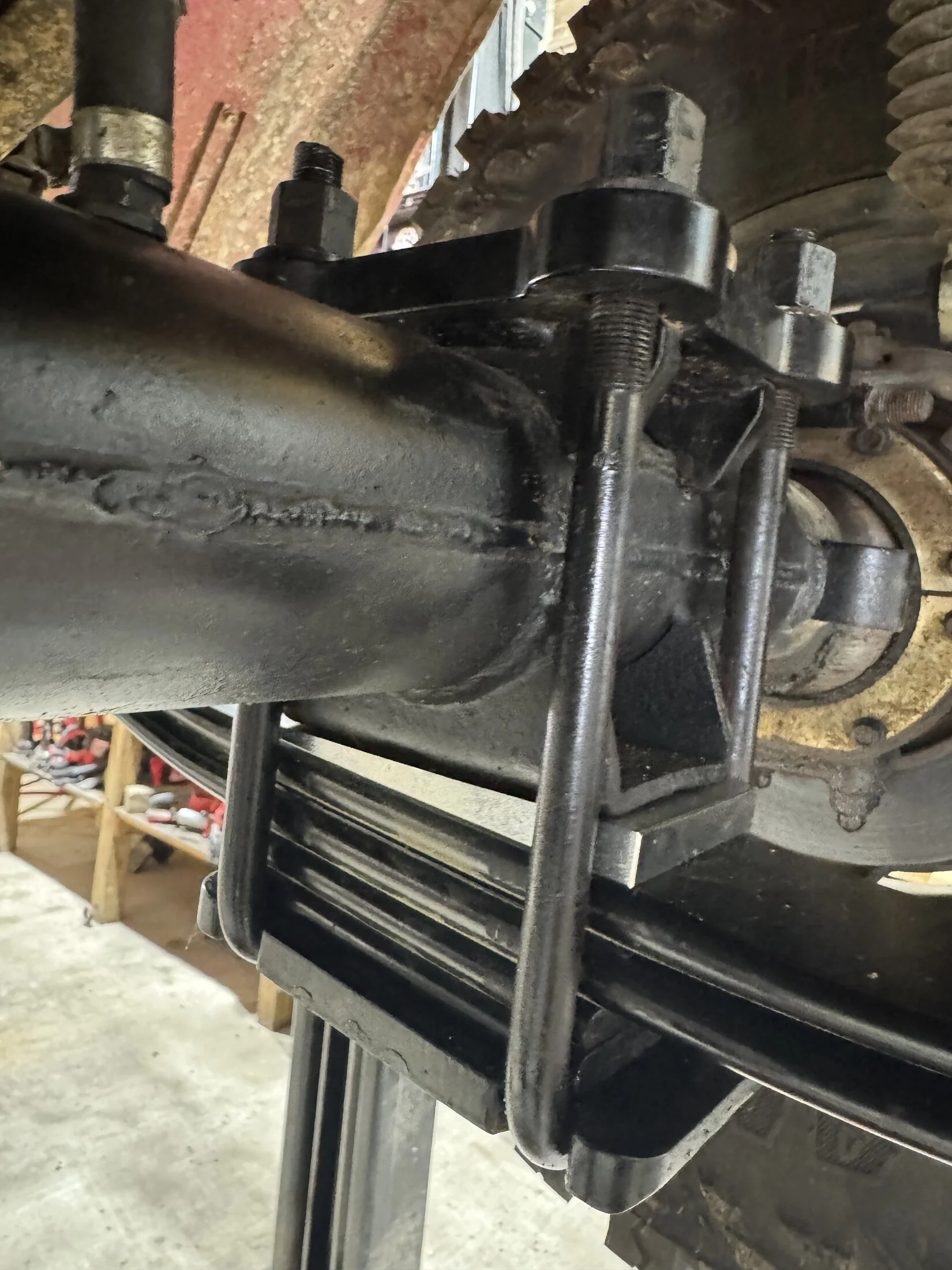

What was the thought process on tightening those u-bolts and u-bolt plate to yield or is there some strange fish eye effect going on that makes them look very much bent?
There is something odd about that photo. The bolt angled slightly once torqued, but the photo exaggerates the angle. The bottom plate may be slightly bent?

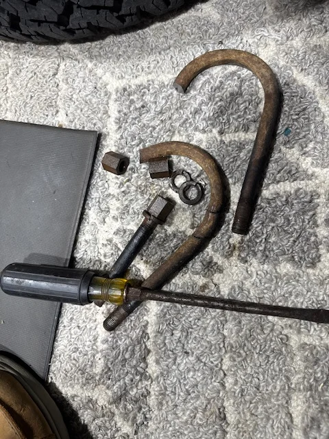

It’s a slow going project but I am getting there. One corner per day. For me, it’s hard to get into the positions under the truck and then discover my 17mm socket is over there and out of reach. That’s All on me, the job is quite easy to do and everything is dropping into place. I have the right rear side to remove and finish then add the steering stabilizer. Got a call into @orangefj45 on the stabilizer… that man is devoted
The quality of all of the parts is quite remarkable an ease of install from 1-5 is a 2…fairly easy and everything is there. if you’re younger and stronger…thank God for extra floor jacks. The rear u-bolts have proven to be too much for my 175psi compressor and 1/2” impact gun. I run it at 95psi but cranked it up for these….nothing. Cut-off wheels worked

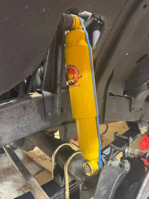

The compressed shock makes it easy to install.. I doubt I’d be able to compress it had I cut the band
