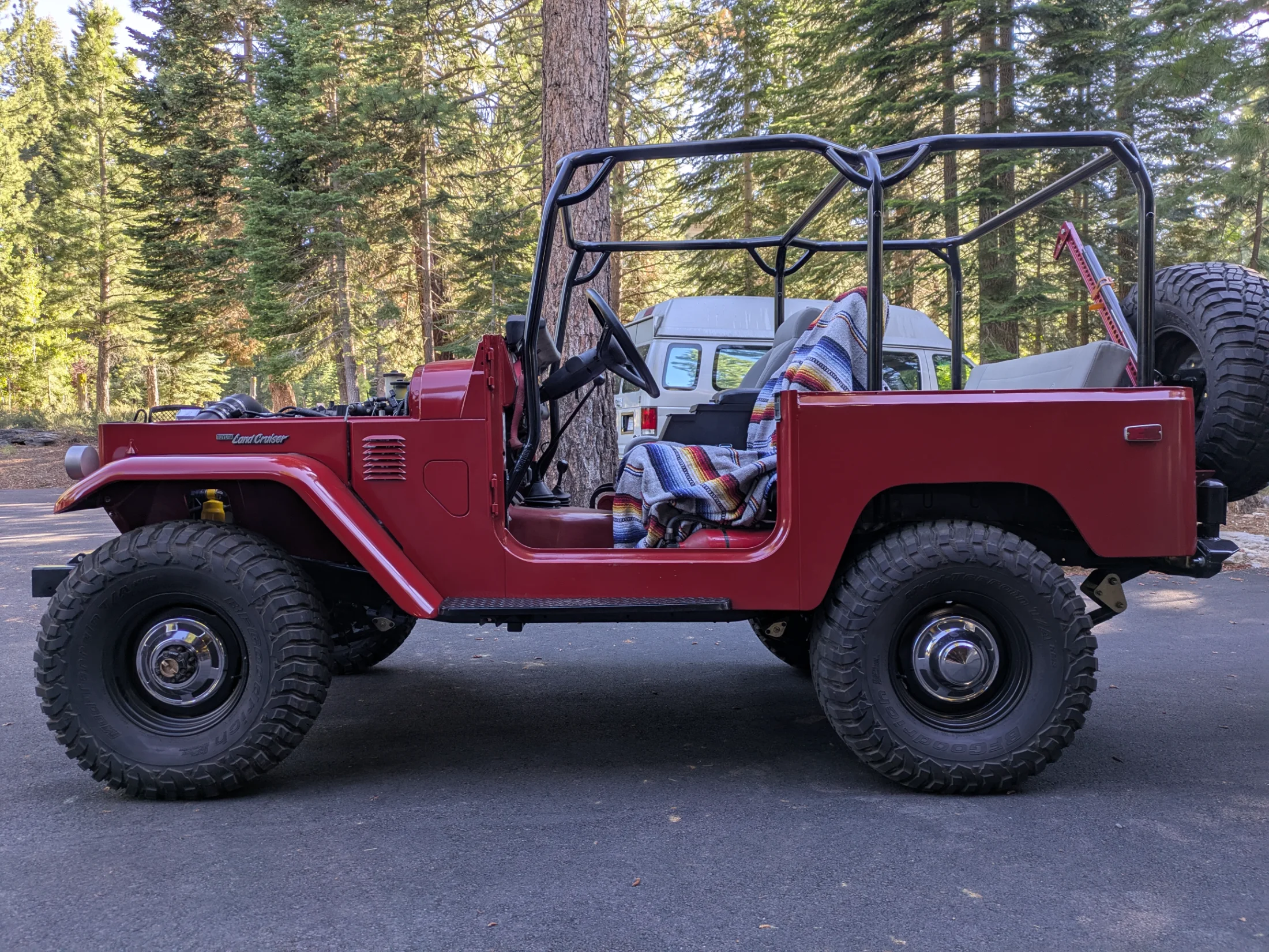

Finished installing the lift yesterday on the '72 FST. The Terrain Tamer kit is really nice.
Here are some pics. I am just waiting on my 33" KM3 to arrive. The tires in the pics are 30x9.5. All is pretty much done but I need to cut down the U bolts and do a final torque of everything.
It has some cruiser lean to the passenger side, about 3/4". Will play around with the levelling blocks in the rear to correct.
Also has some slight nose down rake. Im guessing due to no hard top so not much weight on the back end. Swapping the rear short leaf blocks from bottom to top will fix it I believe.
I don't think it has too much rake but yes if you want to mix and match the little blocks, top to bottom or vice versa to tune the level you can. It does not matter what side those blocks are on. Top or bottom. I've have them on both sides depending on which truck the packs were for
