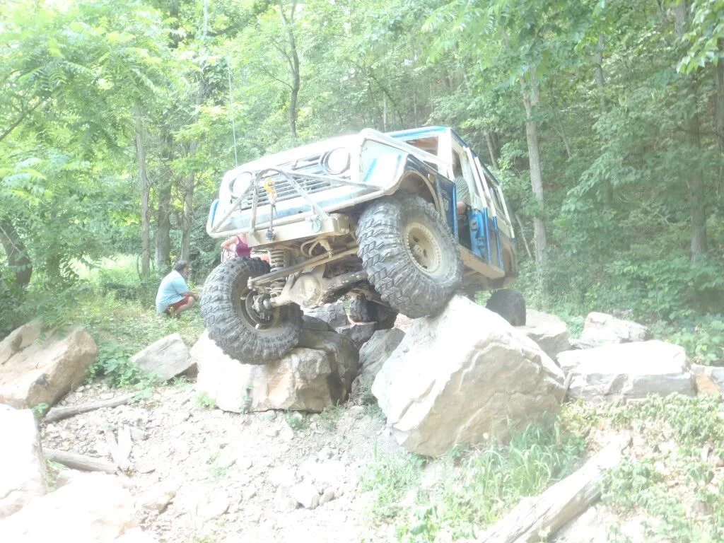

It was in this spot. this pic is from a couple of years ago.
Did you fix it yet?

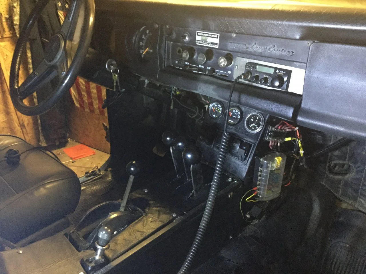

Yep. Used th400 and NP 203 from CL. Still need to change the valve body and pan from the other one. Took the opportunity to build new shifters and a new center console. I moved the ignition to the console because my keys keep falling out. One of these times I'm gonna lose them.
Moved all the electrical to where I can reach it easily and eliminated the glass fuses that had a lot of conductivity problems and were hard to find in the middle of nowhere while wheeling.
Still managed to keep the dash uncut. I get flack from purists, but I could save a lot of time, weight and money if I hacked more pig out. I've worked hard to keep some things very fj55. The view from the drivers seat, the body lines and the front clip in particular are still very much like they are supposed to be. The rear window even still works.

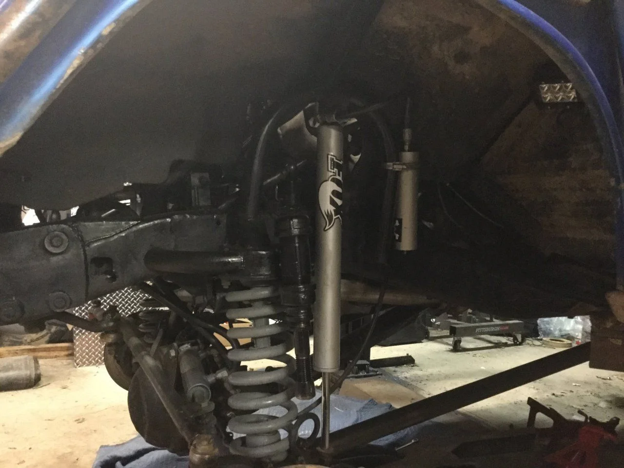

I also rebuilt the fox remote reservoirs. I had to buy one new one because I bent the shaft and then broke it while trying to straighten it. Built some Gingerbump bump stops. Put some LEDs in the wheel wells too with a fancy rock lights switch.

Relocated the rear shocks to the wheel wells. Looking for new springs. Leaning toward stock 80 fronts, but might try some wrangler lifted springs if the guy gets back to me. The tires hit the bumper just before they hit the shocks and they don't seem to contact the frame when they swing down on full droop. Obviously, the truth is in the rocks. You can only test so much on the hoist.
I looked into threaded bodies for the fox shocks while I was rebuilding them, but by the time I bought springs and all the parts I was well over the cost of new coil-overs or ORIs. I have other things I'd like to spend that kind of coin on. Tires and gears specifically.

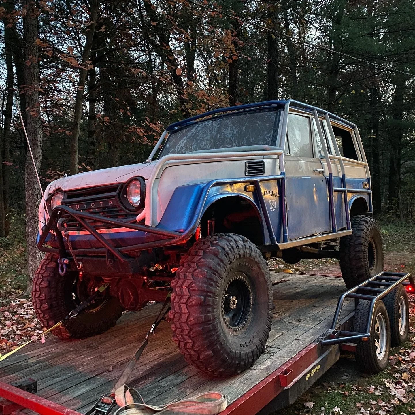

Loaded up and leaving Michigan.

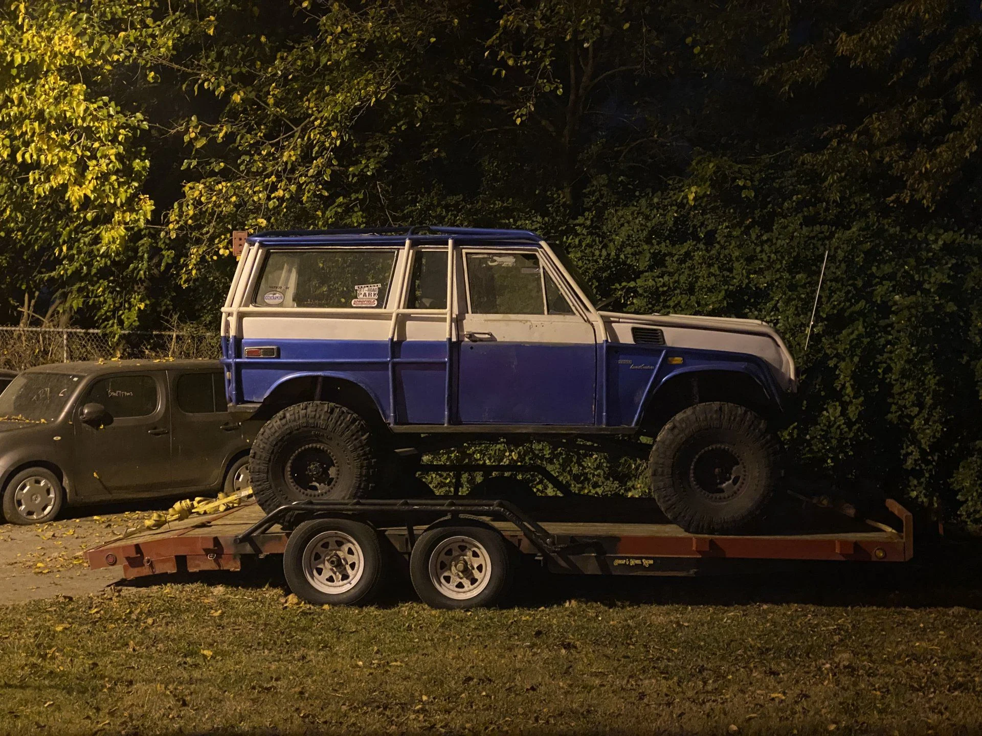

Safe and sound in KY early this morning.
