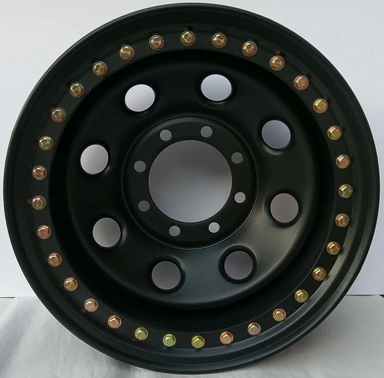

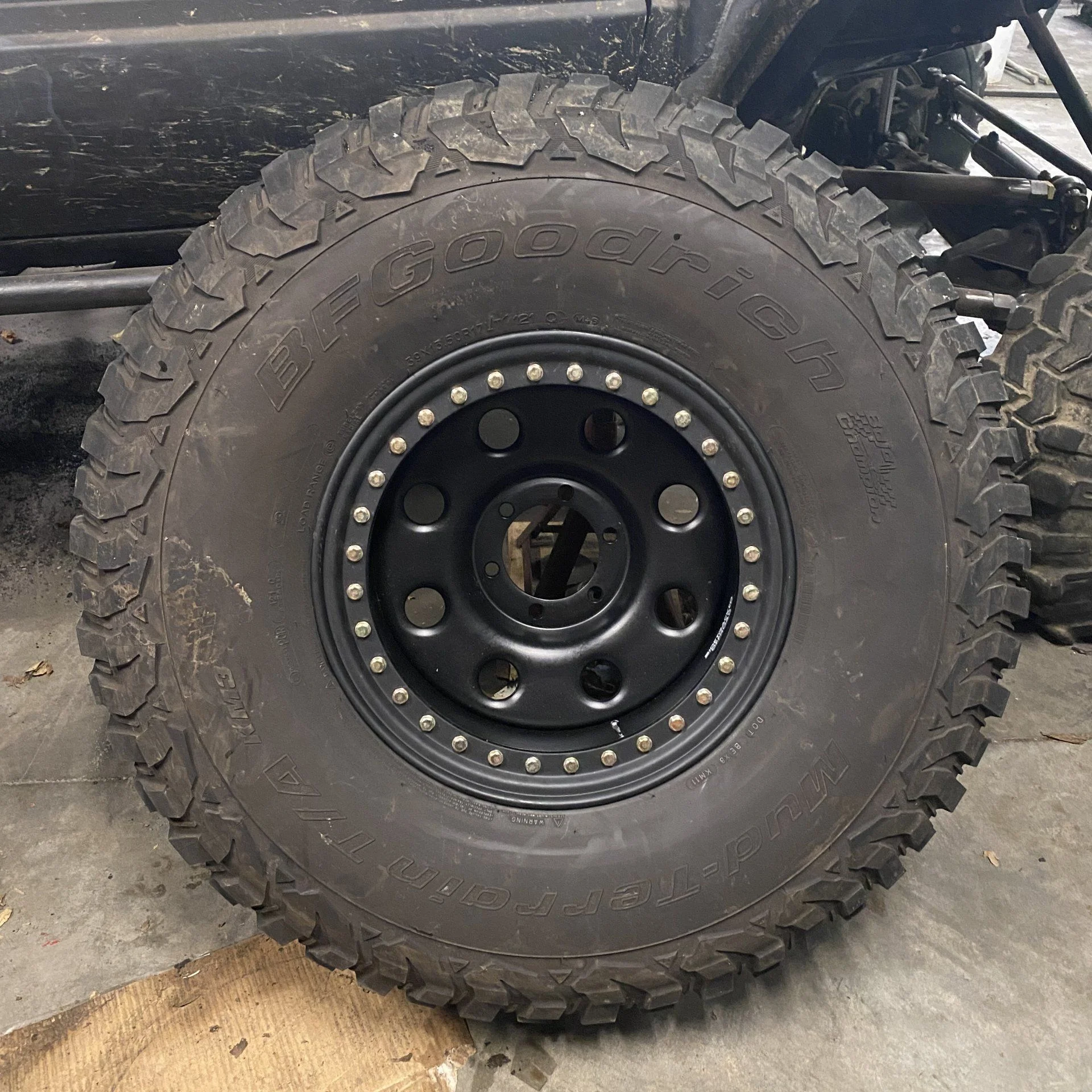

If I went to a 17" wheel I'd be giving up the 15" bead locks (but gaining lots of tire options), and I really wanted to keep the bead locks. A search led me to a steel bead lock from Sidetracked Offroad. 17x9, 6x5.5, 3.5" backspacing, 4.3" hub bore and $200 checks all the boxes.
We're currently doing a set of weld-on bead locks for a buddy's vehicle (17" 1st gen Tundra Steelies) and once I did the math these wheels from Sidetracked were going to be cheaper and not involve all the time and labor of welding up a set. With a viable option for 17" wheels identified I turned my tire search to something that would match that.

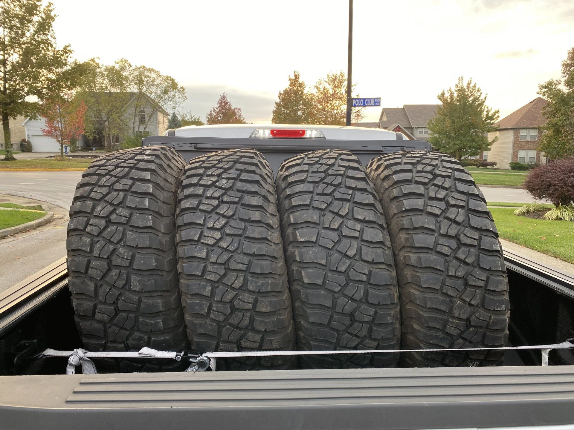

If you're not running a Super Swamper or Pit Bull tire that comes in a bunch of oddball sizes (36", 37", 38", 38.5", 39.5" etc) then it mostly leaves 35", 37" or 40" as options. Since the current tires were 38s (now measuring 36") I want to run the maximum size without getting in to clearance issues. I started looking seriously at 37x12.50r17 tires since they're more available and I wouldn't have clearance issues. One that caught my attention is the Mickey Thompson Baja Boss ( as well as the Baja Boss X which is a sticky). Pricing was still pretty tough to swallow and then I remembered that BFG offers their KM3 tire in a 39"size (that measure 38.5"). After pricing new ones I was able to locate a slightly used set four hours away in TN. The owner purchased them in August to run on his Power Wagon but ended up deciding they were too big for street driving with a trailer and pulled them off after close to 2,000 miles. The tread looked great and the price was a little easier to swallow so today I did an 8 hour round trip and picked them up.
I feel better about having a wheel/tire setup decided on for immediate future and should have them mounted and on once the wheels show up on Friday.

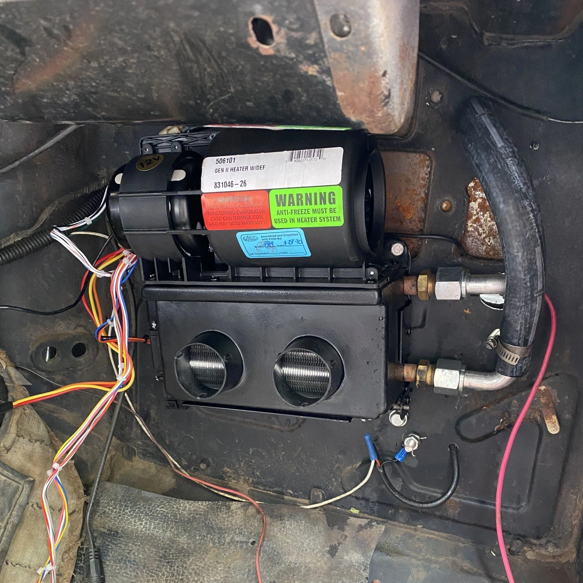

With that decided I went ahead and ordered an aftermarket heater from Vintage Air (should be here Thursday) that had good reviews and will be installing it in the Pig under the glove box area and should be able to connect it to the factory vents/defrost. I've also ordered a new windshield and gasket as well as a replacement gasket for the side cargo window as that will be going back in. A buddy of mine has a couple of parts pigs and I'm hoping to get a set of front door glass so I can seal up the vehicle from cold/inclement weather should the need arise. I'm definitely getting familiar with the "Pig Tax" but want to make the vehicle more suitable for year round wheeling.

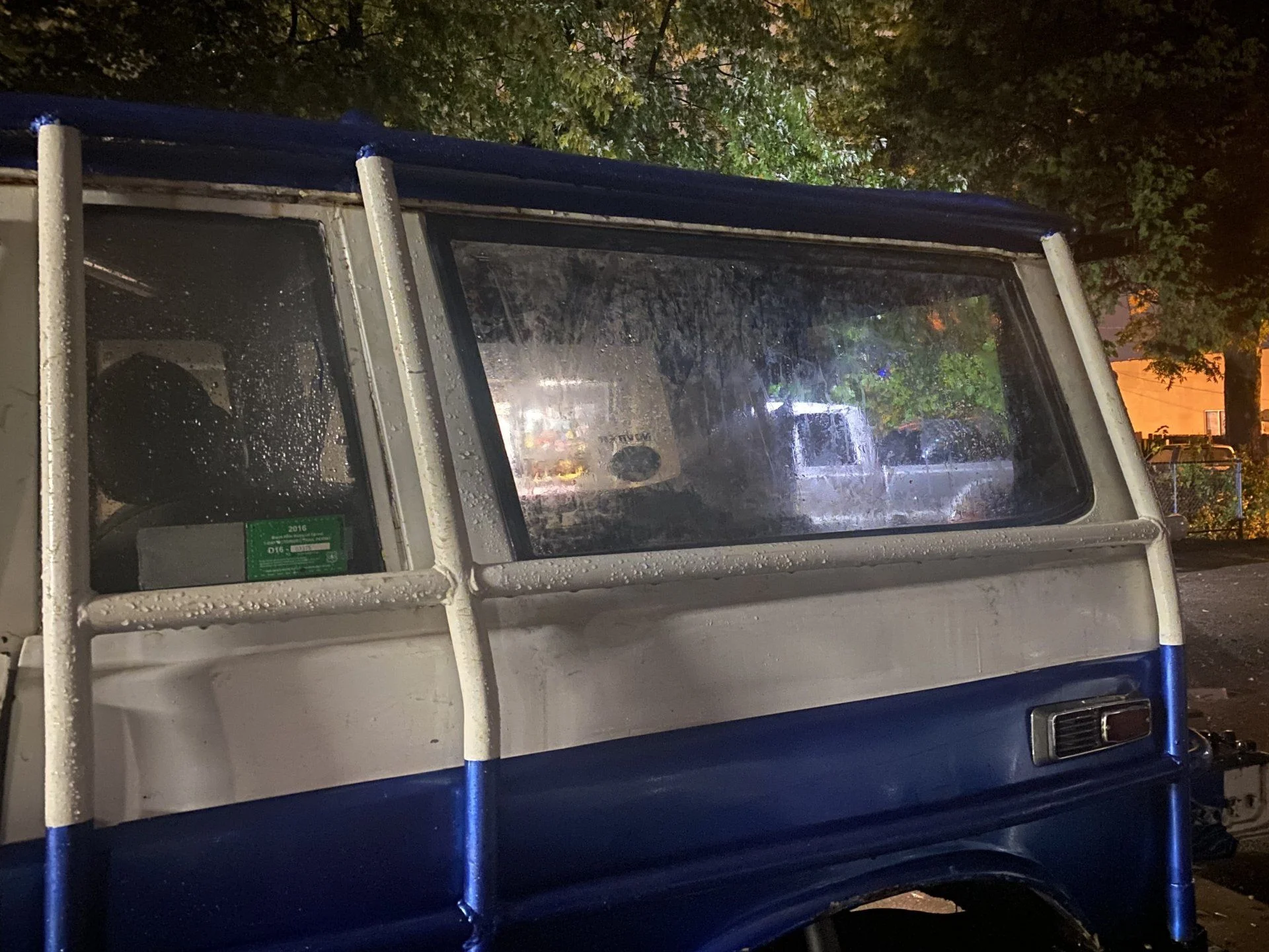

With that said I've got several fellow TLCA members that have been lending a hand, one of which has a '77 FJ55, so he came over yesterday afternoon and help me reinstall the driver side cargo glass with the new gasket that came in. It took some finessing and a few choice words but its reinstalled and one step closer to being closed up from the elements.

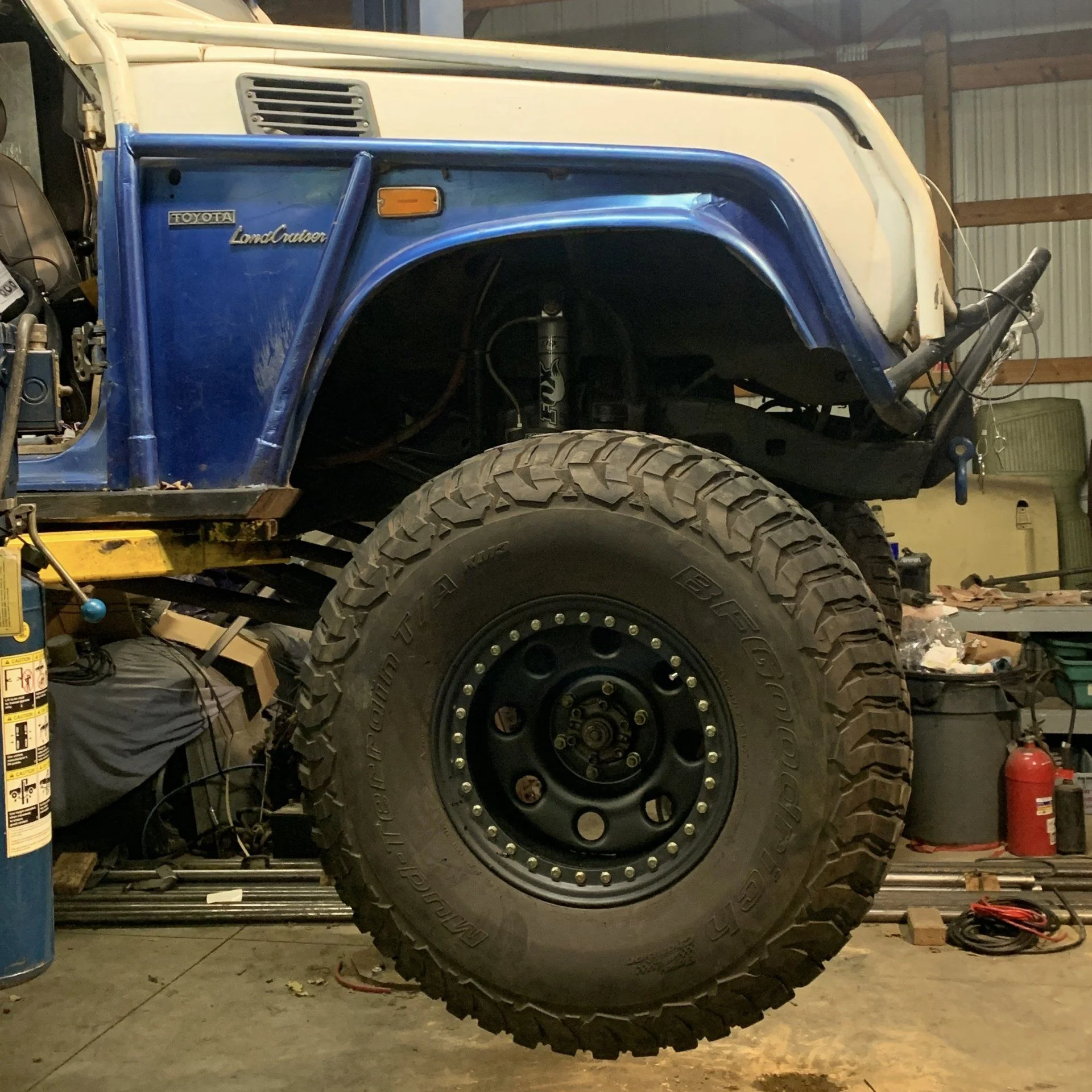

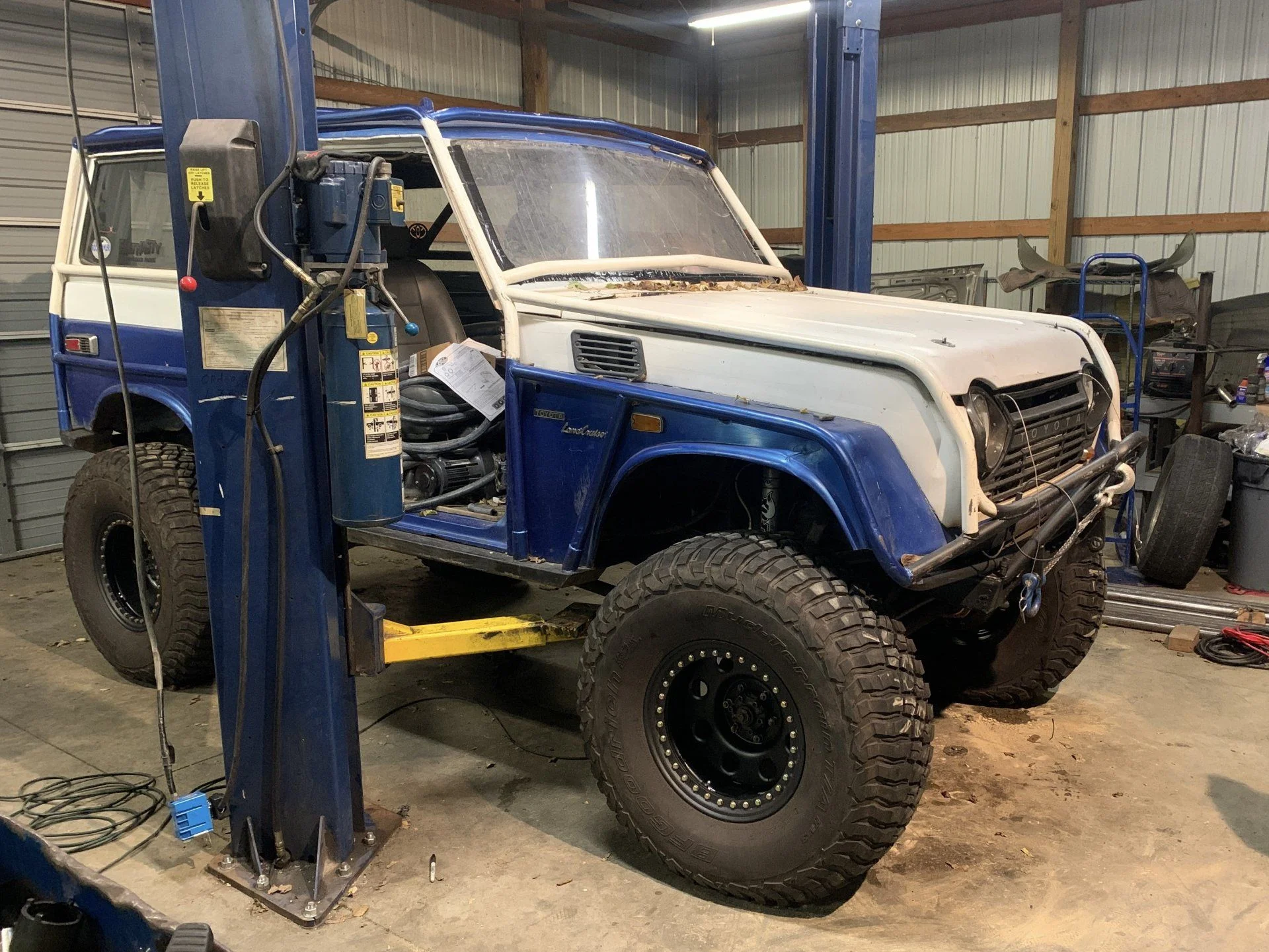

I got the new 17" Bead locks delivered yesterday so we had a chance to mount the 39" KM3s and see how they looked on the wheel. We had one of his vehicles on the lift for some work so I'll head back over later today or tomorrow to put them on the Pig and check for clearance.
The new heater from Vintage air is almost complete at this point. We plumbed the cooling lines to it last night along with the heater control valve they provided and got the heating unit itself mounted to the firewall along with making a bracket for the switch placement. I need to finish the electrical wiring and connect it to the defrost ducts then it should be complete.

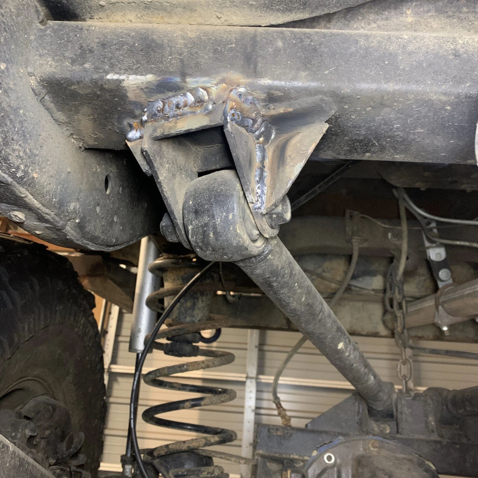

Buddy of mine spent some time tonight with the Pig on the lift doing some welding for me on link brackets that had some stress cracks and wear.
After that the new wheels and tires were mounted up to get a look.
I like them and think they'll work out pretty well.

First I finished up the wiring for the new heater. One cable for the heater control valve had to be run through the firewall and the rest went to the control panel inside as well as power and ground. After everything was hooked up I tested the function and it didn't blow up!
The mounting plate for the control panel we made out of a piece of aluminum that we cut and bent then air riveted to the bottom of the dash.

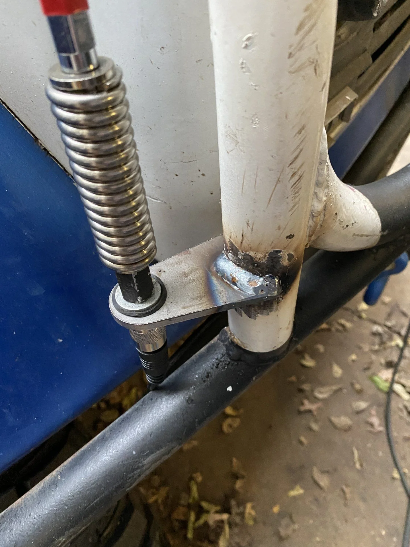

Since the old CB had bit the dust and one end of the antenna cable looked questionable I went ahead and installed a new unit as well as a new antenna cable and mount.

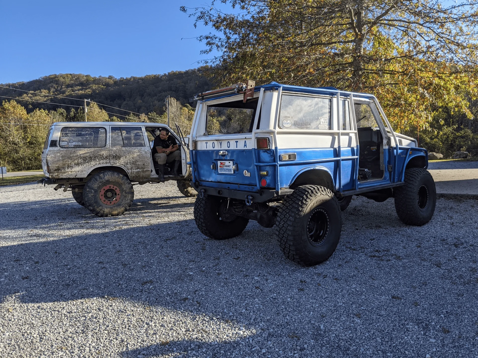

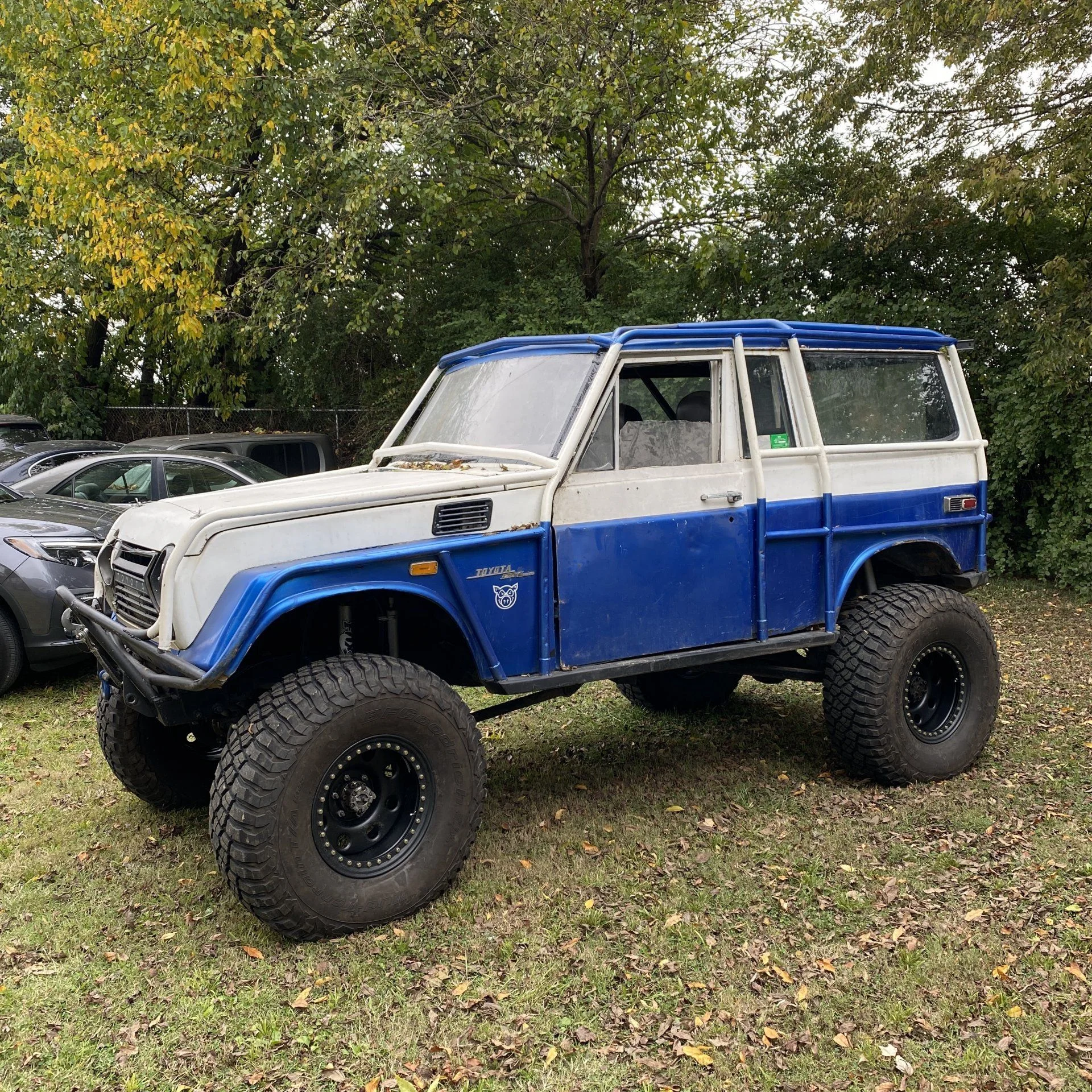

Pulling the vehicle out of the shop and getting a good look at the new wheels and tires.

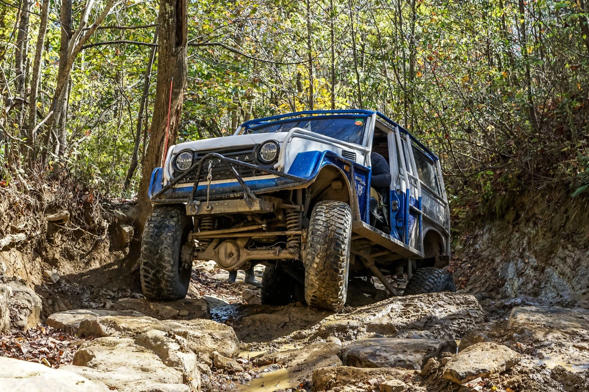

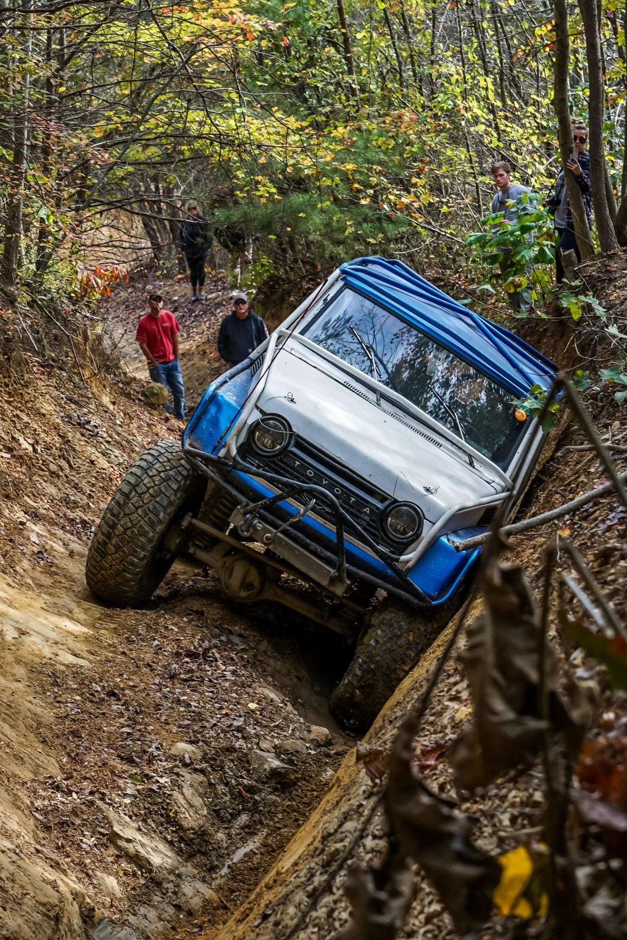

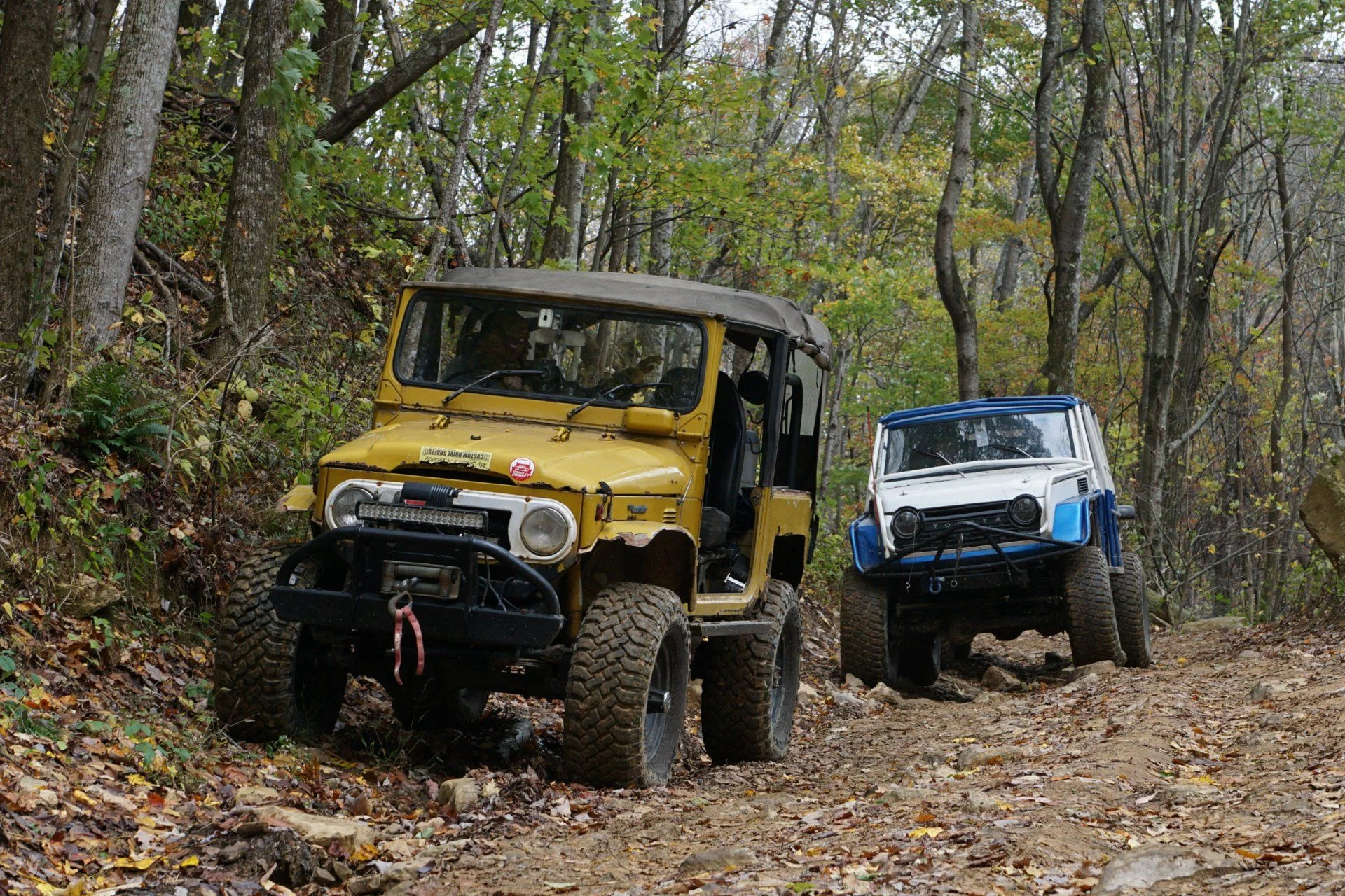

Some shots from the trails at GSMTR:
