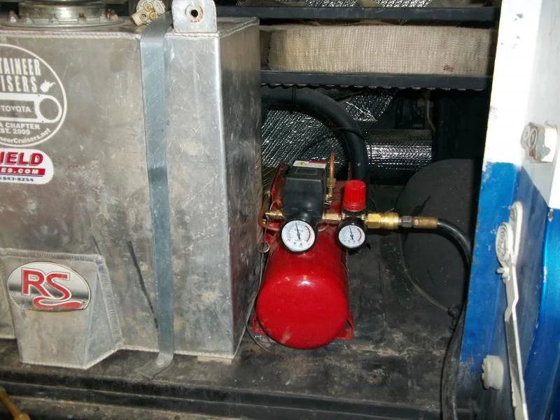

Picked up a 2.5G Craftsman air compressor with a bad seal on the compressor. Took the motor and compressor off. Hooked the ground side of the york up to the pressure switch and grounded the other side. Ran the brass line through the floor and hooked up the air line from the york to that. Bolted the tank to the floor beside the fuel cell in the back. I kept the switch I ran next to the compressor so I have a double fail safe in case the wire running all the way to the back grounds out somehow.
With the tiny tank it doesn't take long to get the tank up to 120 psi and then it shuts off just like it should. I pumped up a couple of tires on the LV that were low. It goes from 10 to 35 psi in just a couple of minutes.
The CO2 tank and bracket will probably go in the SWB 45.
Gumby,
Nice setup!
Will you have to drain any condensation from the tank like a regular air compressor. I have a Puma, but haven't mounted it yet and thinking about a drain hose. Since your tank is seperate from the pump, wasn't sure about water.
Thinking out loud here, would the air cool in route to the tank and water collect in the hose, at the lowest point?
Might have to put in a drain at that point.
