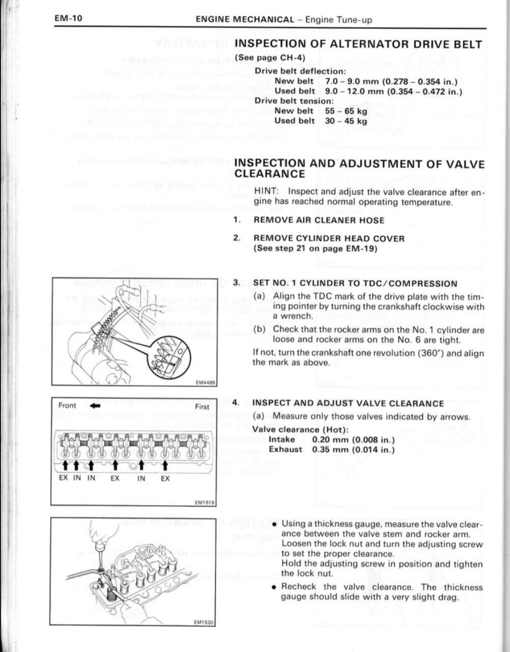

This is a new-build motor I removed the original and had a machine shop rebuild it, they also put on the head and did the valves. In order to adjust valve or push rod, does piston need to be in a specific position of stroke? I do have the valve cover off.
Check out EM-10

I've heard of 1 person who adjusts valves with the engine running & 1 with valves cold. Everyone else runs the engine to operating temp then does the adjustment. Adjust them cold. They should be very close to correct.
