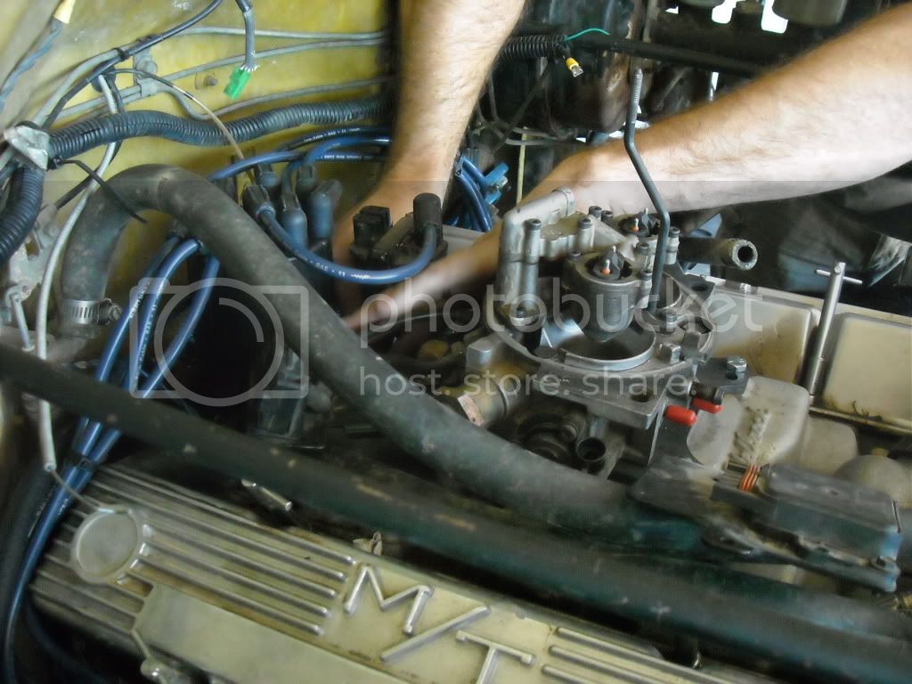

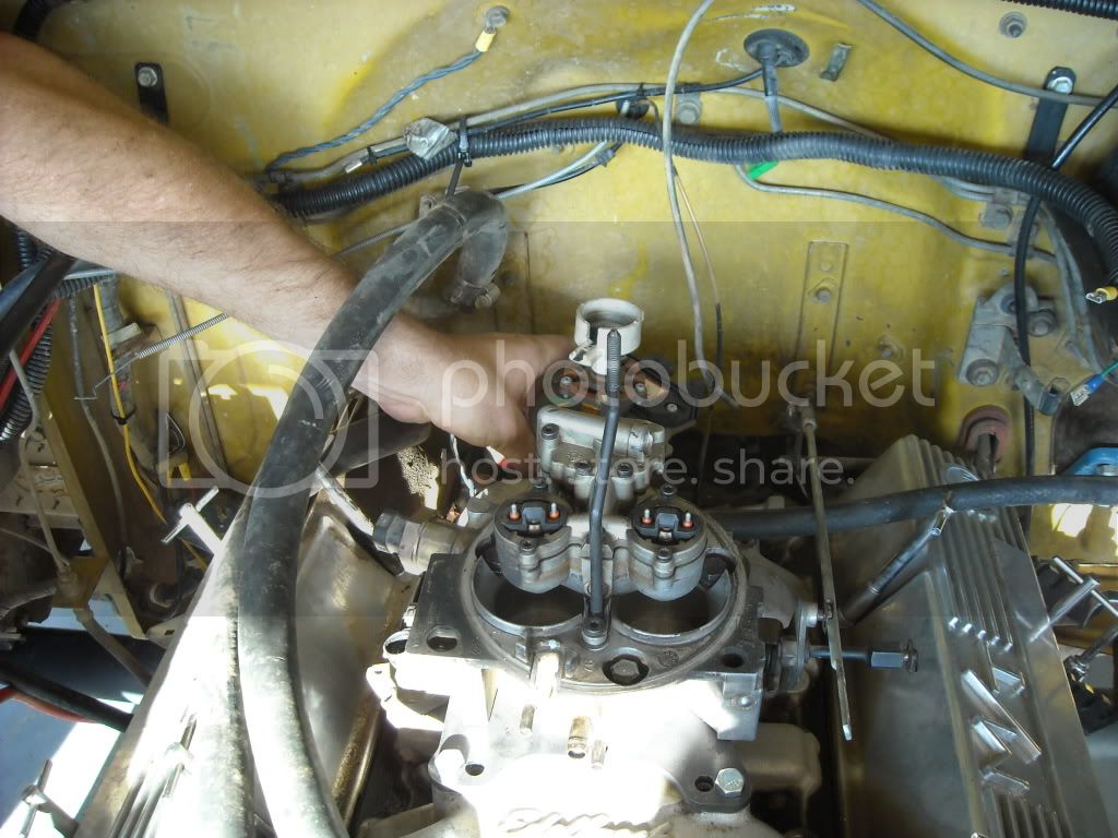

Day 1:

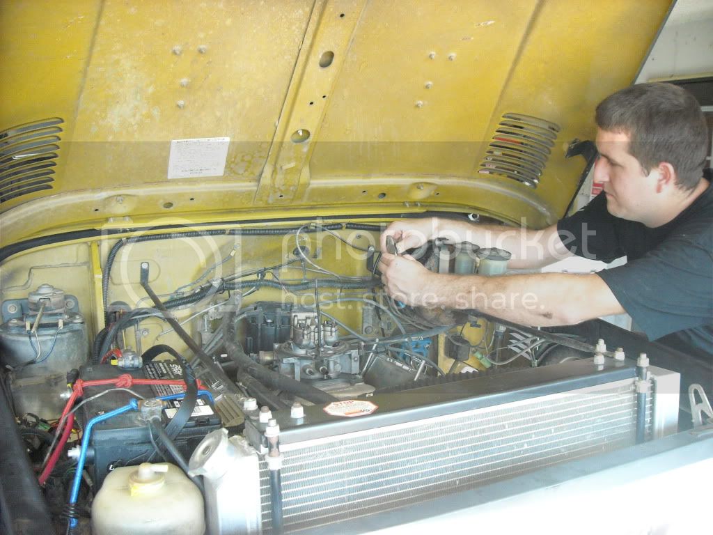

Start of the project. Carb pulled. TBI unit put on with Trans-Dapt steel adapter.

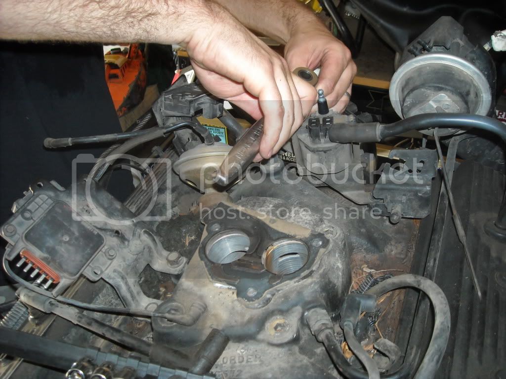

Pulling parts from the donor motor. We used the TBI unit, distributor, ESC module and bracket, MAP sensor and bracket, Coil and bracket, and Knock sensor.

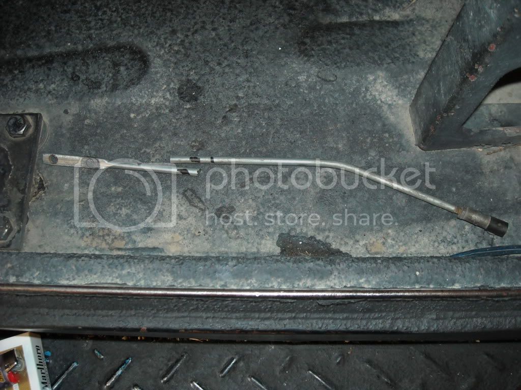

The day began test fitting the throttle rod. Too long. :(
Next I modified the holes in the coil bracket to use existing intake holes. Bolted it down and install the new cap/rotor on the dizzy.
Then I cut and modified the stock MAP sensor bracked, and bolted it to the intake using one of the adapter plate bolts.

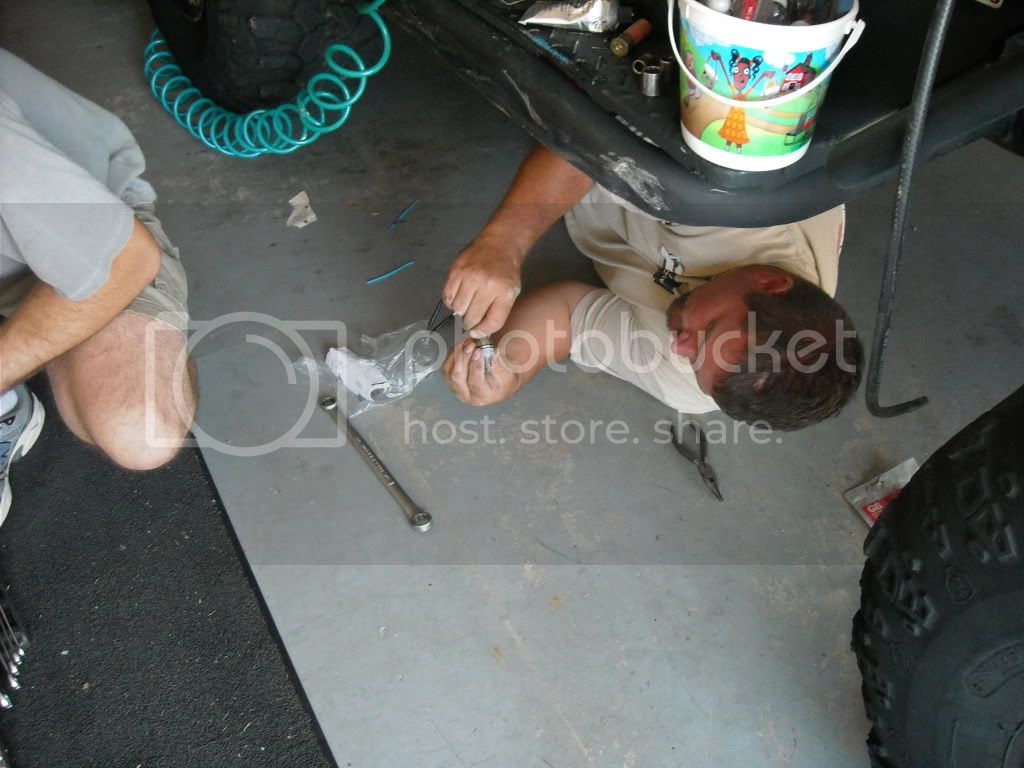

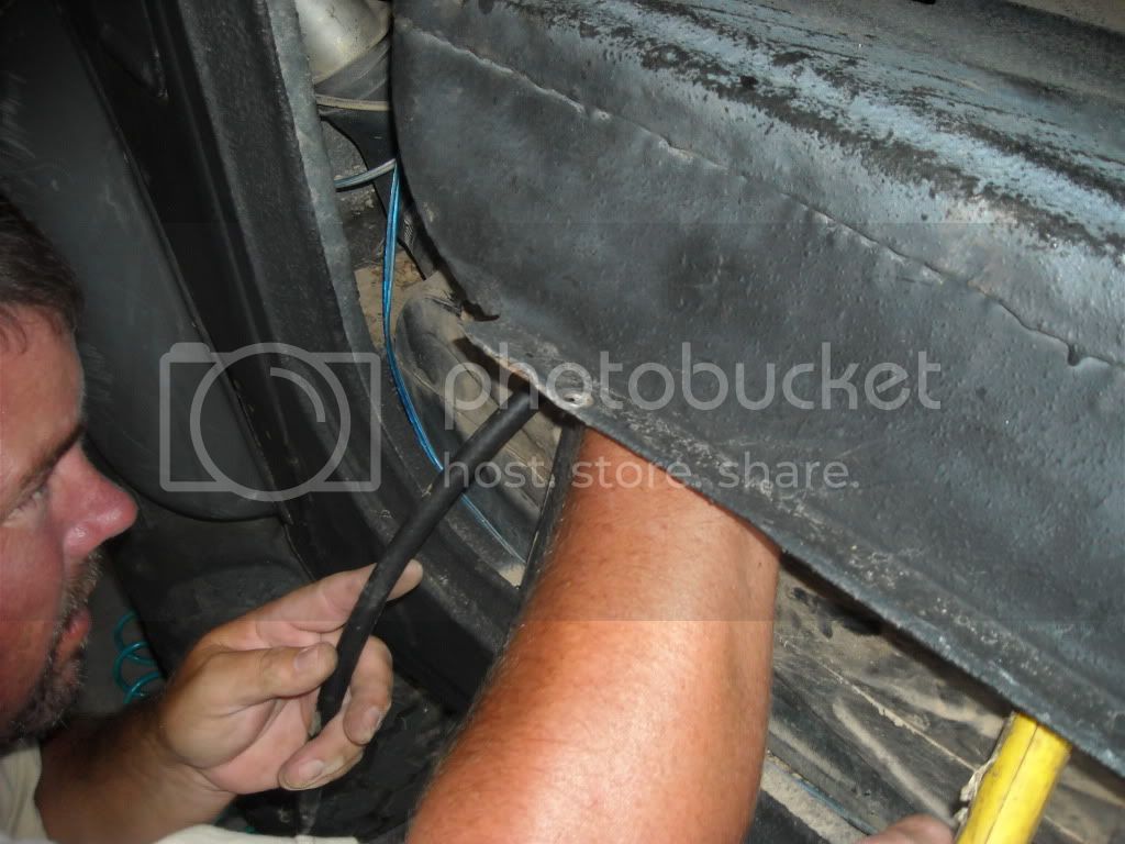

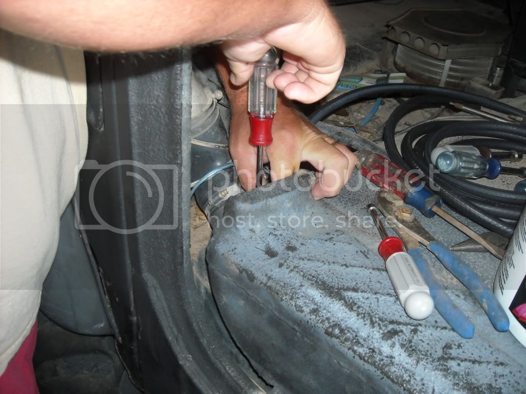

In the meantime, Scott was pulling his passenger seat to get to the gas tank to run the return line. I'm glad he chose that task, because it seemed harder than it looked.

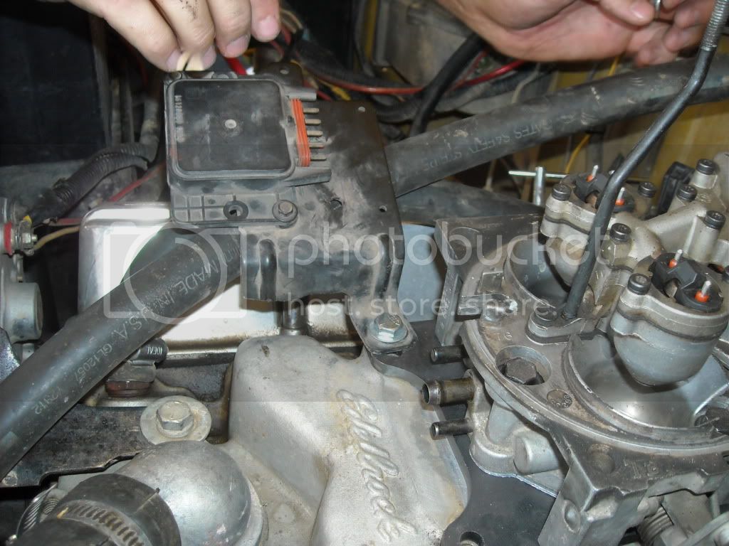

Next I cut and modifed the stock ESC bracket and bolted it to the intake the same way I did the map sensor. The Edelbrock intake didn't have the same mounting holes like the stock TBI intake did.

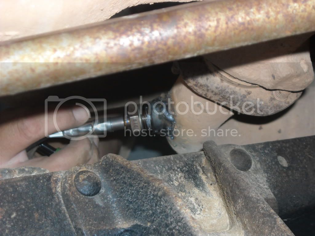

Since Scott was on the floor, he put the O2 sensor in. It's on the driver side just below the manifold.

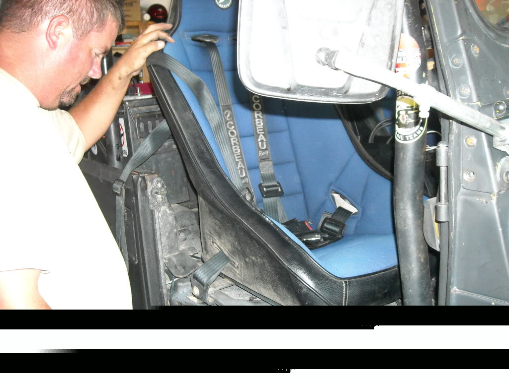

Scott and Eddie finish up reinstalling the seat after running the return line to the tank.

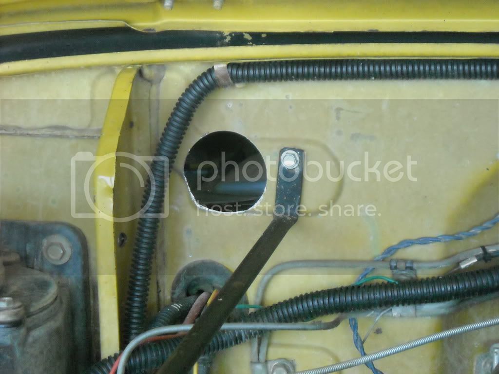

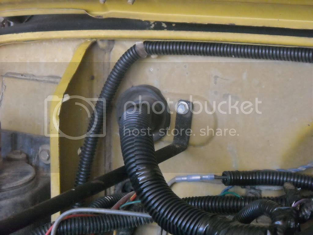

Now it's time to install the wiring harness.
Poke a hole through the firewall into the glovebox. Stuff the wires in.

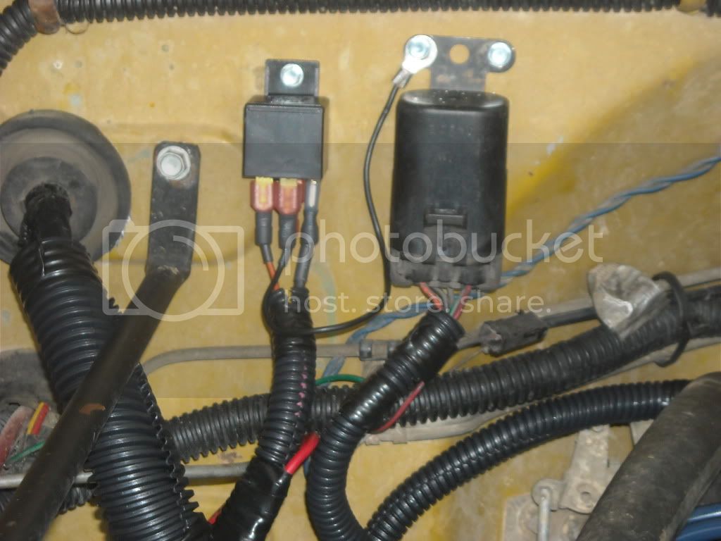

Plug some stuff up.
Mount the relays. TBI main system relay on left. Fuel pump on right.

Modify the throttle linkage.

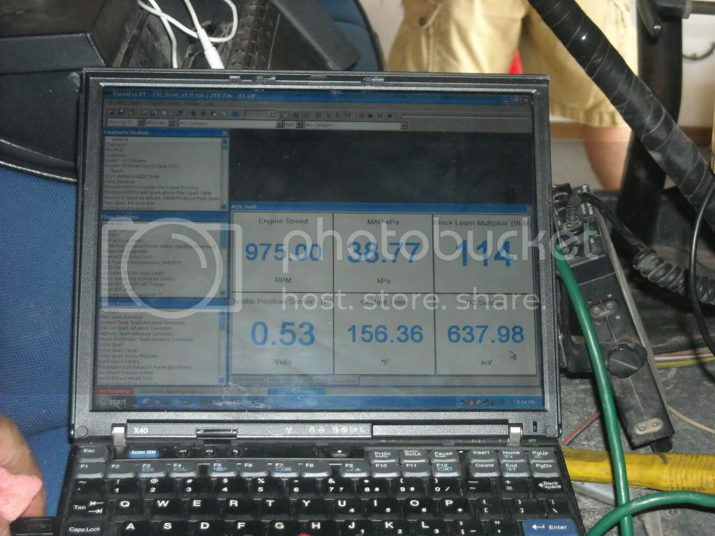

Check the sensors. All looks great!

I watched the O2 sensor and BLM fuel tables during the drive. Tuning is dang near spot on.
