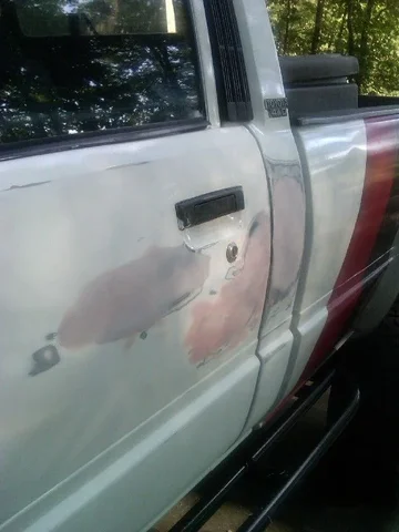

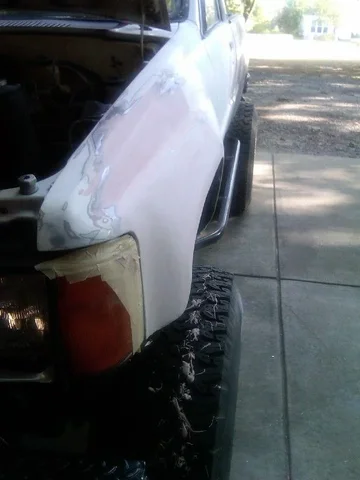

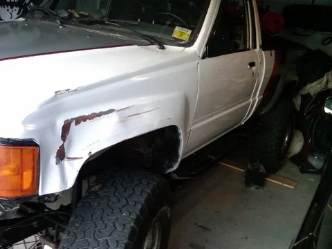

Some further updates!! I took the Bondota up to our property in Caswell County and while out working on some trails, the tcase got into 2wd LOW and the rig walked sideways until I was in a tree pretty good!
Dad has some more picture of the repair stripped down, but this area had been bondo'd previously and really held up!! I know there is concern when using bondo for this type of stuff that it will "pop out" in just such a case but it held up great!
Dad spent about 1/2 day on it yesterday, I could not believe how good / quick he is! The pictures don't do it justice, he is priming it today to see what (if any) more needs to be worked before repainting.
It really is kinda amazing, most of the modern body guys never bother to do this stuff anymore, they just slap on parts off the shelf. This is old school, and rougher than we would do for a resto but perfect for a "beater" truck!

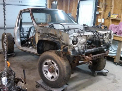

SO... decided to upgrade. If a diesel had dropped in my lap, mighta gone that route but for $250, I picked up an 88 pickup that has been pretty well stripped but has the 22RE (fuel injected) engine and harness/computer, etc.
Tranny and tcase are gone, rear leafs were missing, axle is literally strapped to the frame and the frame itself was so rusted it broke behind the rear axle when loading it on my trailer. (Which was good, it was in the way) Cab is "ok" a few minor rust issues, had good front/rear glass so we are gonna keep it around just in case.

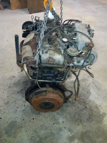

Dad had already pulled the engine when I got there yesterday, I took these pictures earlier in the day, we finished the night by getting it mounted on the engine stand.
I have never rebuilt an engine before, I really am looking fwd to this, engines and trannys are the only thing I am not really comfortable with on a vehicle.
Goal is to rebuilt the 22RE to make it as factory as possible. I want this truck to start and just PURR... I will end up rebuilding the tranny too, and I am "twin stick"ing the transfer case so 1 stick will do 2wd/4wd, and the other will be High / Low (4.7)

The one big thing i learned building a 22r was to use stock Toyota timing parts and make sure that cover is not ate up really bad with gouges from where a chain has been run loose. Those are the key things i remember from building them. Sure more will pop up and someone else will have other things to bring up.
