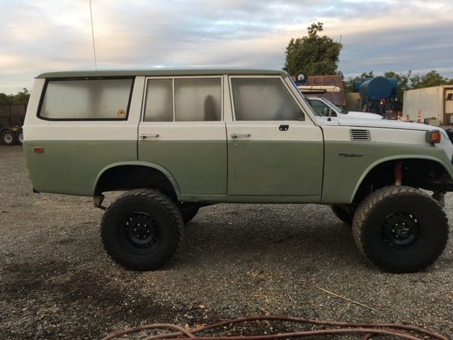

35x12.5x17 BFG KM3
17” FJC steel wheels
Measures 34”x12” mounted on the Pig

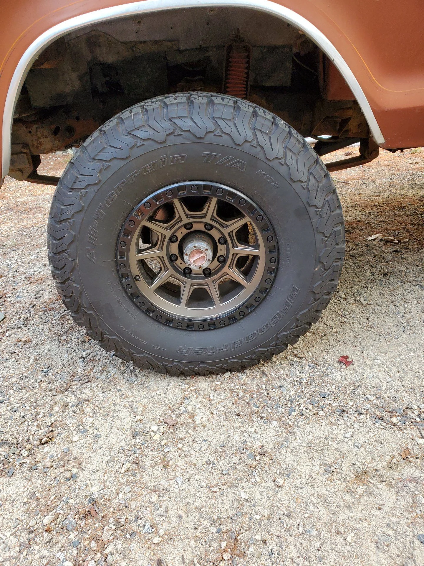

I’m interested in a skinny 35” for sure.
Interested to see how tall they measure mounted

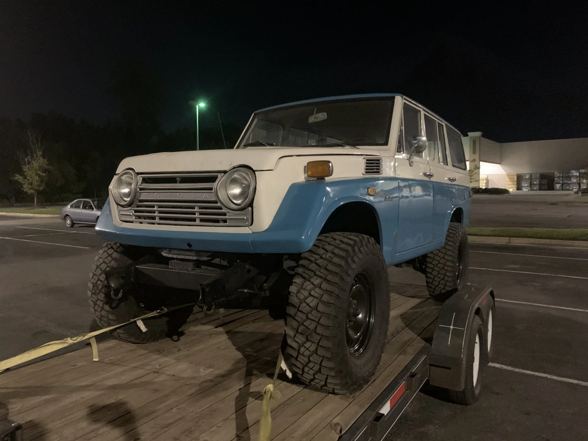

those Nittos look like the old BFG MTs. I dig it. Never really liked the Wranglers and they always measured small.
I got a good deal on these 96% tread 35”s and my pops worked at BFG plant making tires for 33 years.
