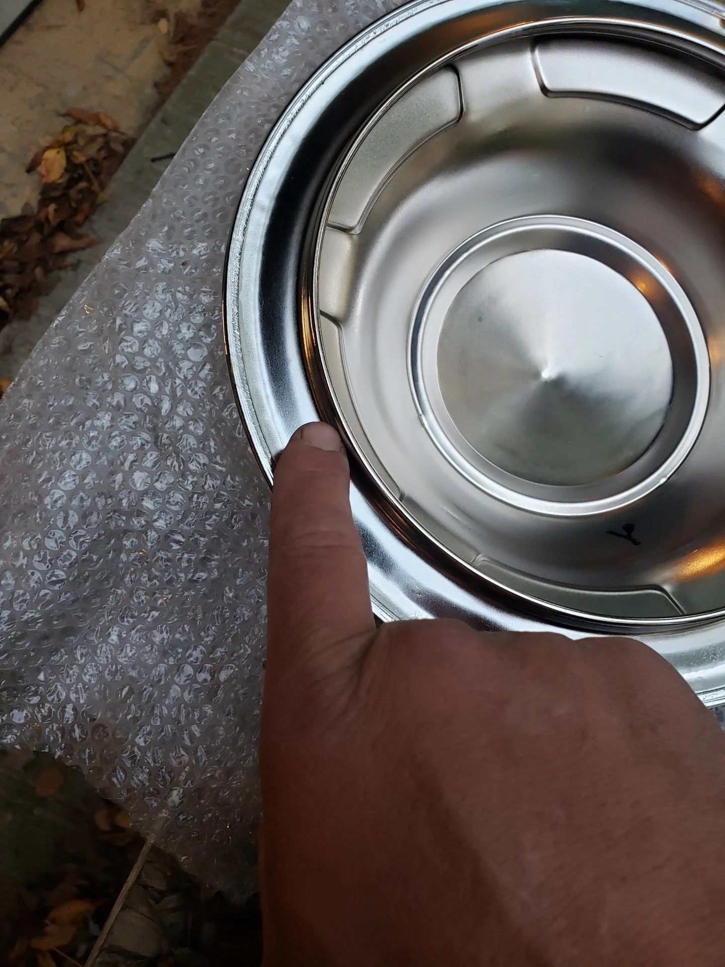

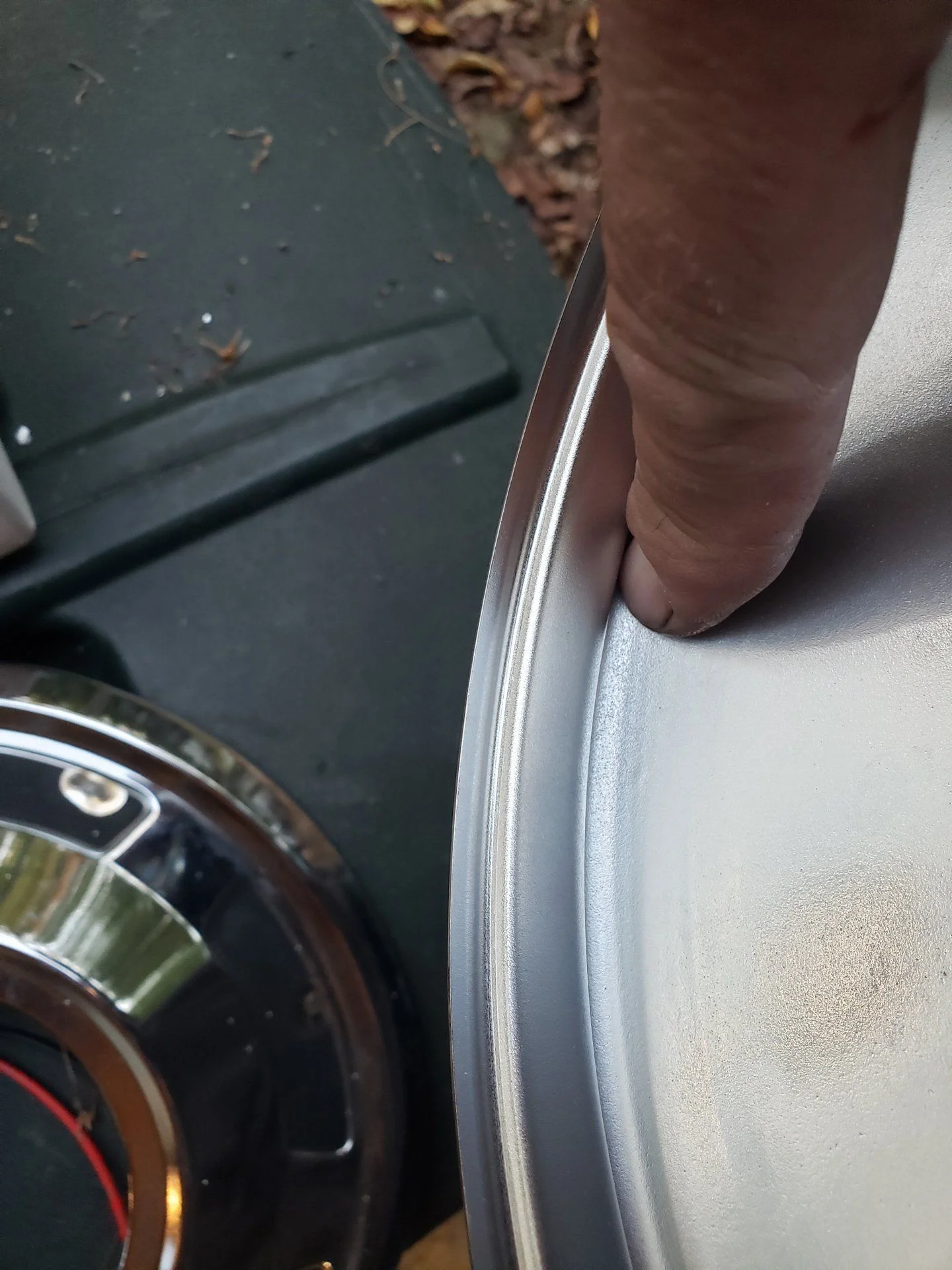

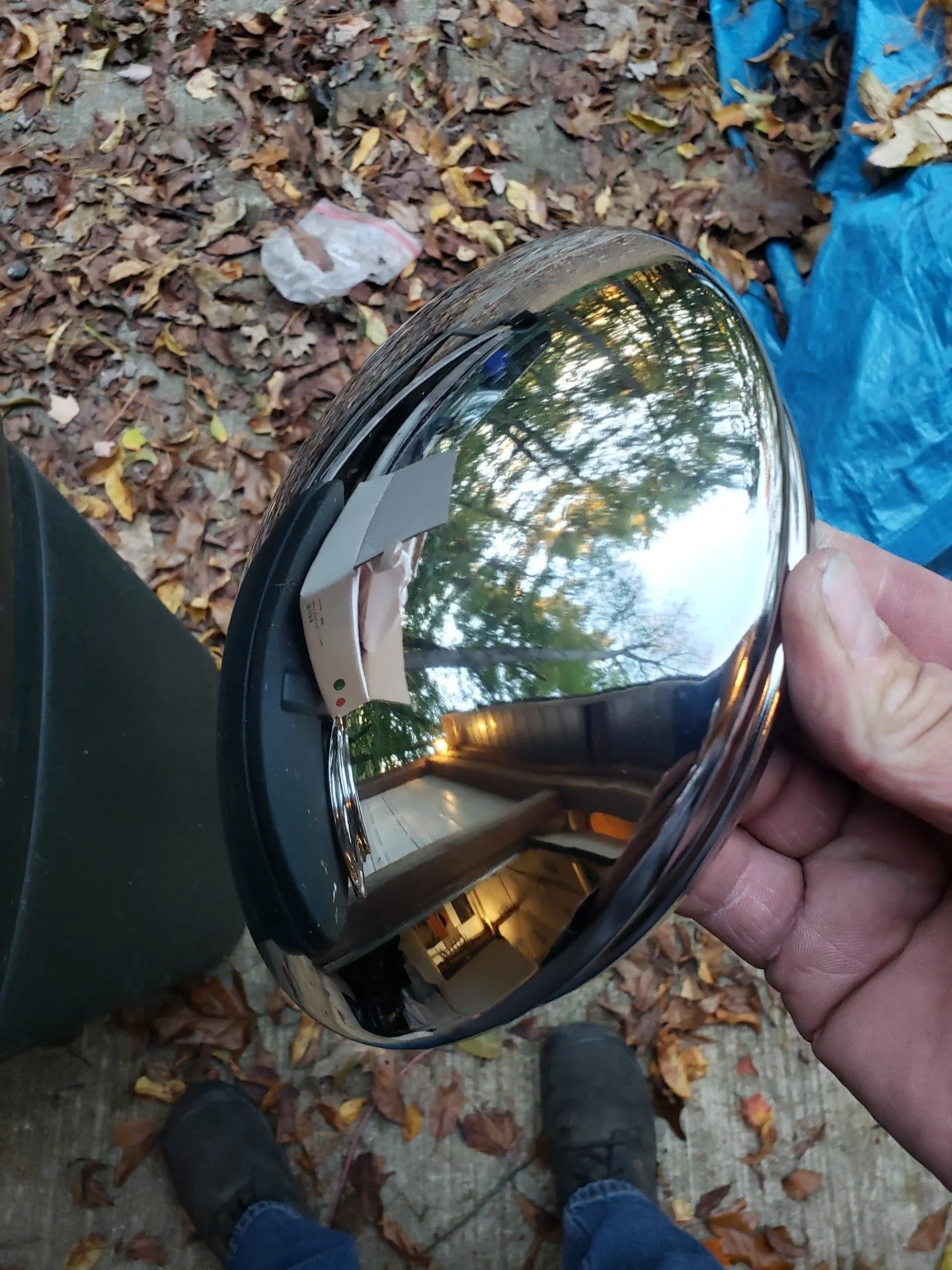

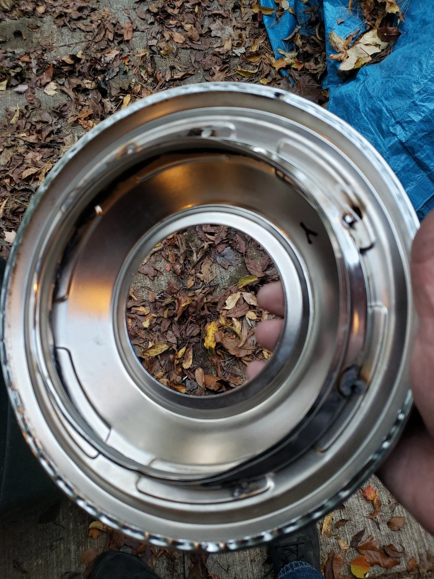

I just snapped these, hopefully it makes sense.
This is the WV smoothie cap
Then cut it with a cutoff saw at this edge
Then take the back out of the factory cap
Then tig the two together under the black part and repaint the black part on the front

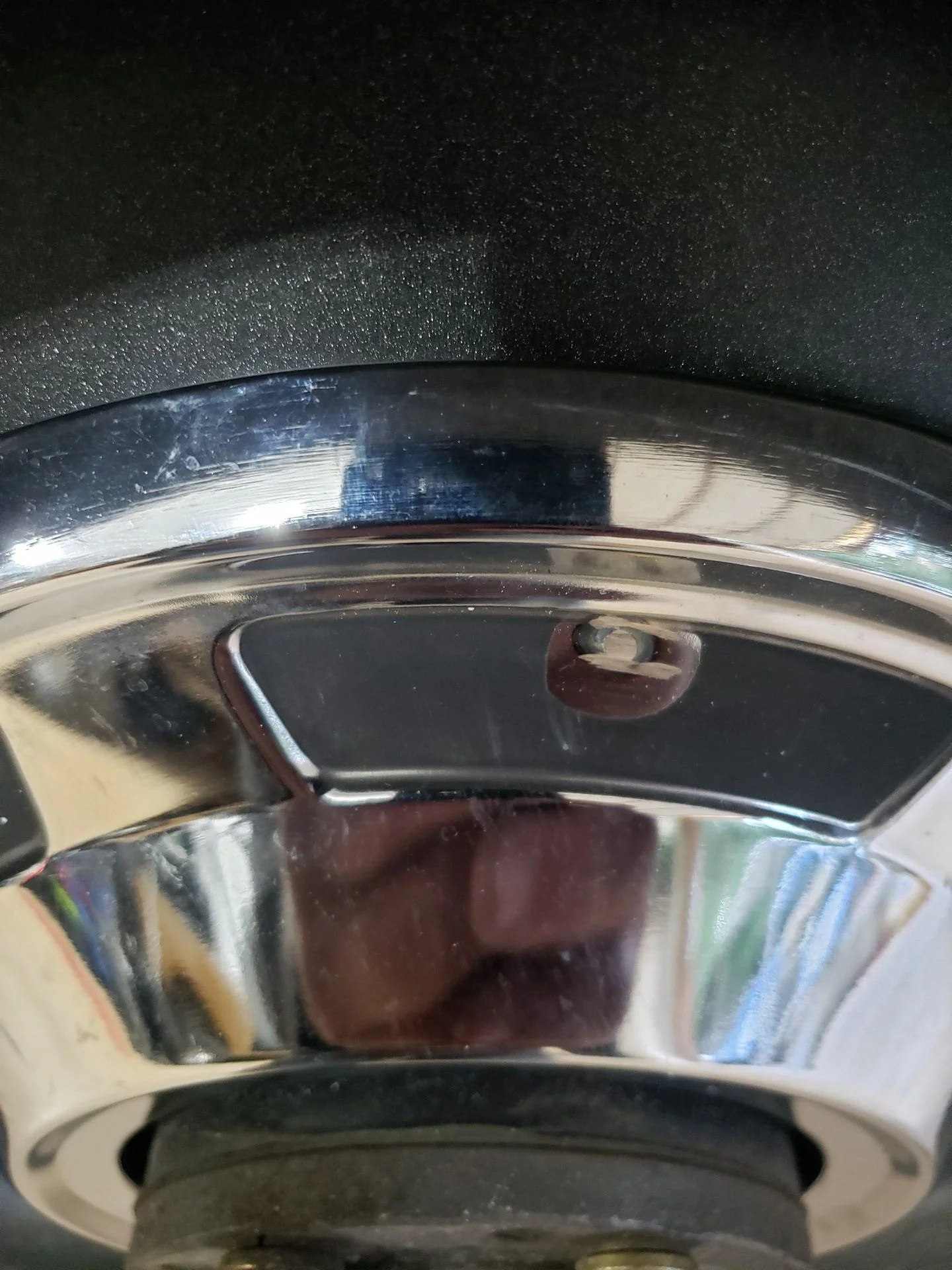

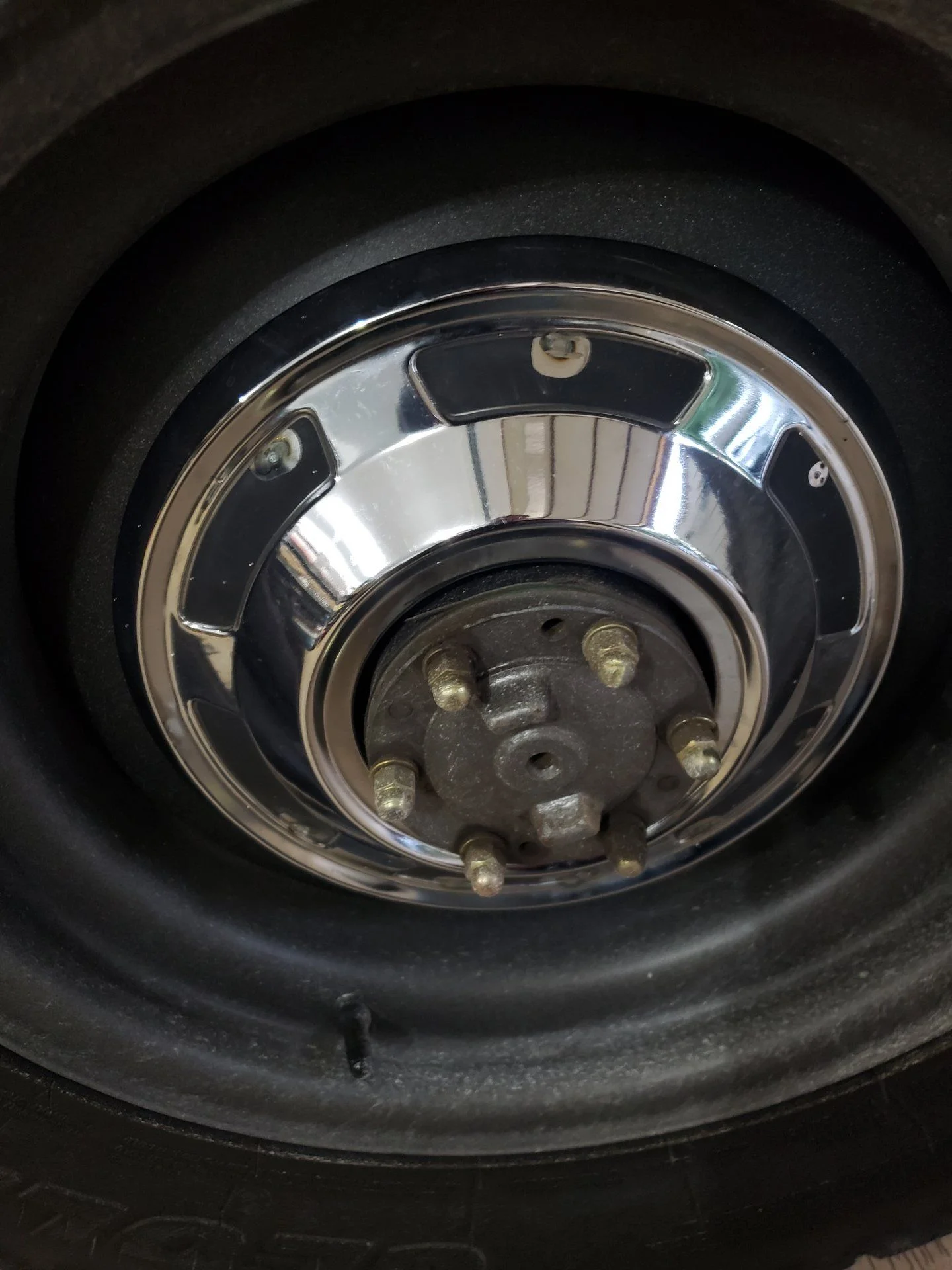

here's the cap on Chunk. Still haven't repainted them
Trying to show in the second picture how there is a tiny bit of reveal there. You really can't see it but it's there.

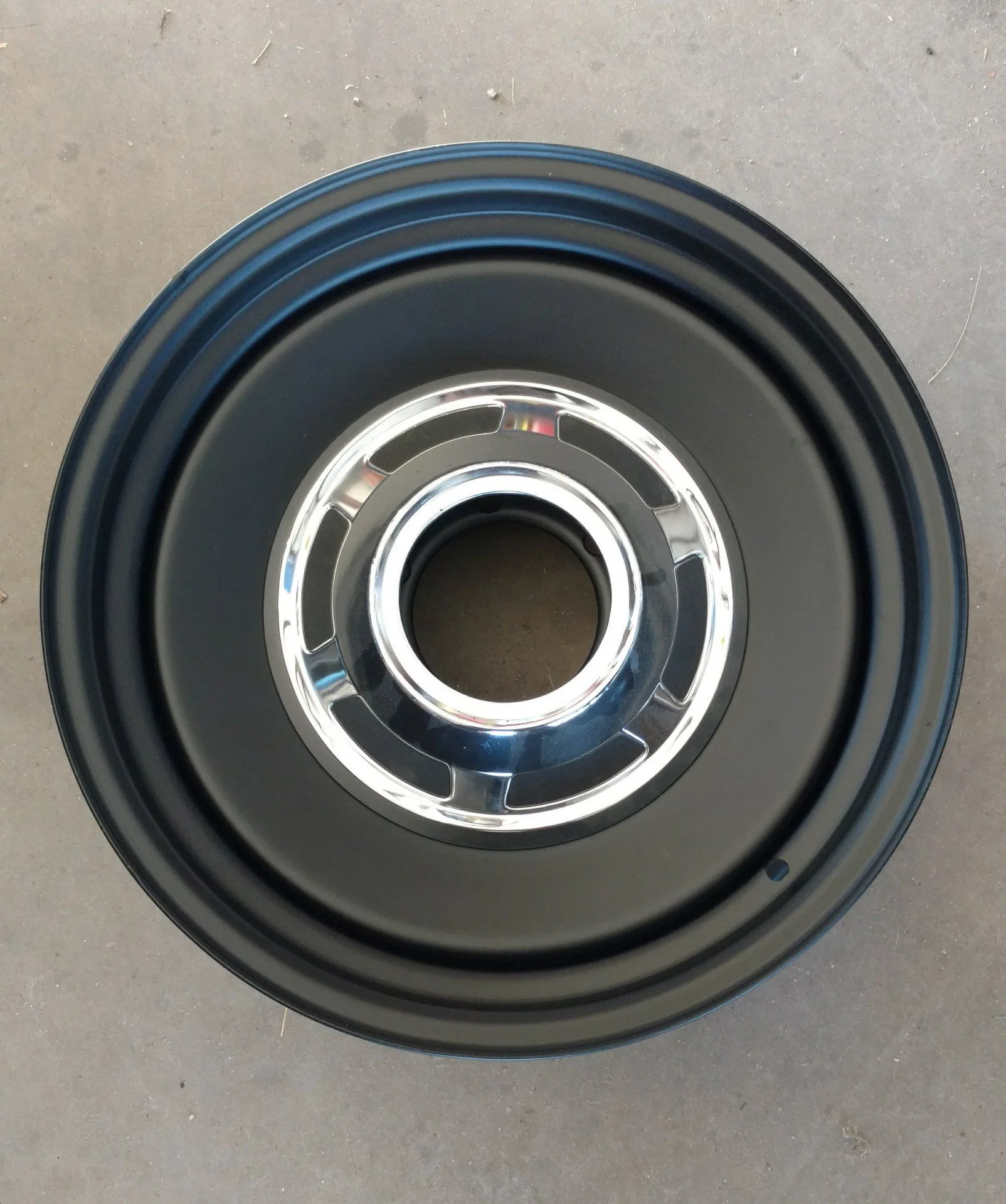

These popped up when we had an FJ Cruiser, might be of interest. A little bit like the fifteen 52 wheels, but have a hubcap.
Those look just about perfect!
They have a 16" wheel with the correct backspacing, I'm talking with them now about a 17" wheel and offered to buy a container full if they'll make them.
