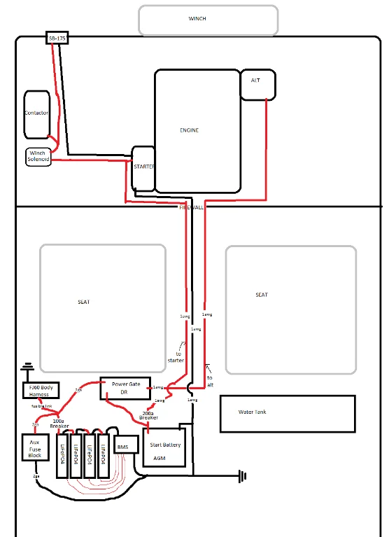

I was able to test the LiFePO4 battery box I made a little yesterday and came up with a plan on how to interface it with my current wiring and hopefully keep the electrical fires to a minimum...
LiFePO4 batteries are the answer to this problem but they need some special considerations on the front side to get all they have to offer, I’m learning as I go so this is an ever changing plan so I first bought a Renogy DCC12 series battery charger (generic 20 amp DC/DC charger) thinking it would help me limit the current to my existing system to something around 20AMPS, in theory I suppose this would have worked but in practice it doesn’t. With the total length of 10gauge wire I tied into I was getting a voltage drop and I was seeing amperage spikes up around 40 AMPS, the DC/DC charger tries to maintain 14.3 volts at 20 AMPS output and will spike the input AMPS when the input voltage drops. My only option if I wanted to keep potential trail issues to a minimum was upgrade the wire size to #8. This is my fifth or sixth attempt to lower the voltage drop and I’m a little pressed for time now and needed to just get something usable for the upcoming camping trip so this is where I’m at now.

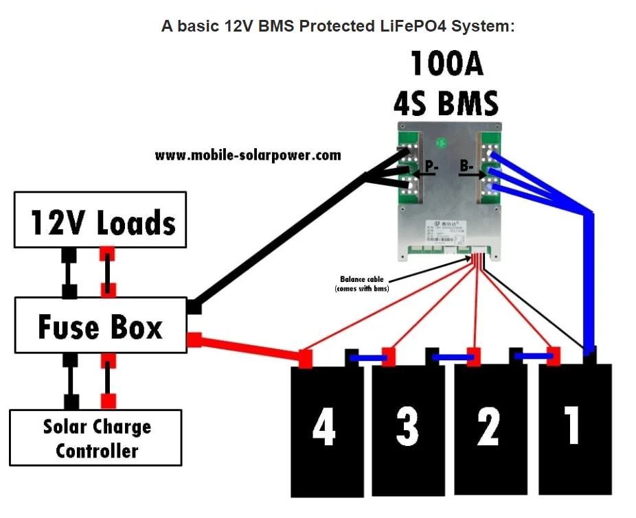

LiFePO4 batteries the way I’m buying them are almost perfect for mounting them in available spaces in the cab of a 55 or a 60 in Johnny’s case, you need 4 cells (Nominal Voltage: 3.2v per cell) and can configure them to lay flat @ about 1.5” tall if you were mounting them under a seat.
This is the specifications for the 100ah cell that Johnny used:
Minimum Capacity: 100ah
End-of-charge Voltage: 3.65v per cell
End-of-discharge Voltage: 2.2v per cell
Max Continuous Discharge current: 200A (2C)
Max Discharge Surge: 500A under 5 seconds
Standard Charge current: 50A (0.5C)
Max Charge current surge: 100A (1C) under 10 seconds
Charging Temperature: 0 to 50℃
Discharging Temperature: -10 to 50℃
Dimensions: Height 11.5″, Width 5.25″, Thickness 1.5″
Weight: 5.85lb per cell
So as you can see a small lightweight battery with a true 100ah capacity that easily tucks into an available space is going to be about perfect for a second battery in a camping rig.

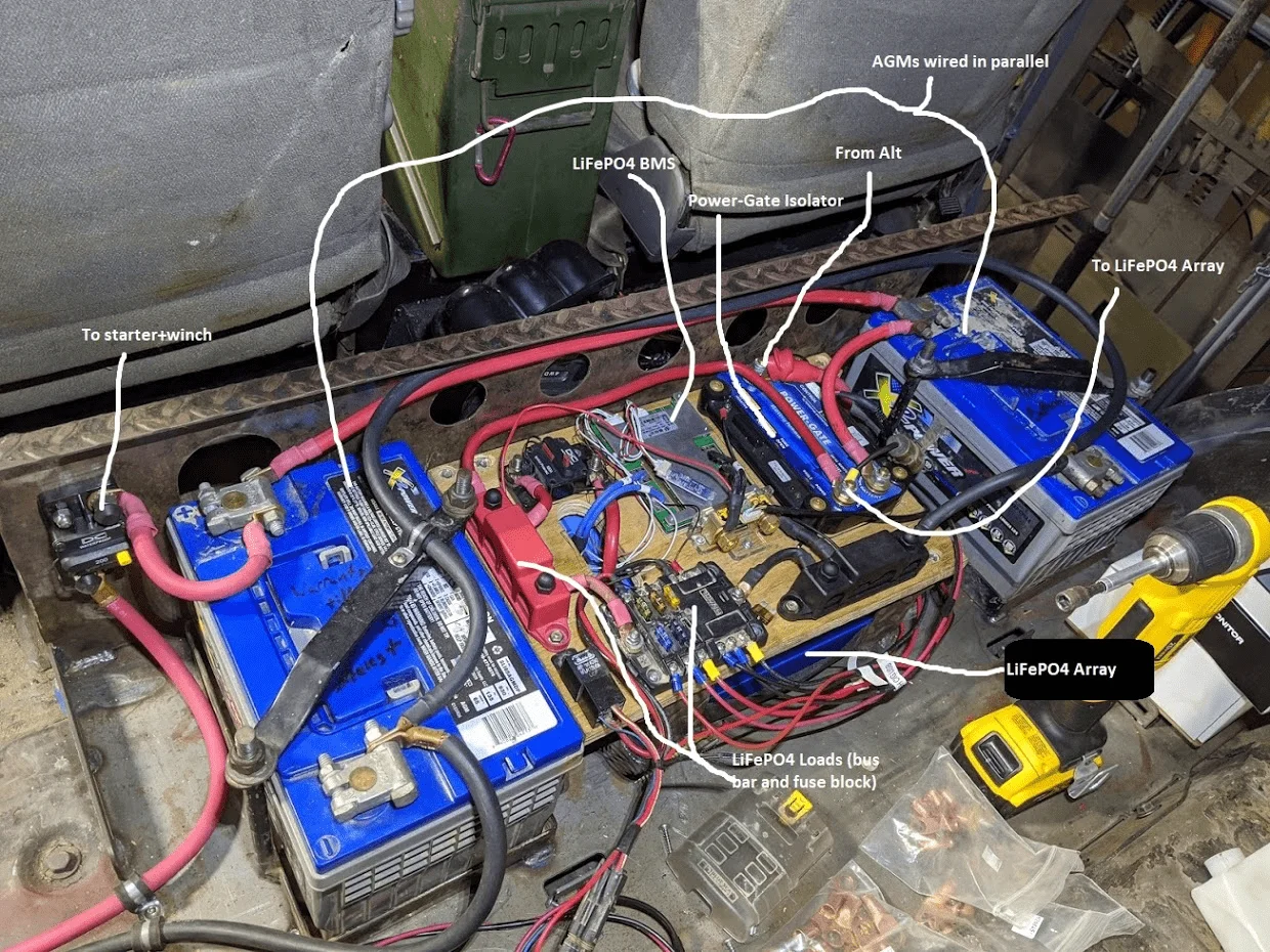

My ideal system would keep the “start” battery in the factory location and let it continue in its role as the “start” battery and add a LiFePO4 battery second battery to run everything else, these two batteries can be combined with something like the power gate battery isolator like Scraps and I use if needed when one runs too low to do what you need. This would not only be easier offering more mounting options but offer 4X the capacity (the only reason to add a second battery in the first place) at ¼ the weight of our standard Pig sized batteries. (About 30 usable amp hour)

Wondering more about how to interface the battery box w/ your current wiring. I don't remember, but I think you were running an AGM as your primary battery. My limited understanding is that trying blend different types of batteries sets up quite a challenge in terms of charging and battery management. I am curious what logic you will arrive at for charging when the engine is running and isolating the batteries...
Is the Renogy just for charging the LiFePO4 battery pack? Or is it a "gate" that manages input and output?
When you talk about limiting the current to your existing system to 20A, are you talking about output from the Li pack?
