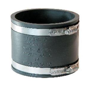

The method mentioned above looks like this;
Just use a Sweep T, two nipples glued in and two double clamp rubber Fernco you can pick up from home depot for about 6 bucks a piece.
You don't need that 4 clamp set up. That's for pressure lines.
