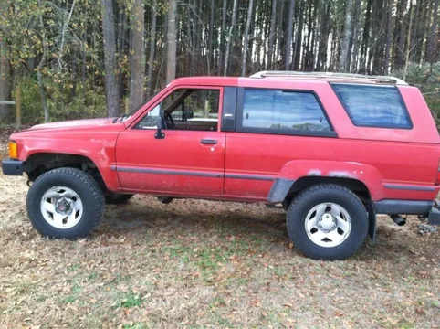

image-2254615265.webp These came from a, I think, 05 Taco 4x4, keep in mind these do throw off the speed O' on my 86' 4 Runner
I'm a bit leery of the 17s, as I think it is a bit less common of a tire size, and the cost of tires will be higher. I thought a lot of those used were 16s. I was mistaken. Why would so many of the 17 alloys be hitting the market? Any thoughts on the pressure sensors?

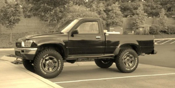

I've been running the split spokes on my pickup for a year or so with no issues. Interesting that you are rubbing. This the same wheel?
Not the same wheel. I tried to find those, but not many available here. I got 4 new Tacoma 16 x 7 alloys. They are 5 spoke. Looks like a 1/4 inch spacer would be enough to eliminate the scraping. Only the balance weight makes contact. My manual hubs were a bit of a tight fit, but still workable. I will attach a photo of the rims.
@Jinx. What size Cooper tires are those? I'm looking to replace 6 tires in the spring.
They are 265/75R16. They fill the wheel wells nicely and don't rub. I can tell a slight difference in power, but I have 4.30 gears and a 5spd so not quite as noticable as 4.10 I'm guessing.
Those are good looking wheels. Look forward to seeing them all mounted up. It is cool to see how the newer wheels look on the older trucks.
I've got the same wheel style jynx has, in the less common 15 inch version, on my '92 pickup. The 265/75R/16 tire is listed at 31.6 inches in diameter. Too bad you need a spacer for the newer wheels. Wonder what the actual backspacing is.
