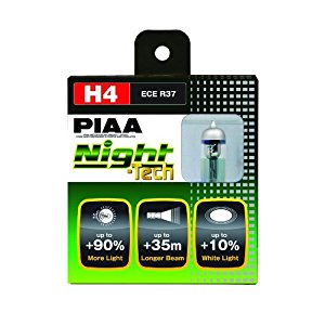

I have the Piaa Night Tech bulbs in my 4runner, they are a great replacement that will work fine with the stock wiring.
Keep in mind, if you go to a higher wattage bulb you will definitely have to run a relayed harness or you risk burning up the stock wiring.

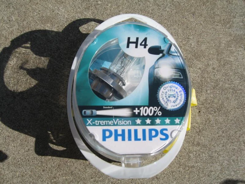

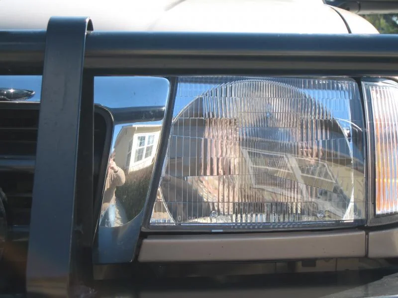

Finally got the time to replace my old, hazy yellow lenses and ordered up some Phillips bulbs at powerbulbs. looks like new again and a much brighter, cleat white light.
