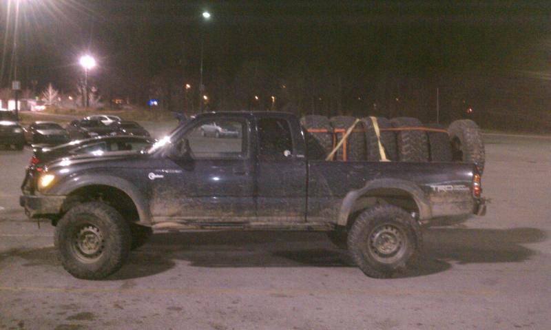

Then i drove home from the University of Arkansas, to my Farm in Missouri like this
Normally an hour, it took me 5 hours. And almost a full tank of gas (filled up at the half way mark, was at halfway when i pulled in the driveway.)
