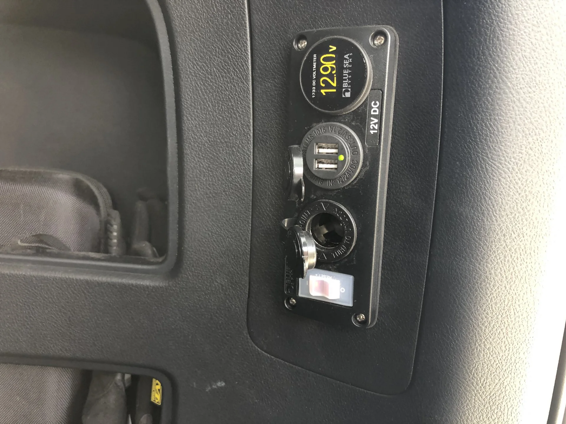

Just set mine up to cargo area with 10g awg wire direct from battery to blue sea 15a switch/ breaker panel with 12v plugs and usb ports. Switchable but as of now only from cargo area. It would be reasonably simple to relocate the blue sea switch breaker by itself to the front of the cab if wired direct from battery.
I’m late on updating. I’ll try to get some pics loaded later.
Something like this?
I run one of these switchable Blue Sea Panels (4366) in the back of my 4Runner. I'm about to put one in my FJ40 as well. Run a power wire with an in line fuse (15 amp), ground, and you're done.
Blue Sea 4366
They make a few different versions. The 4366 version has a voltmeter, dual USB ports, 12V socket, and a 15amp breaker switch.
