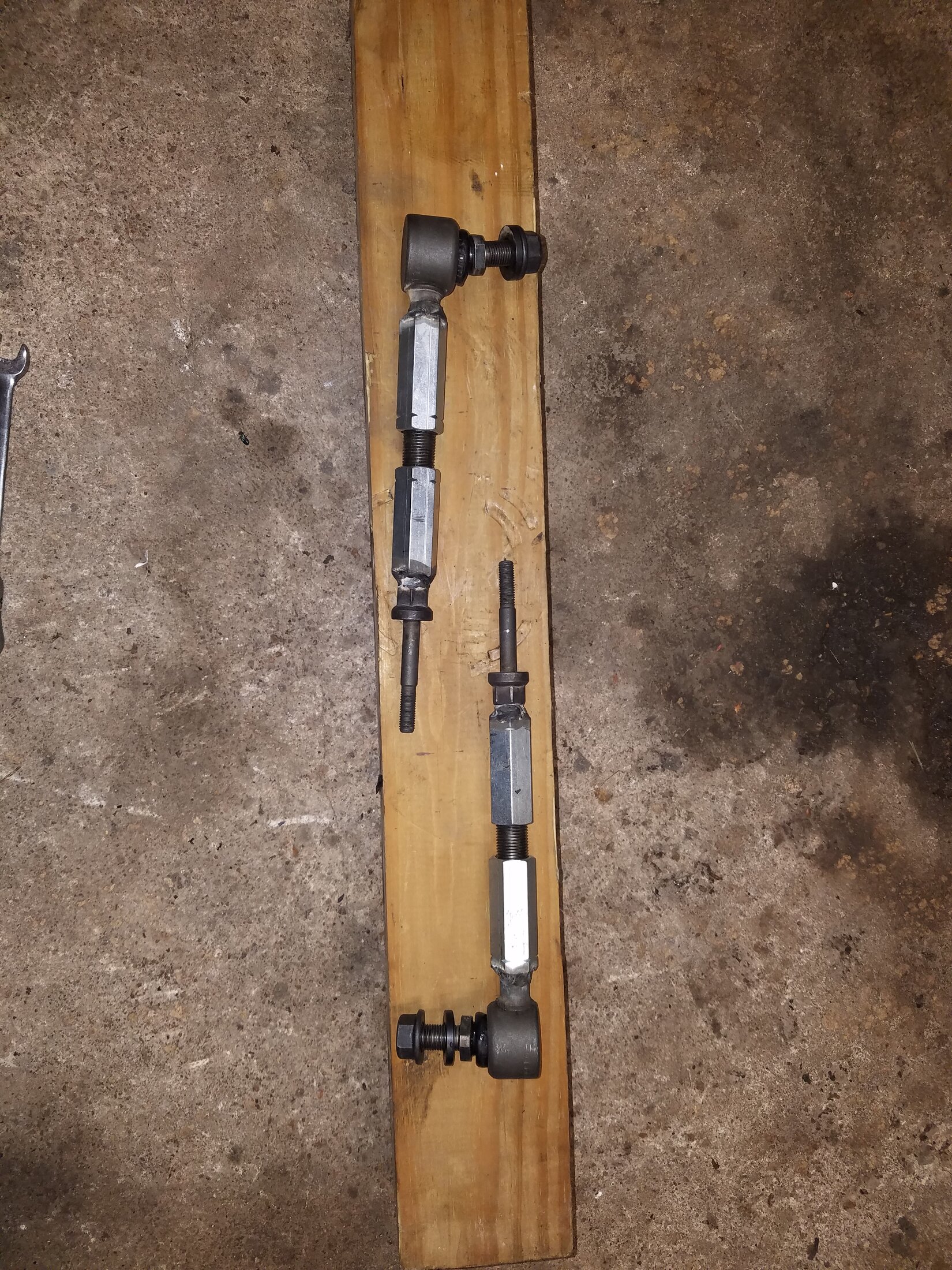

Apparently 3rd gen T4R links are longer than our links and will work in this application. I have not verified this, just saw someone else on this forum mention it. I DIY'd a set of rear links with some all thread to make them adjustable. Otherwise, all of the aftermarket extended links are quite expensive (around $200).

The DIYs I made were based on a Moog end link, which was a mistake. The grease boots immediately blew out. I may replace them with the 3rd gen 555 links in the future - and honestly they would have been cheaper than DIY'ing a pair as I had to but some long threaded couplers and allthread.
Rednexus Offroad Fabrication! Nice
