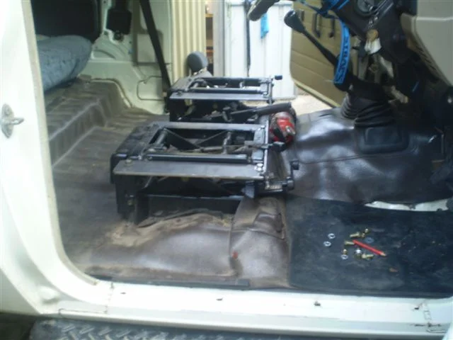

I'm contributing this because there doesn't seem to be enough pictures of this process out there. This is the installation of suspension seat frames into a non-suspension-seat BJ73 (1985, if it matters).
Pull up the carpet - the non-suspension trucks have towers welded to the floor that must be removed. There are three - one at the rear inside corner, one at the front outside corner, and the rib over the tranny hump that needs shortening. In truth the front-outside tower can probably be left in place, but I removed it anyway.
I used a reciprocating saw because it was fastest. Worked great.
On my truck, at least, all of the necessary captive nuts were present under the floor. Others have said some, or none, are there on their trucks - might be a year or 73/74 thing.
I drilled a pilot hole from the bottom, and then drilled to the full diameter from the top. And then some grey primer because I had it laying around.
Fits perfectly.

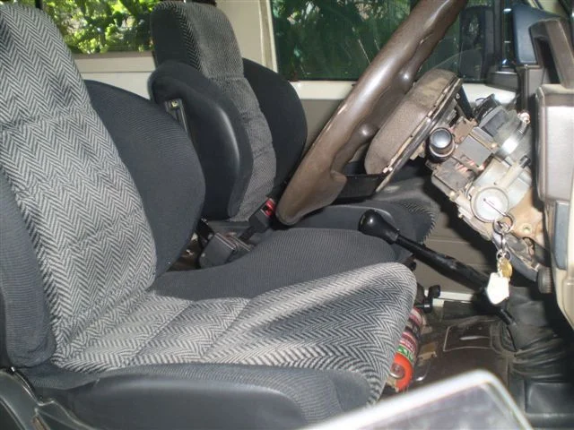

Suspension seat reference pics

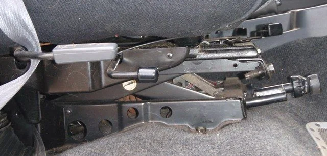

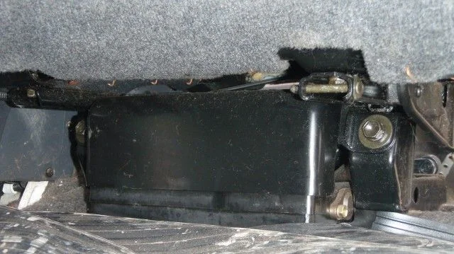

Drew, let me know if you need any close ups of anything. These were taken of the DS seat:
- side
- front left
- front right

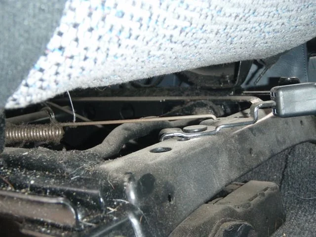

- back view
- close up of back of inner side of seat
- front view of space just below seats
