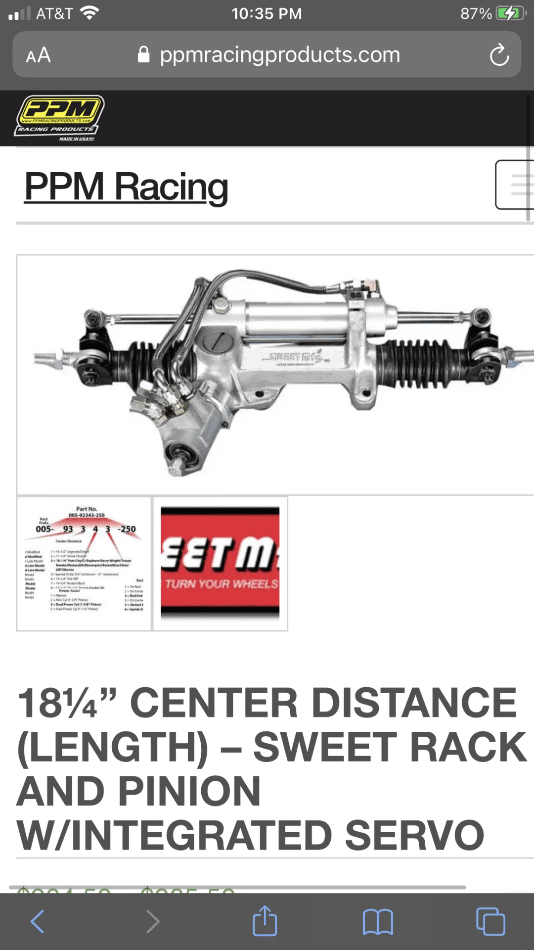

And I’m starting to gather parts. might use the factory steering box or do something like below. Guess I should have got more parts off of my mk3 supra when I started.

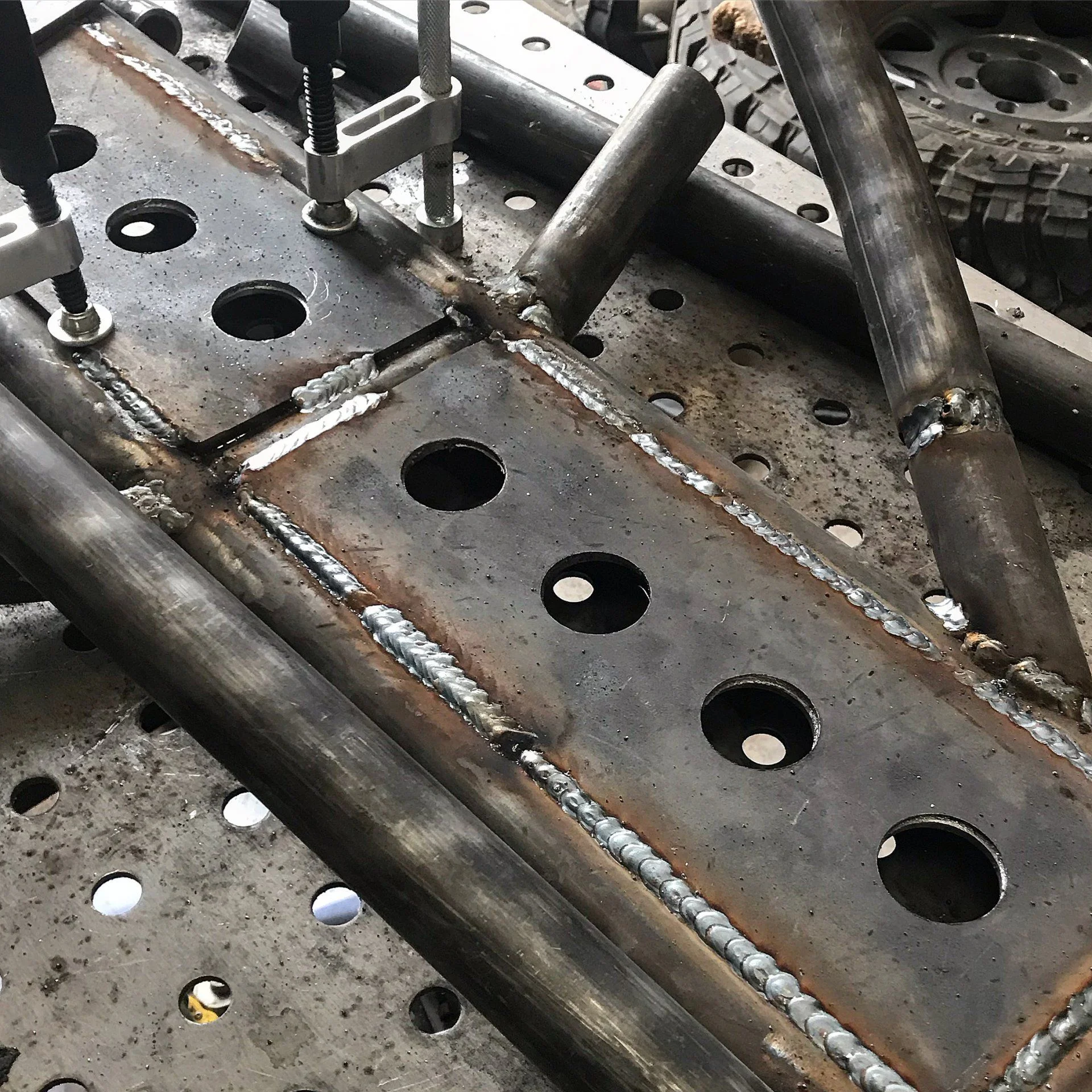

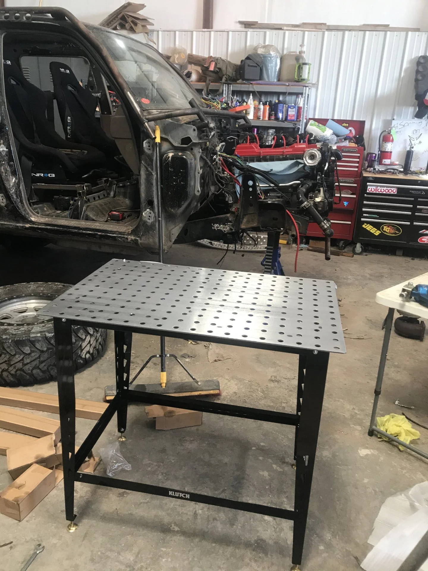

Another small update! Everything is as straight as I can get it with the tools I have. Had to get creative with the table and an angle finder. The
trailing arms are in the works rn going to finish mounting the rear axle this week now that the engine is mounted. Got one lower control arm done roughly to eyeball track width(90”)

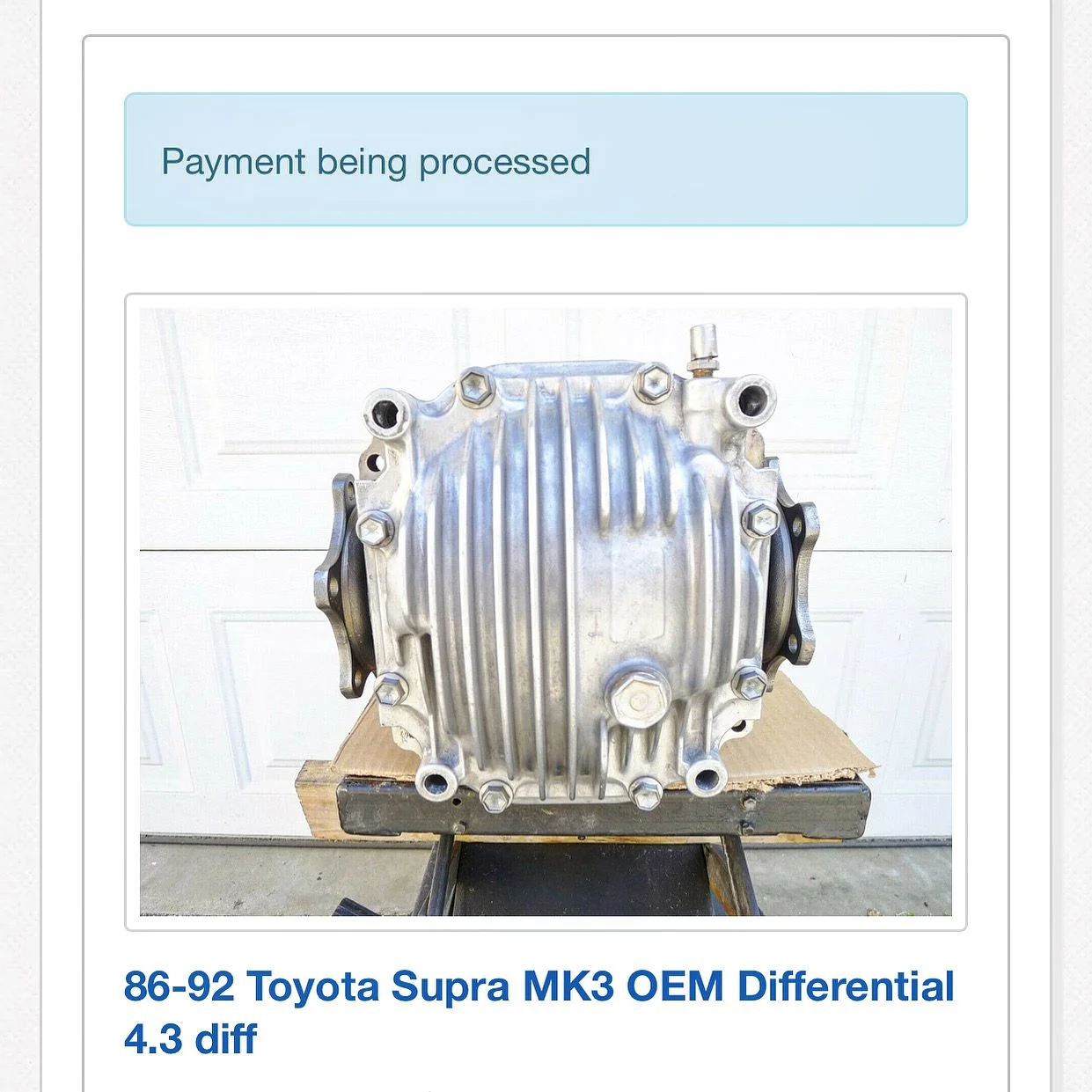

The 100 series 30 spline axles plug right in to the Supra mk3 rear diff as they should it’s the same diff just different housing

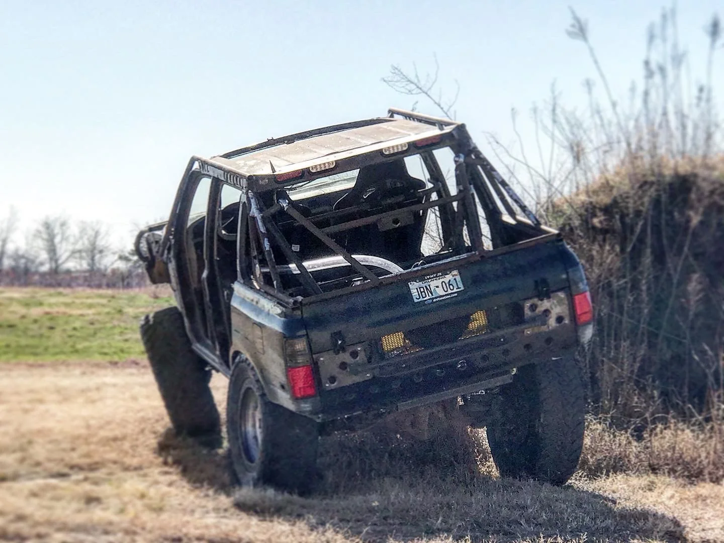

Slightly more official on mud
