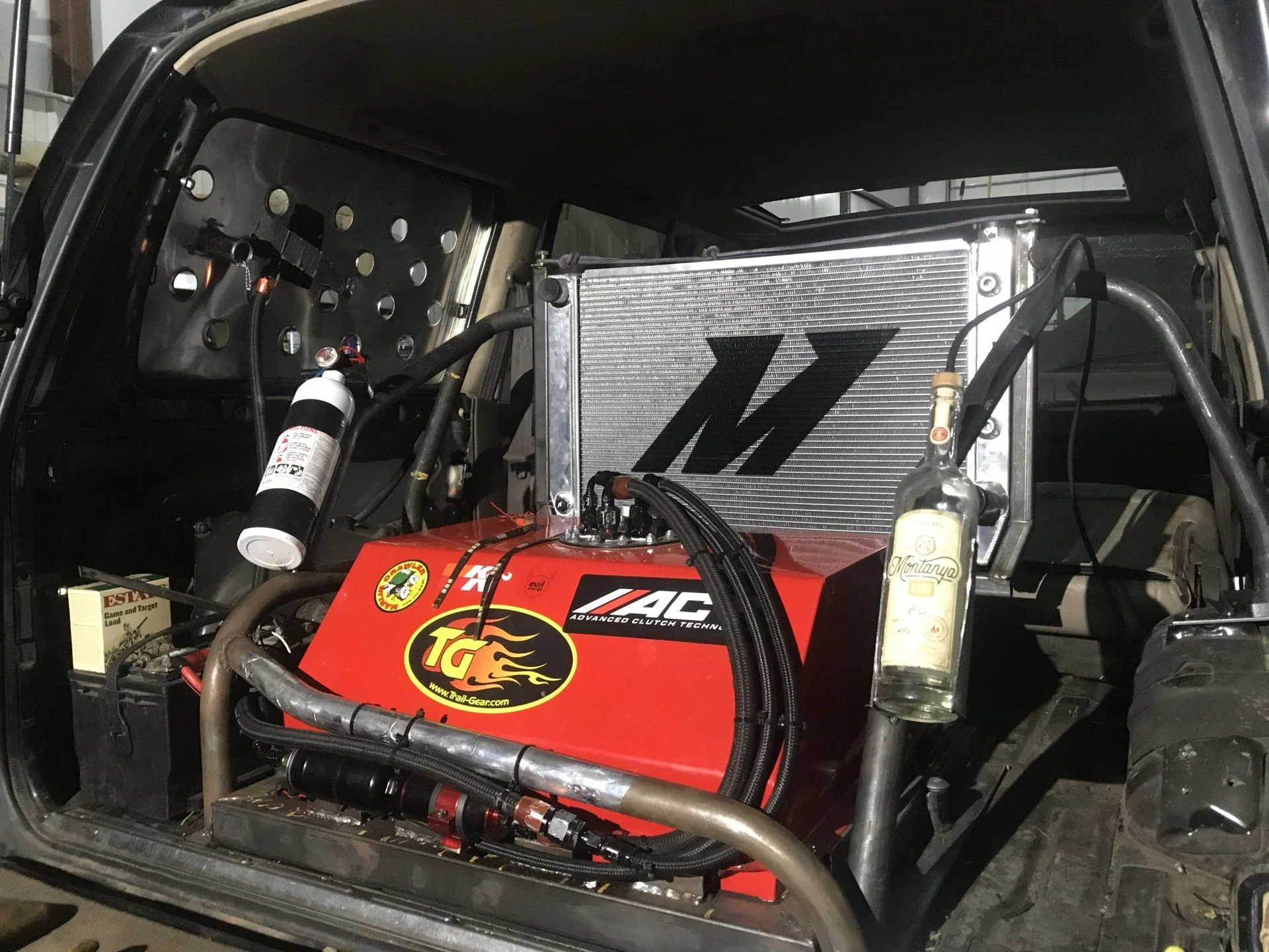

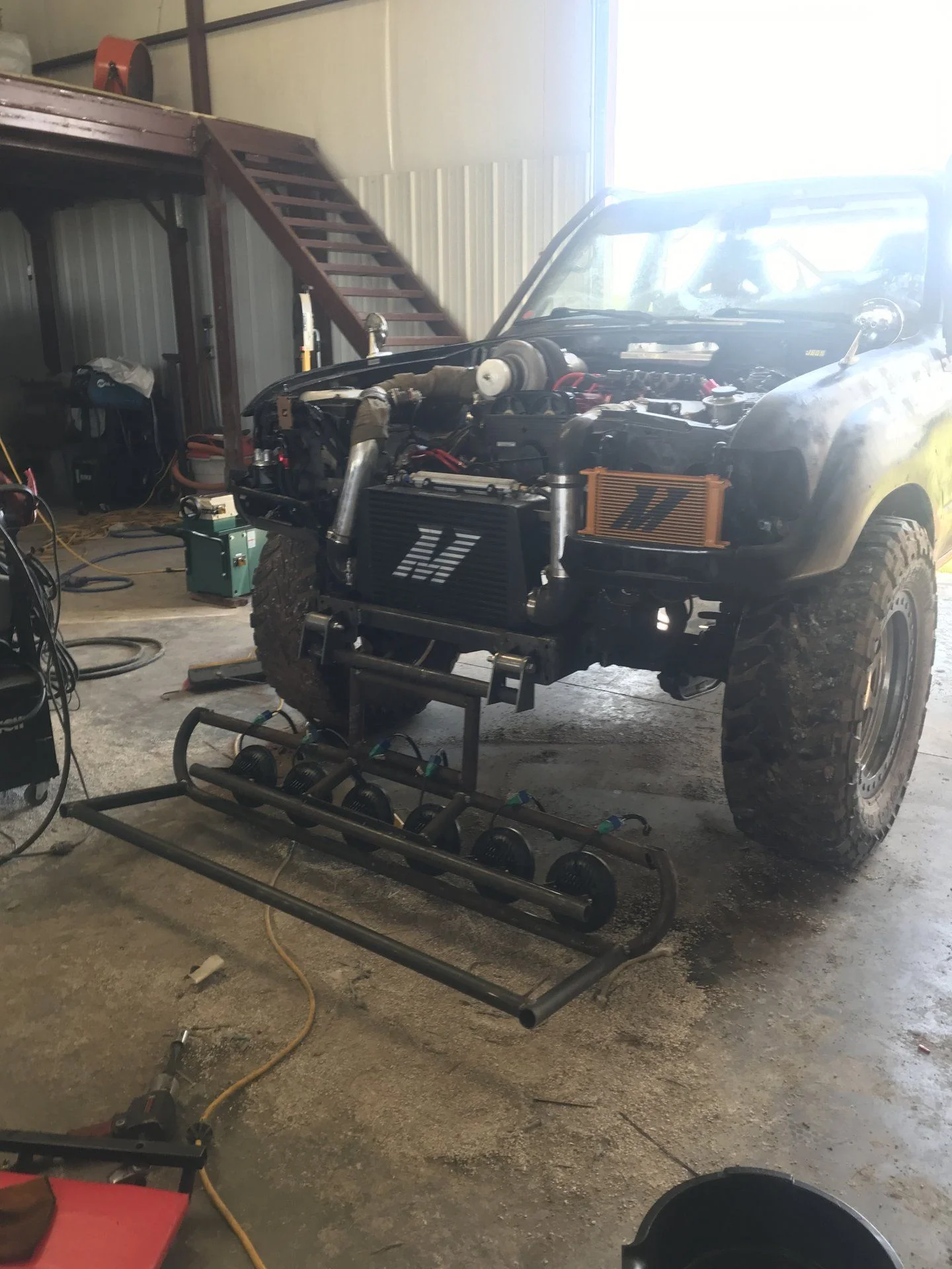

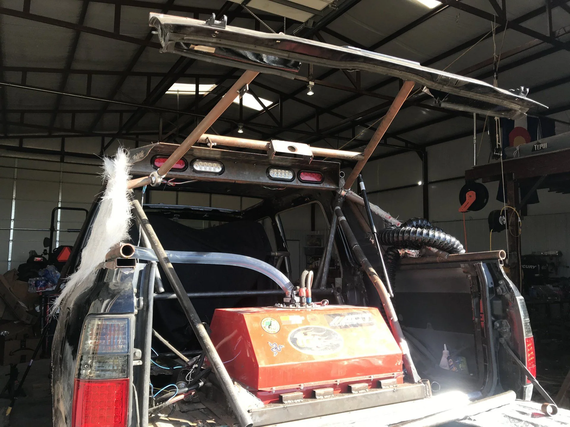

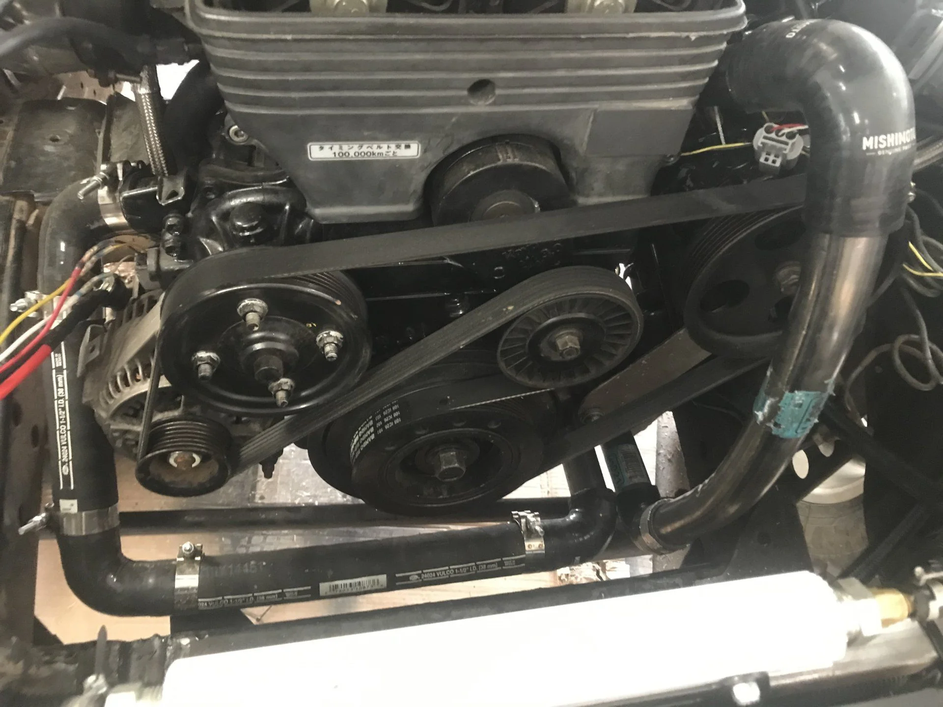

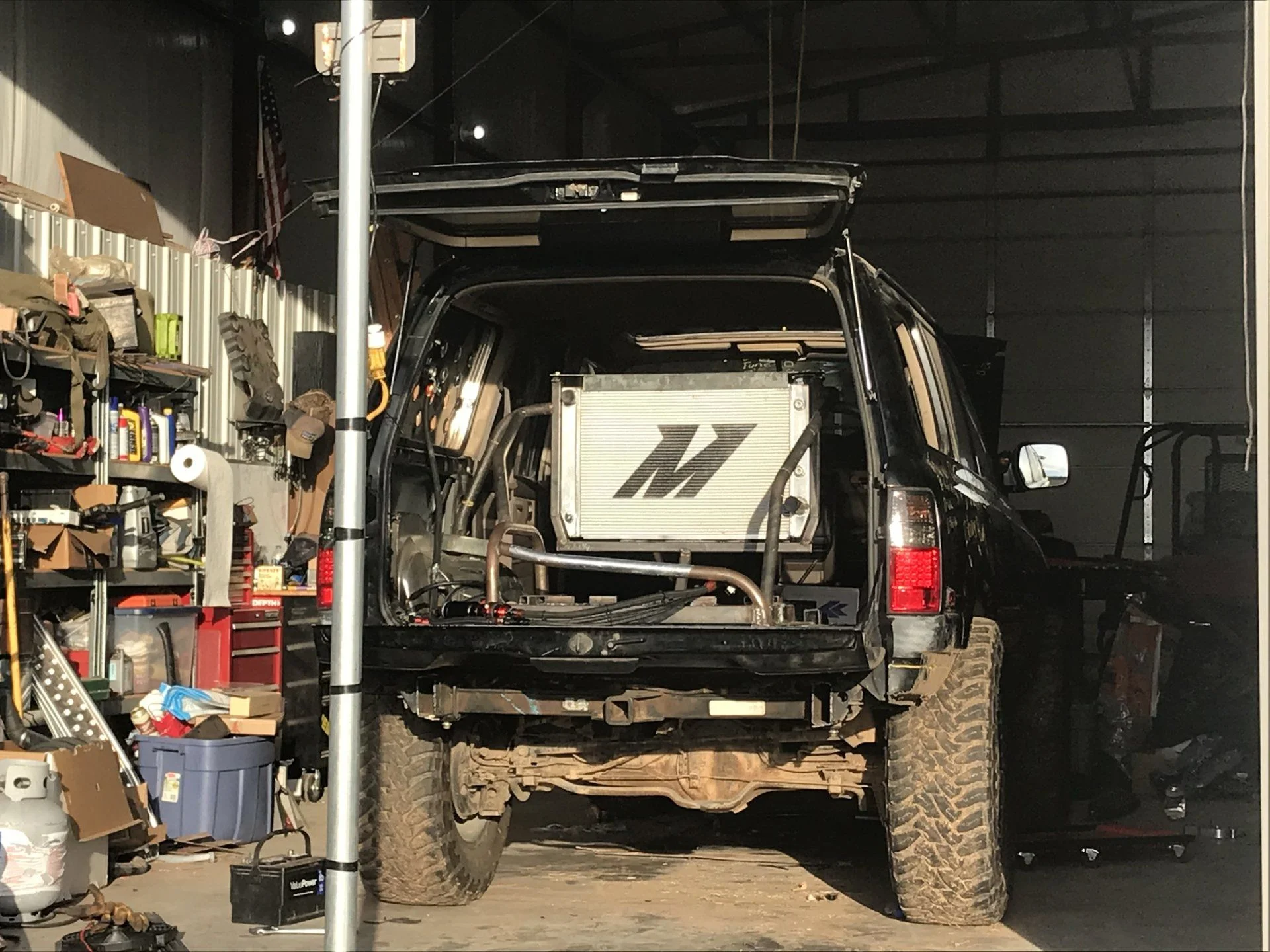

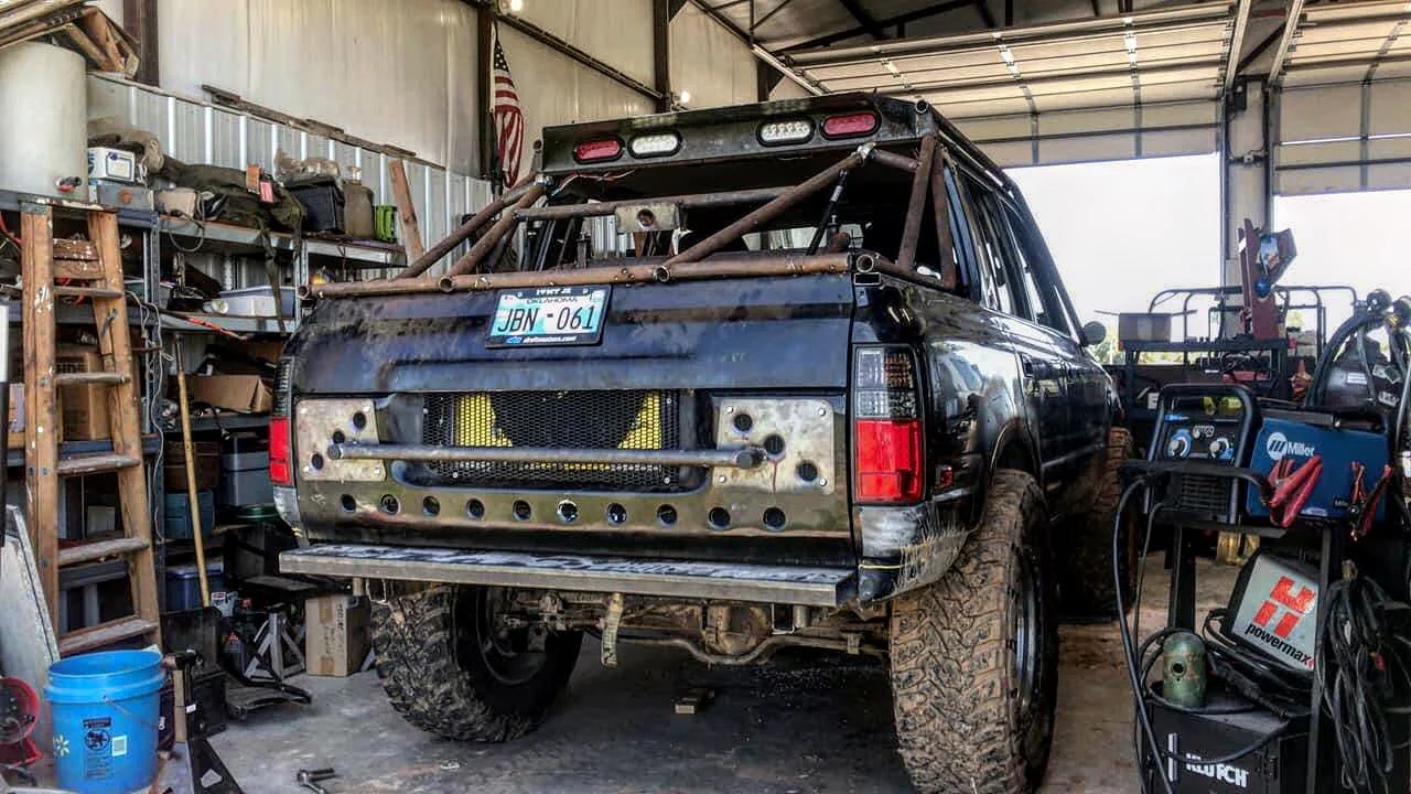

“Big boy radiator” Position is finalized
Radiator is mostly plumed waiting on some connectors
Radiator is mounted

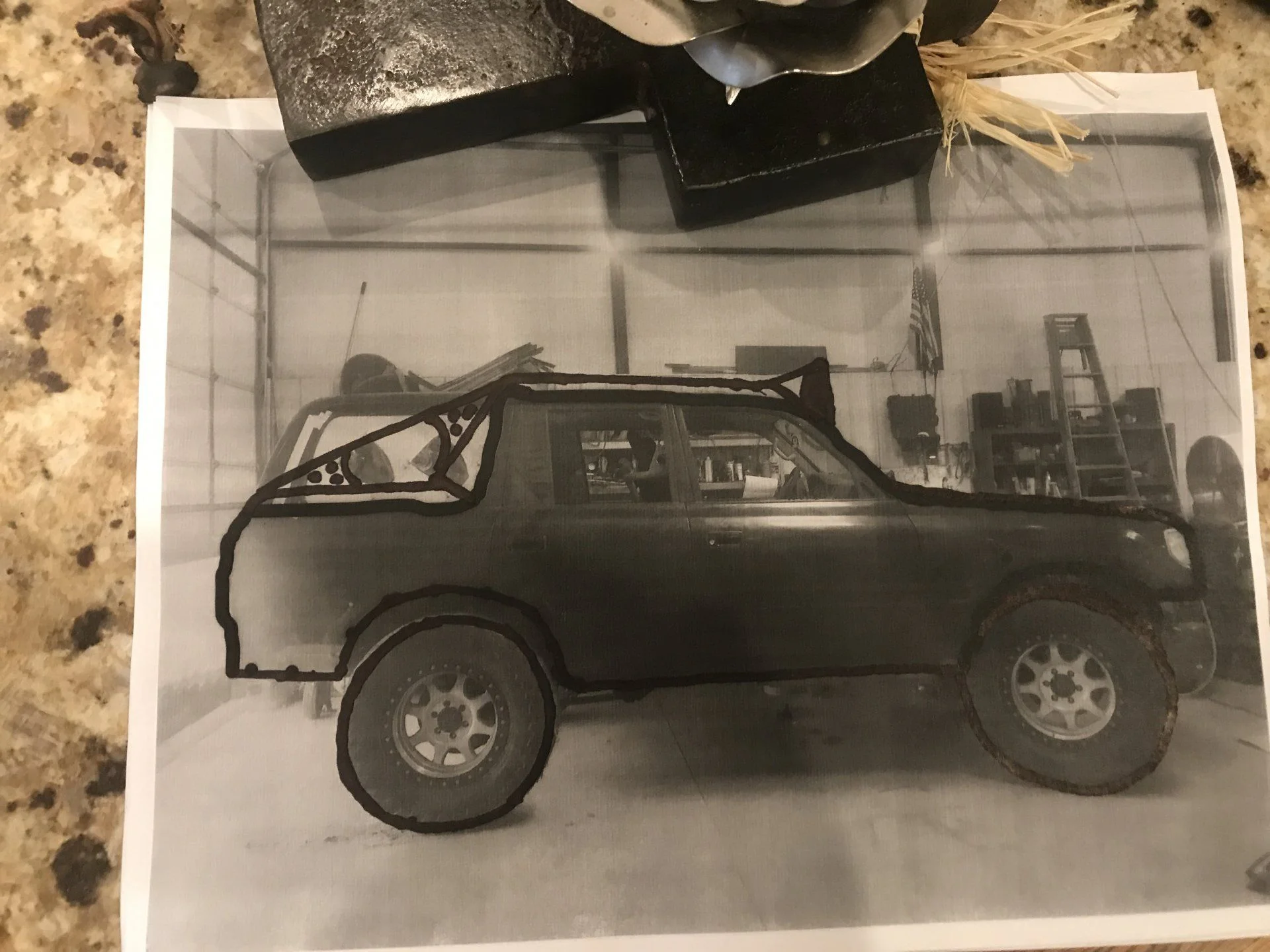

will build shroud soon and do ducting

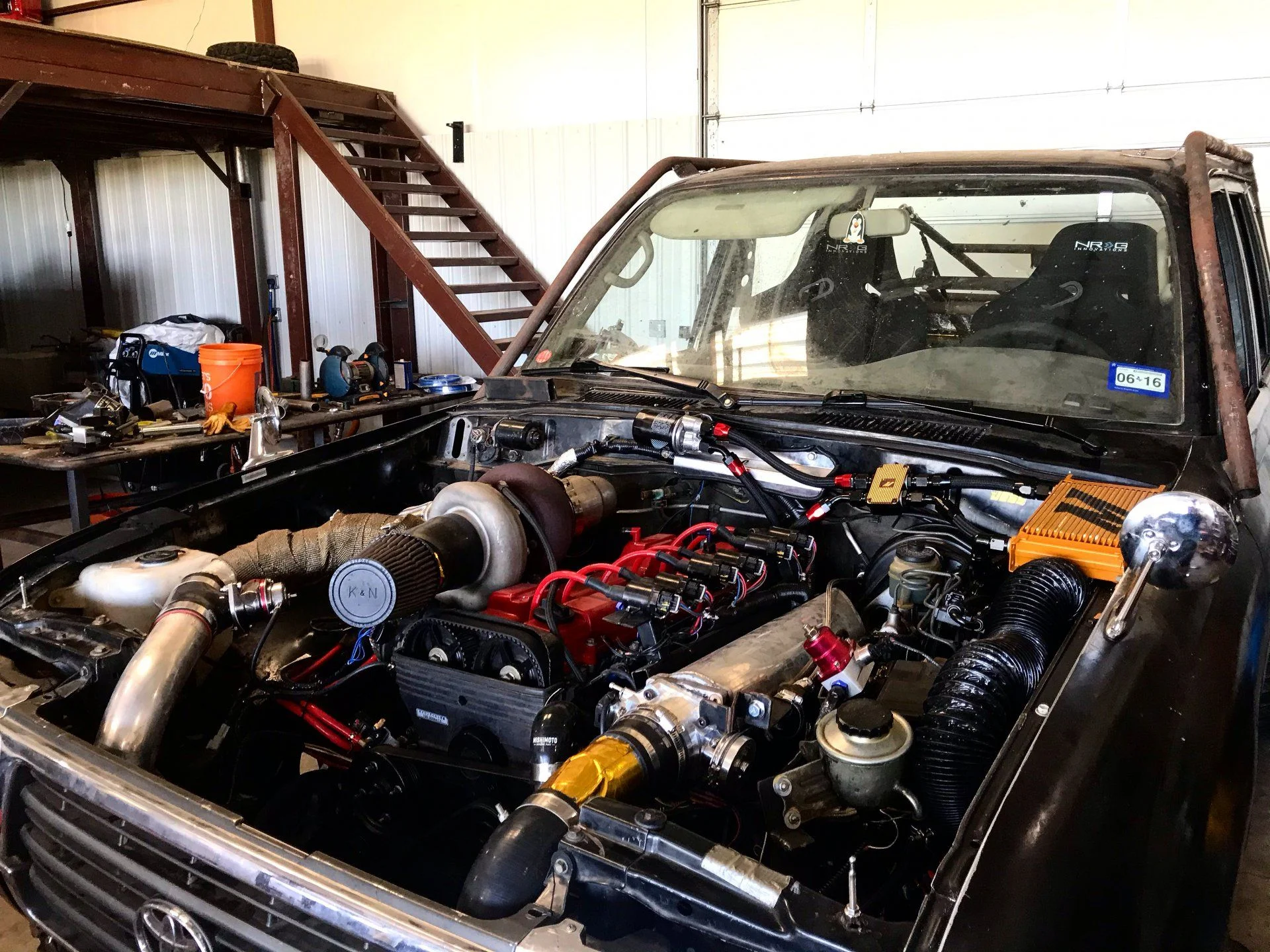

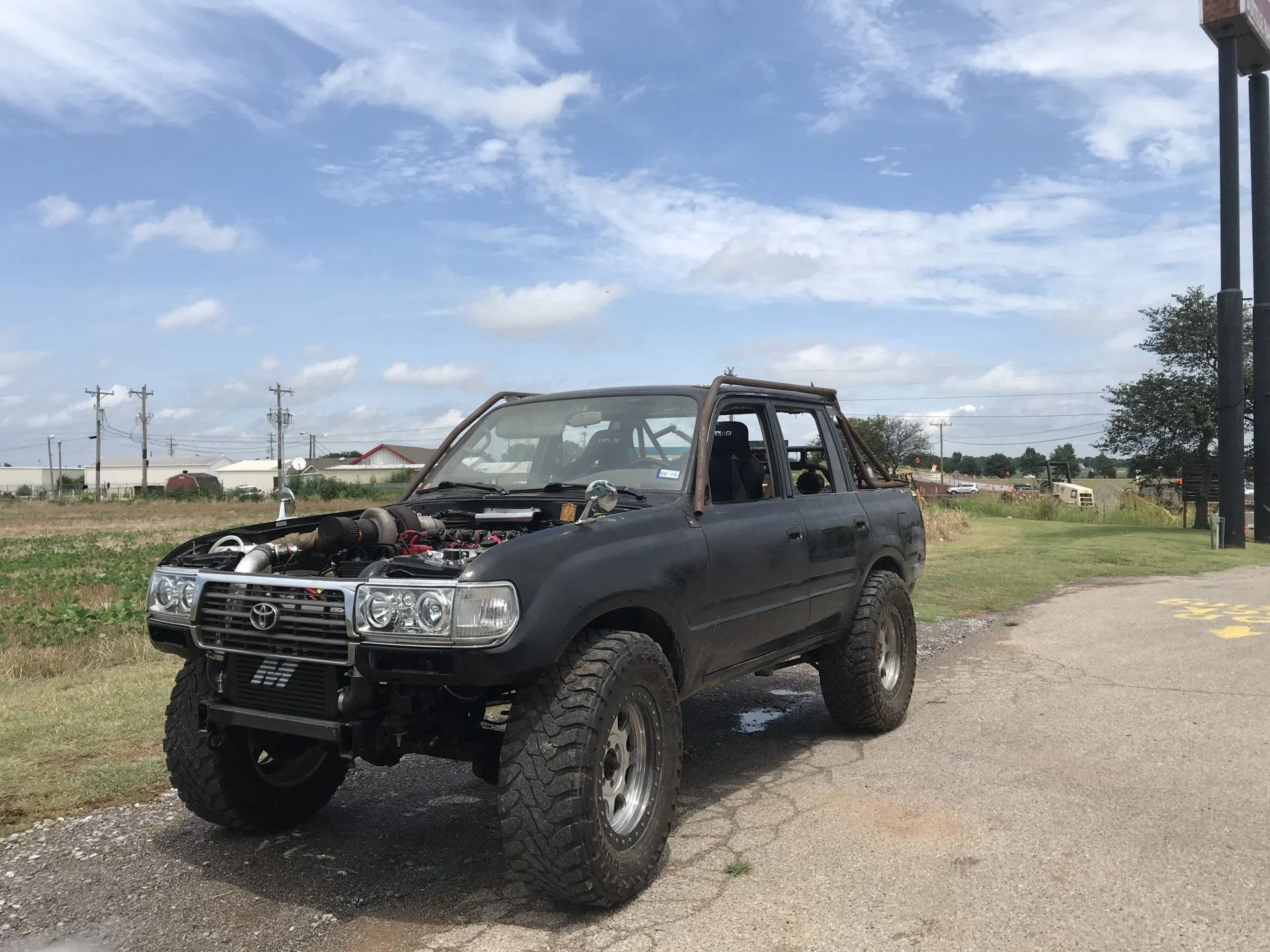

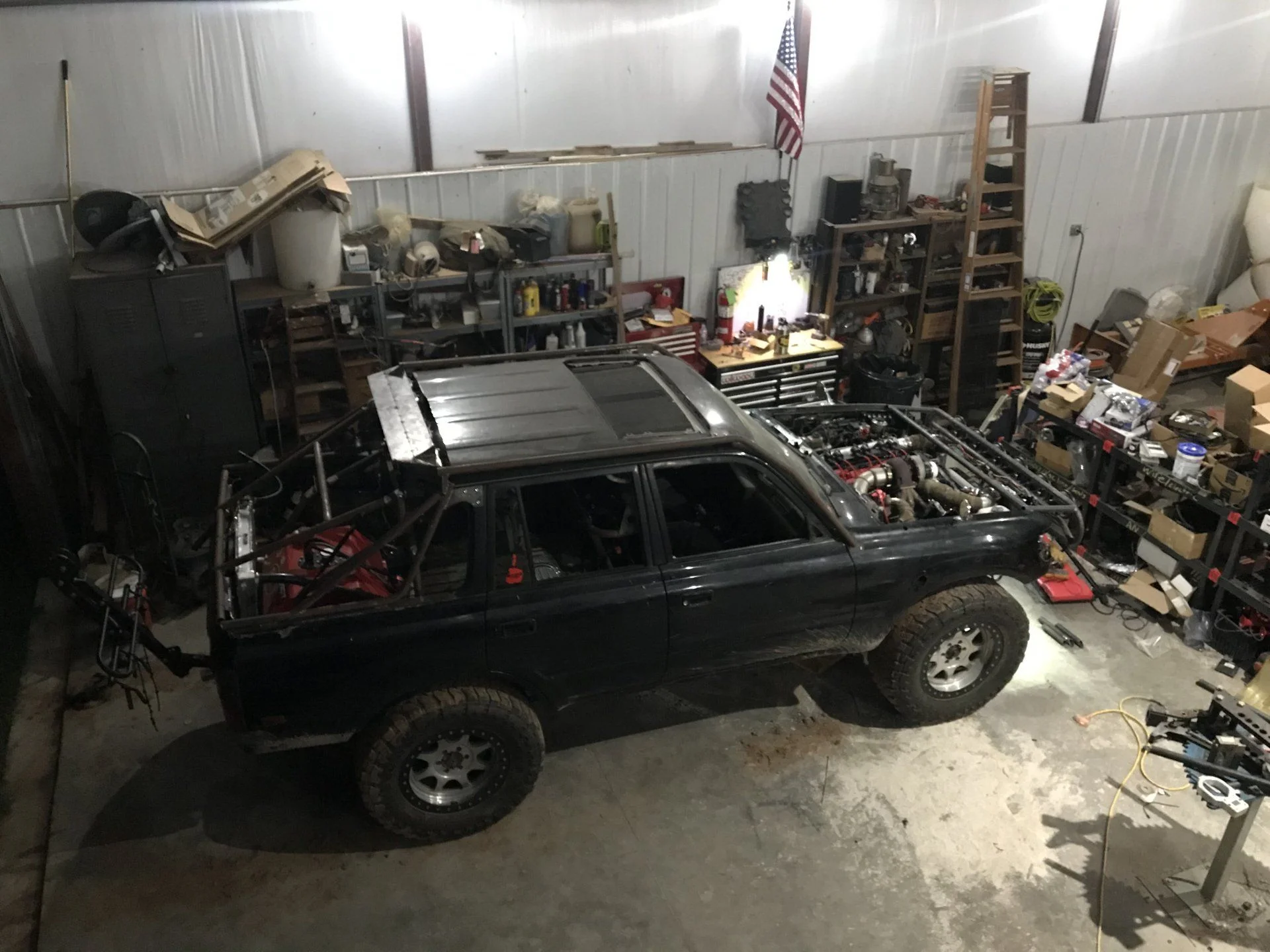

I’ve hit 10 psi now and it is a rocket for a land cruiser have another 7psi to go. Still tuning
Just another small update

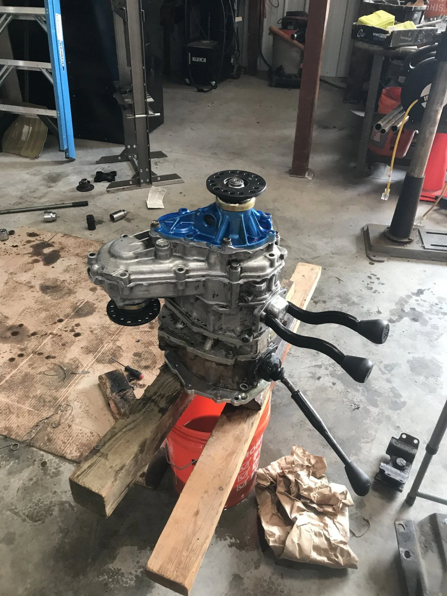

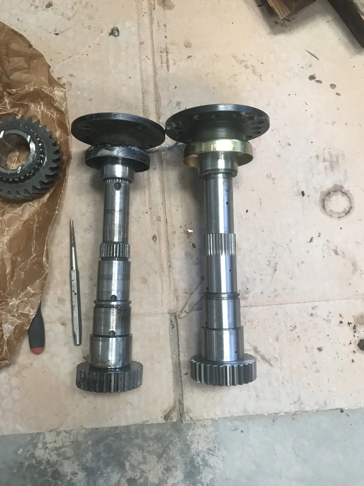

30 spline t case built to handle 400ft/lbs of torque

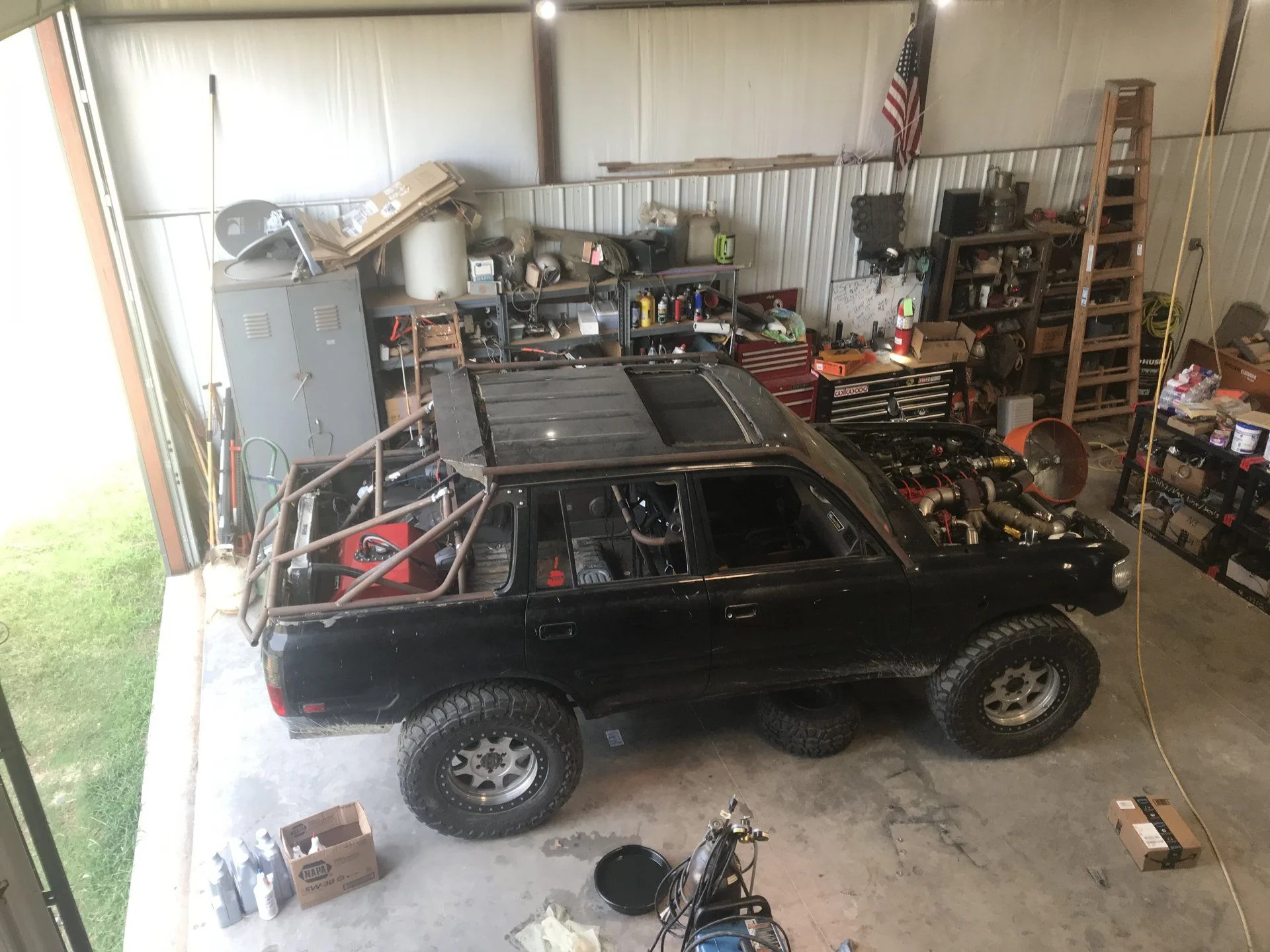

Exo roll cage is in progress
Added a oil cooler system
Was able to get her sideways at 2psi of boost

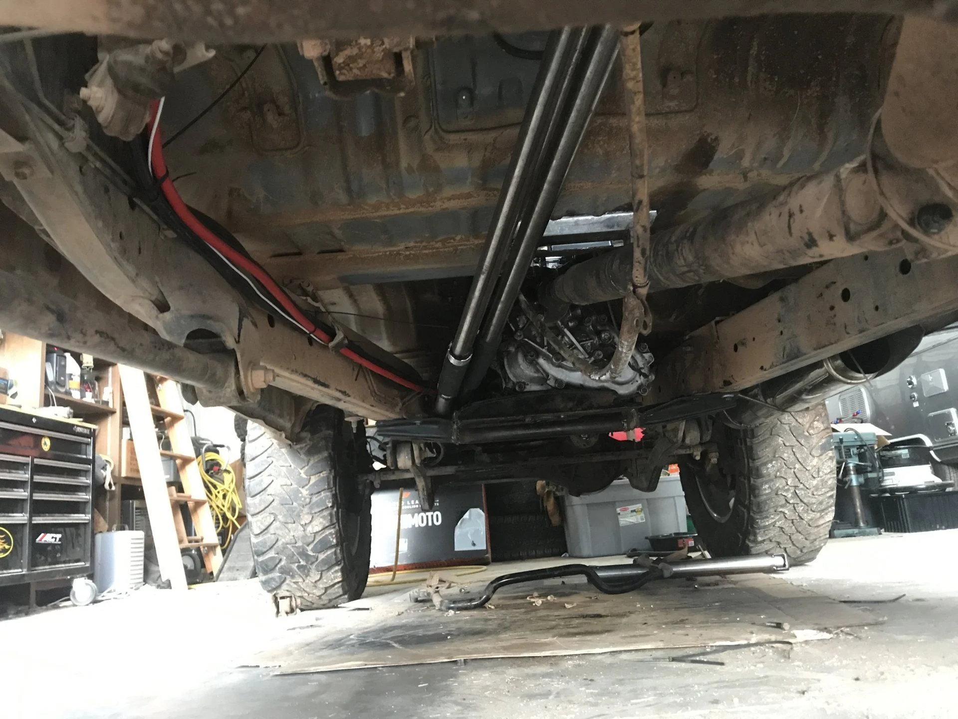

Going to keep the axles so they are the fuse in my driveline and not the tcase or trans

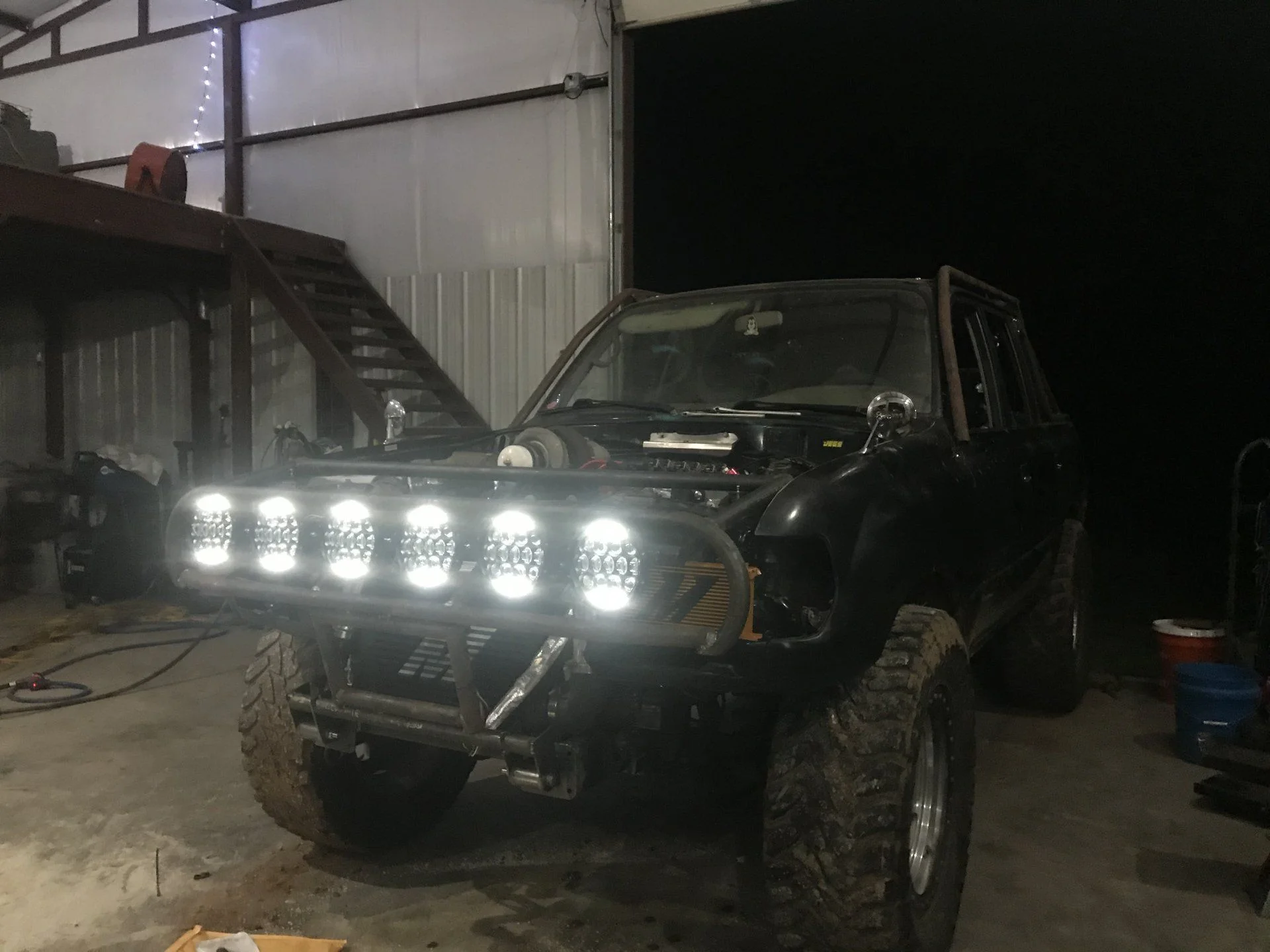

enjoy some pics

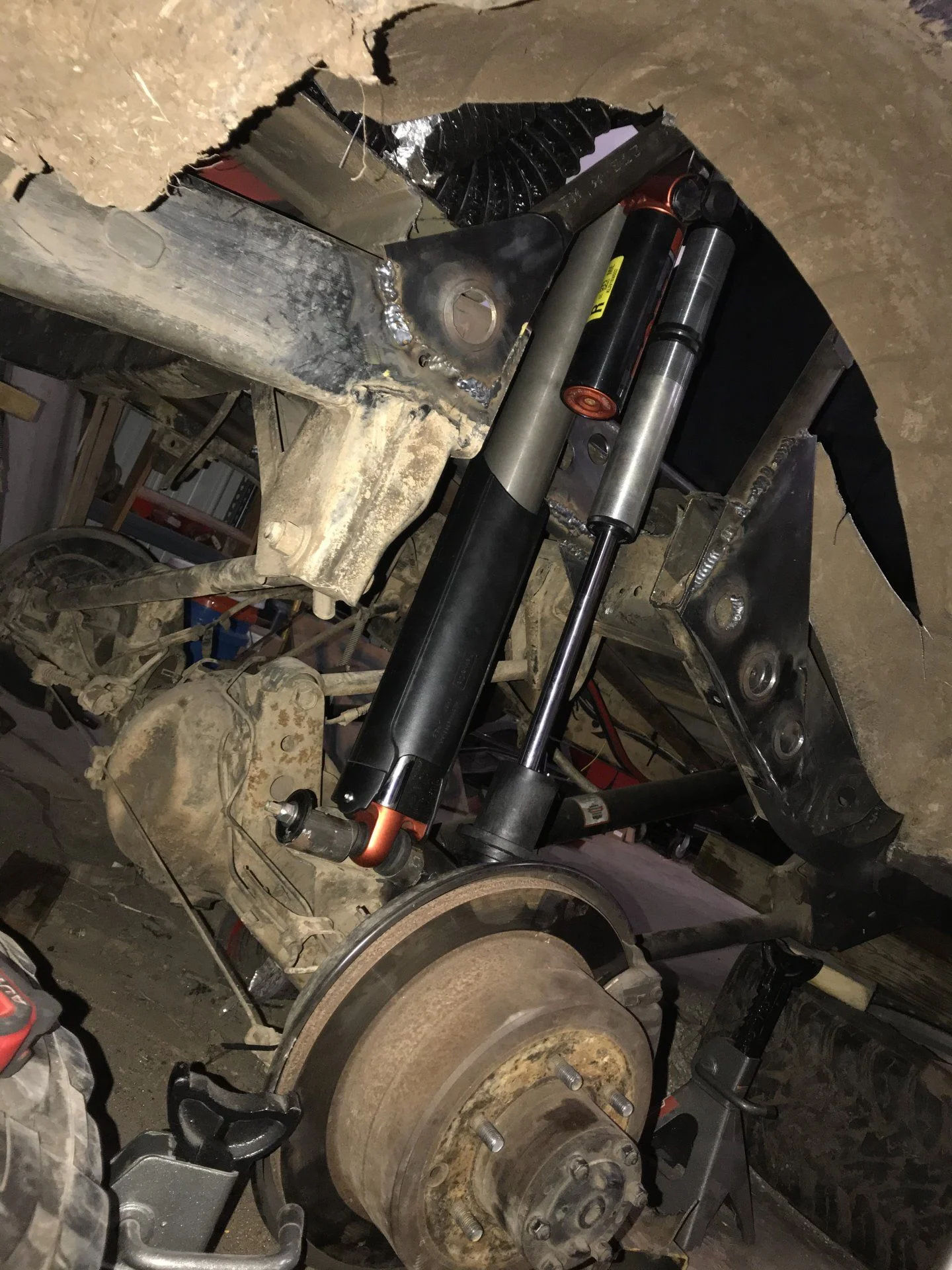

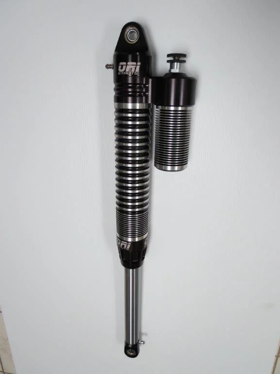

And the plan is to run 14” front and rear ori struts
And one of these fancy “sway bars”

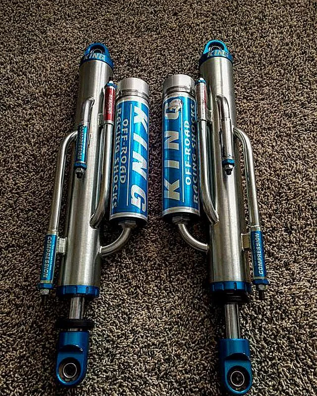

Decided Kings were too main stream and these better suit a “rock crawler“ and all I have heard is great great things
Should drastically help the tippy nature of the 80 series

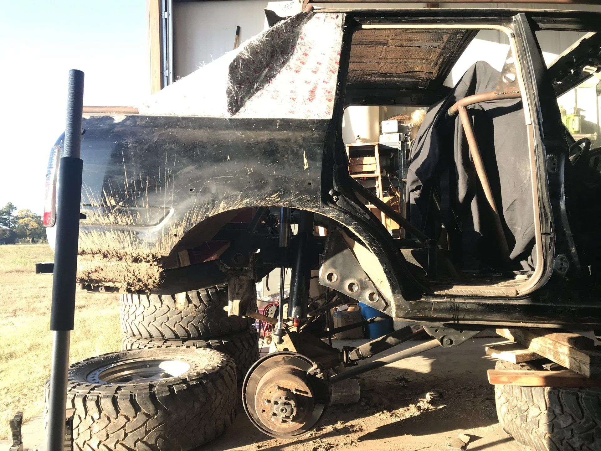

As per usual things change
Got a decent deal on some fox shocks 2.5 3.0 internal bypass raptor shocks and some coilovers for the rear.
wound up not needing the frame in the rear too bad so it’s cut making room for more shock and coilover and ditching a lot of weight.
