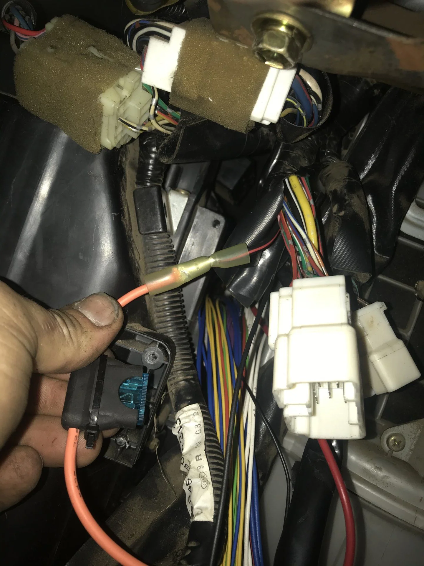

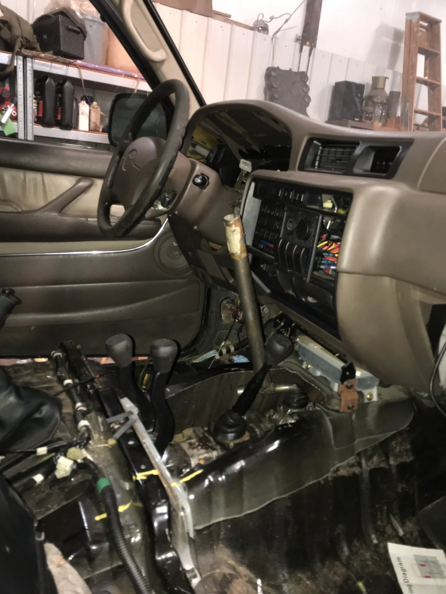

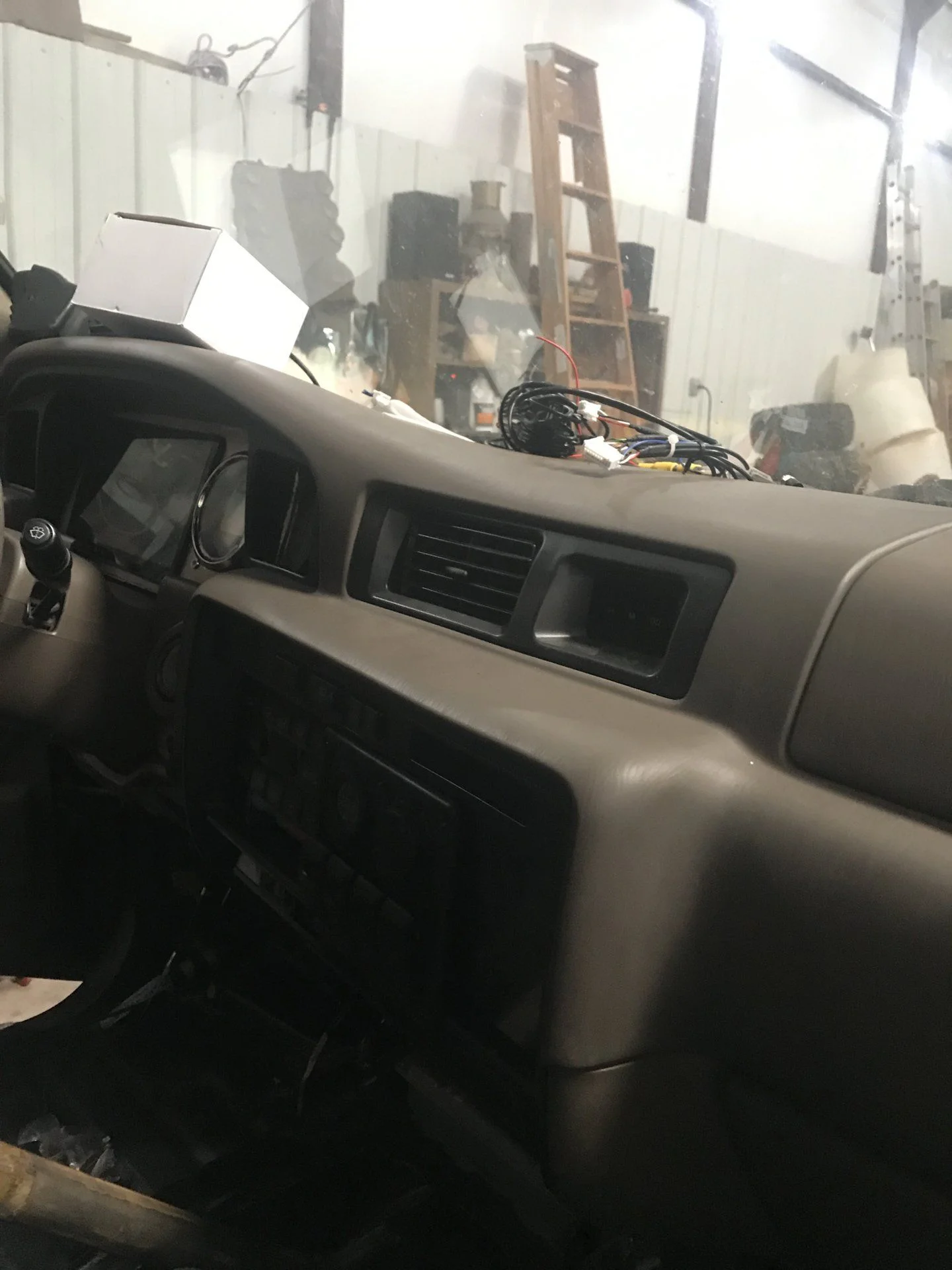

****Important wires for an engine swap****
behind the glove box there Are 2 connectors that go to the engine harness, of the 2 the bigger has
Black with red stripe - is the switched 12v
Black with white stripe - goes to the starter
I’m putting both on a fuse and relay can’t be too safe.

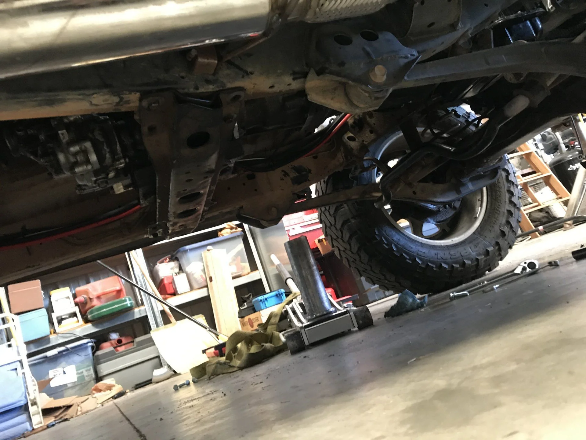

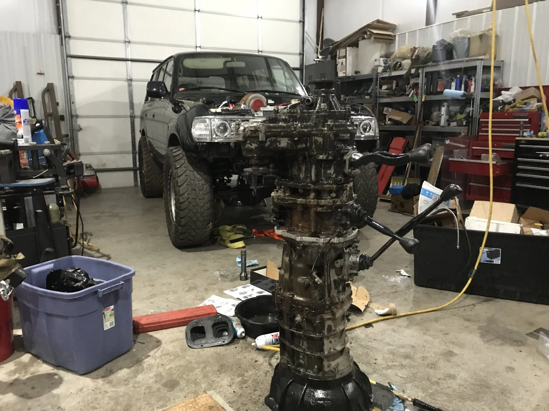

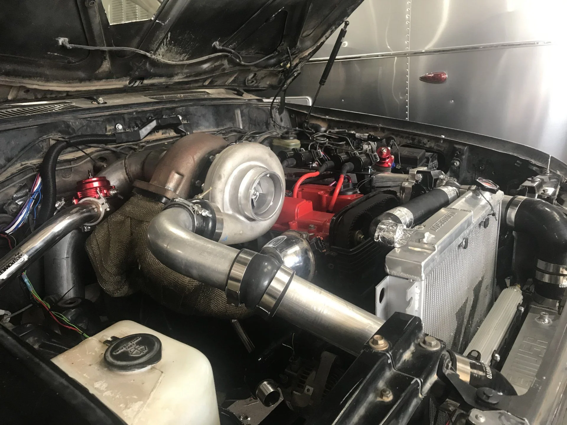

Picking up dual cases this weekend, although this is exactly what I want to do, it is by far not the cheap way and will further delay the cruiser. T case is a r1fa with a another low range stacked on to it.
Yup, sounds like a 2jz
I Hope so. Turbo flutter on the way.

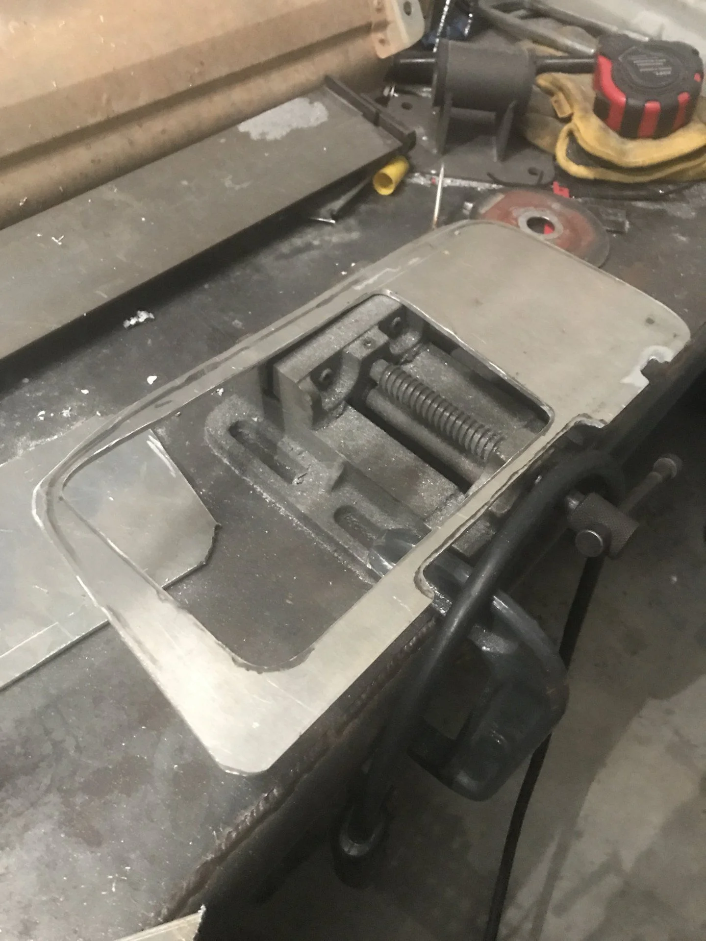

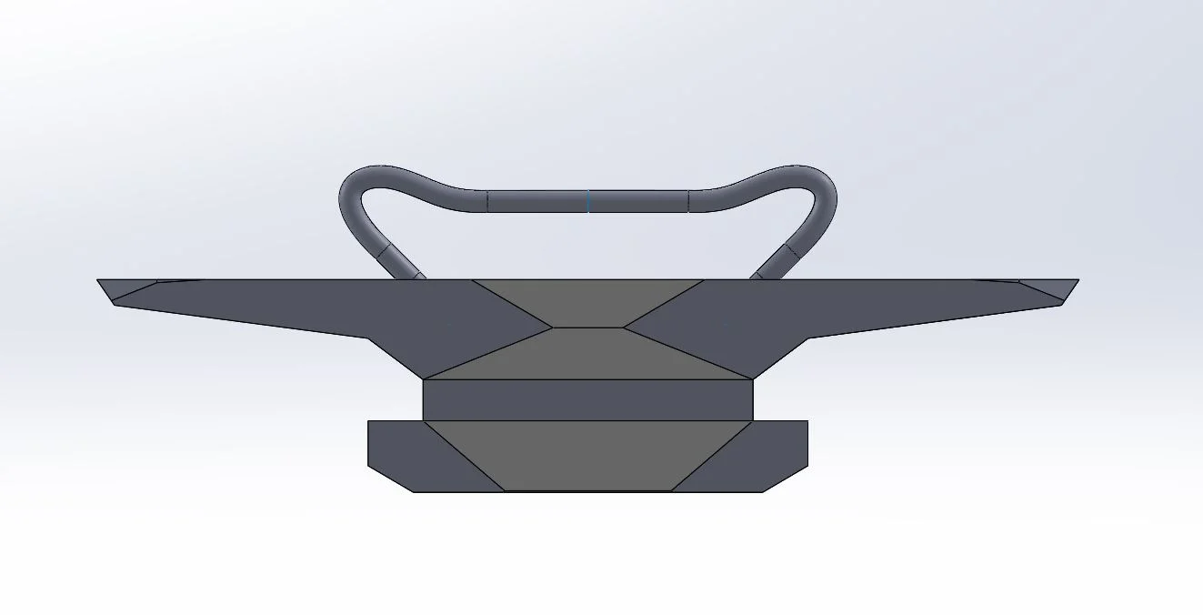

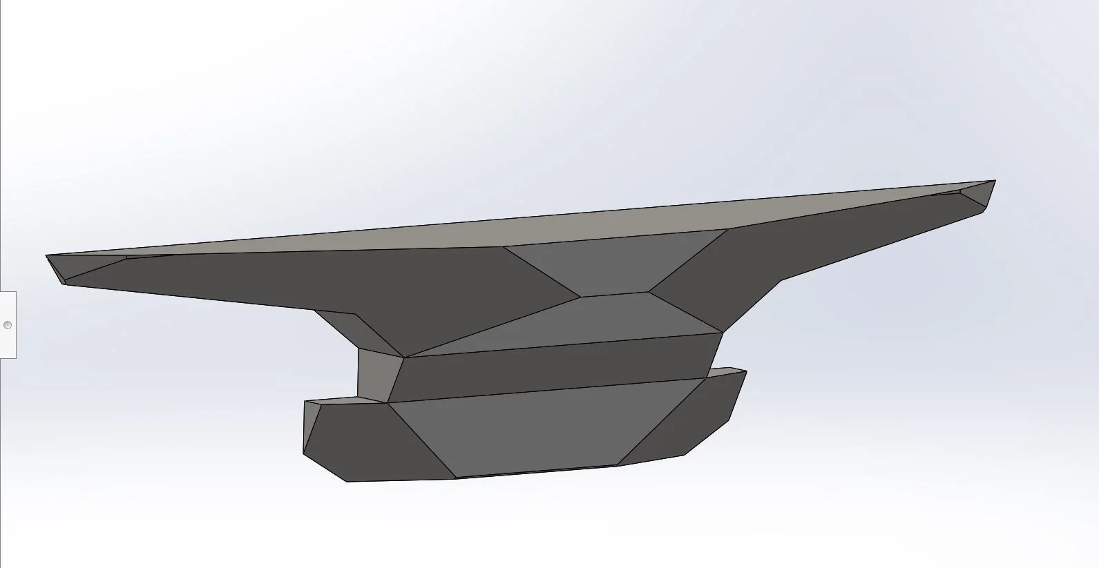

working on a bumper design to delete the valence trim. have not decided on a hoop design.

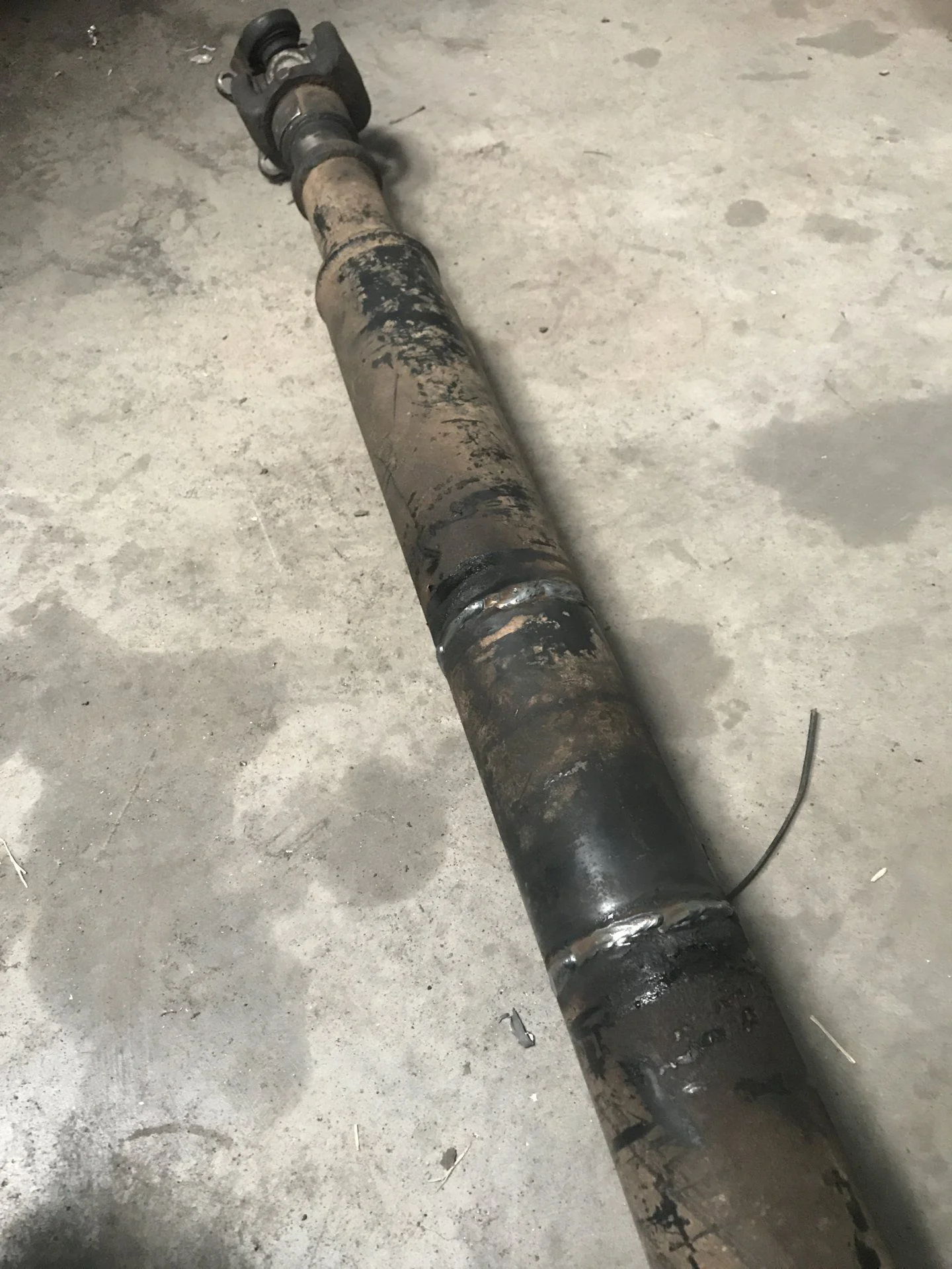

driveshaft angle is minimal, will be using higher angle joints to minimize issues down the road.

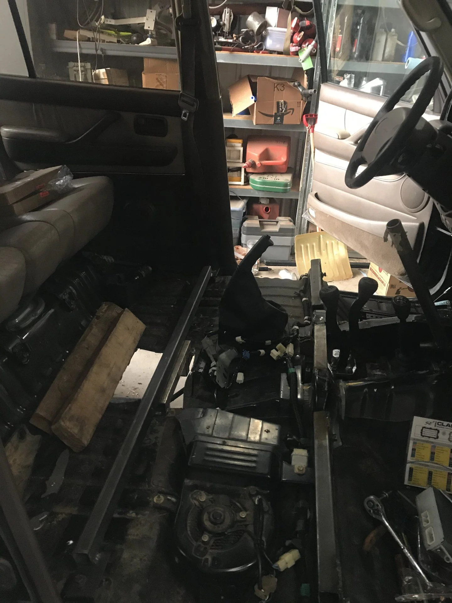

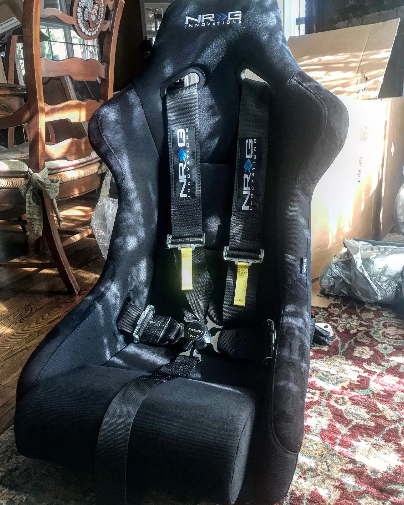

seats are in, they look light but I’ve had a friend who is 6’4” sit in and he fit fine.
clutch is fully operational

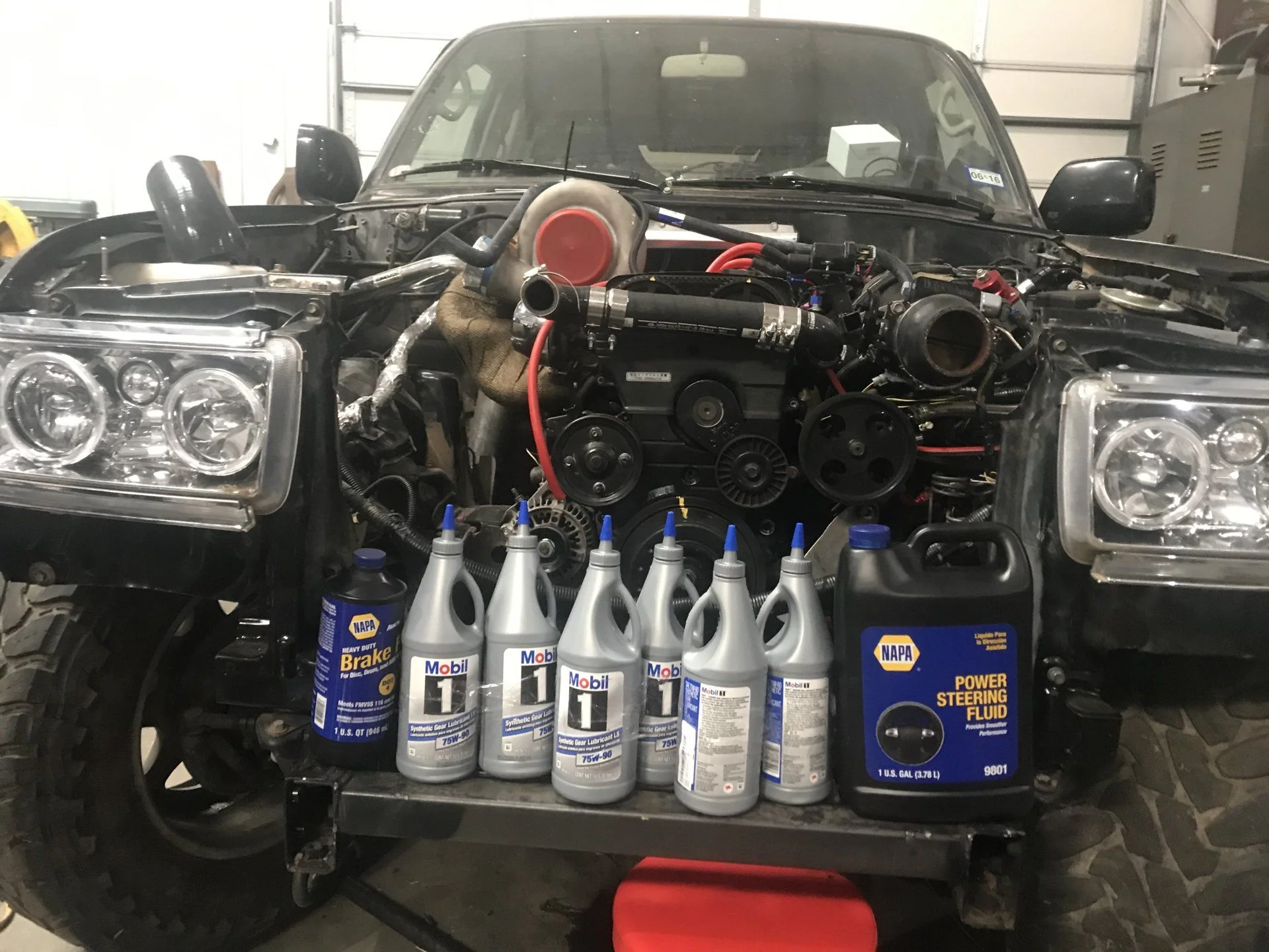

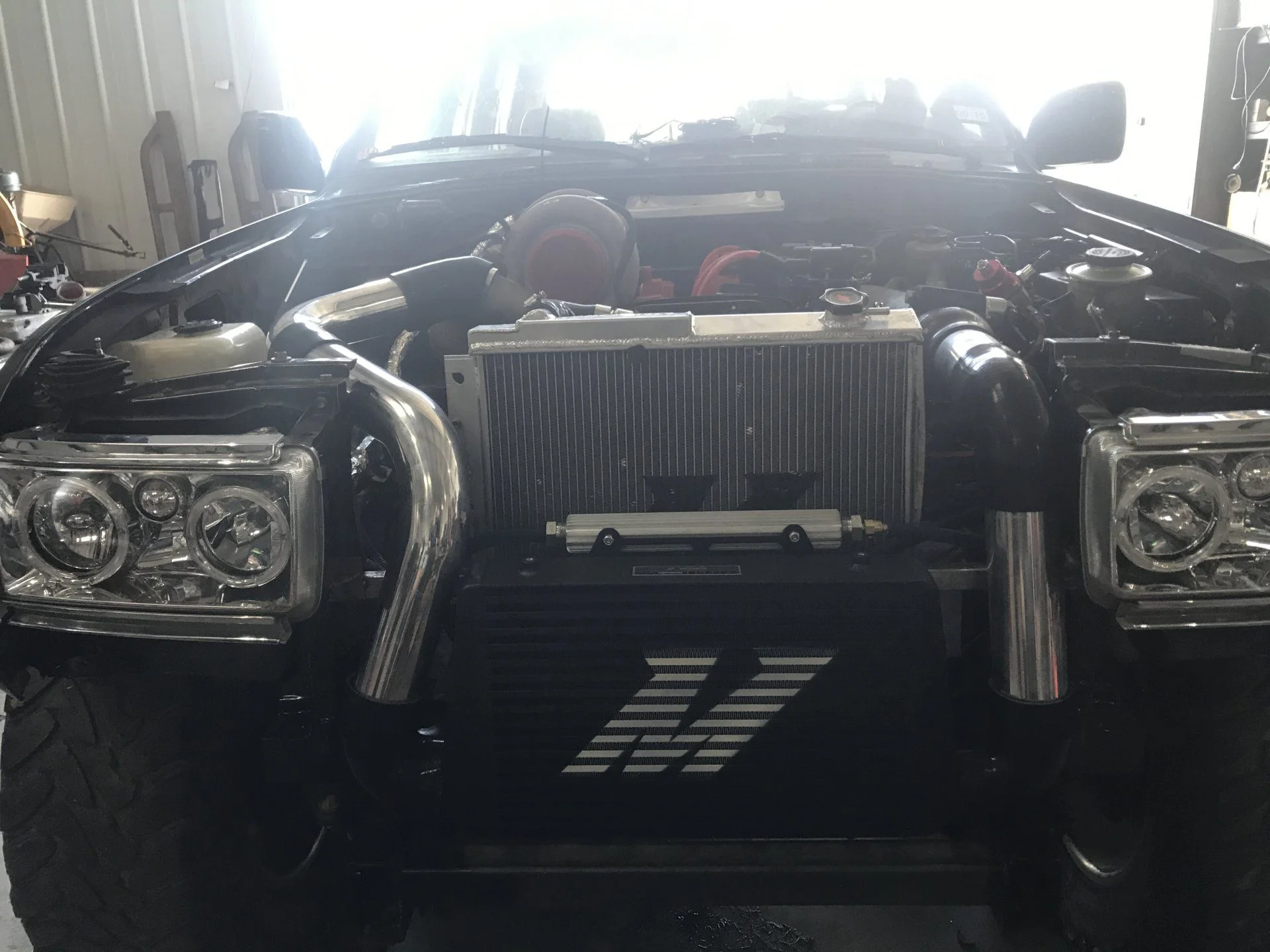

Coolant system is done
Power steering is sealed no fluid yet

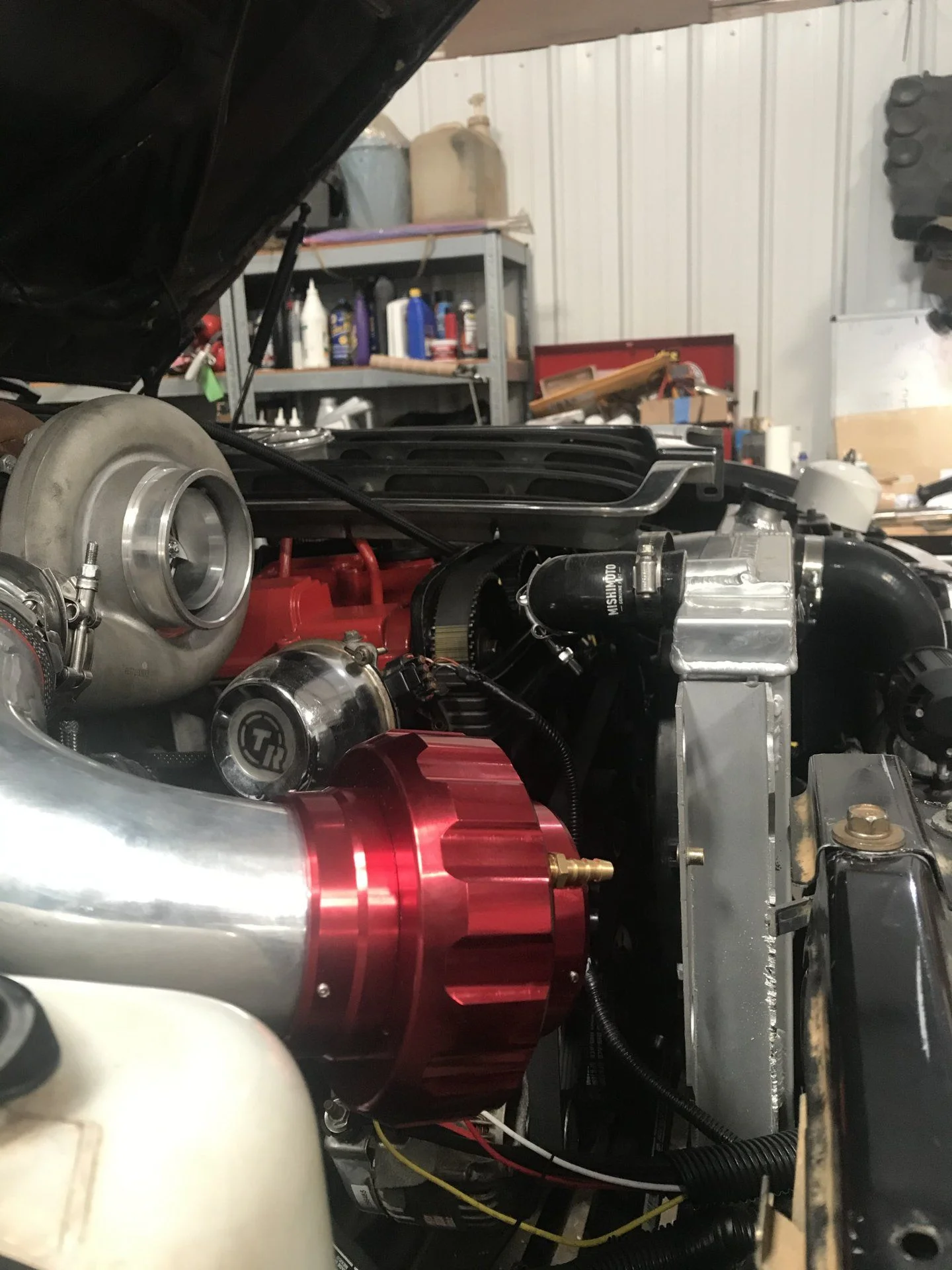

Waiting on more t clamps that actually fit for the intercooler
shocks bumpstop drops are needed

Very excited for you to get this out and drive it! I am going to be very curious what you think of the turbo response. Sweet and different setup for sure.
Haha yeah it will be hella lag I wish I knew what the motor was going in when I bought the turbo. Ball bearing and smaller for sure. However
It can’t make less than my buddies 3fe with 400k mi on the clock
what I’m most interested in is the new weight

On no boost and a base tune it’s still faster than any stock 80 with 37s so of course it’ll have 2 step and probably flat shift as well, those are easy. She feels like she wants to burn down some craigslist 37s exiting the shop
Needs a non eBay turbo this one is already leaking oil and it is soaking the afr sensor making it very difficult to tune. Definitely backfires right now because the map table is for boost and I didn’t have clamps in

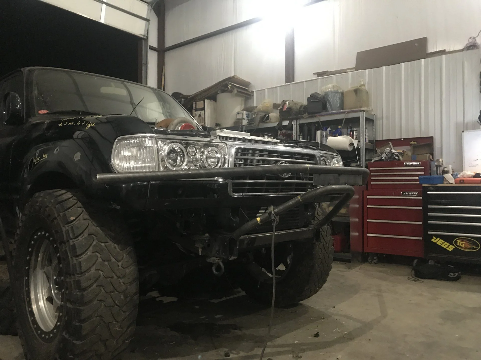

I have started brainstorming for the front bumper
Decided to go tube to keep the weight down
Might make room for a winch... we will see

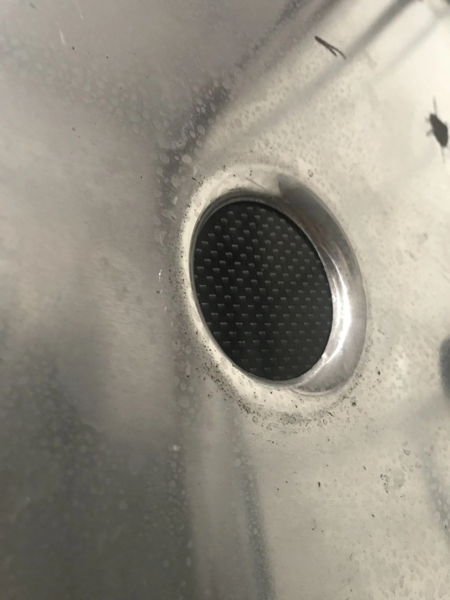

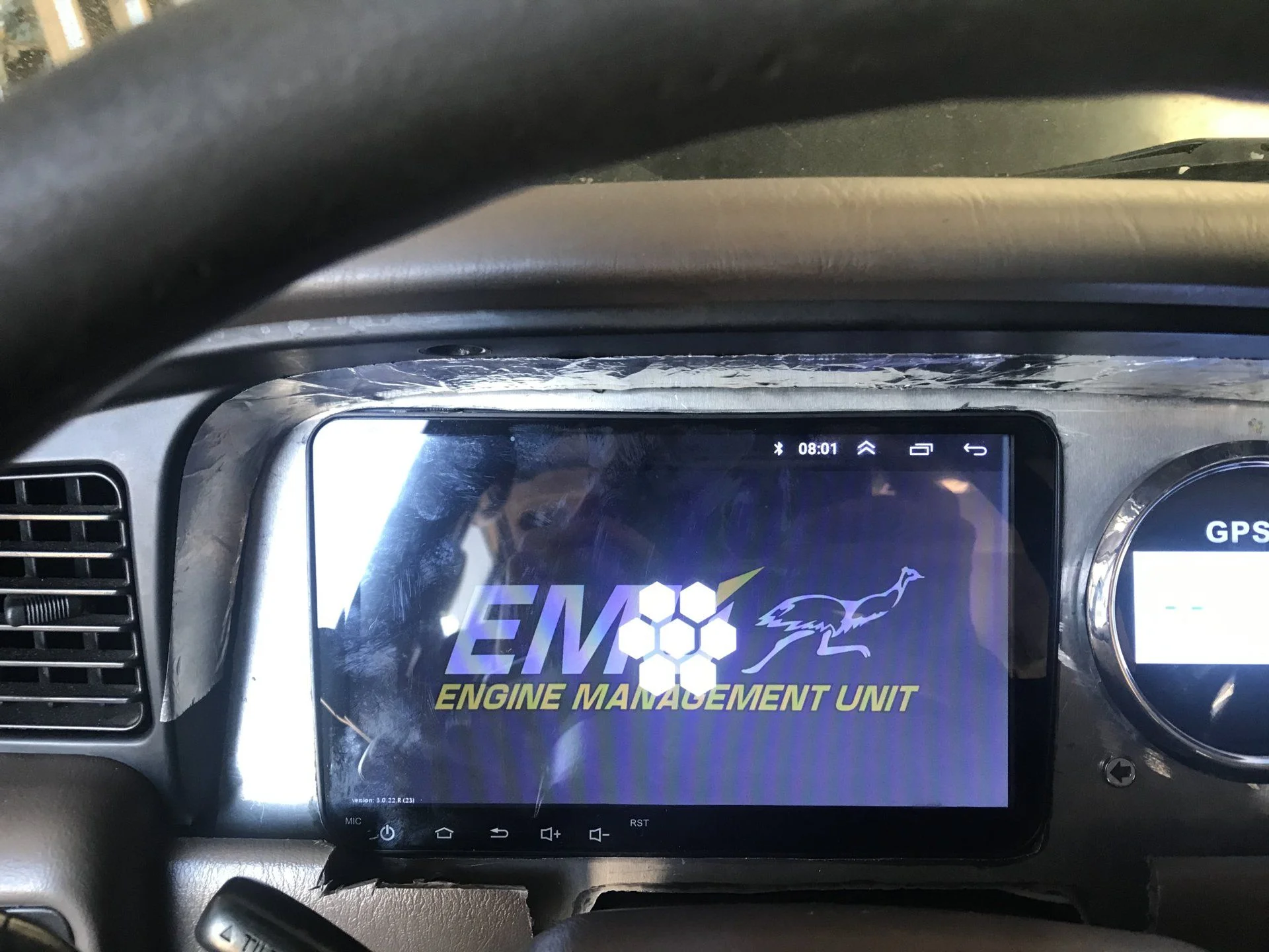

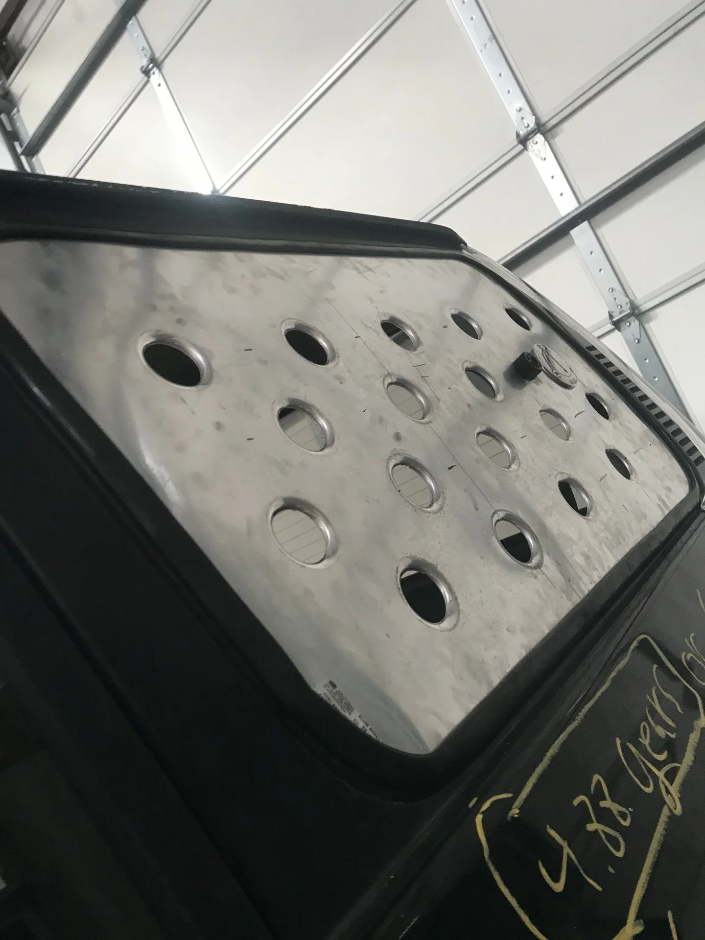

Wound up doing the dimple dies on the rear fill and vent. Ecu successfully connected to the dash. Everything works ok, so now time for the boring stuff before taking it anywhere

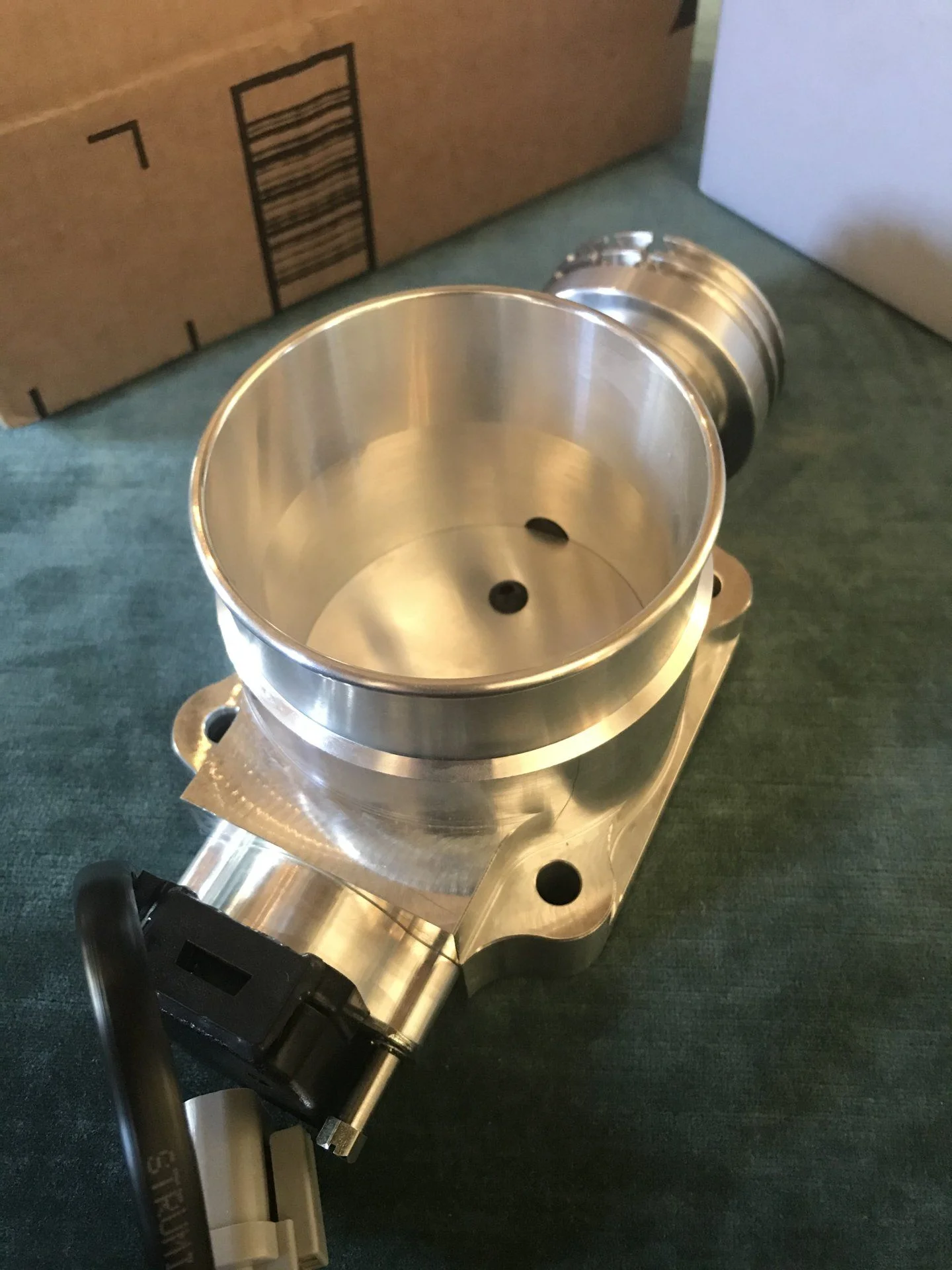

Also the other throttle body failed on me catastrophically and got stuck at WOT and went to 7000rpm before it got shut off. And it was leaking so I ordered a non eBay/non wuhan TB from CX Racing. Still much to do but nothing “new and cool” till it is streetable and racing civics.
