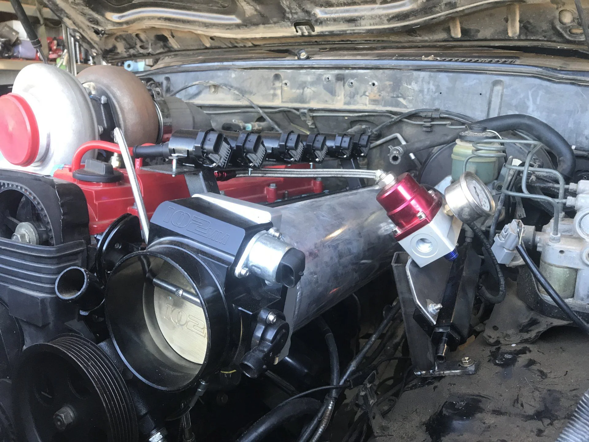

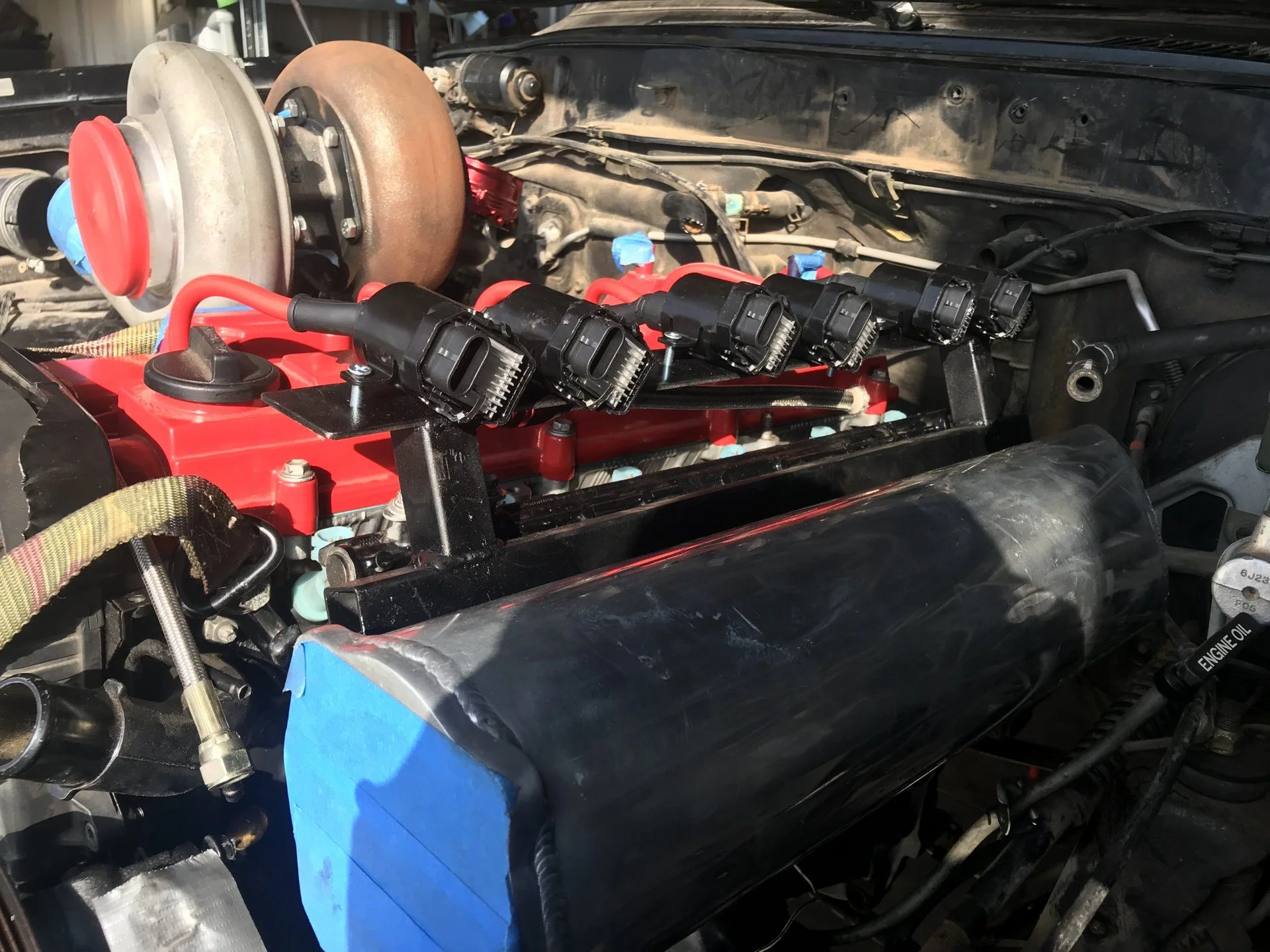

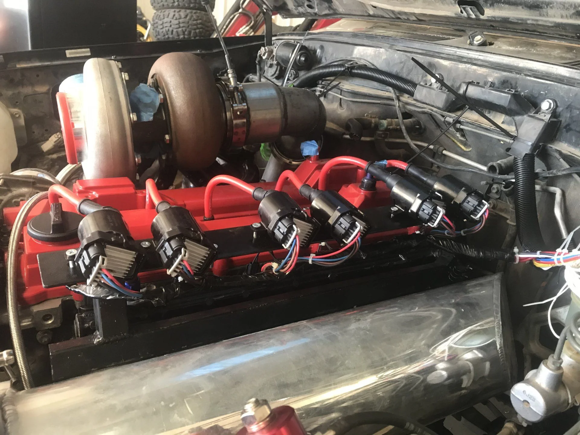

Coil near plug bracket added for the LQ9 coils

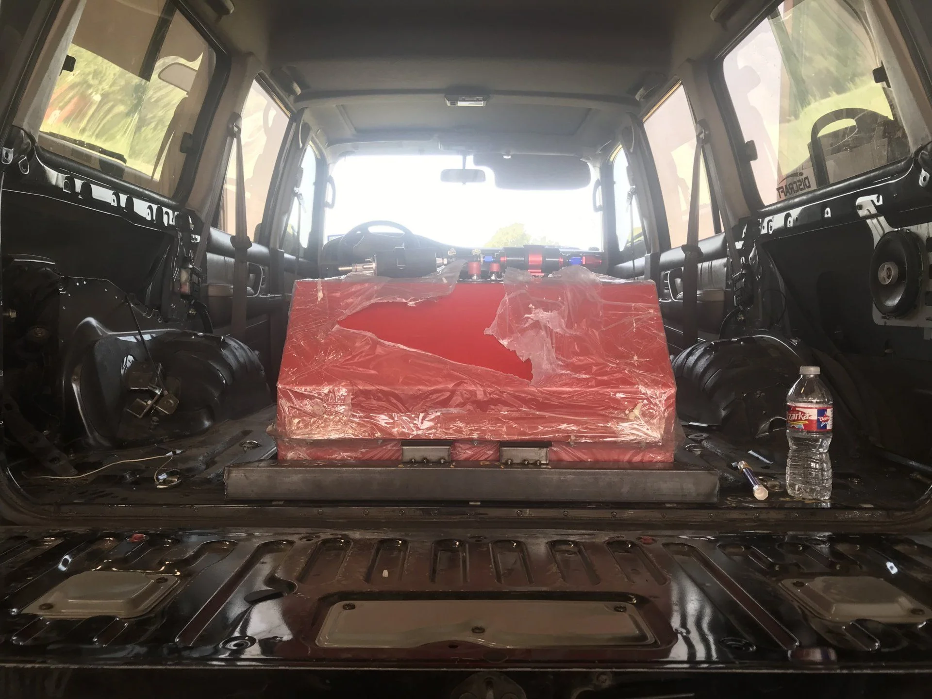

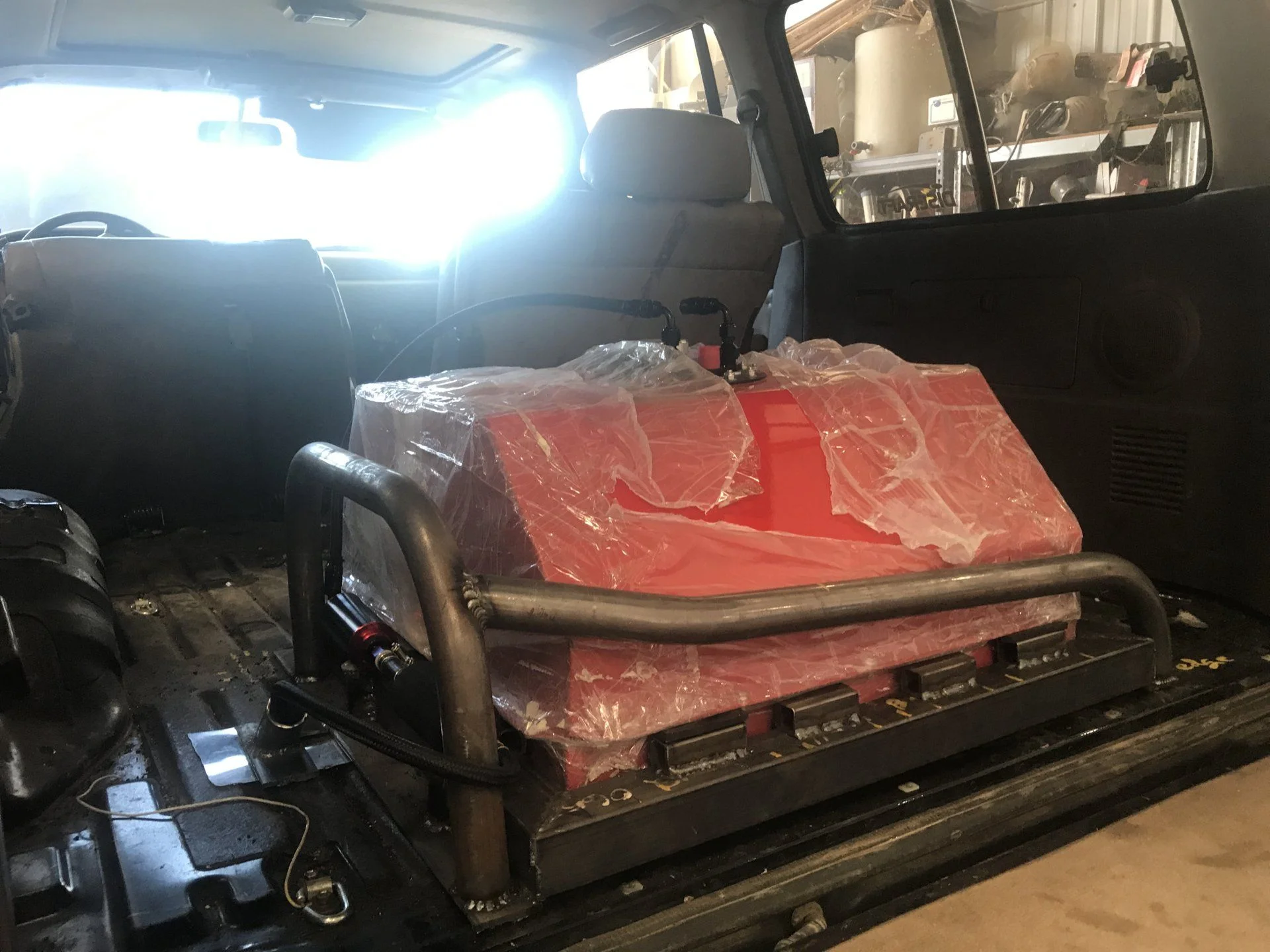

And got the fuel cell in, made measurements and will reinforce the body before cutting out the floor in the trunk area. Did a few more things but they were basic.

1jz gte non vvti fuel rails injector ports line up with 2jz ge non vvti stock runners.
Will be using stock fuel rail and -6 an fuel lines with a walbro 400
The fuel cell is 32 gal hopefully range is around 200 miles.

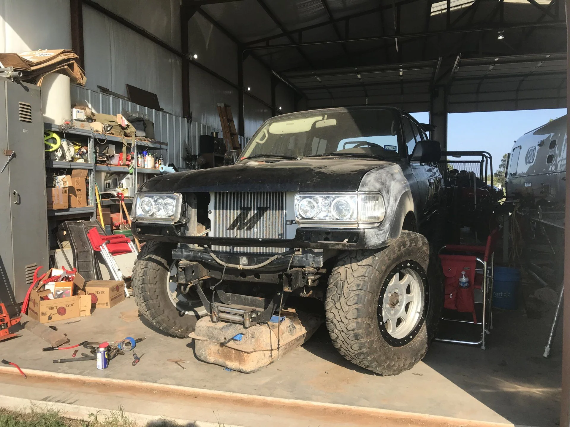

Radiator and intercooler mounted

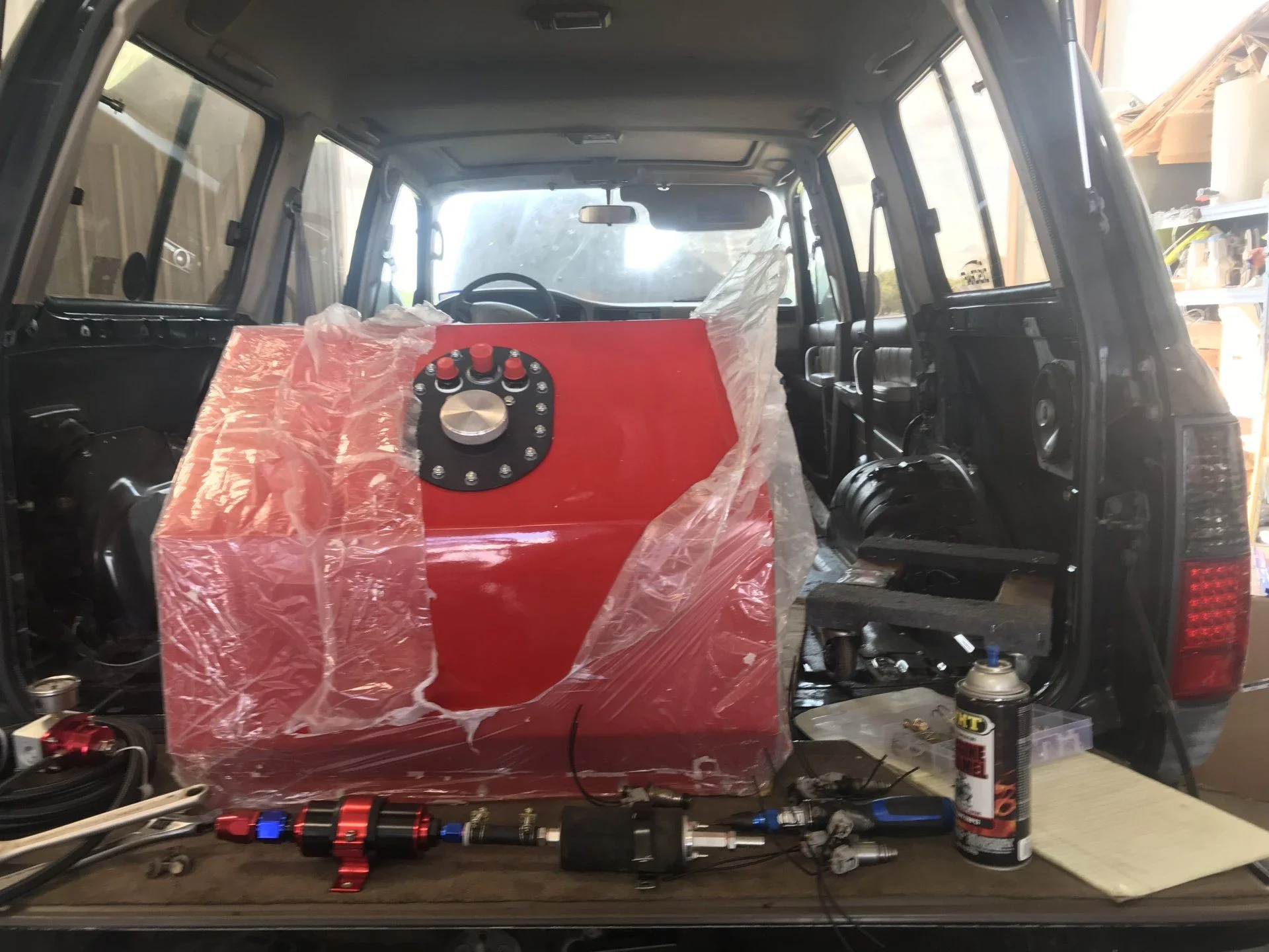

And gas tank is in the final location, need to finish its mount however
Bottom of the tank is above the frame.
Need to do a bunch of plumbing but should be getting ready to wire everything up soon

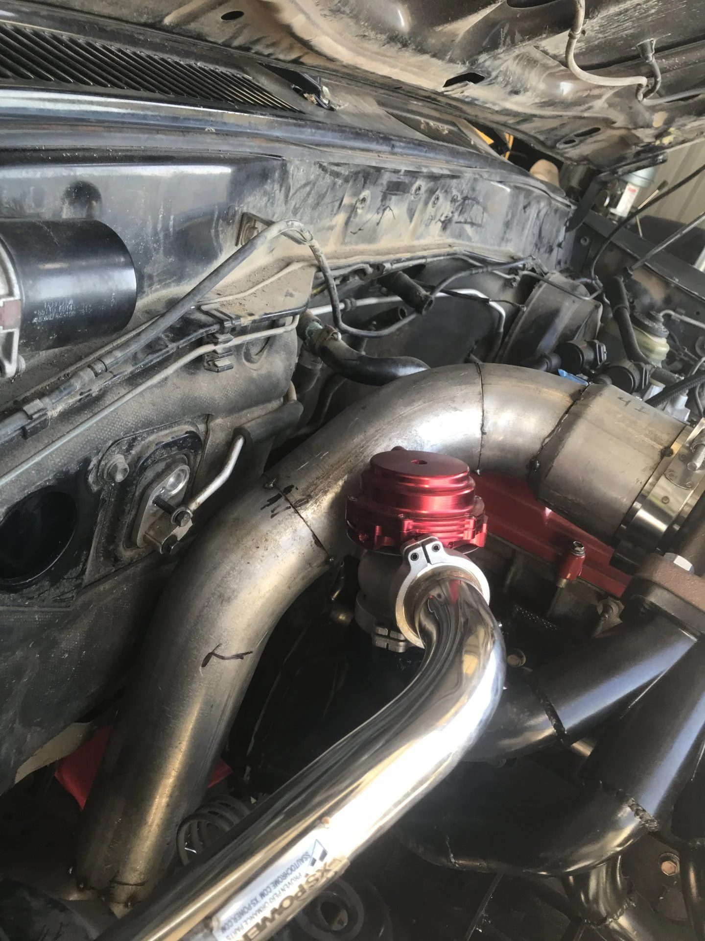

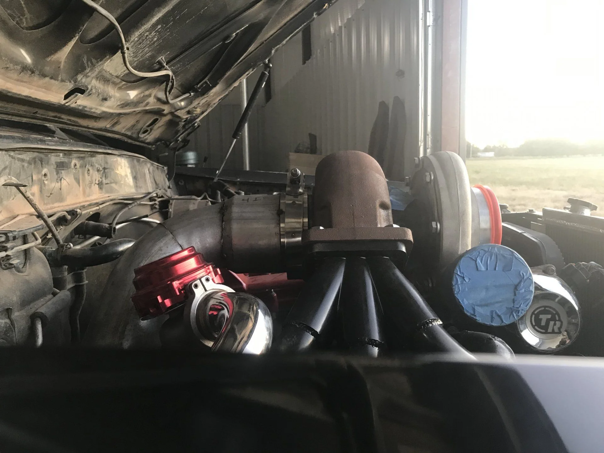

I think I missed what size turbo you are going to run but it looks awfully big for this application. Running the numbers if you went with a 58mm like a EFR 7670, you should be able to make about 450ft/lbs @ 2500rpms and still make 550hp @ 6500rpms. But you would need to limit RPMs to around 6500 with that size turbo.
Good progress, can't wait to see first start up.
Thanks for the info
turbo is a 70 mm
Picked it because I was originally doing a supra kart MKiii but swapped over to the 80
Will definitely be selecting a smaller nicer turbo. If I find one for a good price

Fuel lines ran, frame notched for radiator, an fittings every where, throttle body finally installed.

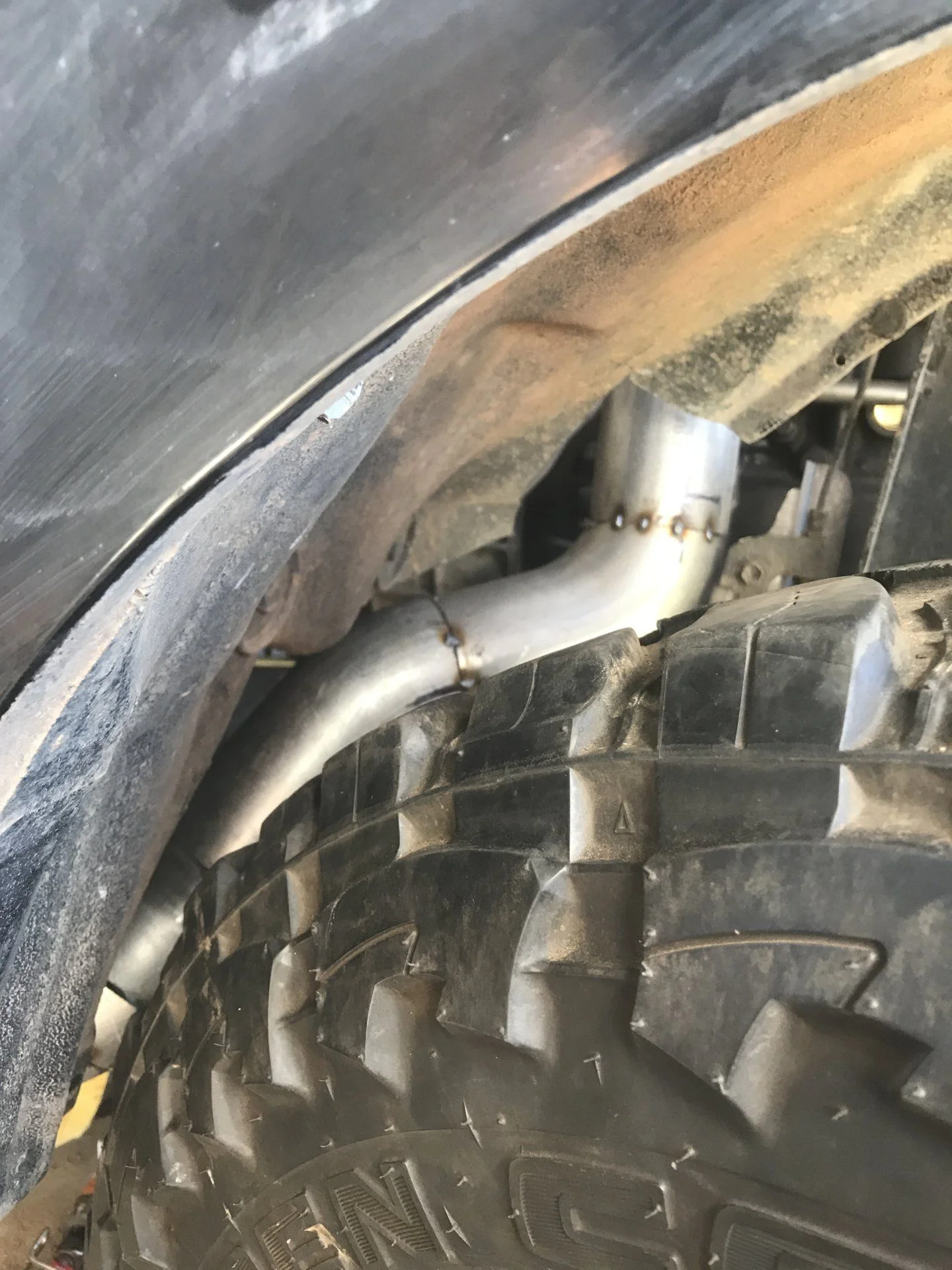

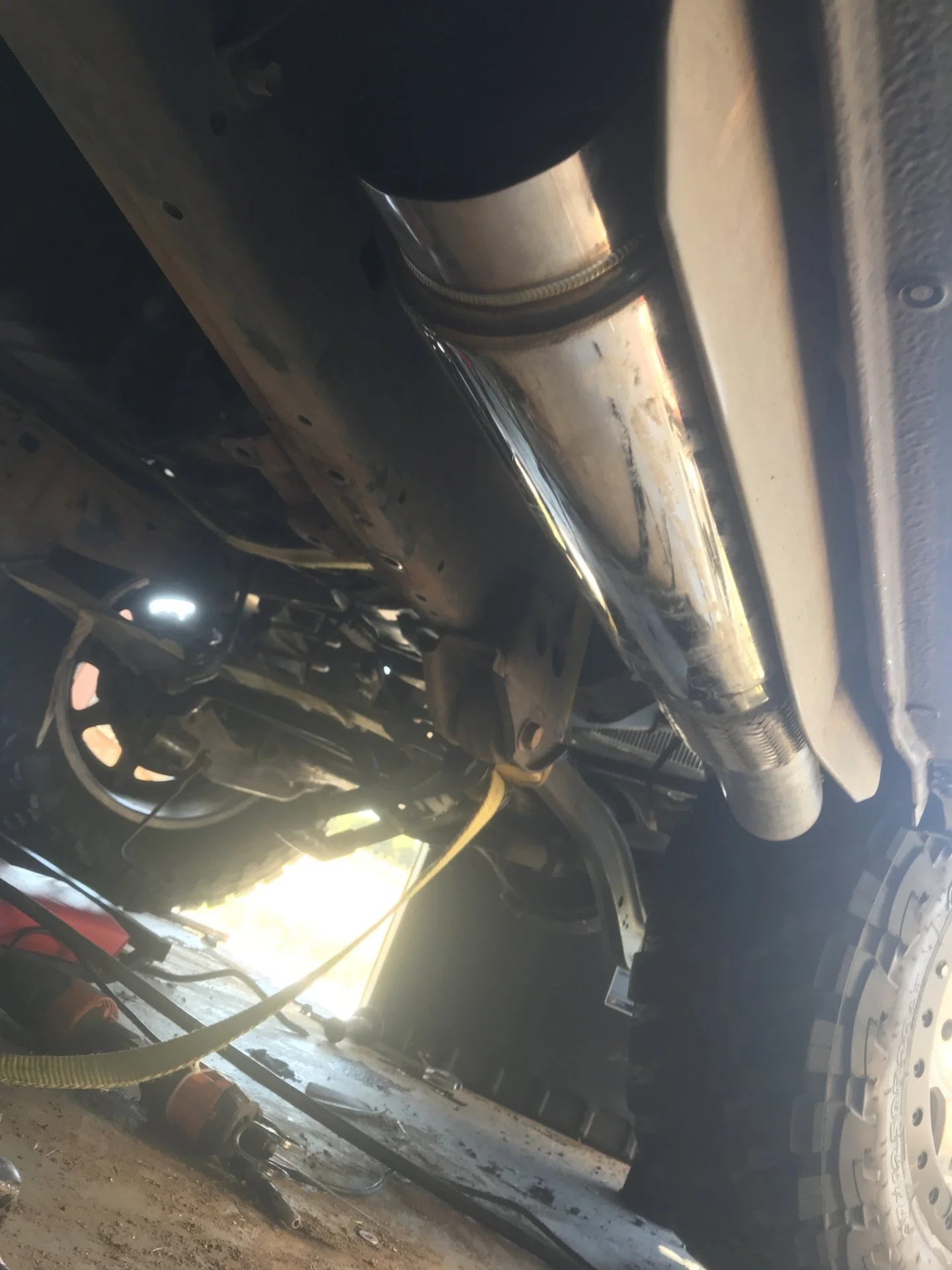

Mainly did exhaust today finished the high pressure line for fuel

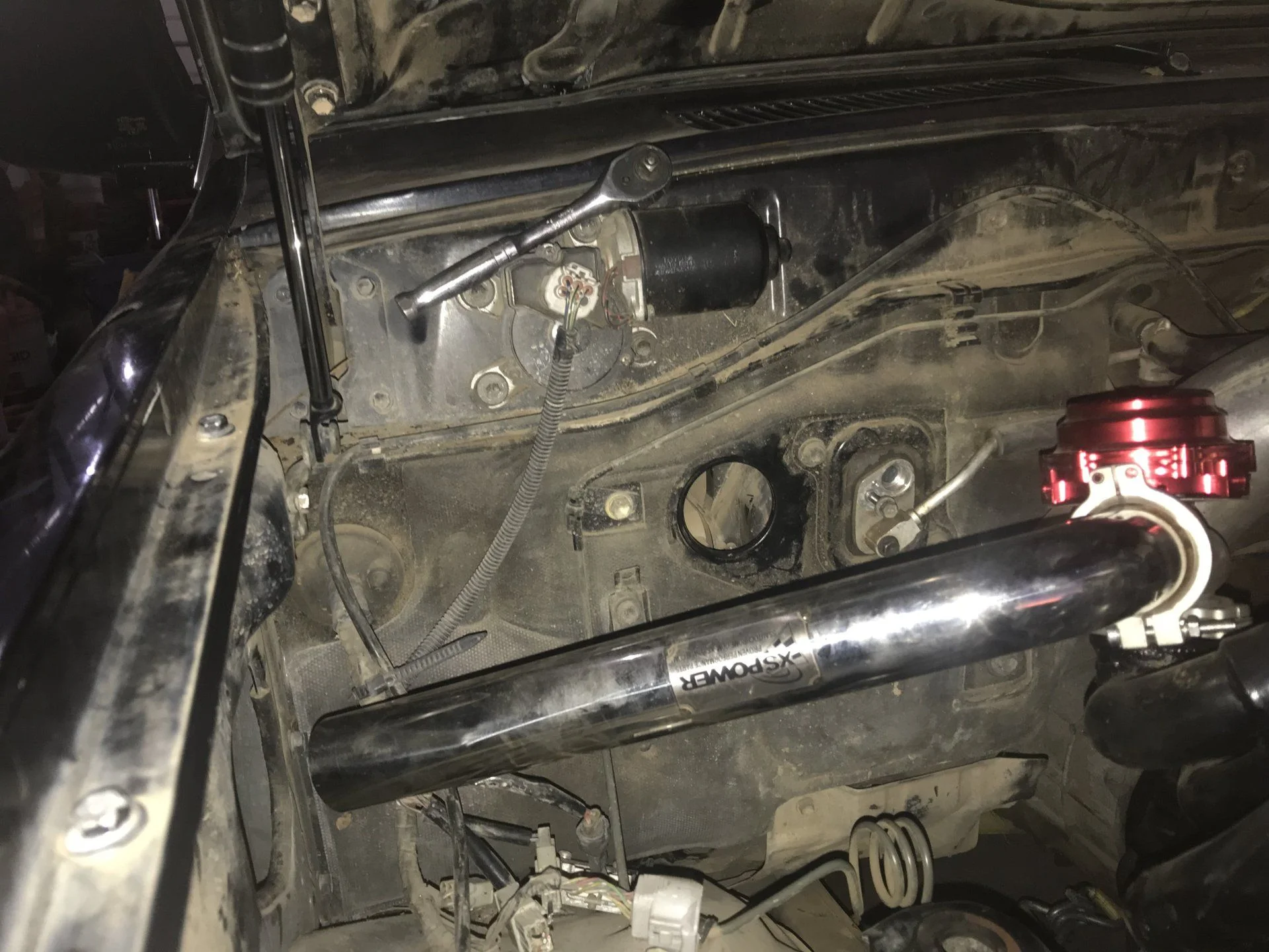

Attempted boost piping but the bender kinked the tubing(didn’t heat it enough)

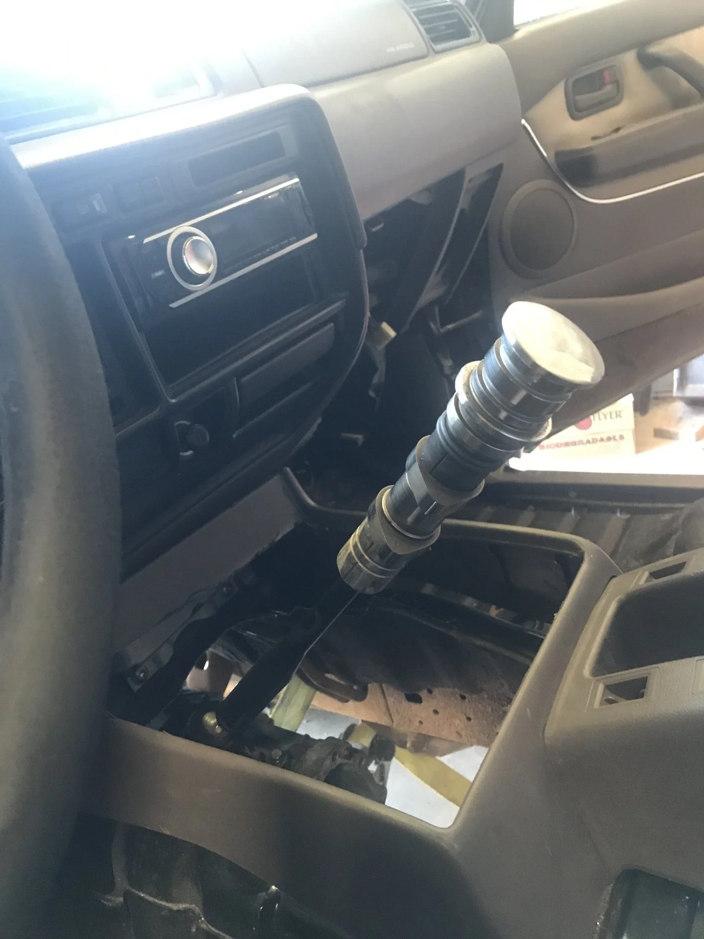

Camshaft shifter might be too much weight too far away. Don’t want gravity selecting gears after a jump so will replace the bushing on it and hopefully I can keep it.
Injectors and lq9 coils are all wired up.

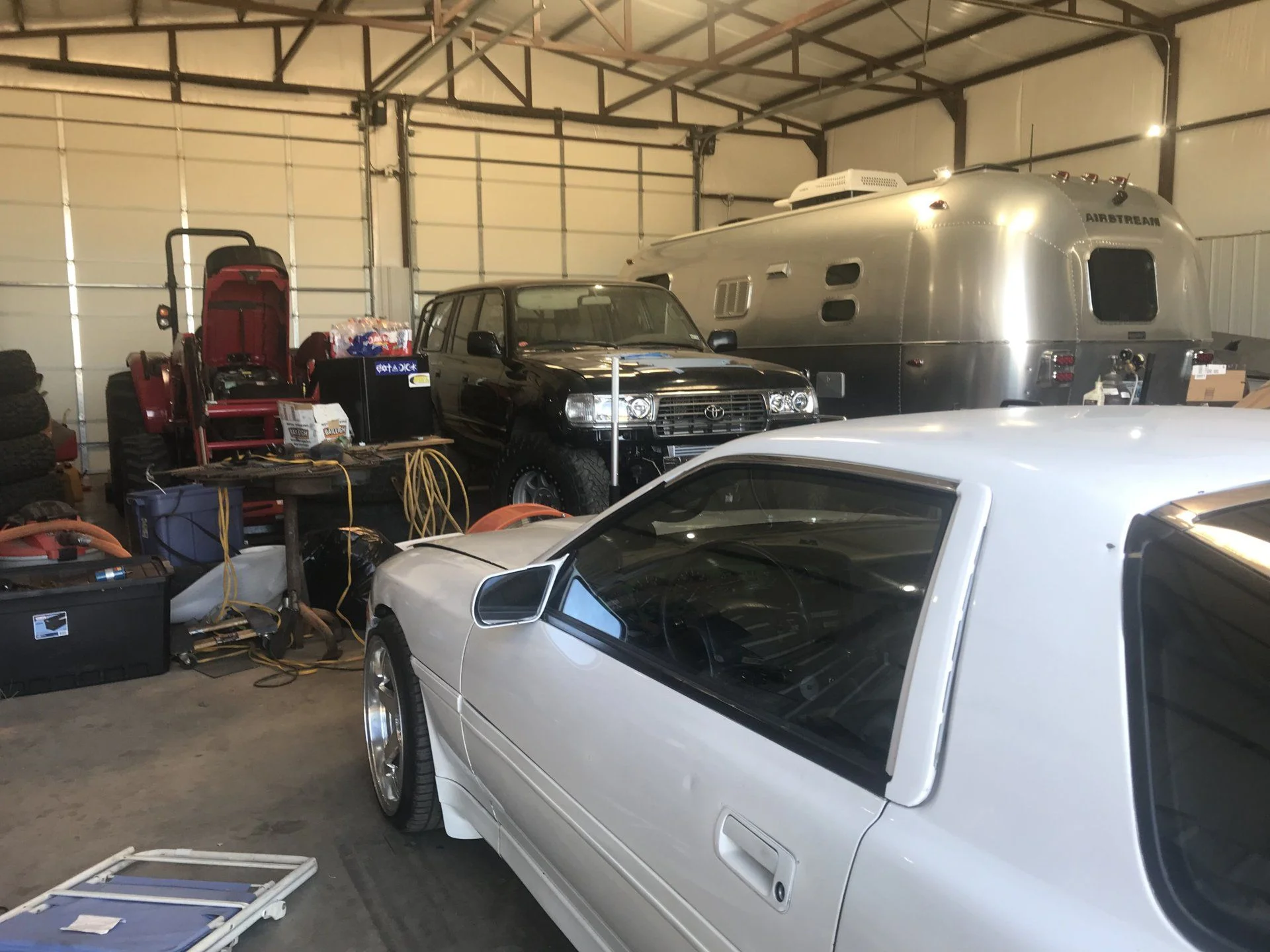

Loving the white MKIII. What's under the hood?
