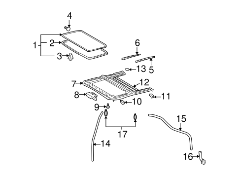

Part of 63201-60081 sunroof glass.
The item#2 in the pars drawing clearly shows it as separate, why we cannot find replacement of just the weatherstripping?
My sunroof rattle a lot. It it was greatly reduced when I put around 3 layers of gorilla tape around the perimeter of the seals. Many people got same problem with other toyota and lexus model but they able to replace just the seals.
I am afraid to spend $700 for replacement glass assembly if it did not really fix the problem. Anybody got ideas how to get replacement weatherstripping?
I just dug through all the parts diagrams I could find for US and Global spec GX470s and Prado 120s, and it definitely looks like there was never a part number issued for this sunroof seal. Which is odd, because the seal for most other models is available.

So I called the parts guys at my local Toyota dealer and chatted about this a bit. For the GX470 and Prado 120 (same sunroof glass) the seal is listed as "not available due to installation difficulty" and Toyota literally has no capability to list/stock it in their parts system as an individual part. Now that doesn't mean the shape/cross section of the seal doesn't match that of another seal, but as far as the parts system is concerned we're out of luck.

I'm sure you've seen this, but I just learned from searching: Toyota and Lexus both call this a "Weatherstrip" and often refers to the sunroof as the "Sliding Roof Panel". So for those searching, "sunroof seal" may not pull up all the Toyota parts.
I also just saw that the 5th Gen 4runner, GX460, LX570, Prado 150, and even Scion xB share 63251-12190 for their sunroof seal. There has to be some cross compatibility, somewhere, for the 470...
