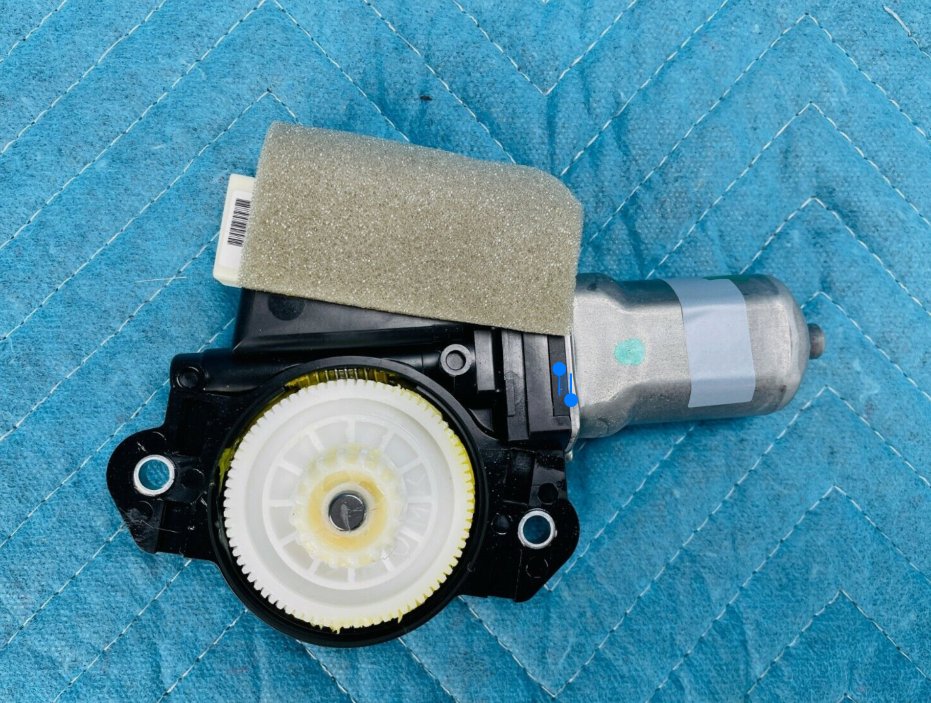

Is there a way to manually close it like some other cars? I pulled the overhead console and I don't see a gear to turn like I've seen before. I am hoping one of you (@Acrad) know how to do this or have a diagram that shows it.
Good to hear you got it closed
Unfortunately.. I’m not aware of an emergency gear like I’ve also seen in other cars to close manually.
You’d probably have to drop the motor and see if you could find something to close it that way
Thanks for the reply. I figured if there was a way to close it you'd be the one to know.
That is what I was seeing too. Annoying but at least it's closed for now.
