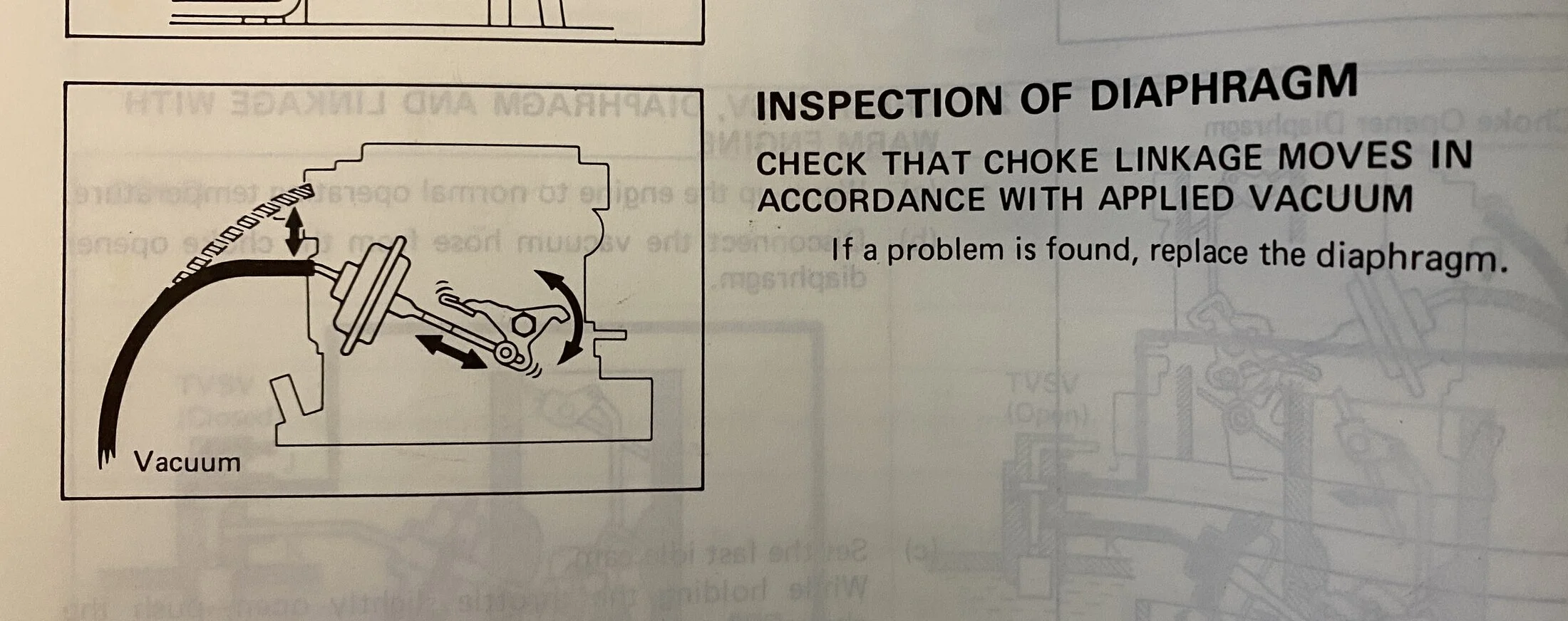

Also, this is super simple to test. Pull the vacuum line, hook up a vacuum pump, and see if pulling a vacuum will close the choke. Mine would partially close and then open up again, it would not hold a vacuum.

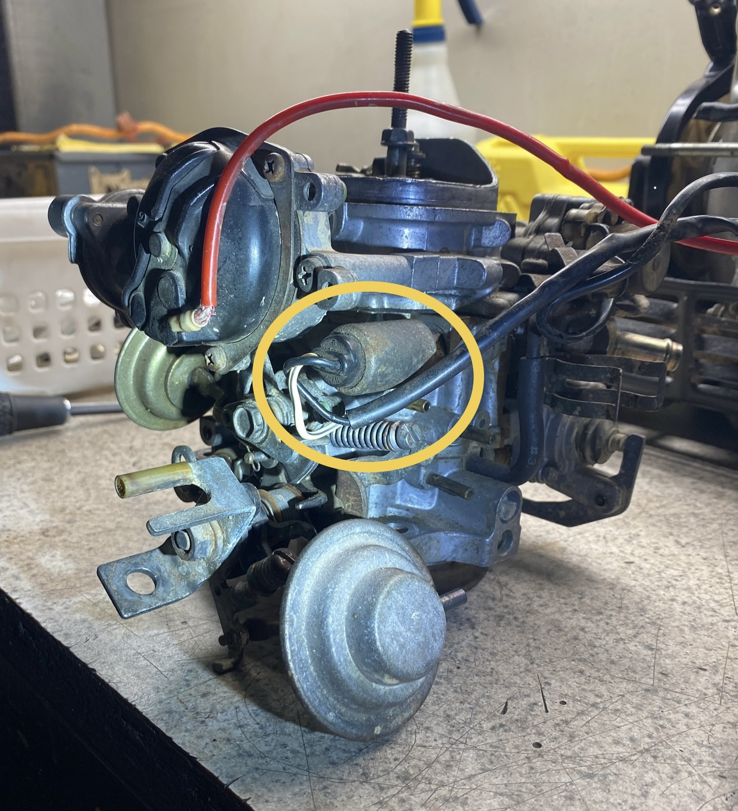

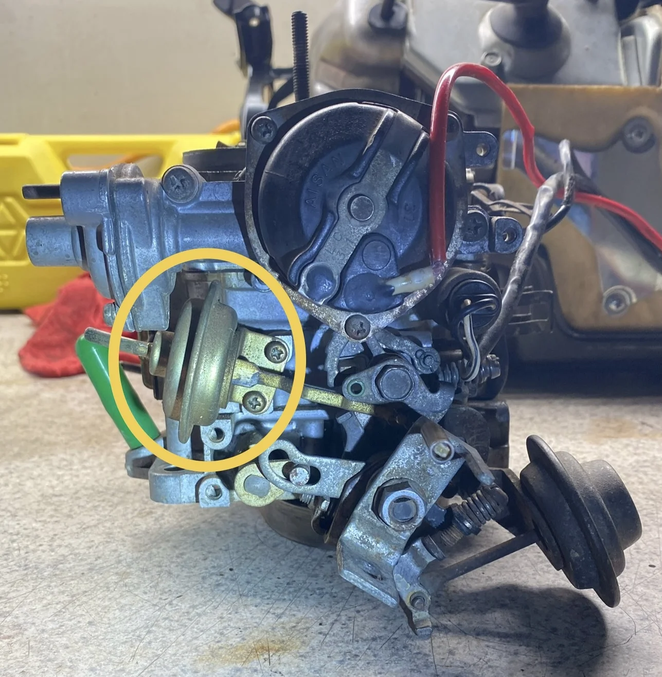

Here are a couple of pics of the back of the carb, closest to the firewall. The first pic is the carb closer diaphragm and the second pic is the fuel cut solenoid.
You will need to remove the air filter housing to have better access to these parts.

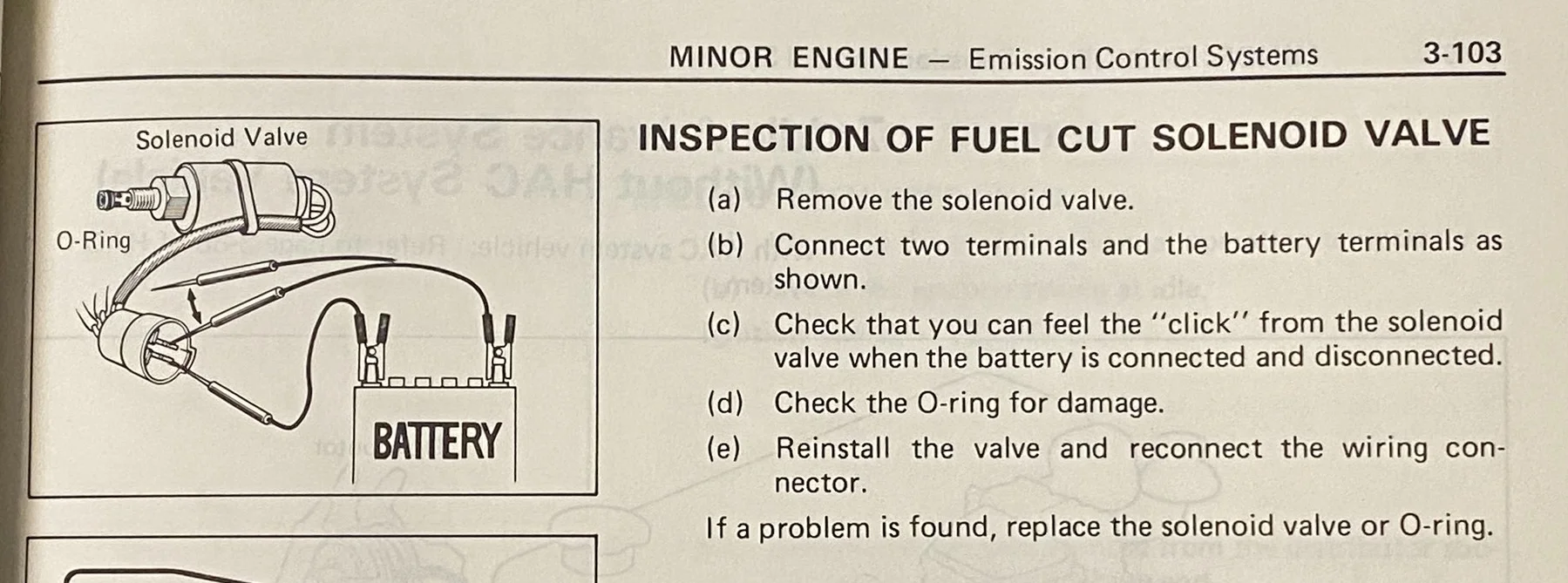

OK, I ran 12V to the fuel cut solenoid and got no click. Negative side of the battery to the wire that is attached to the carb housing just above it (white, I think) and positive side of the battery to the terminal of the black/white stripe wire that goes into the round plastic terminal housing. I did not remove the solenoid to do this test. No go. I did not check for 12V in the circuitry (forgot), but will do that next.

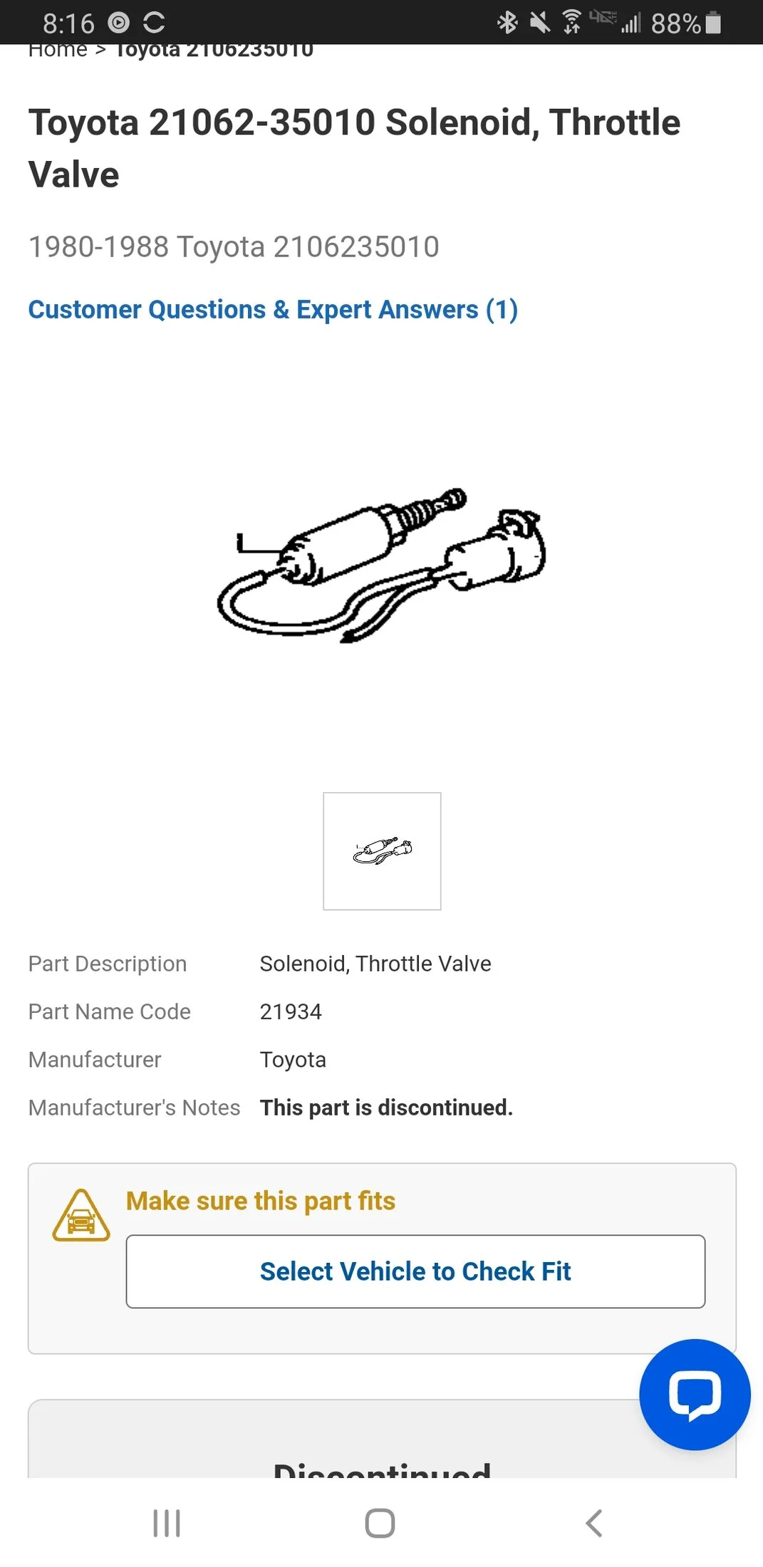

this should be the legit part.
did you check resistance across the terminals of the solenoid?

this site shows it, but it may or may not be legit. i ordered an nla part through them a few days ago, we will see how it goes. i have received order summary emails and they were promt answering another question i had. i did use PayPal in case it is not legit though.
Thanks for that link. They also have one that is correct for my 1981. Since it is a bit pricey, I went out and tested a couple more things with the voltmeter. Turned on the ignition to see what female connector had 12 V (the other three read 0V). This is the plastic connector that goes to the fuel cut solenoid. Matched that to the corresponding spade going to the solenoid and got it to click. So... at least I know the solenoid works.
