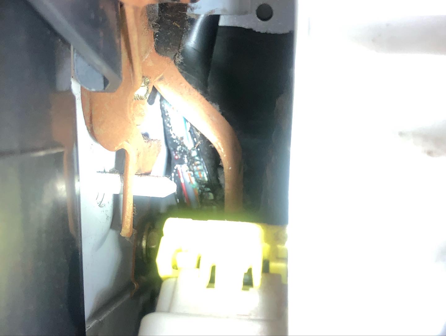

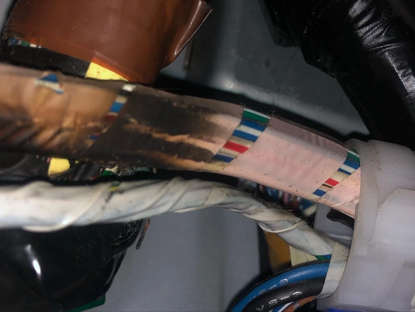

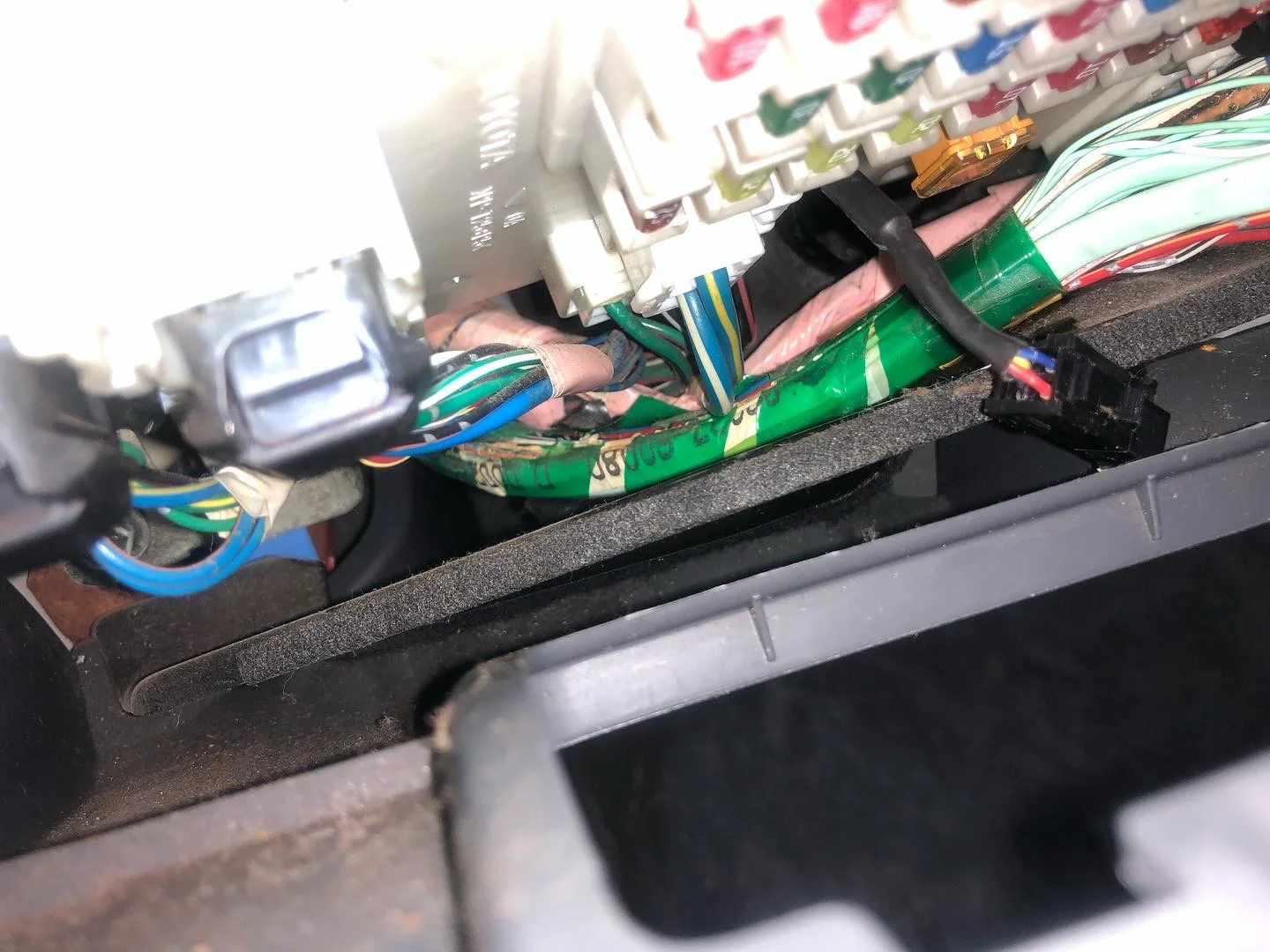

I had the same issue but no symptoms of a problem existed. Discovered the short when I was installing a pedal booster under the dash. I saw factory wire harnesses burned. Ended up being the visor vanity light wire as well. I wish I caught it earlier. Would have saved me from replacing 38 wires.

Yes, they don’t work after the short but I chose not to have them rewired. The fuse was still intact, when I discovered the short I removed it. I took it to an automotive electrician for the work. He said the same thing, it’s odd that the fuse didn’t go and allowed the wires to burn up. The electrician asked if I wanted to replace the visor wiring or kill the circuit since the wires were untouched from the factory. I don’t need those vanity lights so I opted not to replace them.
