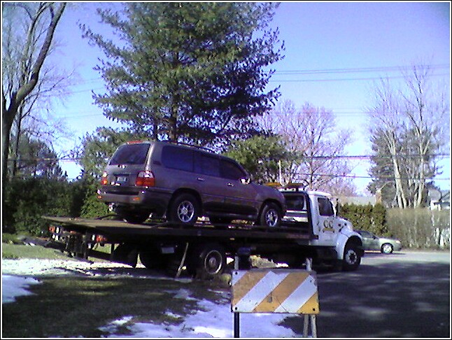

I haven't checked the exact date of manufacture, but being a 2000, it looked like Christmas on the dash when the VSC, TRAC and Check Engine lights came on. Even though I was able to restart and drive it normally to the dealer, all the lights stayed on. My mileage was around 72K.
Basically, the pedal is connected to the throttle body by cable, but once there it is converted to electronics in the APPS. When the electronics are not working correctly the computer locks out other functions, so I would not be surprised if the ECT is not functioning.
