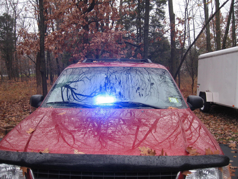

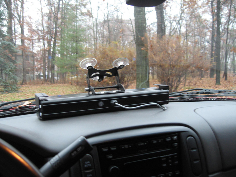

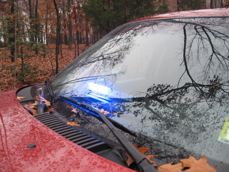

Sorry, I've been slacking on the pics. I just can't seem to get the lighting right so you can see it. LOL.
It's a lot like these photos I stole from the interwebs:

  • Consider a magnetic mount LED mini-bar for better flexibility. It can be placed in the middle of the roof or forward/aft depending on your need in a particular situation. They give much better visibility from off-angles than hideaway strobes. I have several of these and they are very bright, portable and energy efficient. I can even slap it on a roll cage in our side-by-sides with no wiring etc. Being able to move them from vehicle to vehicle is something you will be glad you can do eventually.
