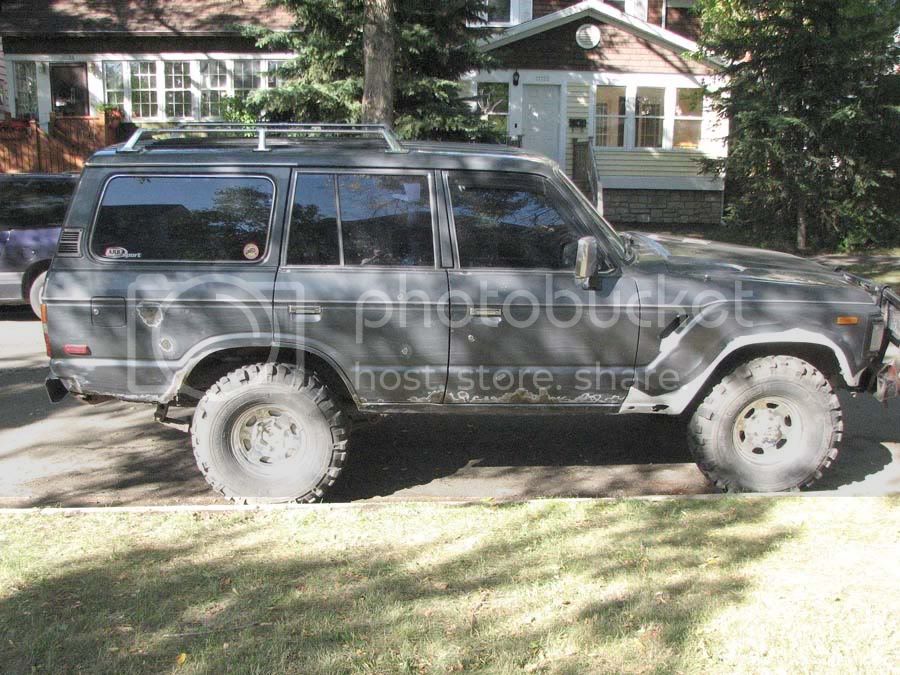

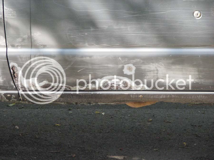

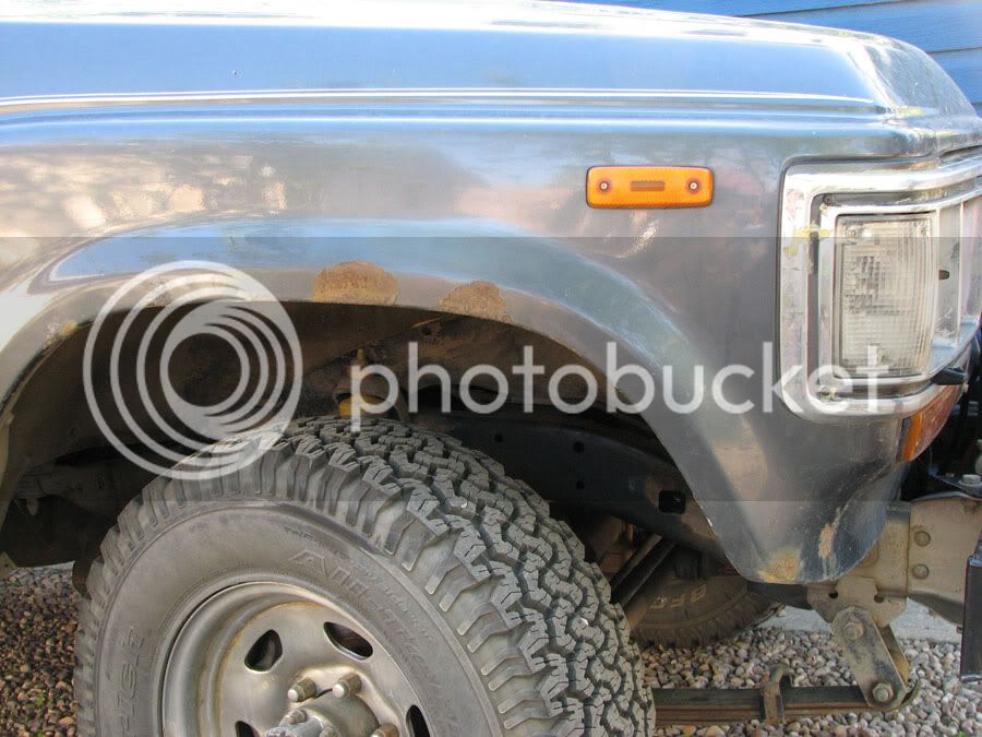

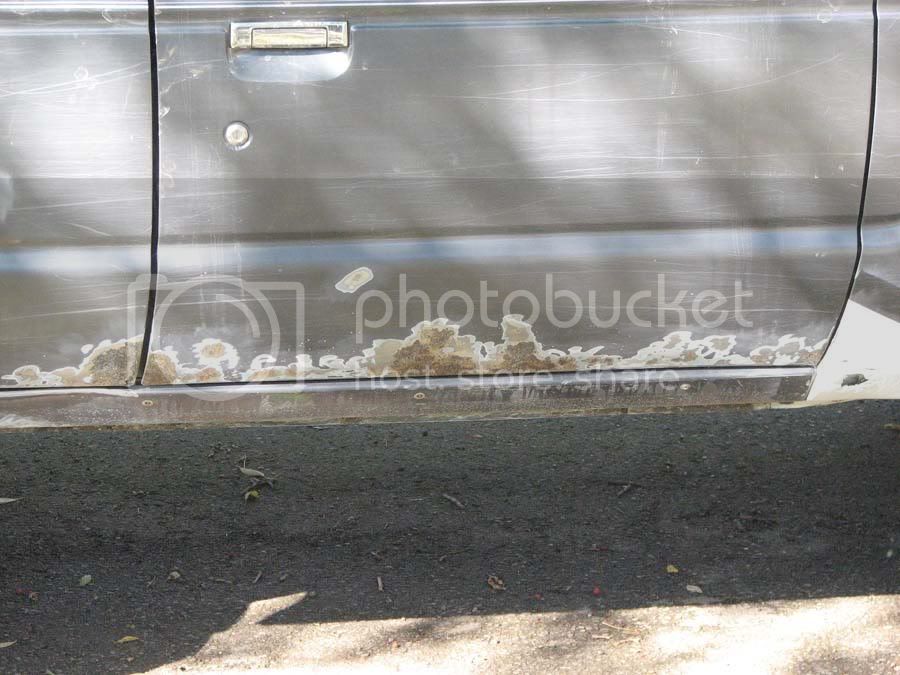

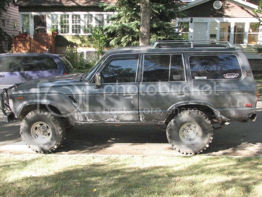

I've got body rust pretty bad on my 62, and really need to put a stop to it if the truck is going to remain servicable for a few more years. I don't have interest in fixing/restoring the body though, as I have another clean truck in the works and will use the 62 as a winter/trail beater so that one doesn't see salt. I'm not too concerned about absolutely killing the rust, just want to slow it significantly.
So here's what I'm thinking, please give me your thoughts.
1 - Sand/grind/wire wheel away as much loose material as can be done easily
2 - Go at everything exposed with phosphoric acid to chemically knock the rust down some.
3 - Deal with hole/gaps as seems prudent (fiberglass, pop riveted sheet, expanding foam, pine cones and white glue, what-have-you)
4 - Coat exposed material with an asphalt based rattle-can undercoating (which hopefully with form a flexible and oxygen-consuming immediate coating over the metal).
5 - Go over the asphalt stuff with a paintable rattle-can undercoating, masked to follow body lines.
6 - If that looks too crappy, give the whole truck with cheap DIY paint job.
7 - Get at the inside of the panels with a suitable rust inhibitor.
Alternate easy and cheap suggestions?
No thread is complete without photos I suppose...
Hatch will be replaced ;)
