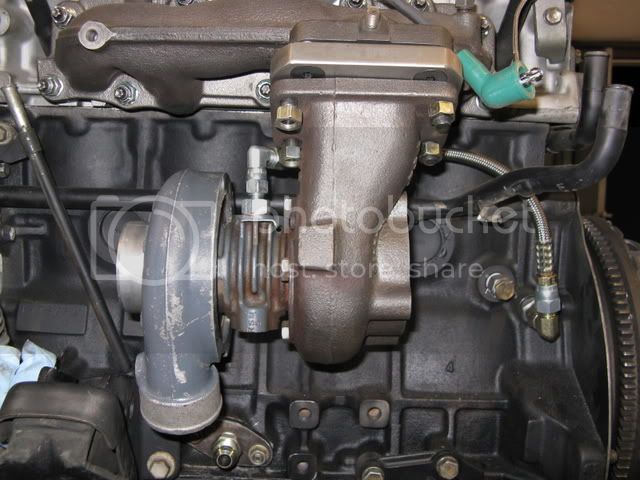

Then you'd have to do this:
From this thread: Turbo 4runner

I'll try to find the RTE forum, it's got a great How-to in it about using a CT-26
ahhh, looky here...
22RTE - EFI and Tuning
more specifically here
CT26 Installation
Also, with a relatively low c/r even for a turbo. You should be able to mix and match the 22RE pistons OR (not and) an RE head. And so you know, a RE block does not have the turbo oiling provisions drilled and tapped like the RTE already does. (not a real a biggy)
The stock Turdblow only puts out 7psi, the CT-26 does to, but it has more volume so it would lend it's self to an intercooler and turbo mods better....
