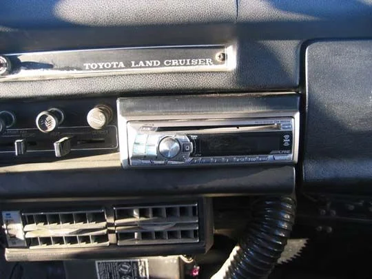

I just cut out a small section and reversed the part i cut out and rewelded it in .only took out 10 % . then i made a box to set the radio out flush with the dash .

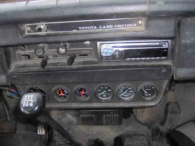

I just notched the radio box and took a small section out of the heater duct behind it and it slid in fine. I didn't need to but I tack welded the radio cage into the old hole as well...

Hmm, build a box and let the stereo stick out a bit? Sounds good to me.

I remember that heater duct...think I found it was just a little bit in the way, put a long punch and the 3# sledge to it and made room for the stereo. And you're getting pretty close to the windshield wiper mechanism too. Evan's idea for not pushing the unit all the way into the dash solves both of those.

Pighead, your right, the wiper rod is close also. I think I will build out the box. Good idea.
mine is mounted flush like DCH (dre) did. my old radio bit the dust from dust, so the new one i built a foam box in the dash for it, like a foam air filter with the open cell that can breath and vent heat for the unit. i take it out to clean it after every off road trip and it stays pretty dust free.
