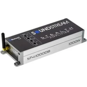

I use one of these, hidden away. In a 40, it makes a stock am/fm loud enough to hear while on the highway, probably don't have that problem in a 60. Easily connects to your phone for podcasts, streaming.
