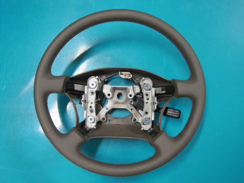

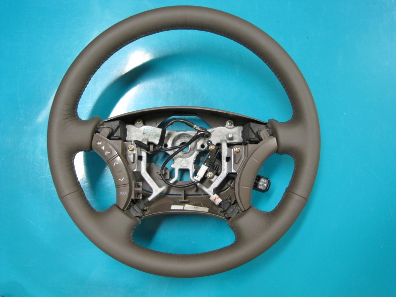

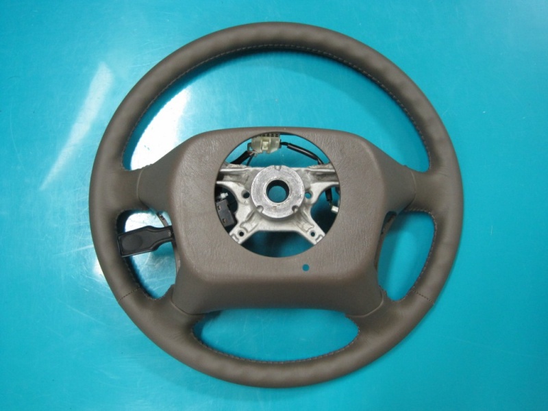

It's a long thread, and the pics I had hosted on my old webpage are now gone. The text describing what I discovered is there, though. Just skip to about page 4 or so for the relevant info you're looking for - OR just look at the four pics below.
The clock spring interface that is cast into the wheel is not the same from 98-2002. The 2003-2007 LC uses the same clock spring as the Tundra/Sequoia/Sienna steering wheels. The 1998-2002 wheels had a Land Cruiser / LX470 casting ONLY and no other wheel will fit that I know of.
Early LC/LX Steering Wheel Clock Spring Interface vs. 2003+ LC/LX + Tundra/Sequoia/Sienna type wheel. Look at the casting shape on the BACK of the wheel.
