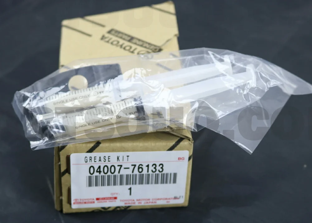

That's what this is for:
It's in the service manual.
FWIW, it's also great for regreasing electric motors, like the door and window motors (in the 80s) and the transfer case actuator motor.

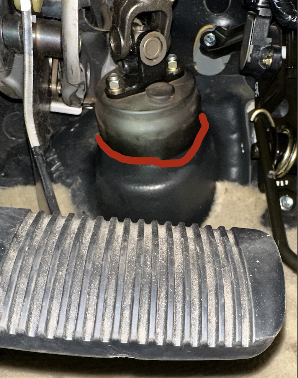

I had a similar noise although more of a friction / rubbing feeling than a squeak.
Follow the steering shaft all the way to the firewall and you'll see a big rubber boot / cap. Peel this rubber cap back just enough to use your finger to rub silicone grease all along the ends of the rubber cap where it makes contact. This solved it for me although it needs to be redone every once in a while.
Follow the steering shaft all the way to the firewall from the Engine Compartment, or from inside the Cabin to the firewall?
Just ran to the garage... peel back this rubber cap and silicone grease the ends (where it's edited red). Make sure to go along the entire circle of the boot
there were a few different p/n for the kit, or at least there used to be. some of them had more tubes of grease vs the others, if you can get a kit with more grease go for that one
